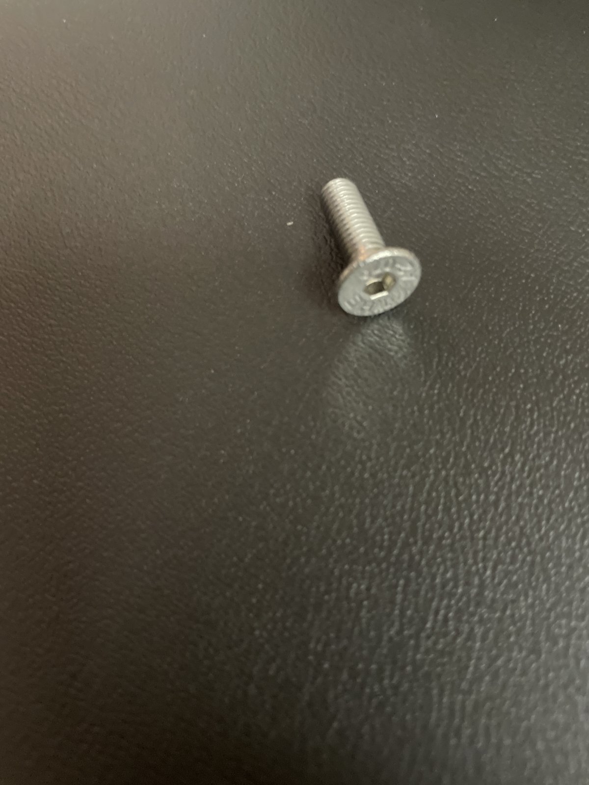

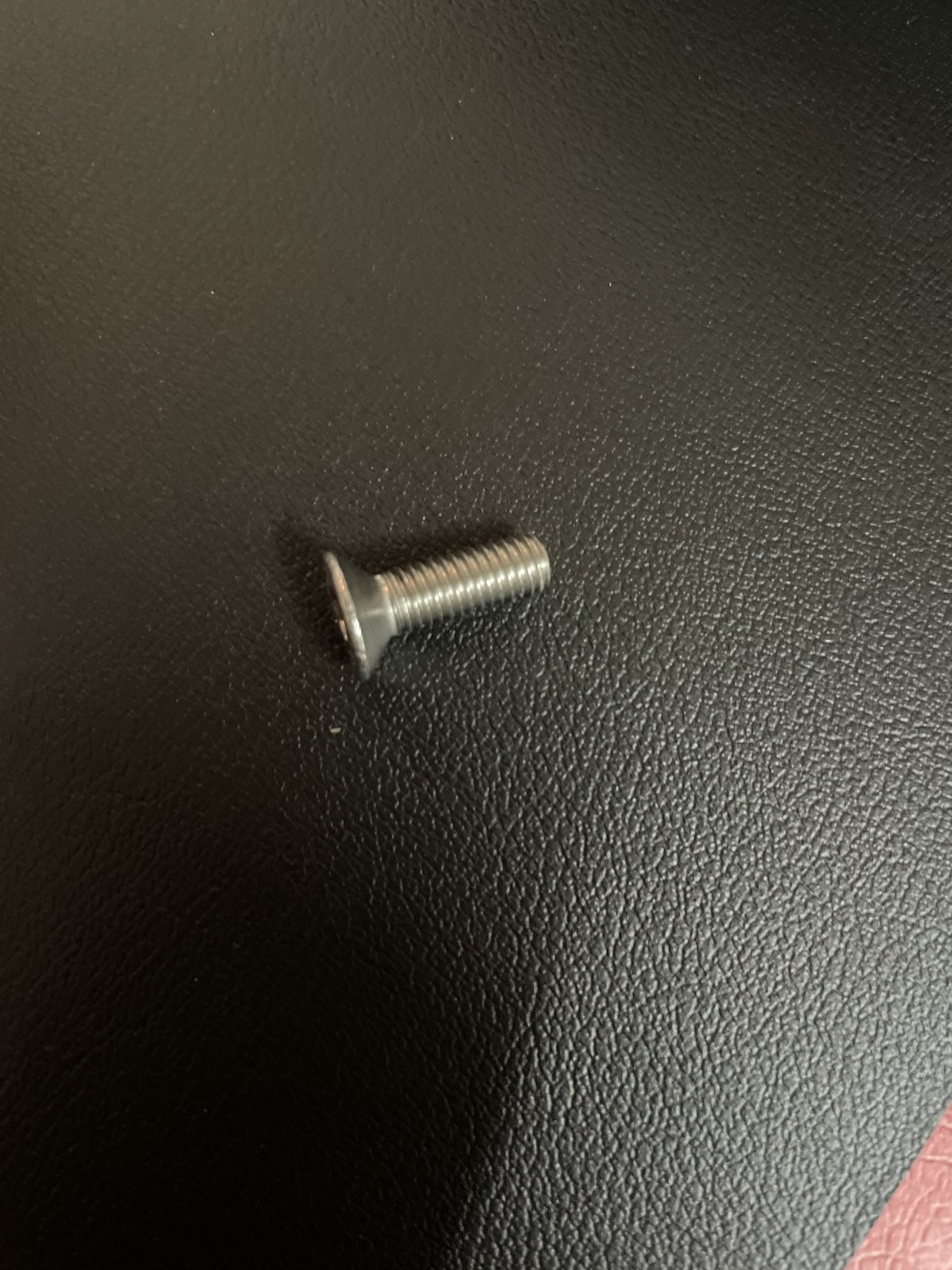

Do you know what screws are needed for the bushguard? Have 4 screws left but only two fit, on one side there are two screws needed i dont have ??‍♂️
You need 2pcs. M5x16 sunk head hex srews. You cannot use the cylidric head screws on the side of the bashguard
No they dont. They are missing / the delivered screws do not fit. You have to buy them somewhere, should not be a big issue.

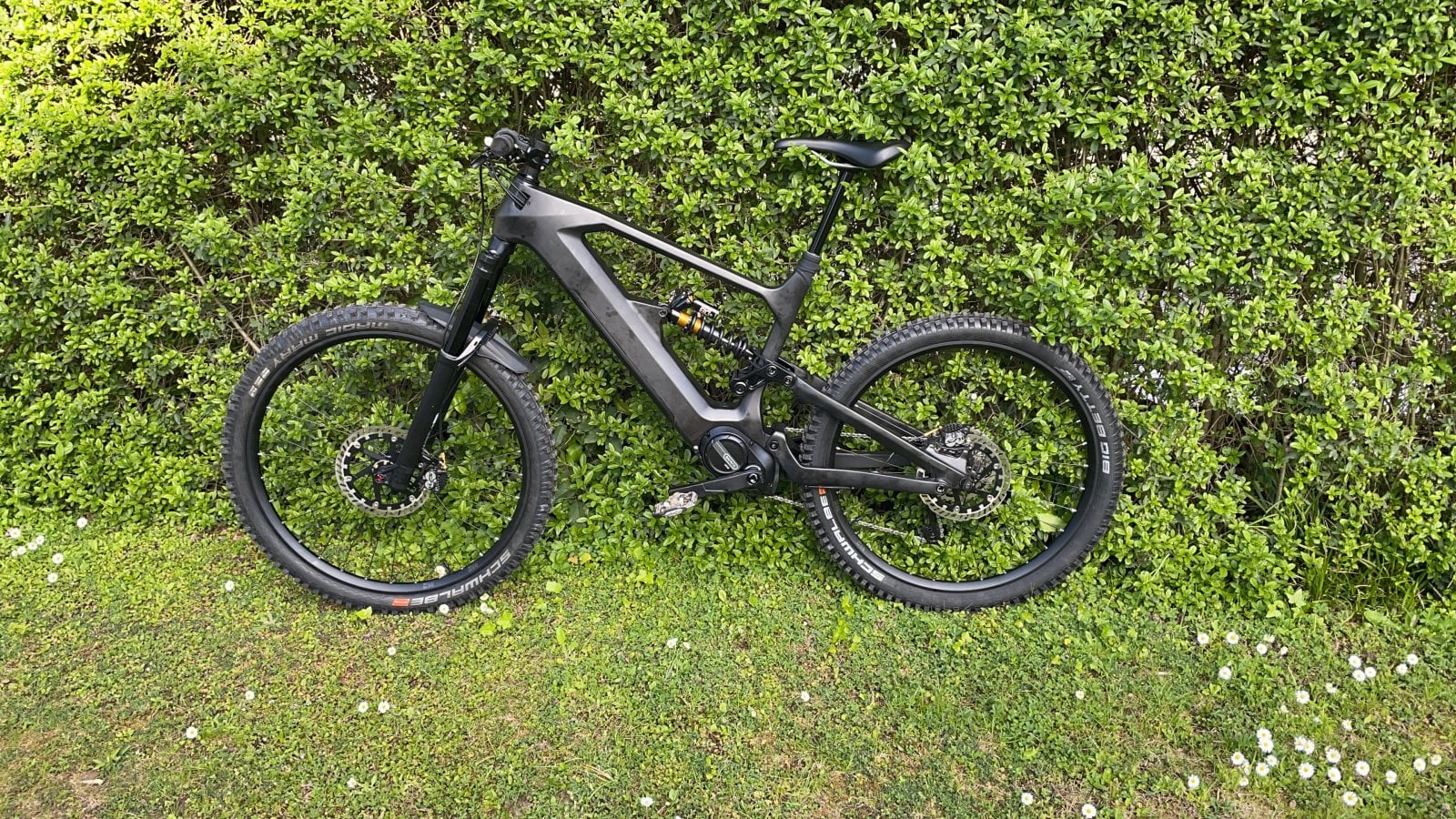

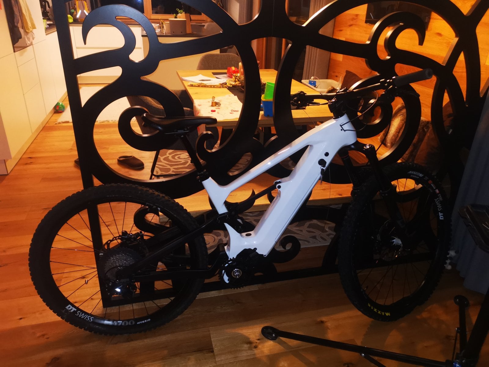

Finally, Battery arrived today! 1st testride successfully done, its a BEAST! 180/29“ front, 170/27.5“ rear. Cane Creek DB Coil 216/63, 2 mm Offset bushing reducing to 214 shock length. Minimal rework on rear shock link needed. BB heigt at 360mm, Head Angle exactly 64 Deg. Almost 25 kg with 840 Wh Battery. Manitou Mezzer Fork. Feels like a flying carpet!

Looks great! Good to hear you managed to get the 216 x 63 to work. Thinking of doing the same but running a 29 rear on a 17,5" frame. Do you think there's enough clearance to make this work? Thanks!

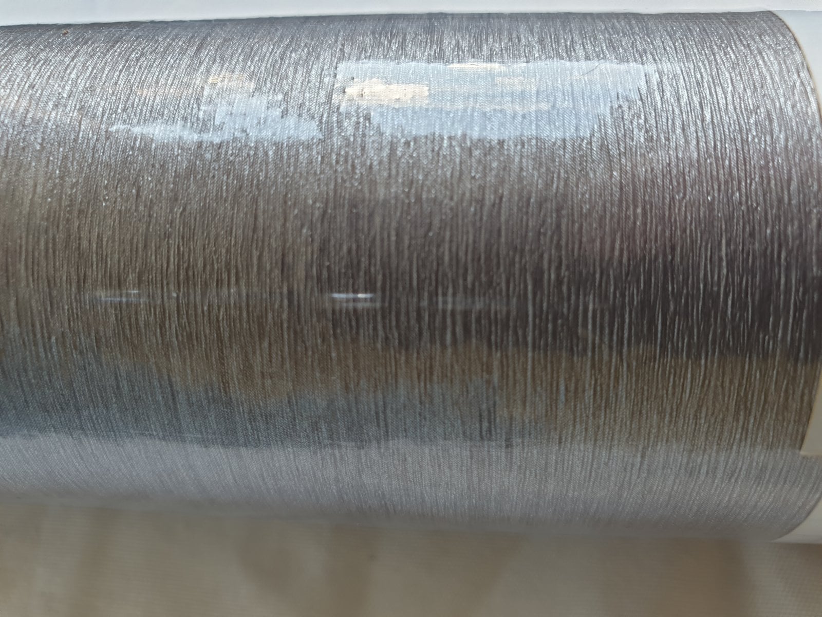

Hi. Does anybody Knows if there is any problem if the frame remains matte black without any paincoat???? After four months waiting I don't want to wait 3 weeks more to get it painted.... Somebody tells me that the carbon fibres will have problems with sunlight.... I don't know if is it true...
That is true but the frame does seem to have a matt black finish so the resin and fibres are not exposed to direct sunlight which would cause degradation in the resin and fibre. My only concern is the quality of the finish. My lazy compromise is to use vinyl wrap on parts of the frame. We'll see how it turns out.

Sure! Its a 29 frame according to specs, 29 x 2.6 max tire size!
Hi @thaeber,
When you say some work needed on rear
When you say minimal work needed on the linkage do you mean shaving some material off??
