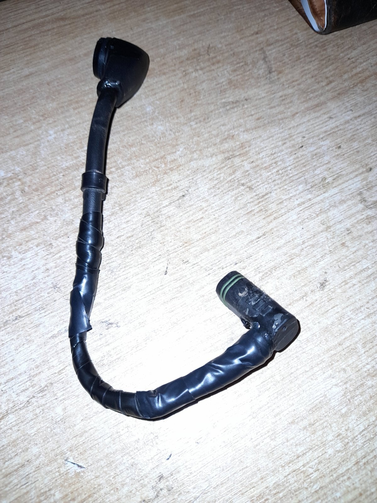

I replaced my power cable with the V3 before my existing cable gave me any problems. It had however started to crack. I modified my old cable to keep it as a spare.
I repaired the crack with araldite. Then stripped the outer sheath back from the motor end plug about 75% along the total cable length. I then used a neoprene glue called Aquasure to seal the cable into the motor end cap and also to make sure the battery end cap to sheath seal was reinforced. The bare section of cable was then wrapped with self amalgamating tape with a layer of insulating tape over the top just to act as protection. This process made sure the cable was fully sealed and made the cable more flexible so that it would not put pressure on the motor end cap and break it. I will dig out a photo of my modifed spare cable.

My repaired cable
