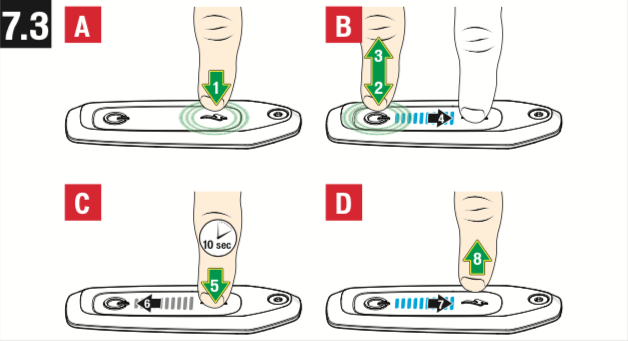

Factory Reset the TCU Display
Before a new or used bike is sold, the new user should perform a factory reset of the TCU display, to reset the peak power and support mode settings.
To perform a factory reset:
A: Long-press (hold) the Mode button (1).
B: Press (2) and release (3) the Power button (continue pressing the Mode button). LEDs will light up (4).
C: Continue to long-press the Mode button for 10 seconds (5), until the LEDs turn off (6) and turn back on (7).
D: Release the Mode button (8). Factory reset is complete.

Yes you did a factory reset....your mode settings ade probably returned to factory default as well. I suspect following a short circuit, depending on the original cause, the system needs a reset. The specified factory reset procedure is to hold down the mode butyon and then press and release the power button. Keep the mode button pressed for a further 10 seconds and then release.

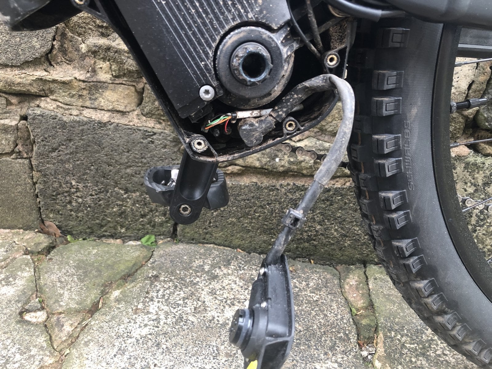

If you are talking about the power cable I would remove the non drive side motor cover and remove the power cable. The normal problem with old cable is that motor end plug cracks and that causes a short if any water gets in there or in worse scenarios the wires can break or develop a high resistance break. Assuming there is a crack photo it. Then contact any Specialised dealer or go to Spesh direct and request the v3 replacement using your photo as evidence. Also photo the serial number of your bike to prove ownership and that it is still under warranty.
I think the issue may be the TCU but I will have a look at the power cable now.
Thanks

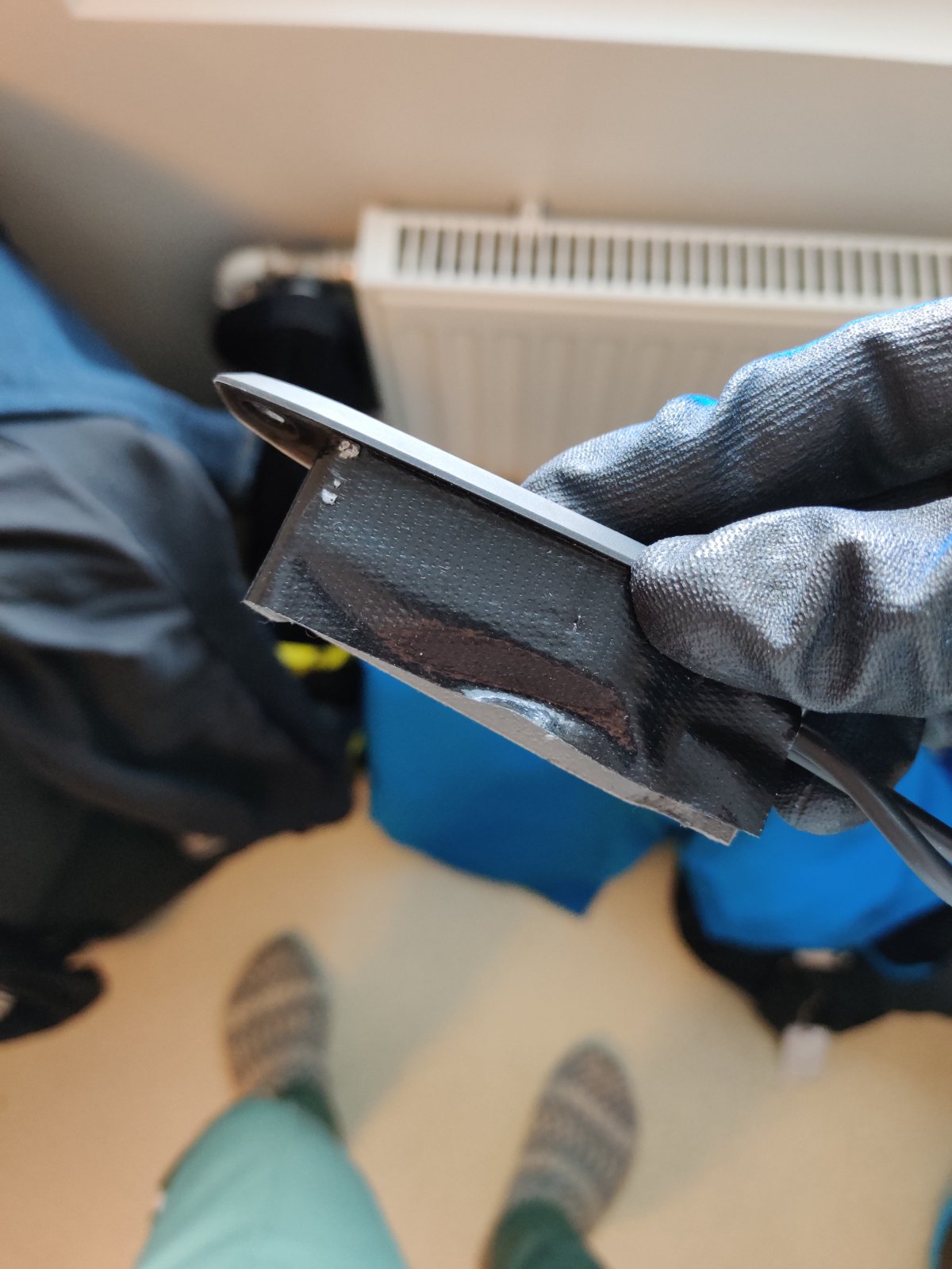

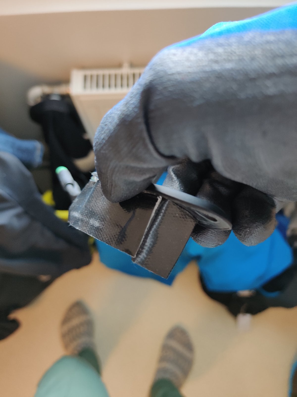

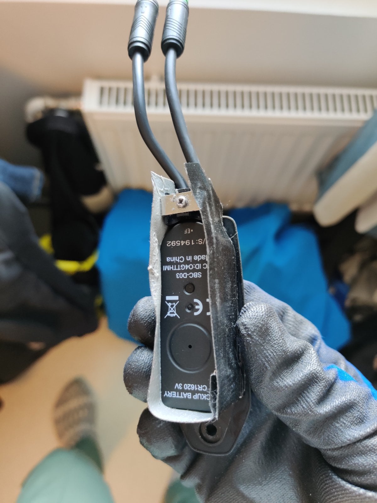

Take out your TCU ,remove the plugs and lay it on the radiator over night.
Usually the Water goes into the USB Plug,..even with the rubber Plug closed.
I taped the whole damn thing,..since then I had no Errors from Washing or heavy Rain.

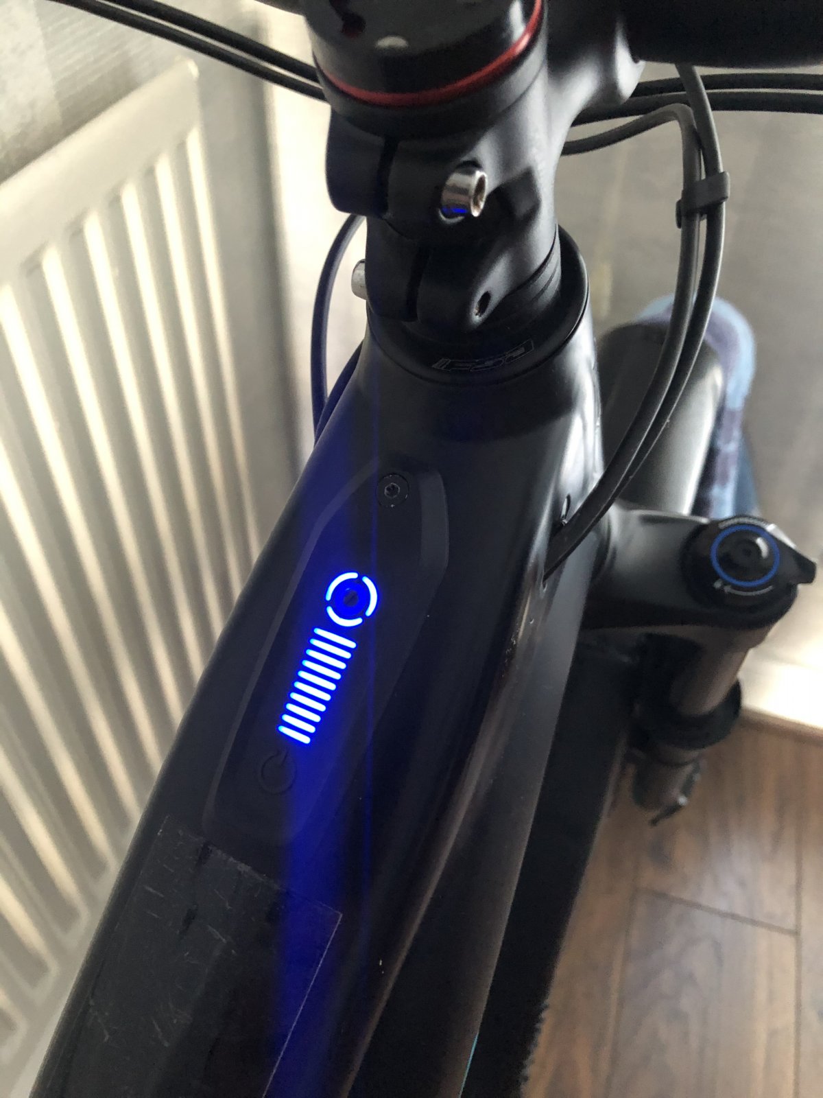

So I’ve had the TCU and battery out all day on my office window ledge in the sun, I’ve taken out the power lead and inspected for breaks but it appeared in good condition. I’ve had the bike in the dinning room for the past hour (she’s not happy lol) I’ve cleaned the terminals again with a cotton bud and put everything back in and it’s working again.
I plan to leave but the radiator overnight and then check in the morning and tape up the USB as Bushkila suggested.

Tape everything up, not only the USB Port, go all the way around. It has to be really tied.
Yep, you have to remove that tape for an Firmware Update,....but its worth the effort, it works.

Looks dry, can’t see any cracks but it does have a rubber cover around it.
Is there a good waterproof seal between the cable cover and the motor end cap? It is only glued in and looks at an angle in the photo suggesting not. ps the O ring on the battery connection is bone dry and probably not achieving a lot. I put silicone lube on it and then grease on the chamfered face behind it.
