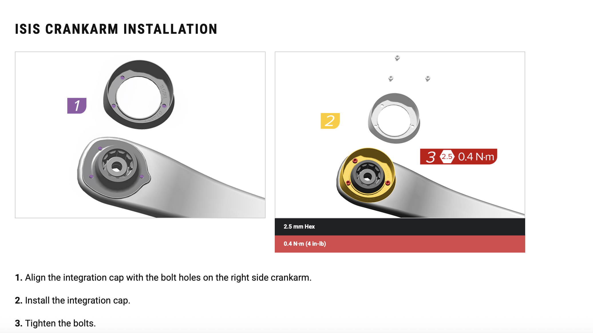

Are all SRAM ebike cranks the same offset? Can I use the standard X0 ISIS crankset?
My understanding is there is a difference. Not all ISIS e-bike cranks will work with the DJI and Bosch SX. It needs to state its for the Bosch SX.
