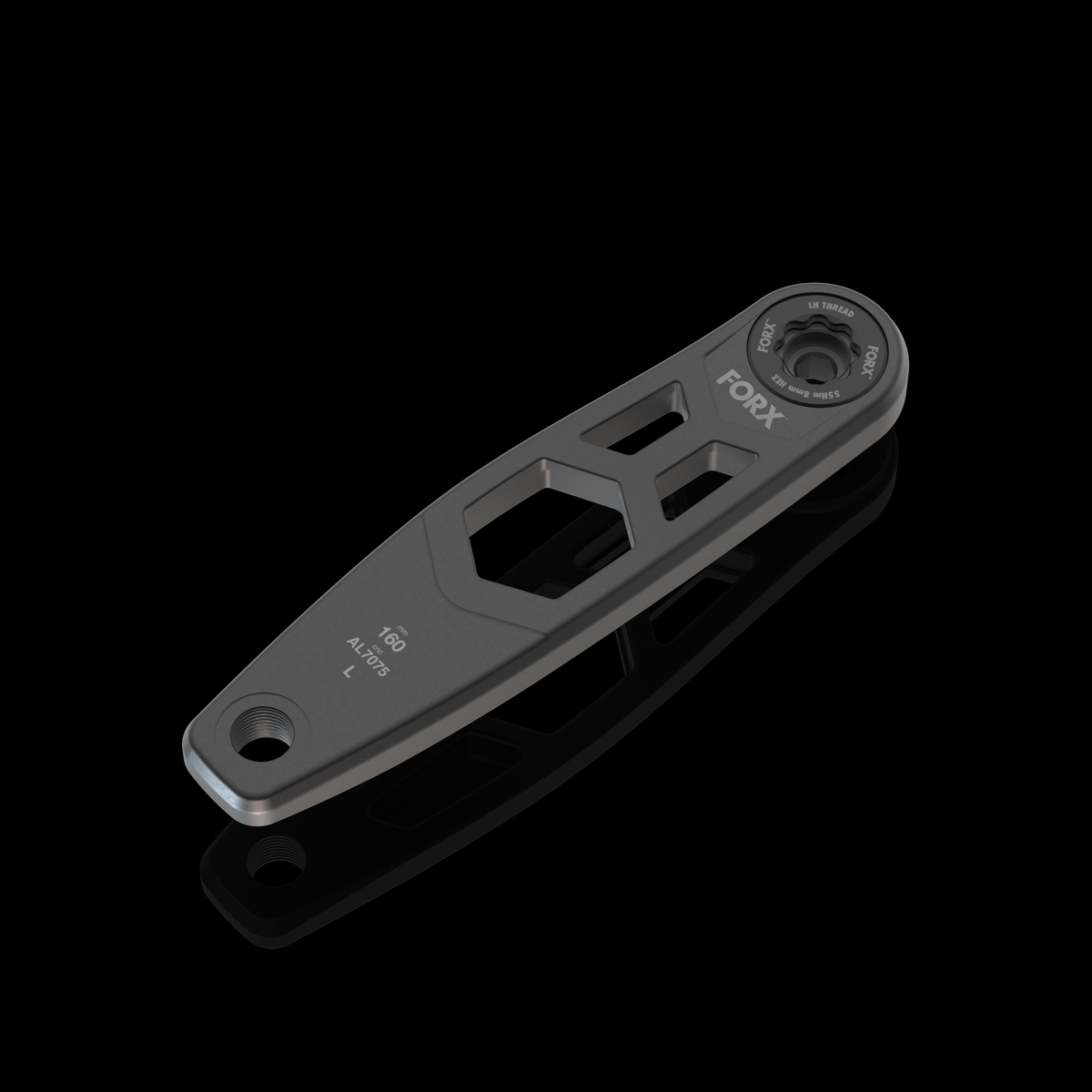

I believe any ISIS crank will work. I am going with SRAM XO 155mm. I've been running Forx, which are an interrsting small company with at least some color options if that's your thing. SInce I'm all SRAM drivetrain I'll use thier emtb chainring for Transmission.

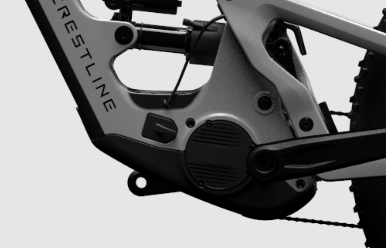

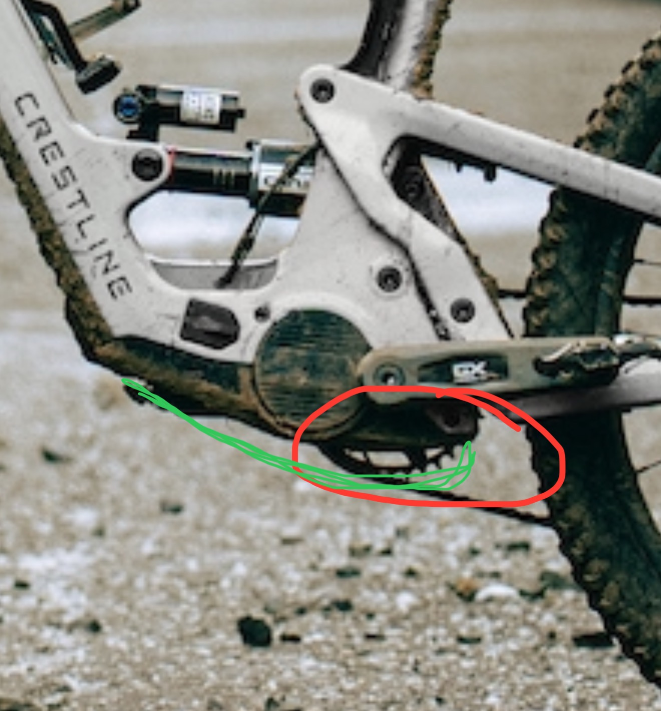

It's a fatal flaw and it blows me away that no one else is discussing this issue or trying to create solutions.
I talked to Troydon about a bash ring or guard for the chainring, his response was: “the offical cover serves as a bash guard. The cover in the website pictures is a 3D printed cover. The official one is more like our current bike and comes down enough to protect your chain ring. You wont need a bash guard, I did it cause there is no real way to mount a bash guard.”
He also sent this pic that shows the added protection that isn’t displayed on the website.
It sounds like he may offer the same bash guard without the added chainring protection, so buyers have options.
Troydon also said even with this added chain ring protection guard, the new RS181 still has more ground clearance than there last bike.
This will solve the bash guard problem but sadly will make the motor appear significantly more bulbous.
I think they should have kept the low profile cover but make a solid rib protrude just at the chainring. This bike does have a tall BB, is this even needed? Are guys who live and pedal up rocky technical terrain experiencing impact on their current Bosch bikes?

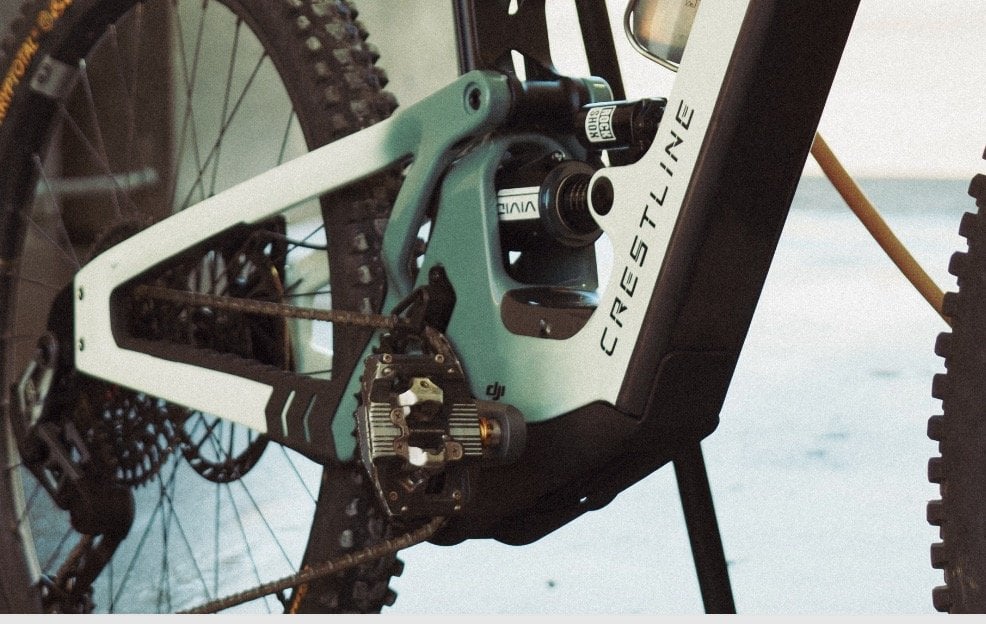

Happy accident to have a more flattering picture on the website; not the real one.
Troydon said he MIGHT supply us with both covers, a low profile (like what’s seen on the website) and a cover that helps protect the chainring(like I just showed)

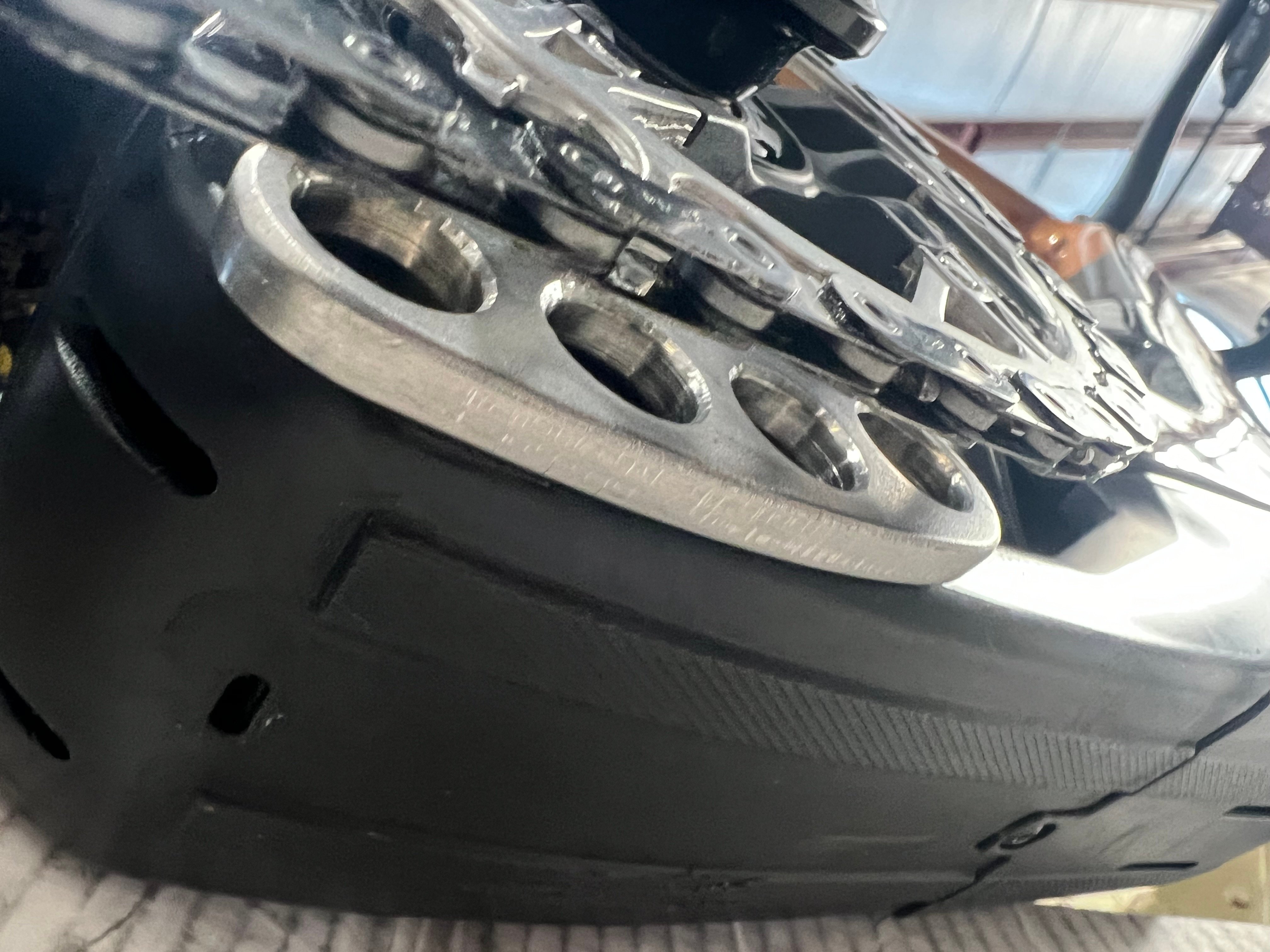

No, I was unable to find any chain ring bash guards that work….thankful Amazon has free returns!

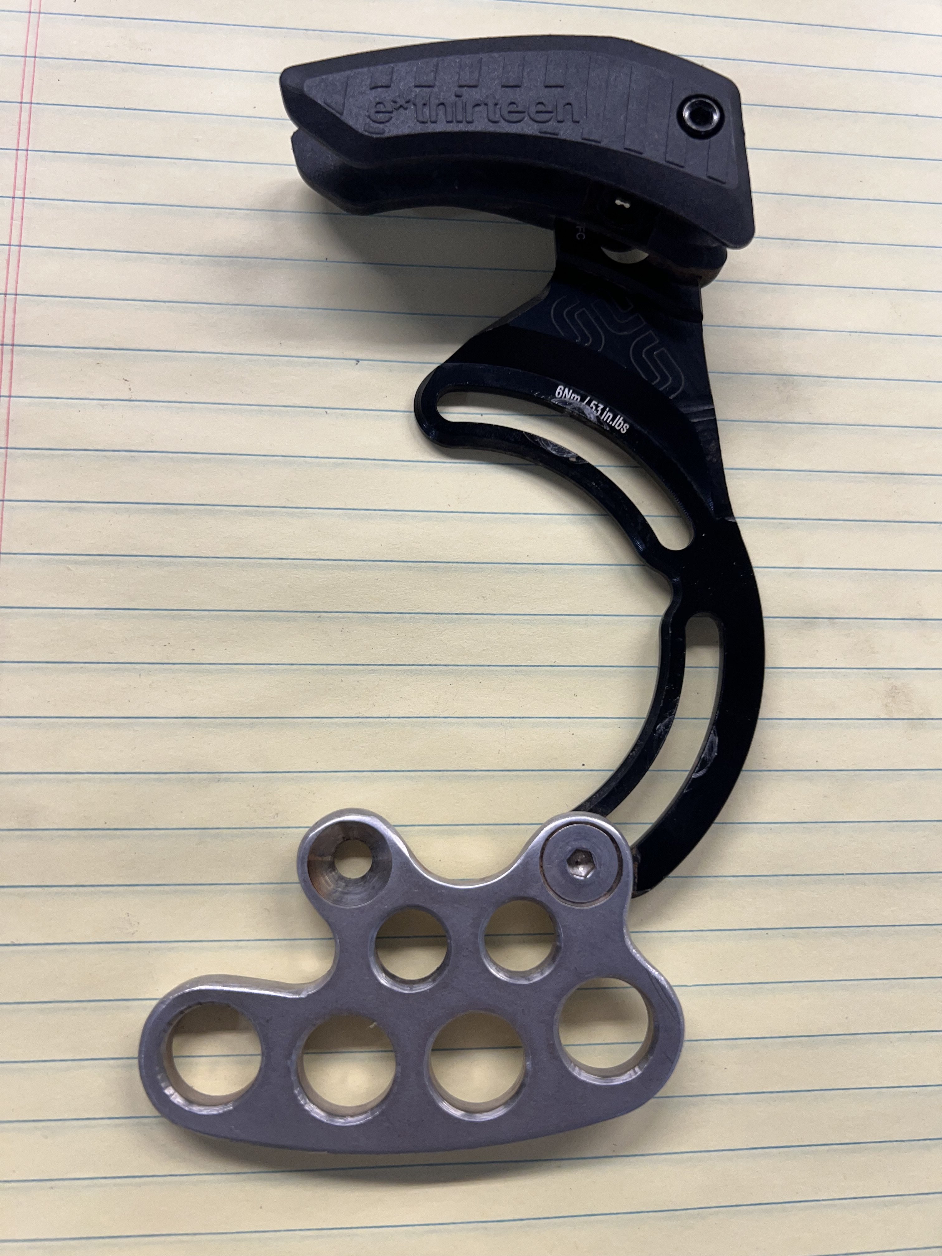

The Bosch Gen 4 bolt pattern is different, which is why I designed and made my own. I made it out of stainless steel because stainless steel won’t get hung up on jagged lava rock or break easily, like aluminum will.
Once I get the new RS181 in my hands I’ll check it out to see if there’s anything I can develop, that is if I feel it even needs any added protection. It doesn’t look like there are many external motor mounting points on the RS181/DJI. I’m thinking maybe something internal to back-up the inside of the bottom motor cover. But I trust Troydon did everything he could with what he was presented with.
You also have to be very careful when adding extra protection because it’s transferring the impact to another location that may not be designed to do so! In the end something has to give or be the weak link, typically better to be a “plastic” motor cover.

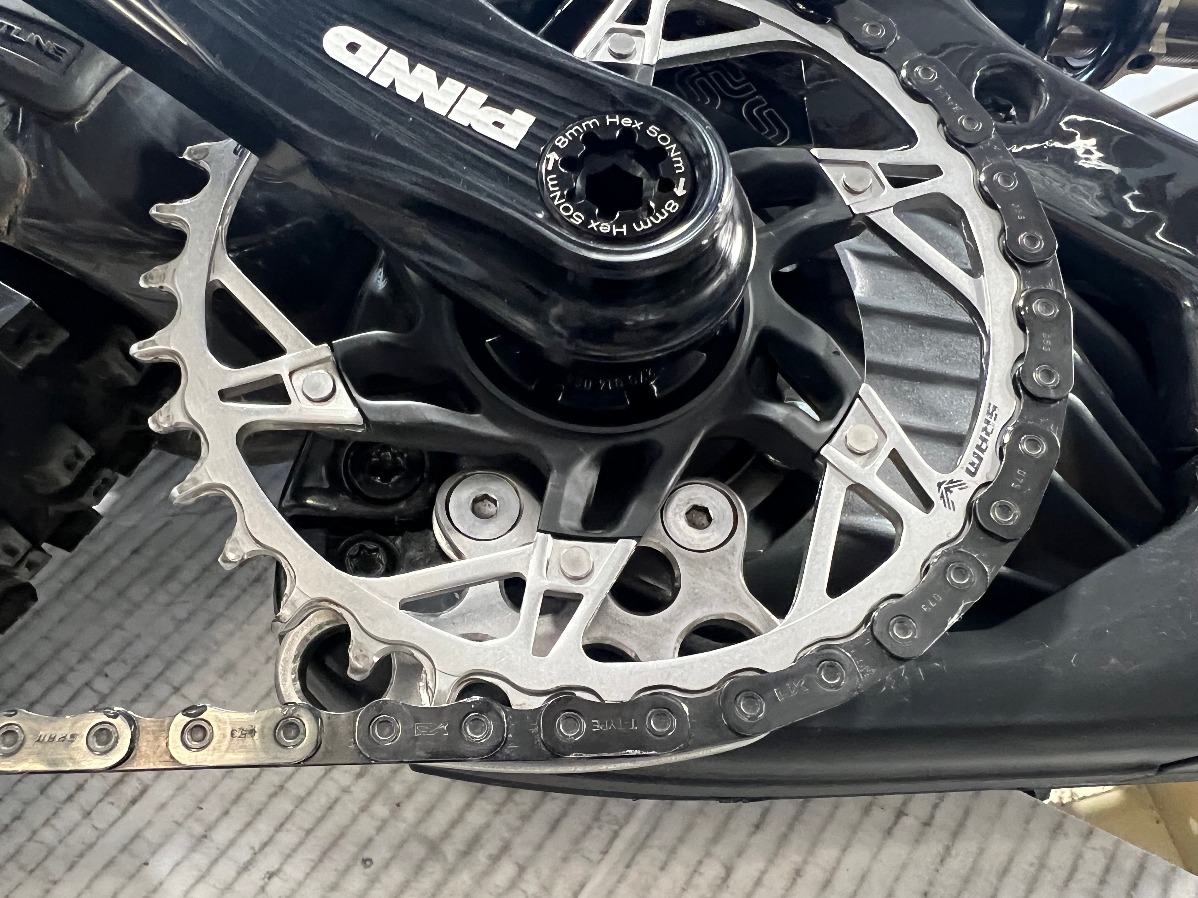

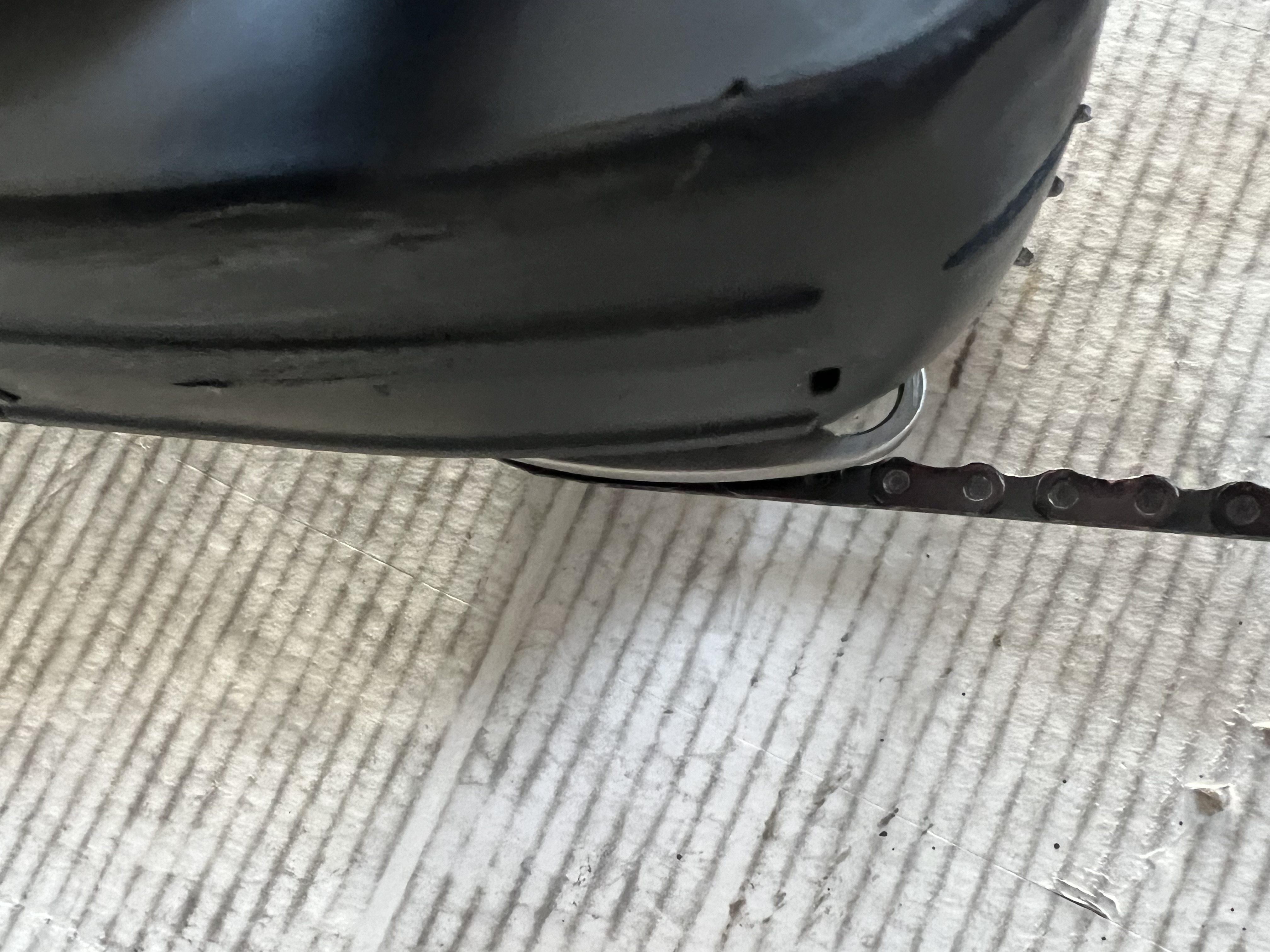

But in the photo, I see the Bosch standard motor covers 95% of your chain anyways, so why go through all of the trouble?
Are you running the 34T or the 36T in those photos?
One helpful solution could maybe be a 28T combined with some small rear cassette, a 9-38 8 speed or the like. Would greatly improve clearance and weight.

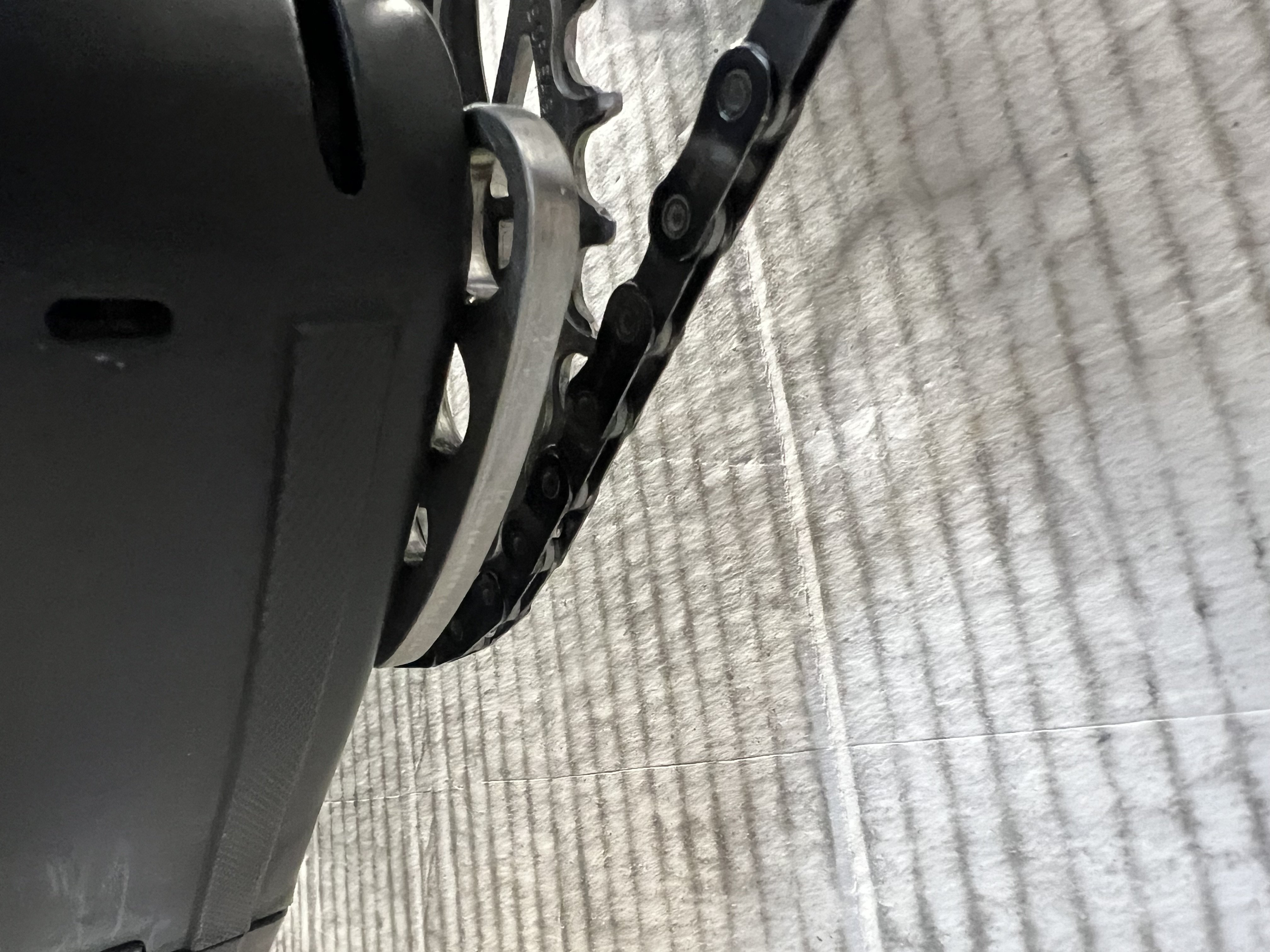

I’m running a 36T which hangs down past the motor cover just enough that I was occasionally grinding my not so cheap T-type chain across big jagged lava rocks.
And Im not so worried about a bit of added weight to a bike if it serves a good purpose.
