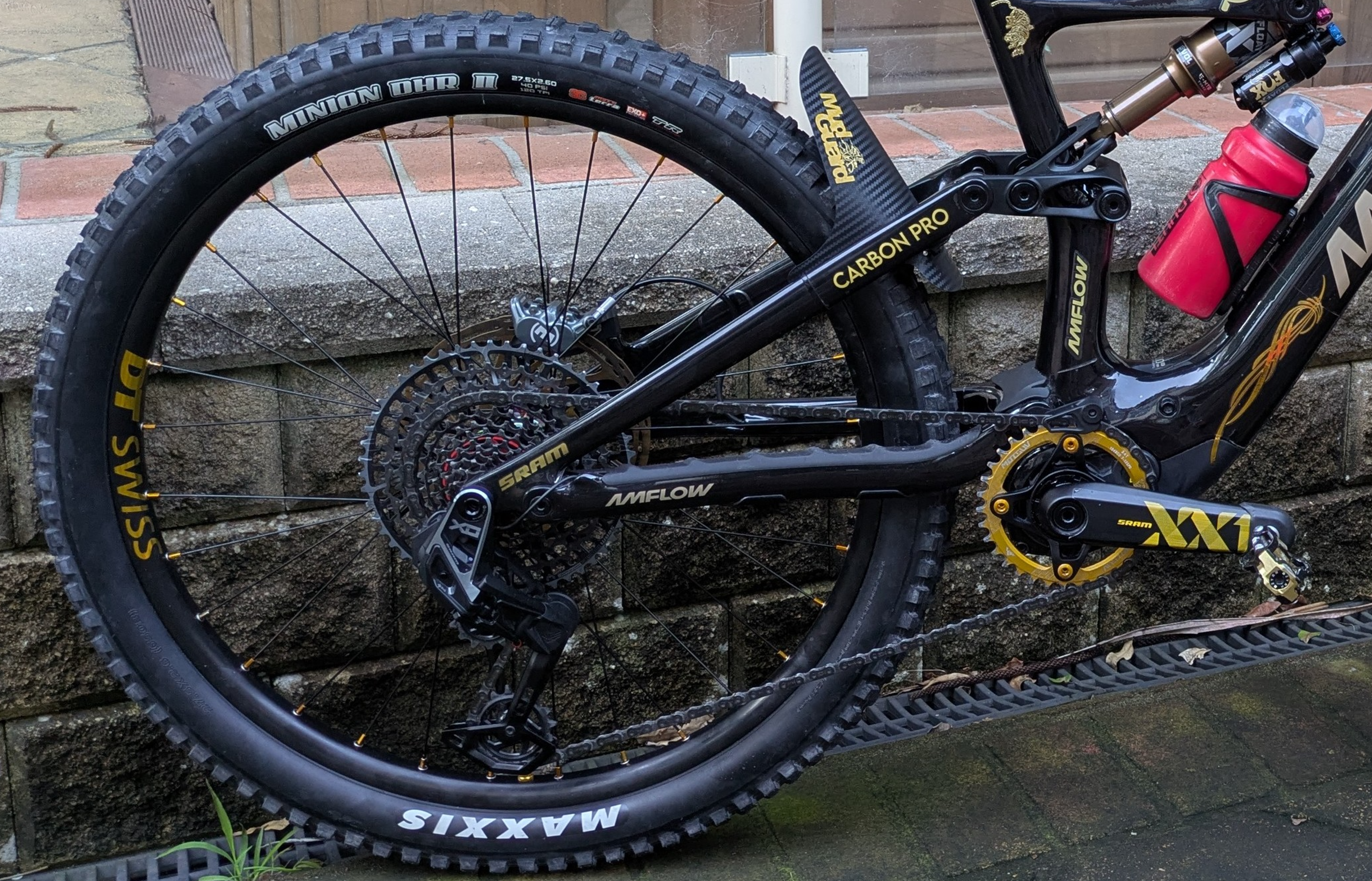

Look at the images on the first page. The chainring on the DJI is well below the motor/bash guard because of the small motor size.
On my Amflow the chainring is about 30mm below the bashguard. So you definitely hit your chainring first.
I spoke to Amflow. They said to fit a chainring protector, to the chainring. The only issue is, I couldn't fit it, without rubbing on cranks, or chain guide, or altering the chainline. So I fitted an alloy chainring, that I'm not too concerned about bending. Sure it won't last as long as the Eagle Transmission chainring. But it's a fraction of the cost. So far it's working perfectly.
In 300km of riding, far I've rubbed the chainring 2 times, dropping off steep ledges. It hasn't caused any issues. There does seem to be more BB clearance than my previous EMTBs. I bashed my bashguard far more times on the previous EMTB, which had identical travel.

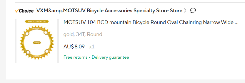

Im getting my shopping list together and I’m curious what other RS181 buyers or DJI users have for a chainring?
I’m currently running a 36t on my Bosch Race.

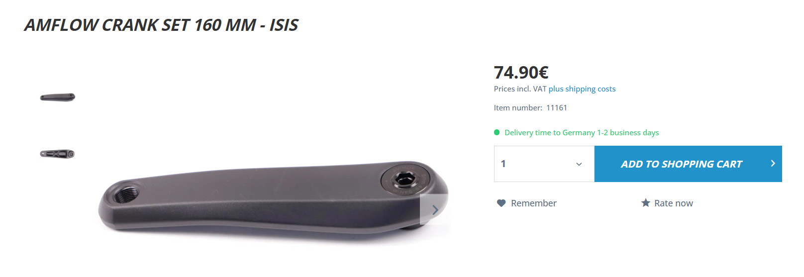

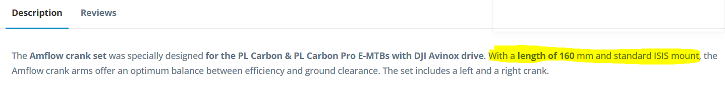

I assume we need a 104 bcd chainring given a spider is provided? Im curious about cranks too (my gen 5 is my first emtb). Will any ISIS crank work? Only companies I found that advertise dji compatibility are ethirteen and praxis.
Can anyone shed some knowledge?
I run the MOTSUV Alloy chainrings. Have done on my last 3 EMTBs. At AUD$9 delivered, I just change them when I change the chain. So normally around the 1000 - 1500km mark, but none have actually been badly worn when I change them.
I get nothing but grief when I tell people what I pay for these chainrings. But they have been bulletproof for me. And I love my technical climbing, so they get a serious workout.
Not expecting anyone riding a Crestline to fit these. But they do work well with the DJI and SRAM Eagle Transmission Systems in my experience.
I don't know the specs of a standard ISIS crank. All I can tell you is the retaining bolt is about 15mm in diameter. But all documentaion I have read seems to suggest the Amflow Crank is just a standard ISIS spec.
