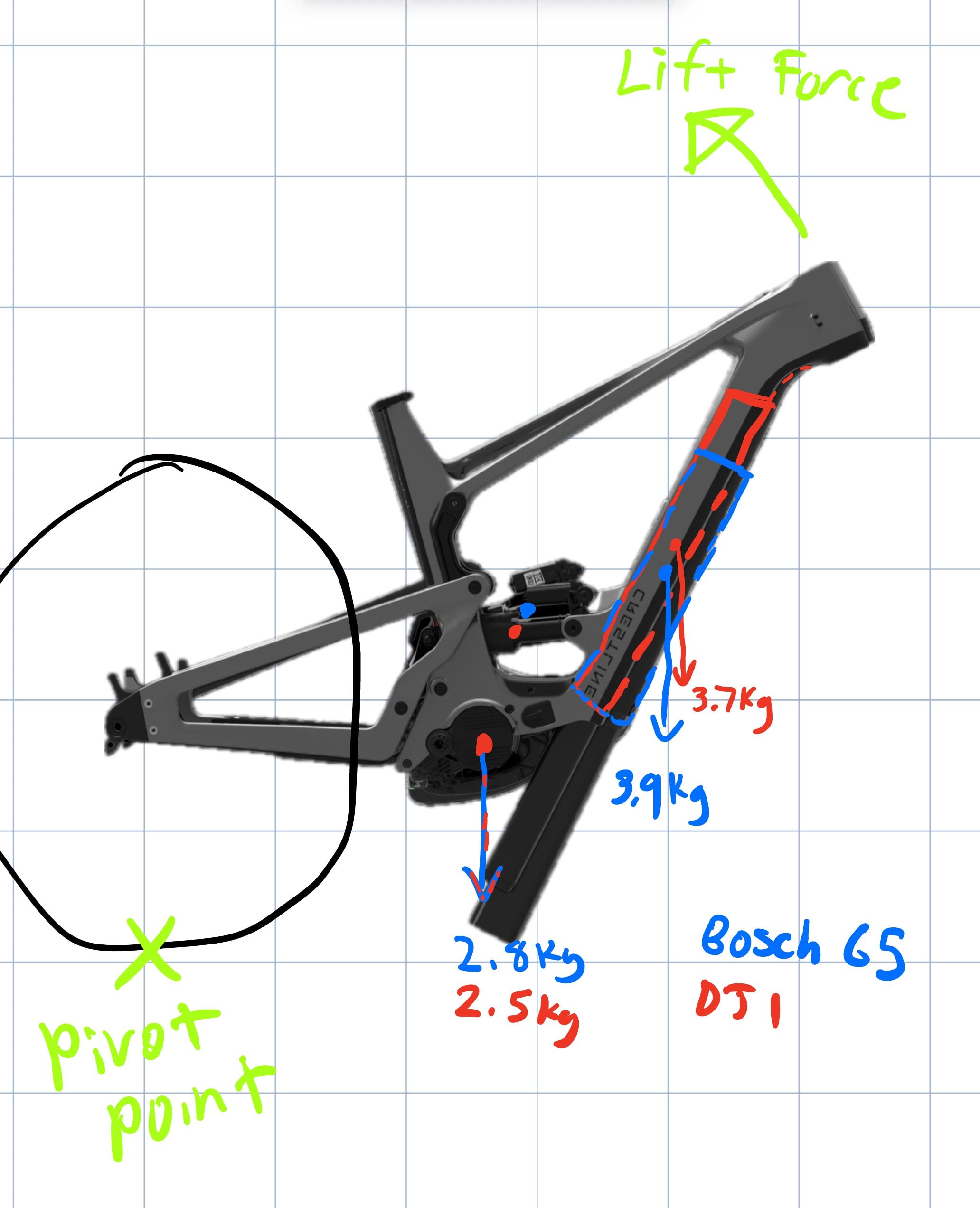

I agree, it does make a difference but it might not be as big or noticeable as you think.
Torque = Force X Distance
i overlayed a DJI bike with a Bosch bike (sadly their website has a medium frame DJI and a large Bosch so the images don’t line up perfectly but you get the idea.
The difference in weight around the pivot point is pretty much a wash when you consider the 5mm difference in chainstays, (440 on a medium as opposed to 445 on the Bosch), heavier battery, heavier motor and higher Shock location. Also notice the DJI battery is located at the top of the downtube, that also helps shift the COG back a bit.
You can make a bigger difference to the weight of the front end by either shortening the chainstays further via dropouts or lightening the front wheel up a bit by going with DD tires as opposed to Gravity. Or swapping out the 225g 2.3mm TRP brake rotor with a 160g hope rotor since that’s the furthest point of mass from the pivot point!!!
Perhaps a lighter carbon front wheels and carbon bars will help too. A DH fork with Gravity tires/wheels and cushcore is probably a lot worse than going from a 400 to 800wh battery in terms of front end weight.

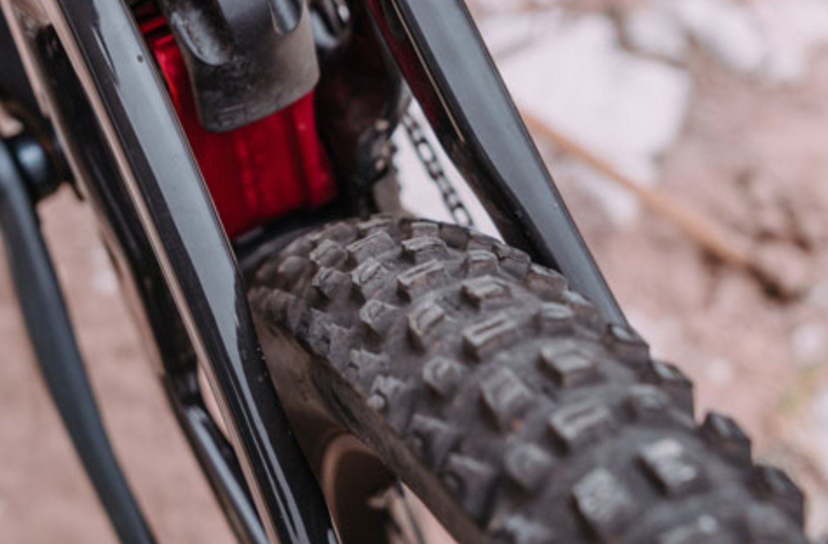

On a side note, rear wheel tire clearance was an issue with mud on some reports. Does anyone know if they fixed or widened the chainstay on Gen 4?

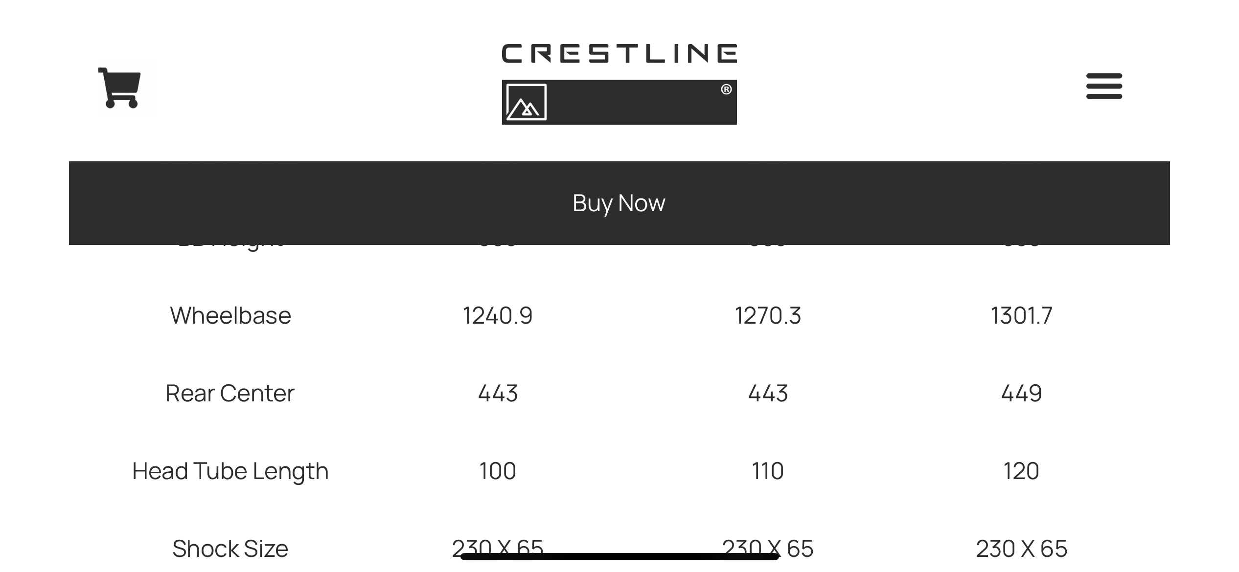

Does anybody happen to know what the default adjustable dropout length is for a MX RH3? I can’t find this on the website, it just states the following:
“Each frame ships with the recommended dropout and wheel configuration based on size.”
Likely 445 since RH2 is 440. You’re right, this information is now missing from their website…
Yeah it listed this info then you choose what size to order. Now just: “sold out”
The RH4 recommendation was 450. So I would agree with 445 for the RH3

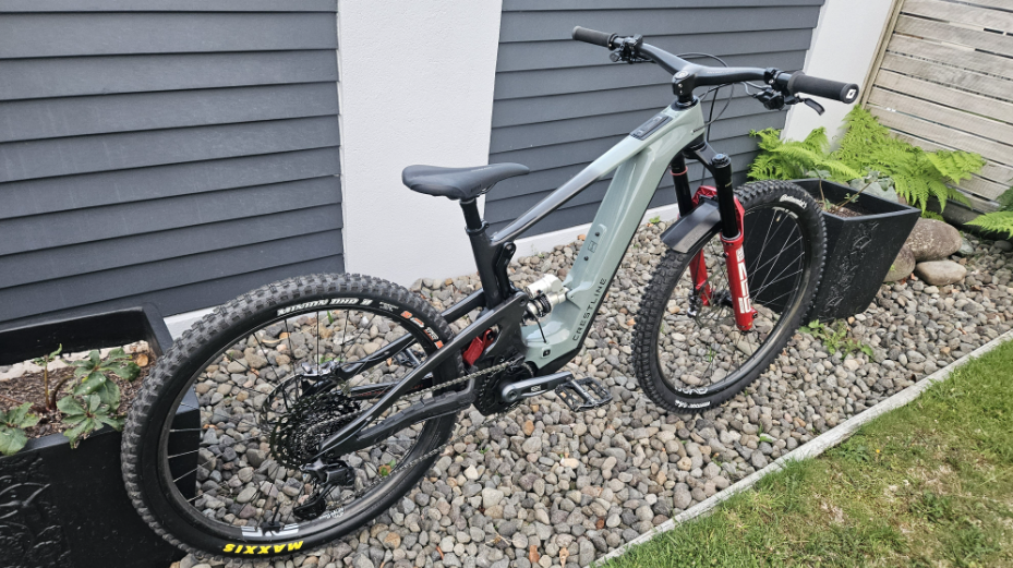

This pic is the previous Crestline
Good write up. I agree with your hypothesis other than the longer battery makes front weight bias worse rather than better.
