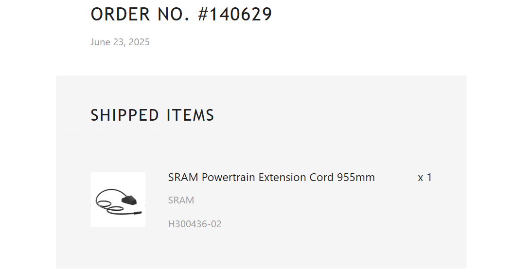

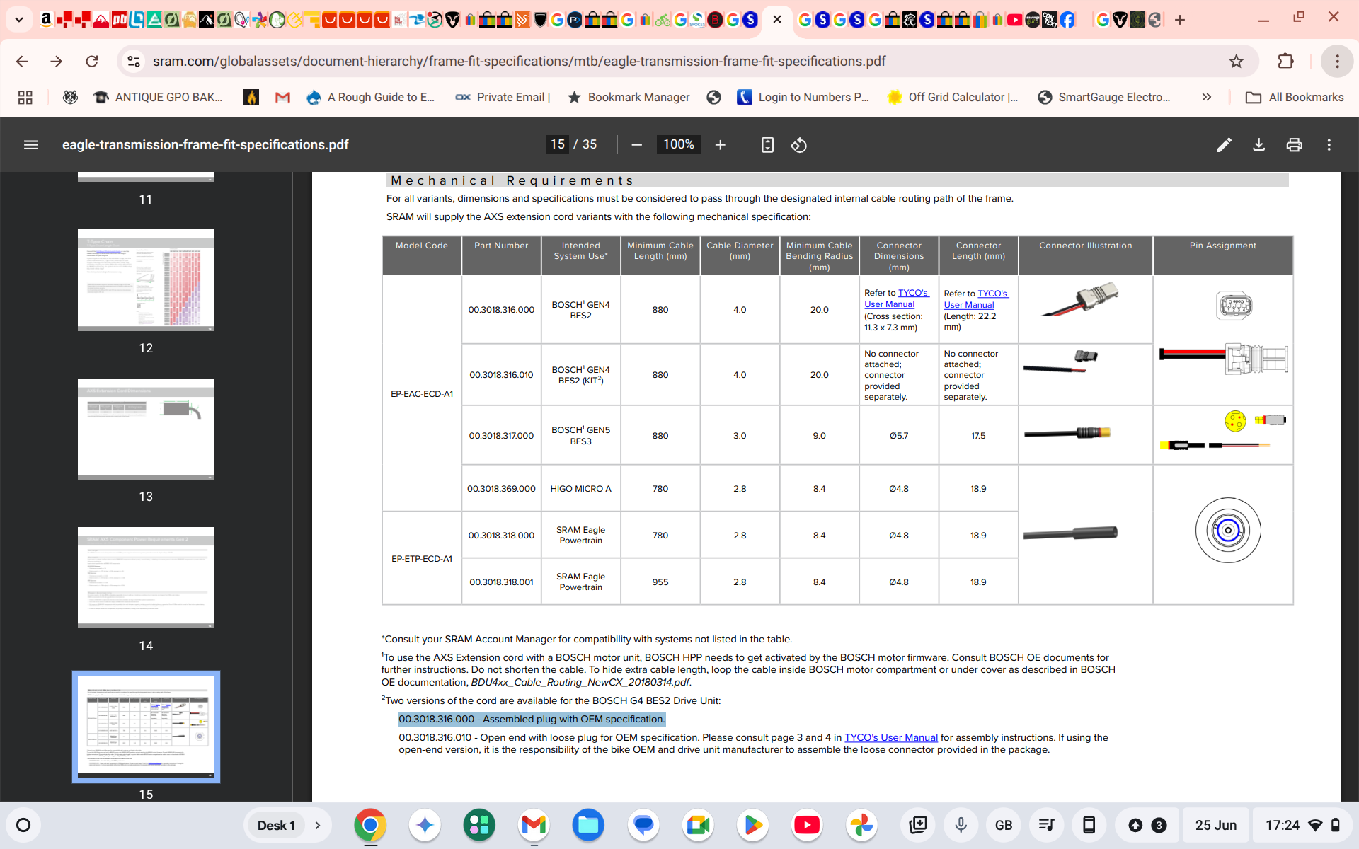

I hope you didn’t order SKU: 11.3018.028.001
Which was the attachment you added in this thread to order from FanaticBike.
That one is for SRAM and Bosch motor plug, NOT for DJI.

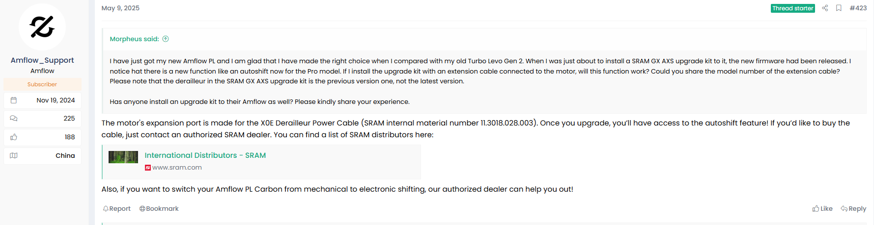

AMFLOW support mentioned 11.3018.028.003 was needed, and the only difference I can tell between that .002 and .001 is length. What's the correct product code?

So I don't keep spreading bad info... do you have the exact product code or anything like that for the SRAM/DJI wire? Much appreciated!
I do not. My bike came with the cable so I don't know the part number. All I can do is post the Amflow Support reply to someone asking about the cable.

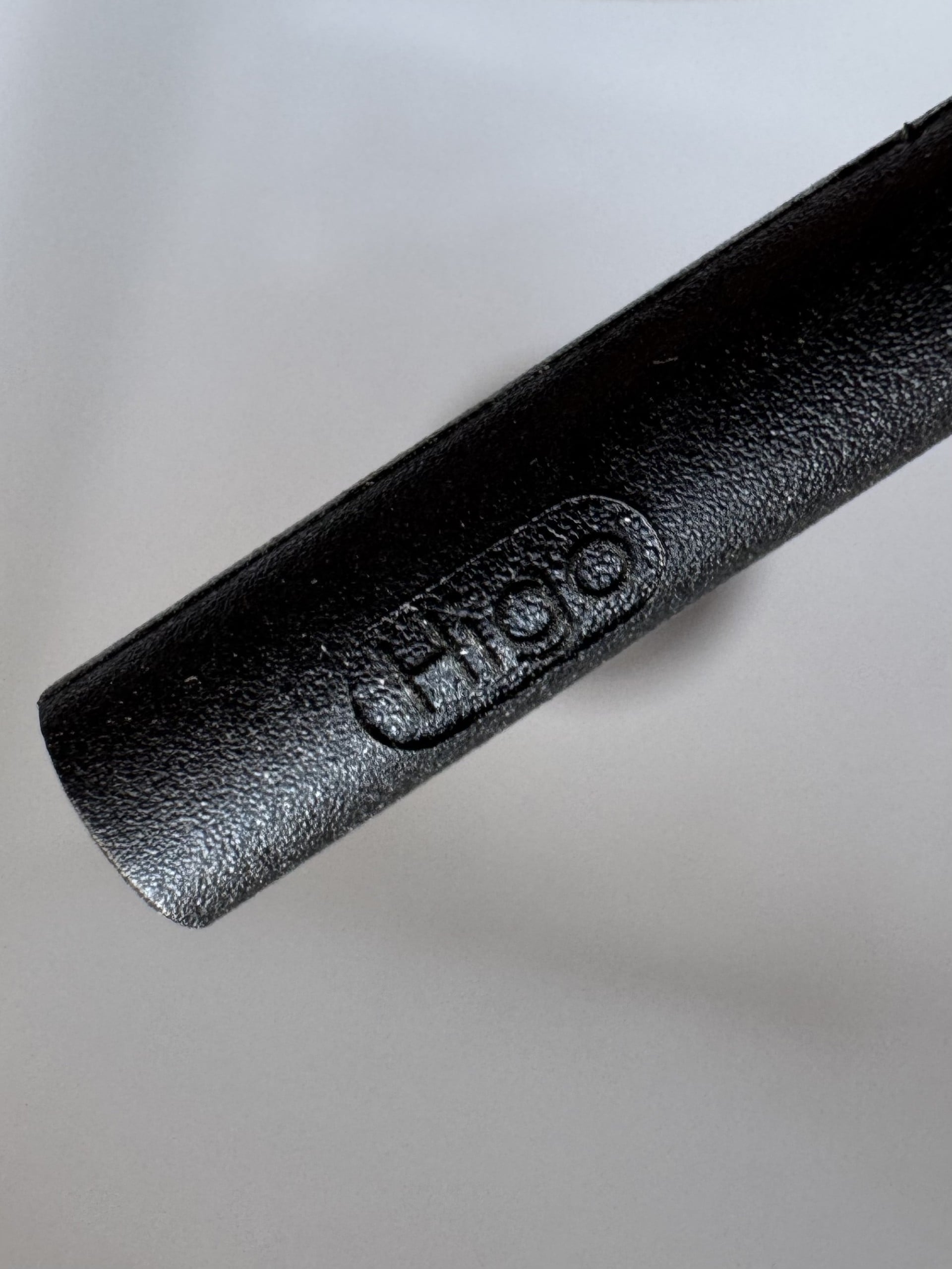

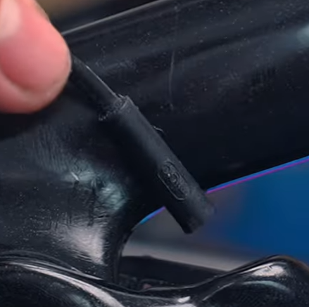

And here's a photo of the plug that goes into the motor. It does look different to the one in the photo in your order.
Higo Micro A is the correct plug.​
My current MX Crestline would require over 900mm length.
I’m not able to fine a 955mm with this correct plug in stock in the US or even in a country willing to ship to the US.
Some website reuse photos between SKU's of similar products so it can be misleading. I dug REAL deep yesterday and I'm 98% sure I have it straight. 11.3018.028.003 is the only cord to have the Higo Micro A plug, which is needed for DJI. It's only 780mm. The other similar SKU's ending in .000, .001, .002 have connectors for Bosch or Eagle Powertrain, which is Brose and have varied lengths available for those motors.

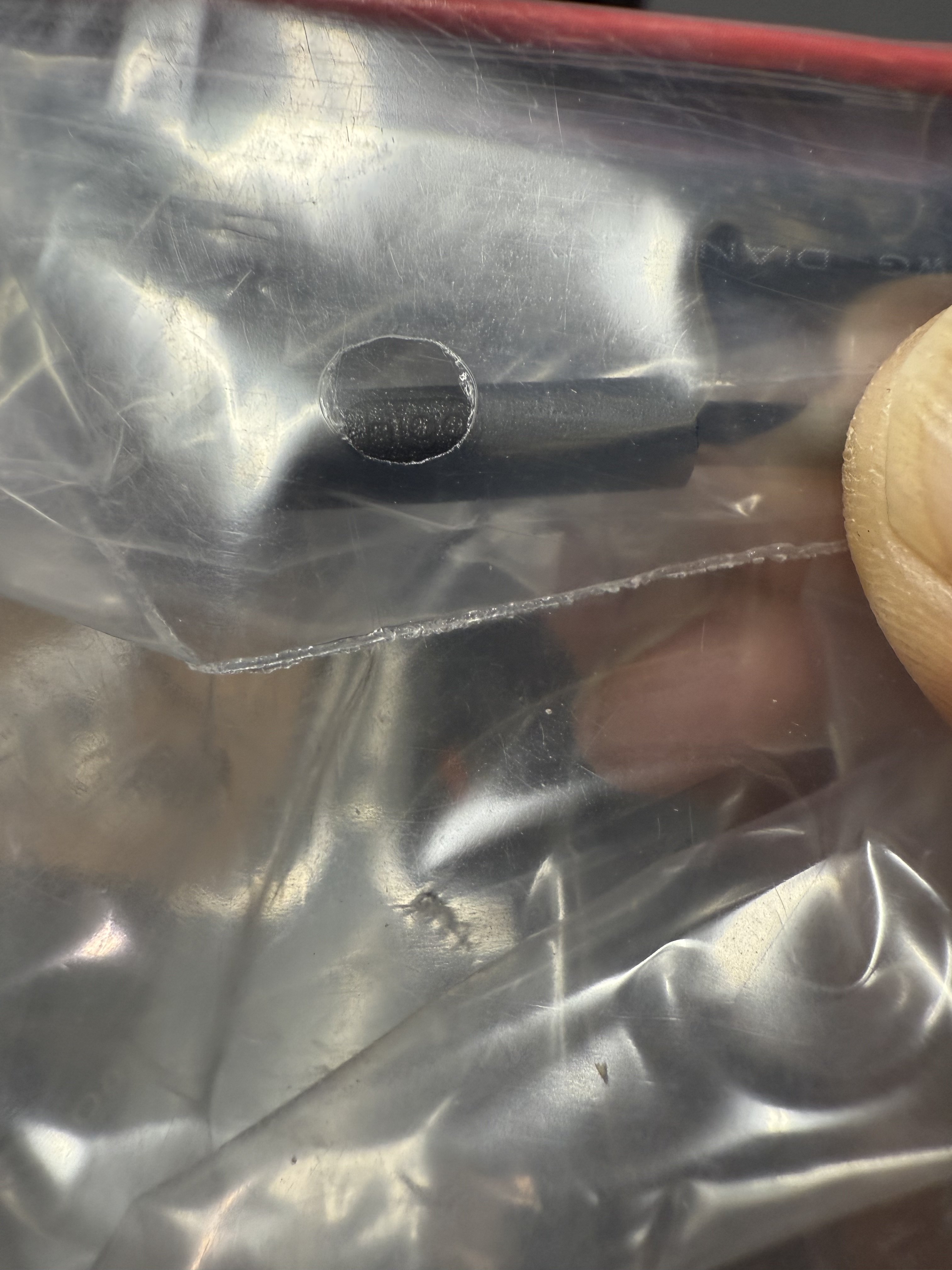

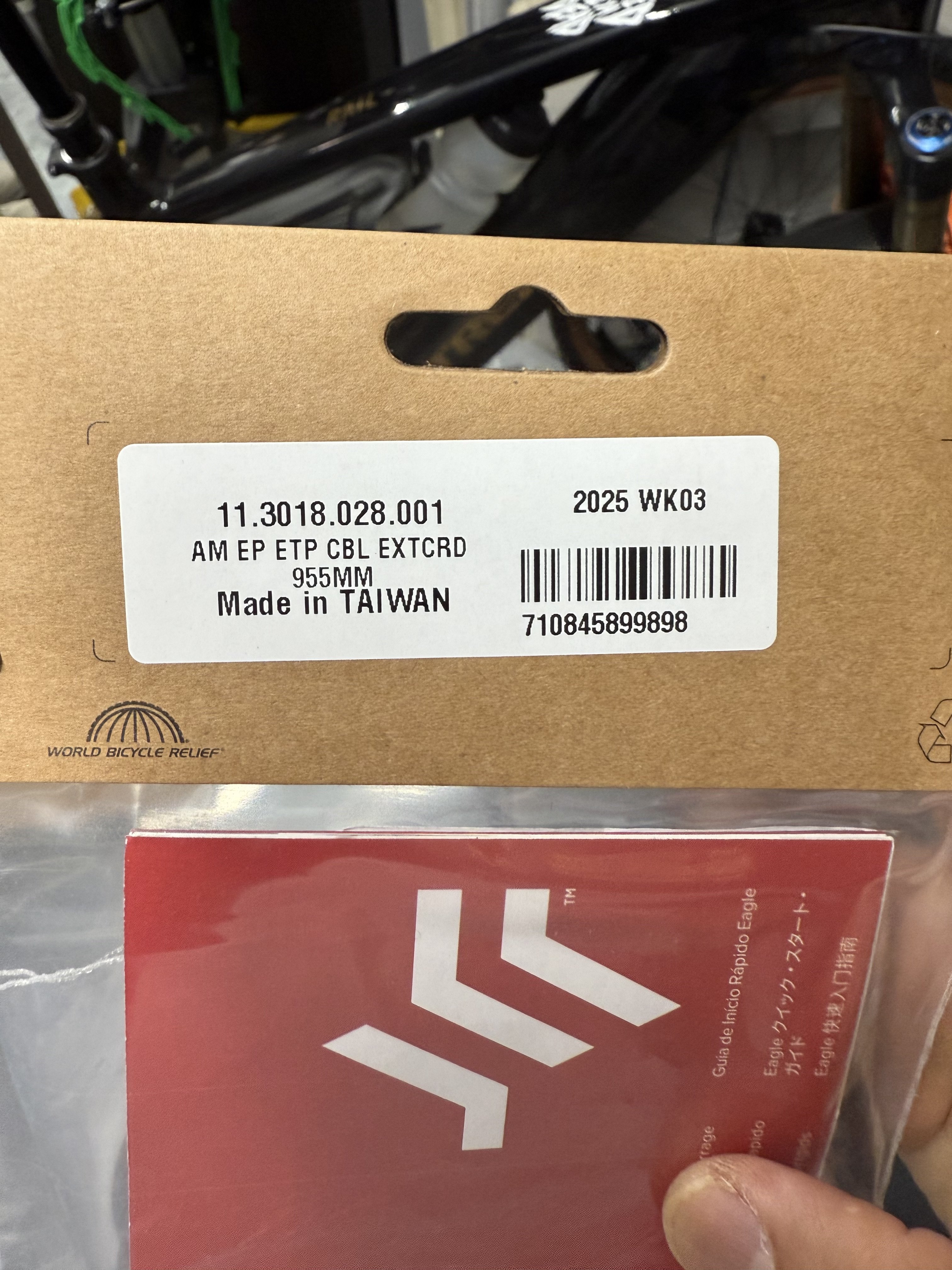

Well, I'll be a monkeys uncle. Sram Power Train (Brose) uses a Higo A connector so the extension cords for that unit should work with the DJI. Brose also has the Coast Shift, which is like Autoshift... pic of the connector for my 11.3018.028.001 that arrived today as proof I'm not posting only worthless posts.

Well, I'll be a monkeys uncle. Sram Power Train (Brose) uses a Higo A connector so the extension cords for that unit should work with the DJI. Brose also has the Coast Shift, which is like Autoshift... pic of the connector for my 11.3018.028.003 that arrived today as proof I'm not posting only worthless posts. View attachment 163123
Lion King….got it 👌🏻
So your packaging is labeled .001 or .003? And what length again?
