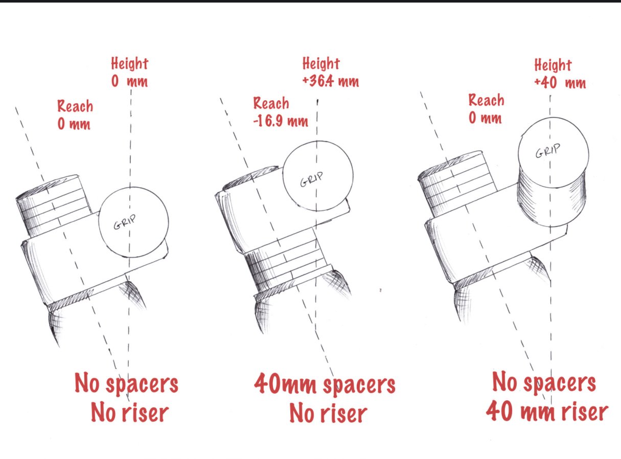

If you're trying to lengthen reach higher rise bars are only going to shorten it (unless the roll is forward). The new, higher Renthals over 40mm rise have a 2 degree higher back sweep, pushing it back too. Just FYI.

Agree on new rentals being more backsweep. Unfortunate if trying to maximise effective reach.
My goal is to achieve a bar height from the floor of around 113cm. If I ran the same bar angles, but a lower rise (say a 35mm) and wanted to achieve the same 113cm ground to bar height, I’d have to run the bar higher on the steerer and would lose effective reach.
If using the same bar angles but the only variable is rise, then you can maximise effective reach by running higher rise, and placing the stem lower on the steerer tube.
No doubt, I agree with you. The variable here is bar roll forward and back. There's certainly the factor of preference but if the bar is rolled forward with the rise perpendicular to the ground you lose the full dampening effect and horizontal back sweep Renthal engineered into the bar. End of the day, your bike, you do you. Looking forward to the completion of the build.

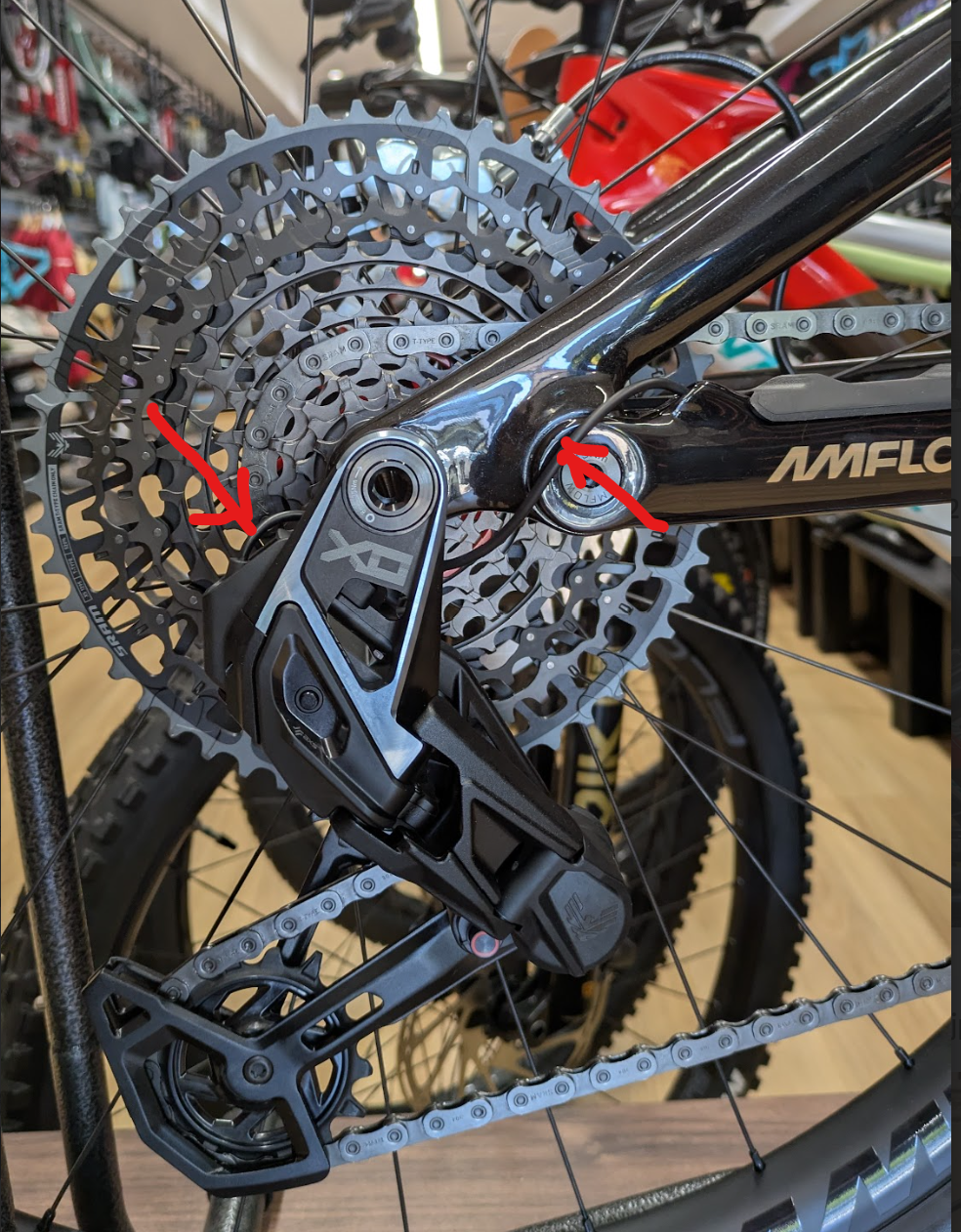

That's fair enough. It's just the SRAM Wireless interfaces with the DJI motor so well. I absolutely love the the Smoothshift, where it indexes the chainwheel for you without pedalling. I use that all the time. It just means I can remain perfectly balanced, and still shift.
Also the chain protection software, to back the power off at the instant of shifting. I have watched a few videos where people have snapped the chain on shifting.

Yes it does. If I'm stationary, and I lift my rear wheel and push shift up or down. The motor automatically rotates long enough for the derailleur to move the chain onto the newly selected gear. Obviously this also happens when you are riding.

Only with the SRAM Eagle Transmission. So yes the AXS T-Type. Supported electronic rear derailleur models are: XX, X0, GX, S1000.

It's setup in the Avinox Ride App. So most likely a DJI Avinox Motor thing. But I cannot confirm that.
Unless AXS T-type is hard wired to the DJI motor, DJI doesn't know the bike is shifting and therefore can't adjust power.
I mean I guess it could be reading the wireless protocol signal.

It does exactly this when it’s hard wired, it knows when the power draw is taken to the AXS mech and can adjust the motor power at the exact time.

Hardwired it is. I'm guessing some sort of BUS system in the hardwiring, probably serially coded over the 2 wire power, like RS485.
