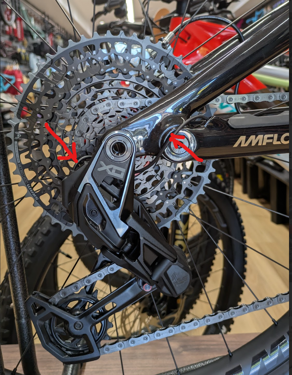

Question is, do you heed to split another power cable or are there extra plugs on the DJI?
I always figured that SRAM extension cord was to only supply power to the derailleur off the ebike’s power supply, not being a communication wire as well 🤷🏻‍♂️

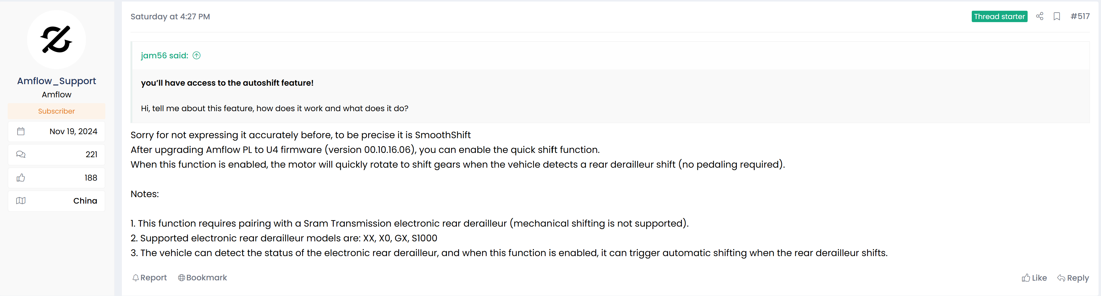

Amflow Support confirms this ability.

100% needs a hard wire. Confirmed with DJI

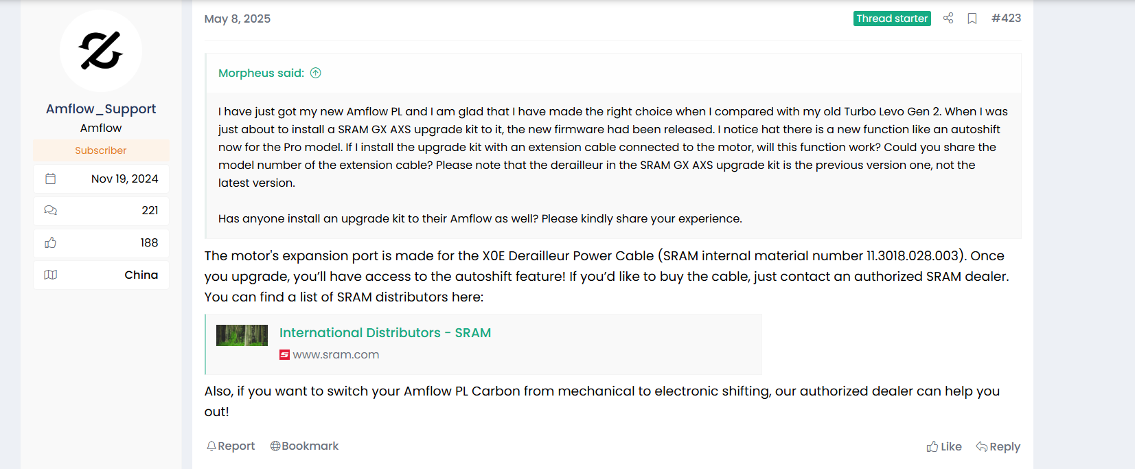

THIS is now the last of it... confirmation from the hoarses mouth on both needing to hardwire the deraileur power and there being a port on the motor. Not that I didn't trust you guys, but....

do you REALLY think SRAM is giving other companies access to their proprietary wireless communication protocol?
Hardwired it is. I'm guessing some sort of BUS system in the hardwiring, probably serially coded over the 2 wire power, like RS485.
No BUS! Detaileur must by wired to motor to be powered thru deraileur cinnector on dji motor. Works with any deraileur which is connected and powered from motor! When you shift, power from motor conector goes to deraileur, this is signal for system to turn motor few turns for shifting. No magic! Works also with old (non t-type) axs, prooved!
