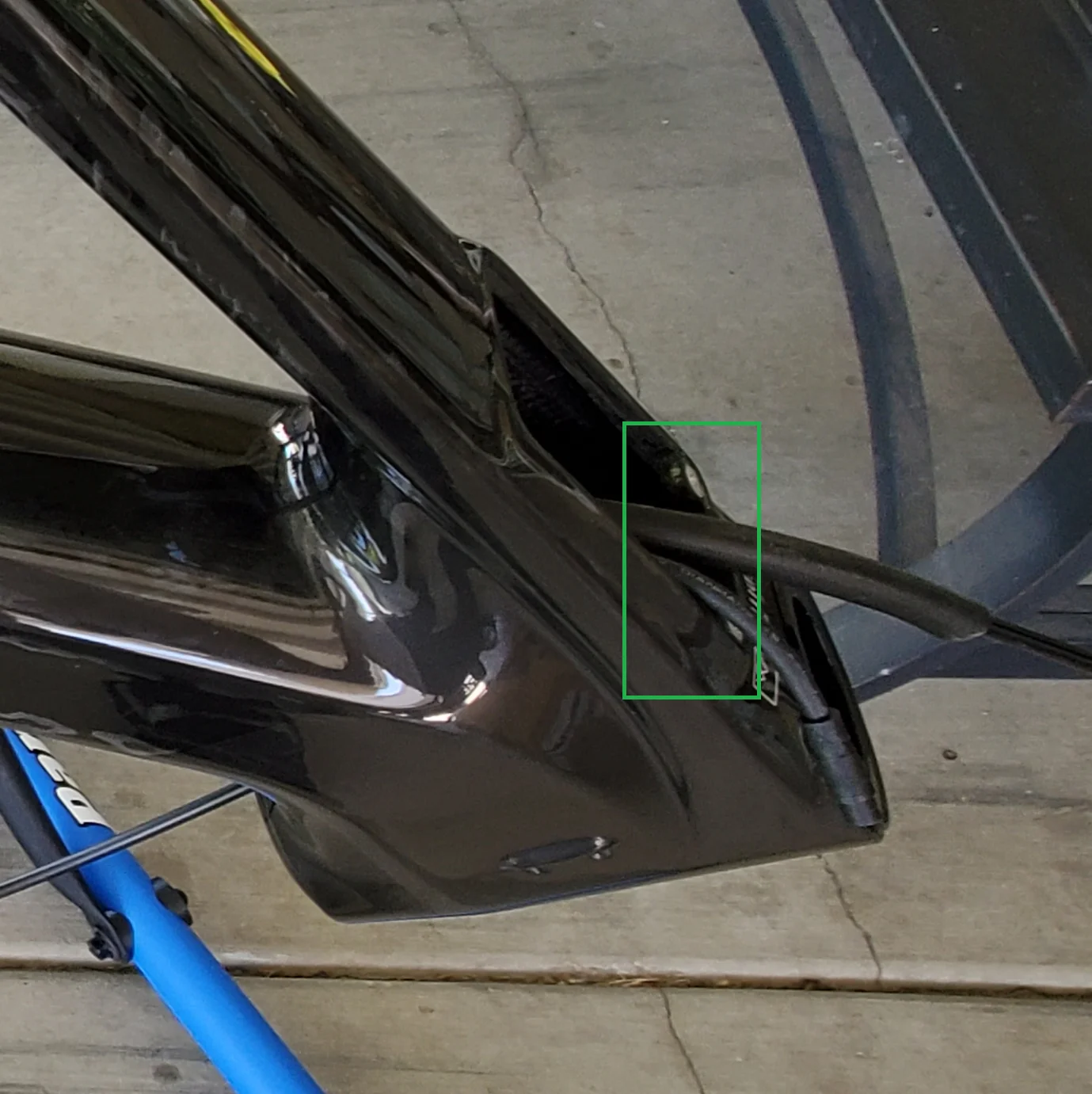

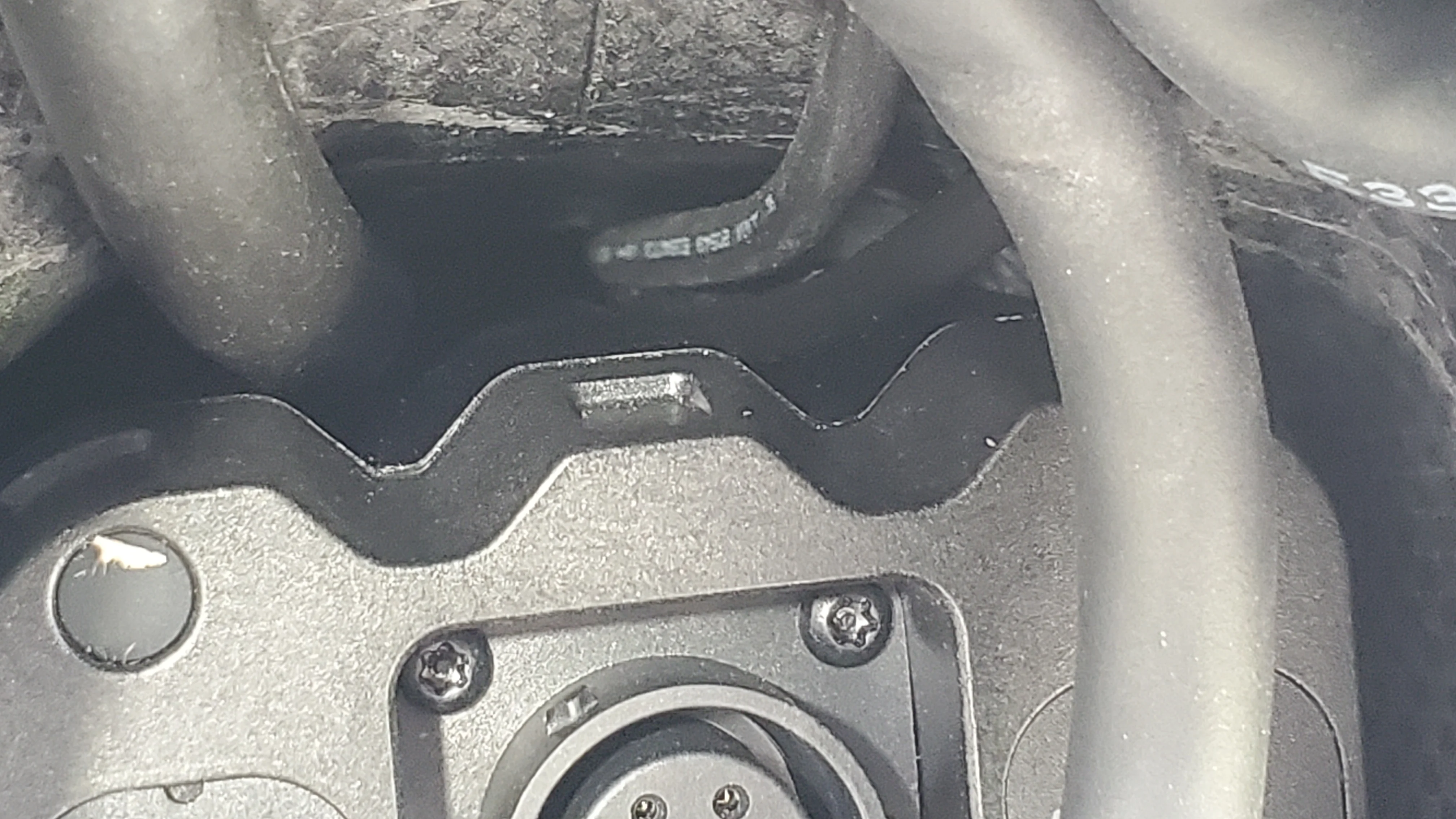

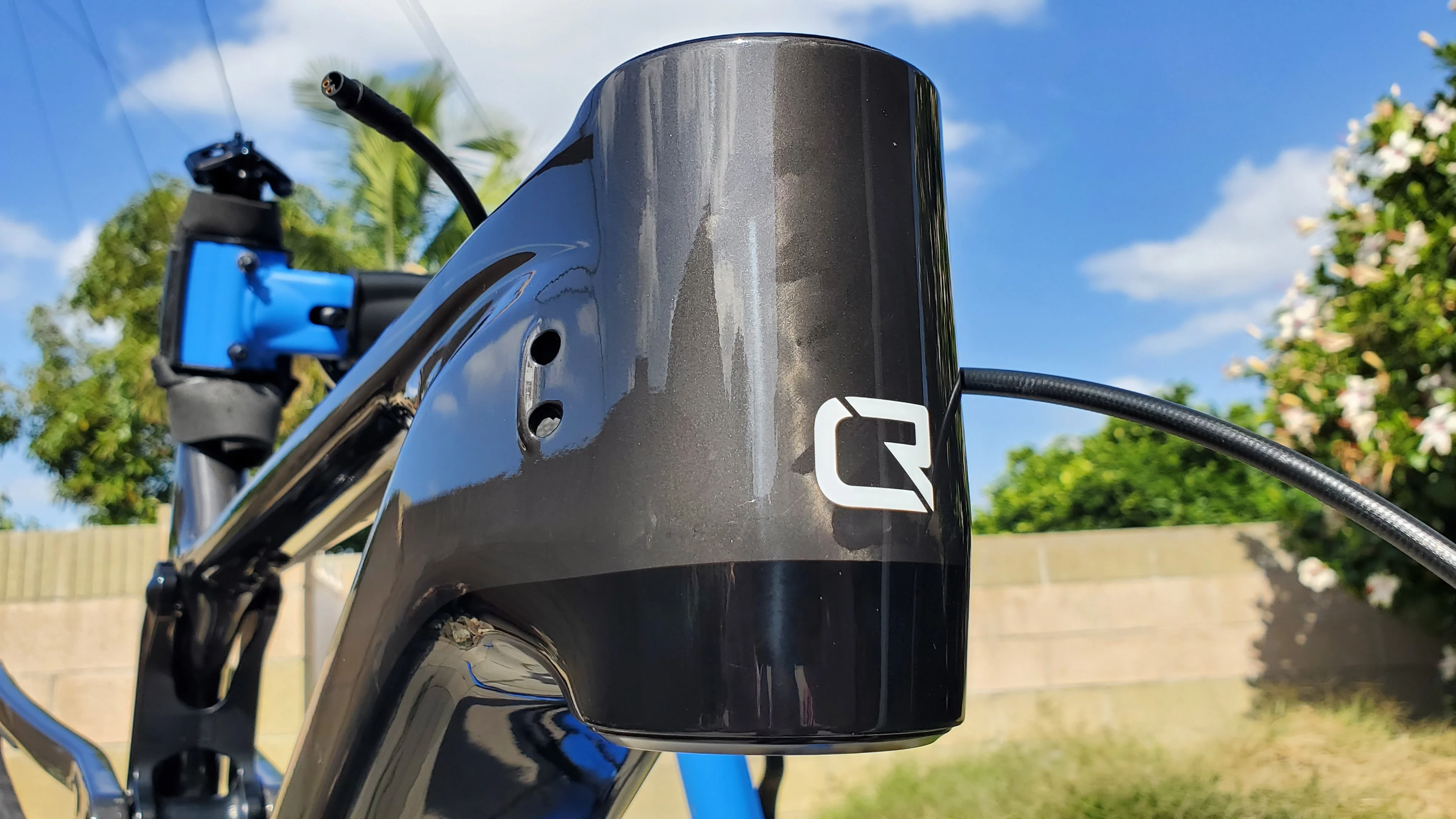

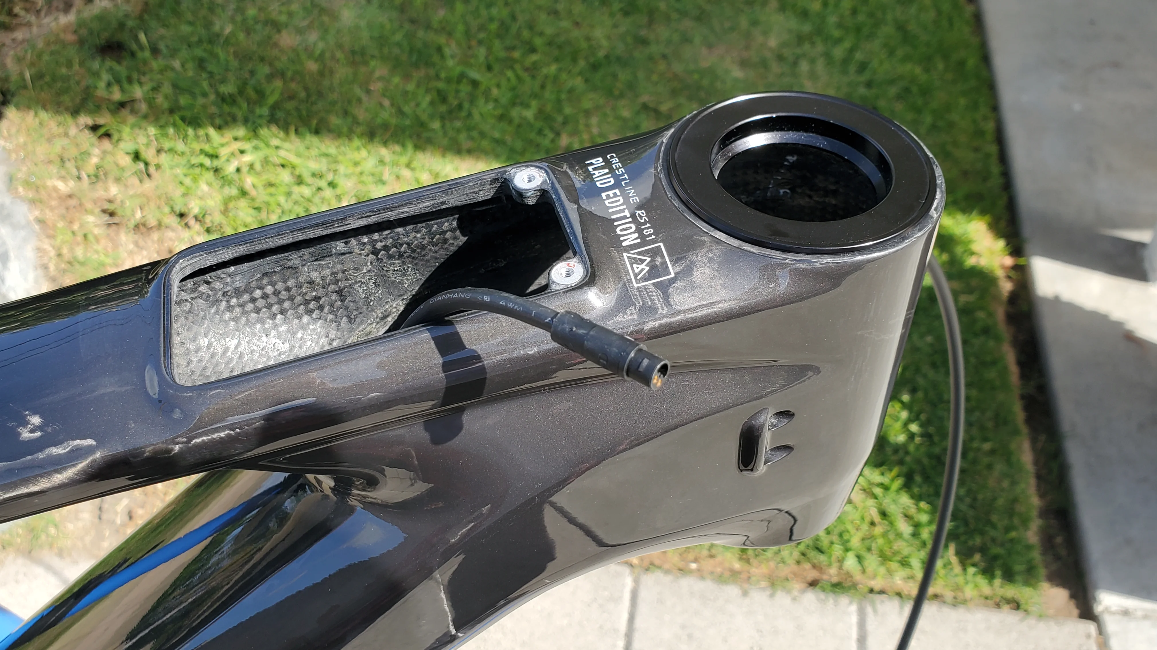

Mud wise, interested to see feedback from 181.1 owners to see if it is a real issue?
Someone in the crestline fb posted a photo of a ton of mud jammed up in there.
It’s just a weird open window. I wonder what the purpose is. Go check out yeti thread and see how much mud gets built up in their motor area. I also just don’t want to get it wet if I don’t have to. I wash my bikes often (I know some of you don’t but mine get messy.

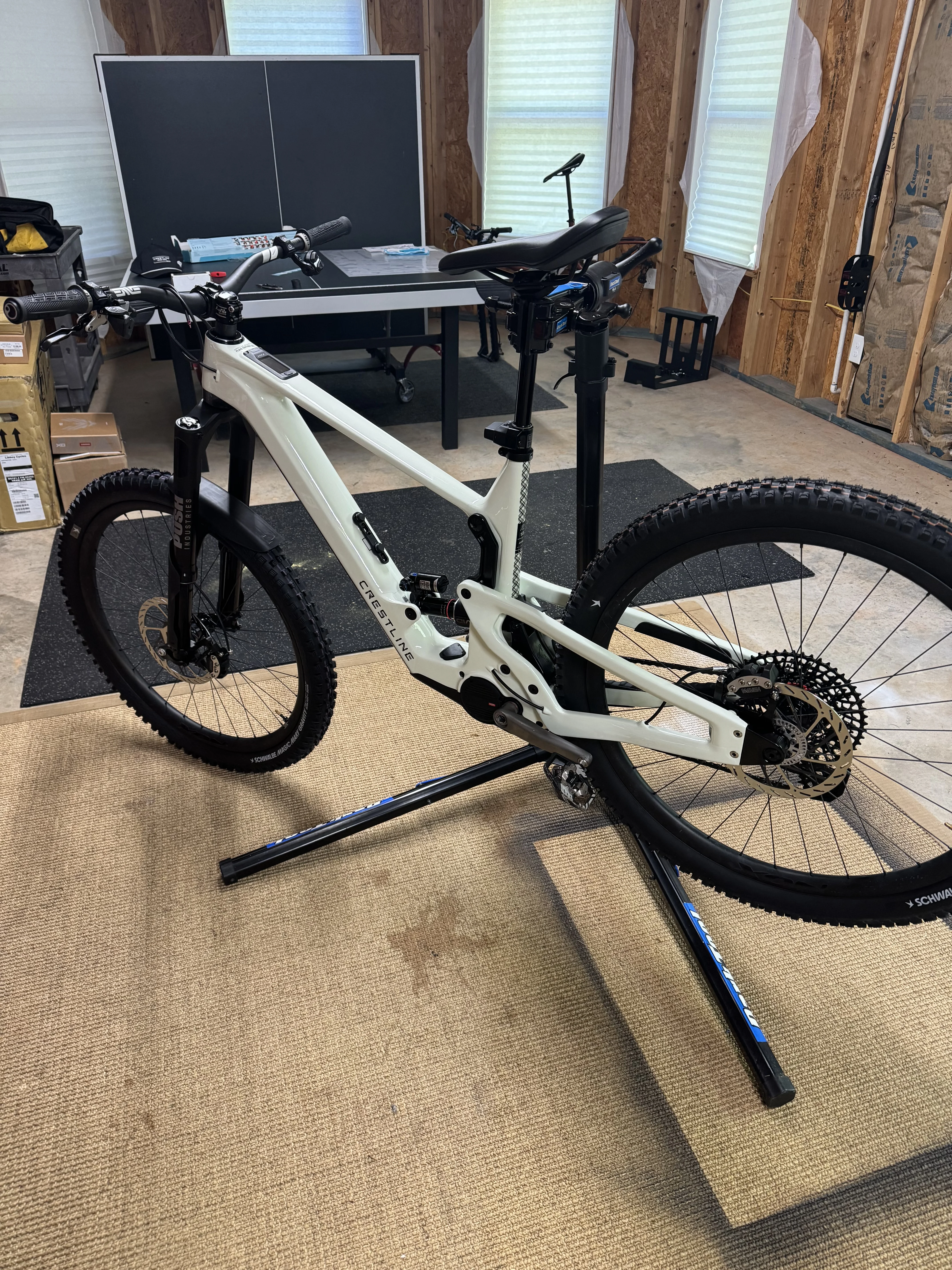

I like to "take my time" with a new build bonding with new components and unleashing their potential with a turn of the wrench! But things are underway of course..

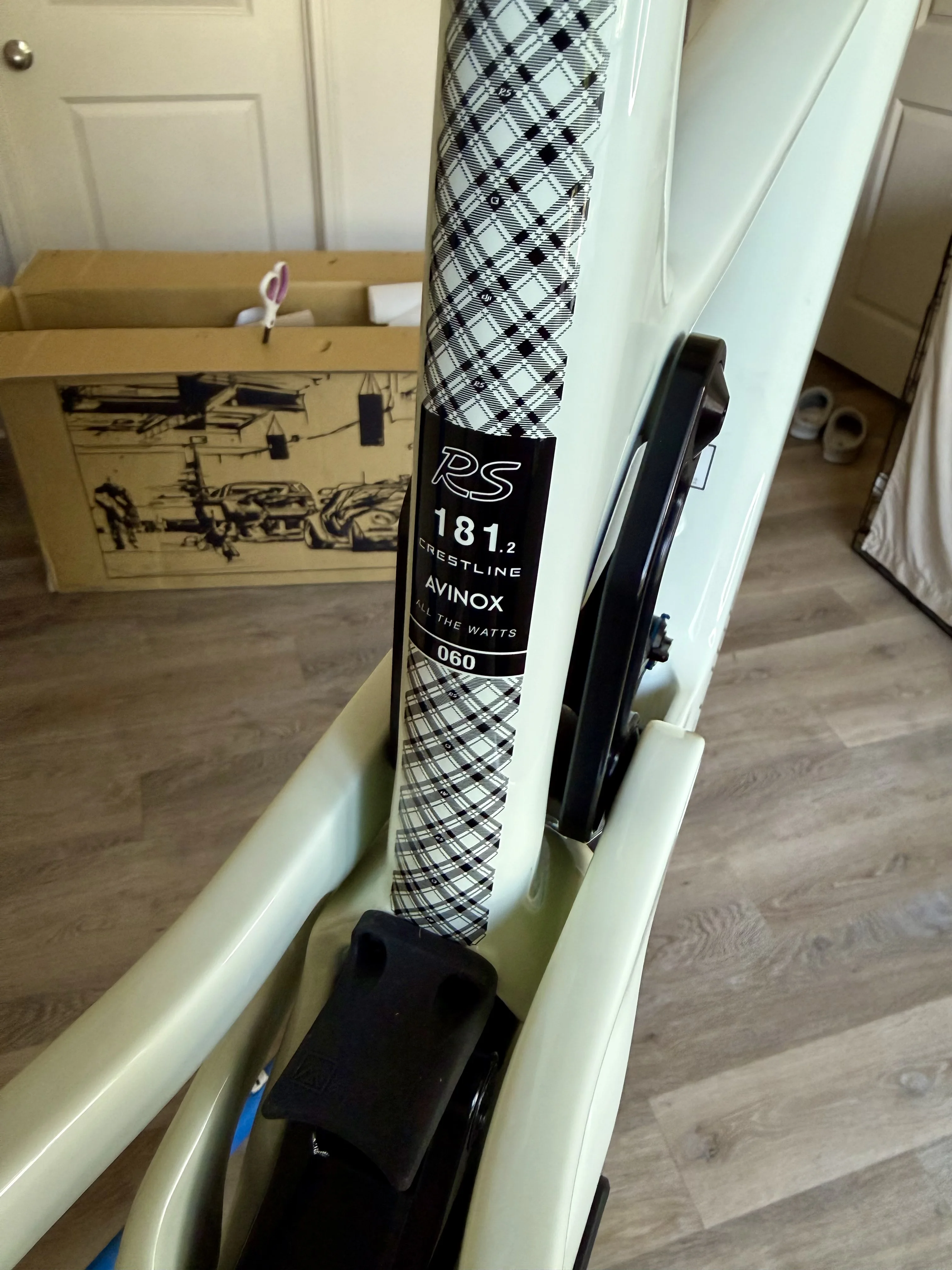

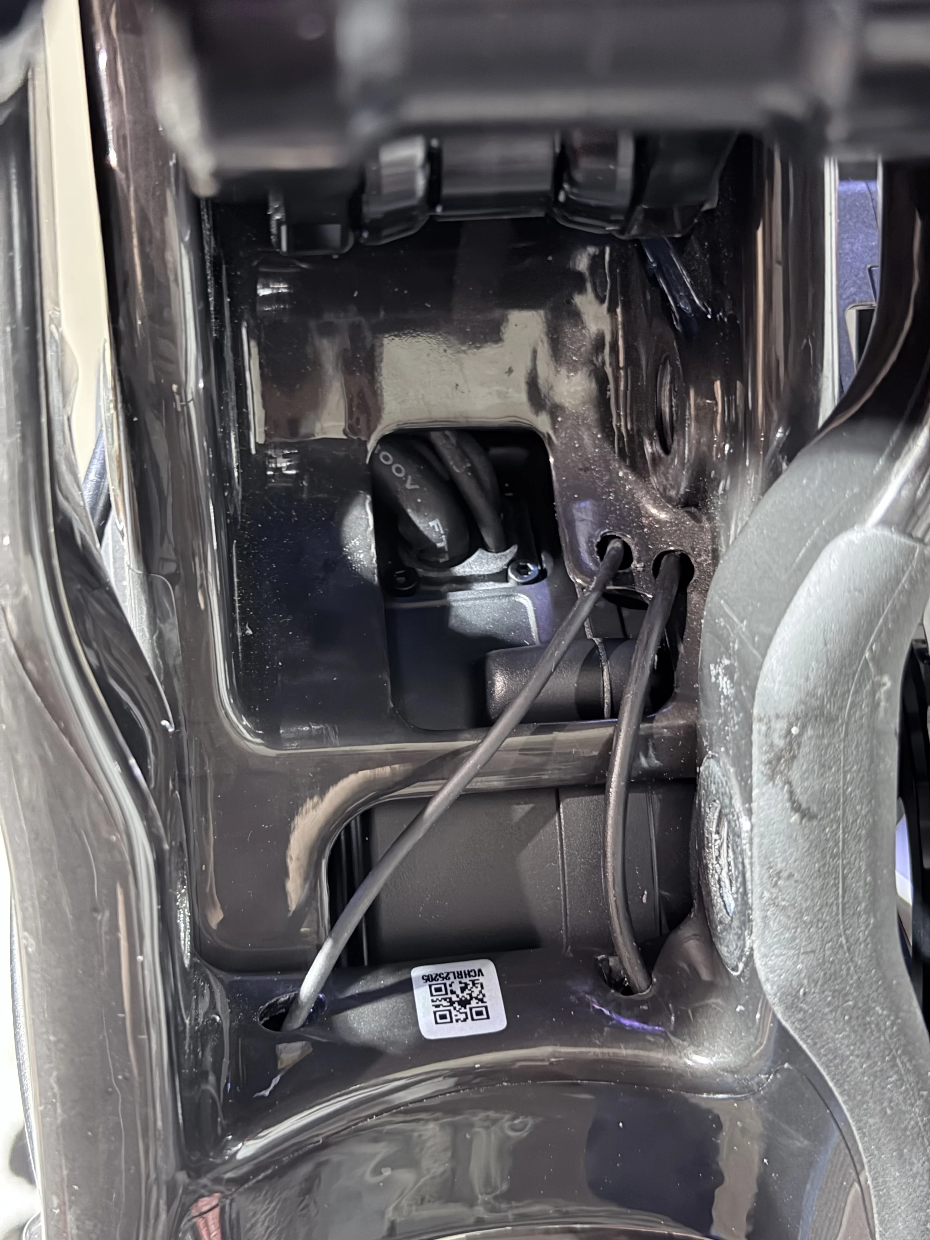

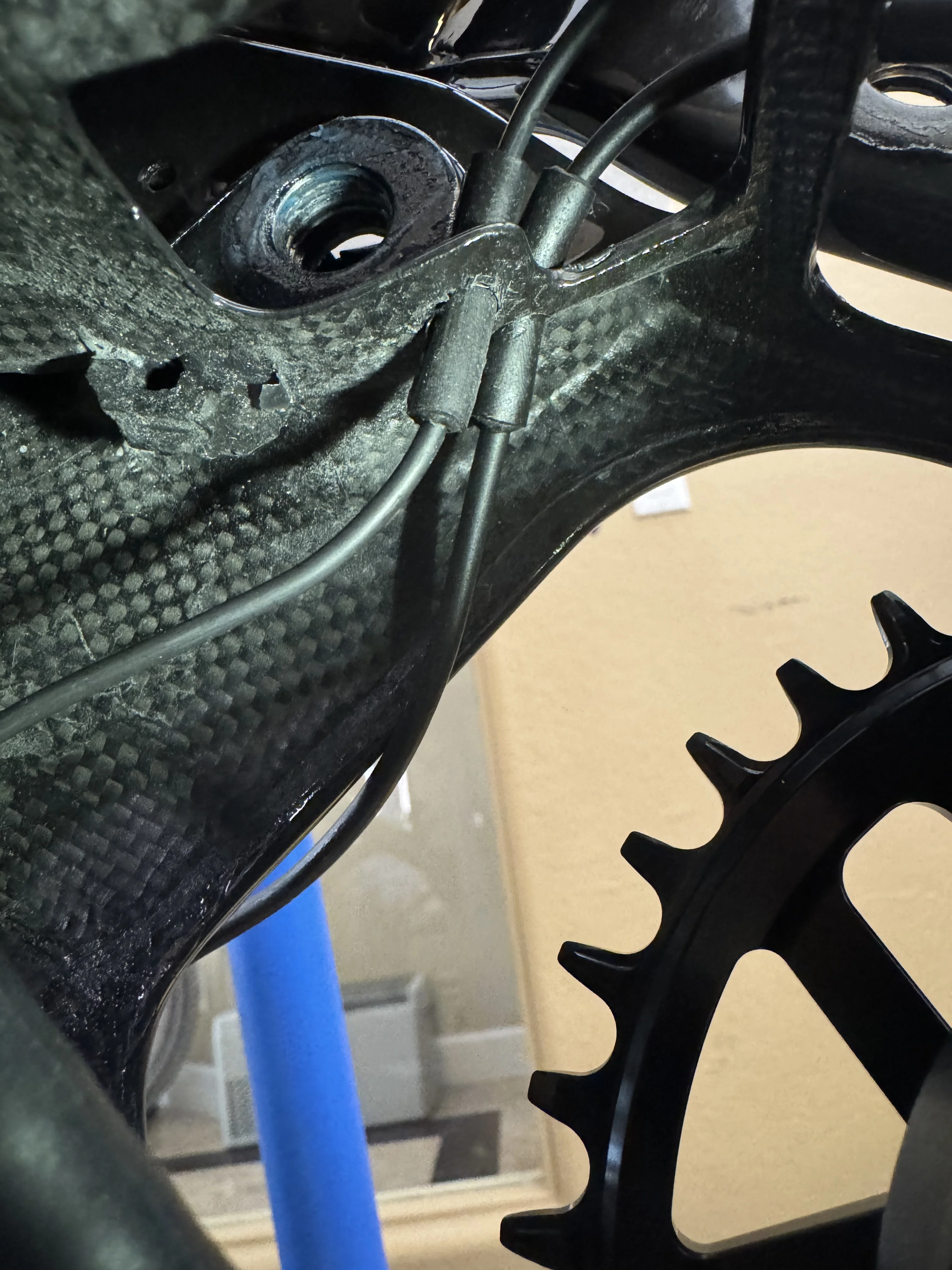

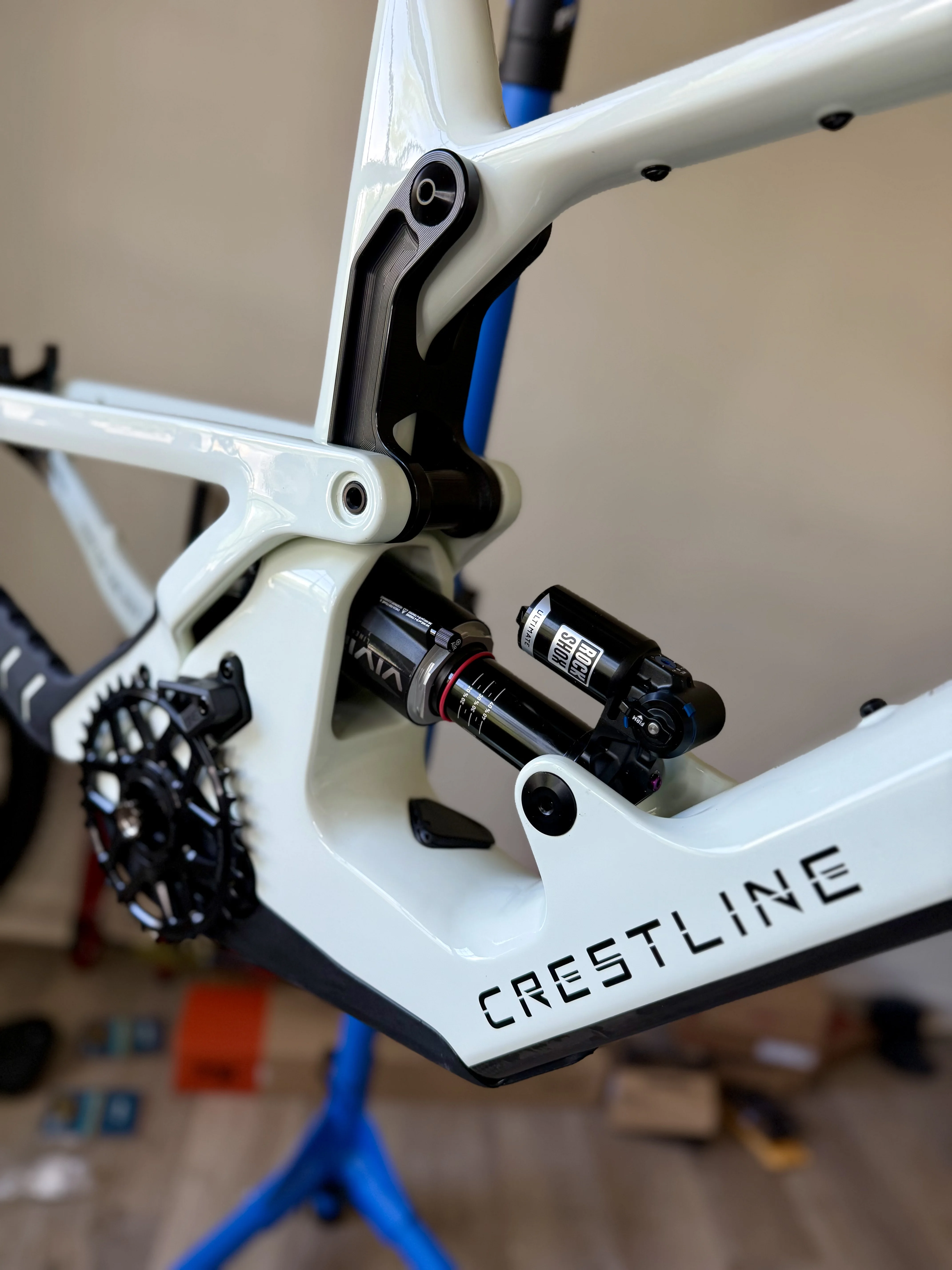

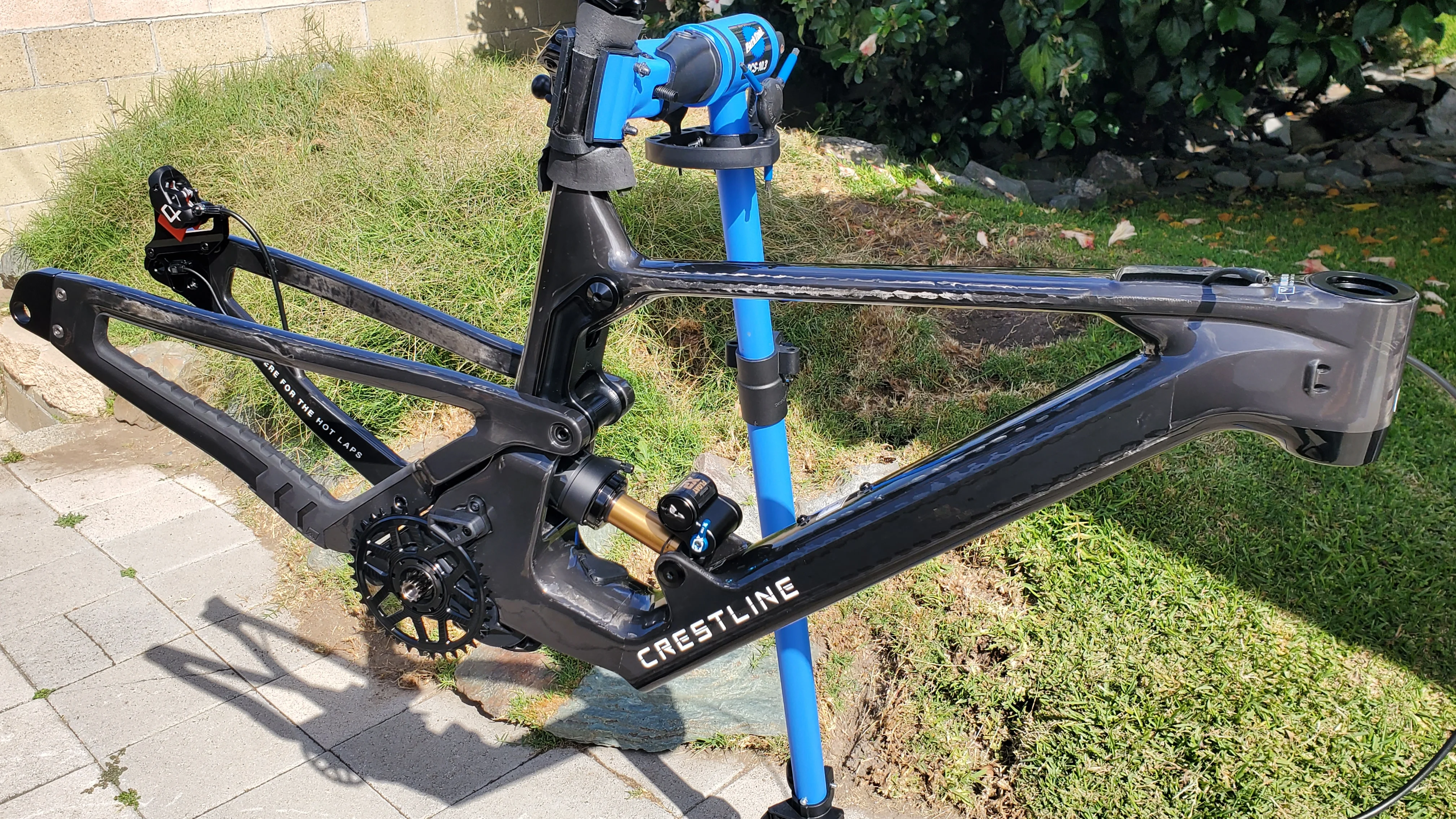

Step 1 - Got the rear brake installed loosely to "root the cable" per the build video. I pulled my 600 battery out and used the left side routing tube built into the frame as T suggested is the way for RH2's, use the 2 guide tubes.
Slipped right through with some gentle wiggles and twists when needed.

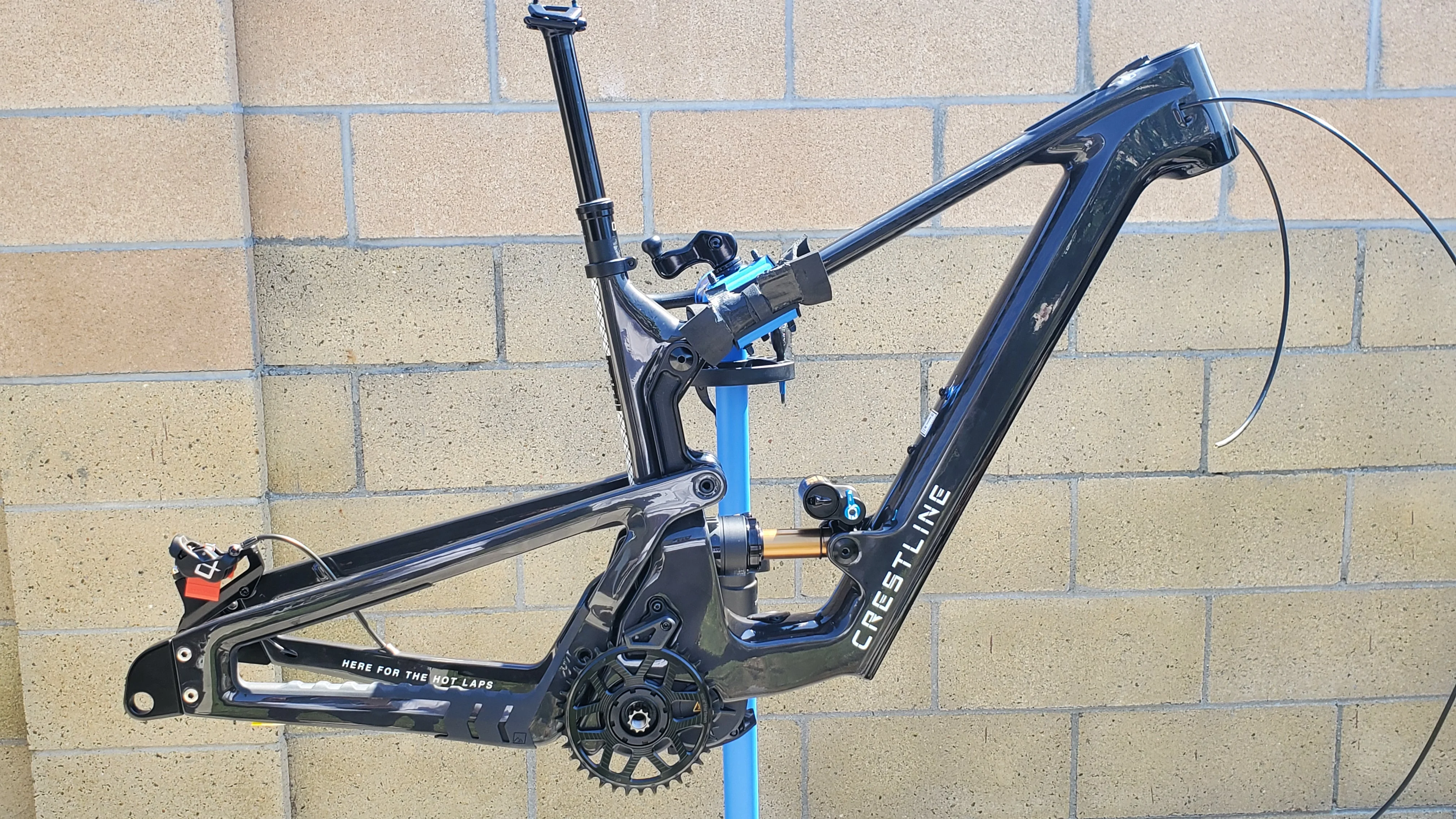

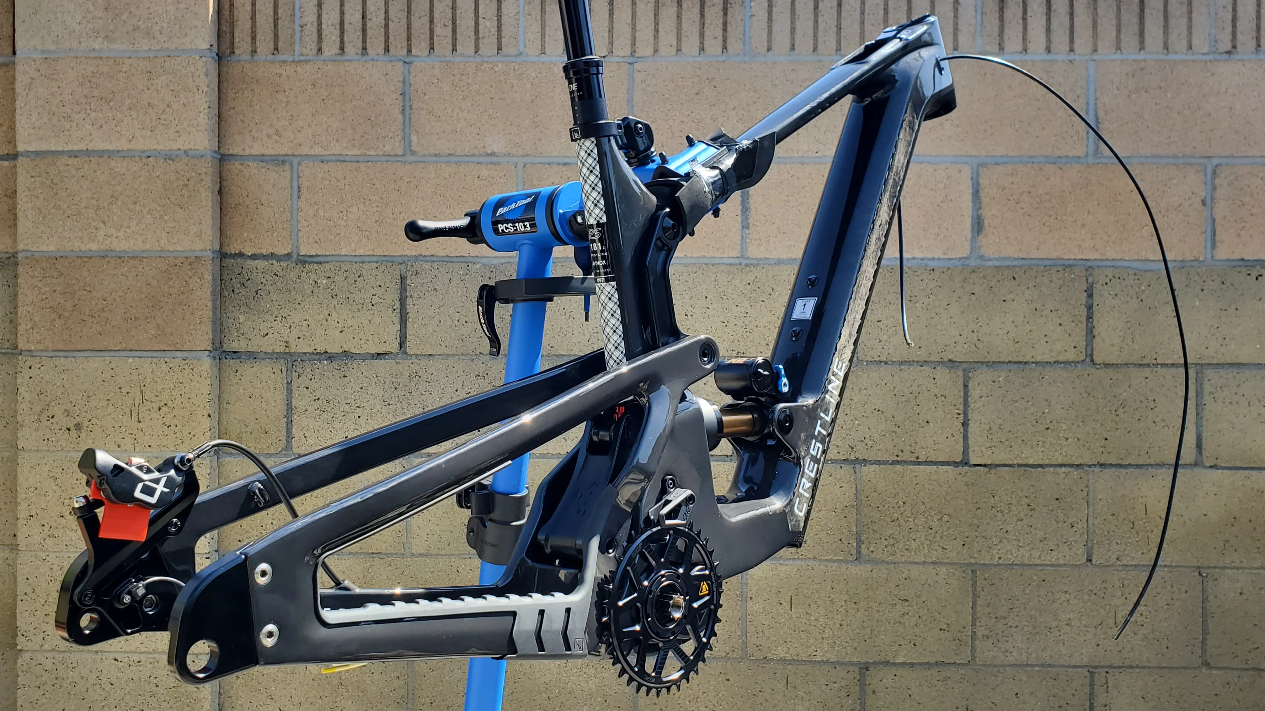

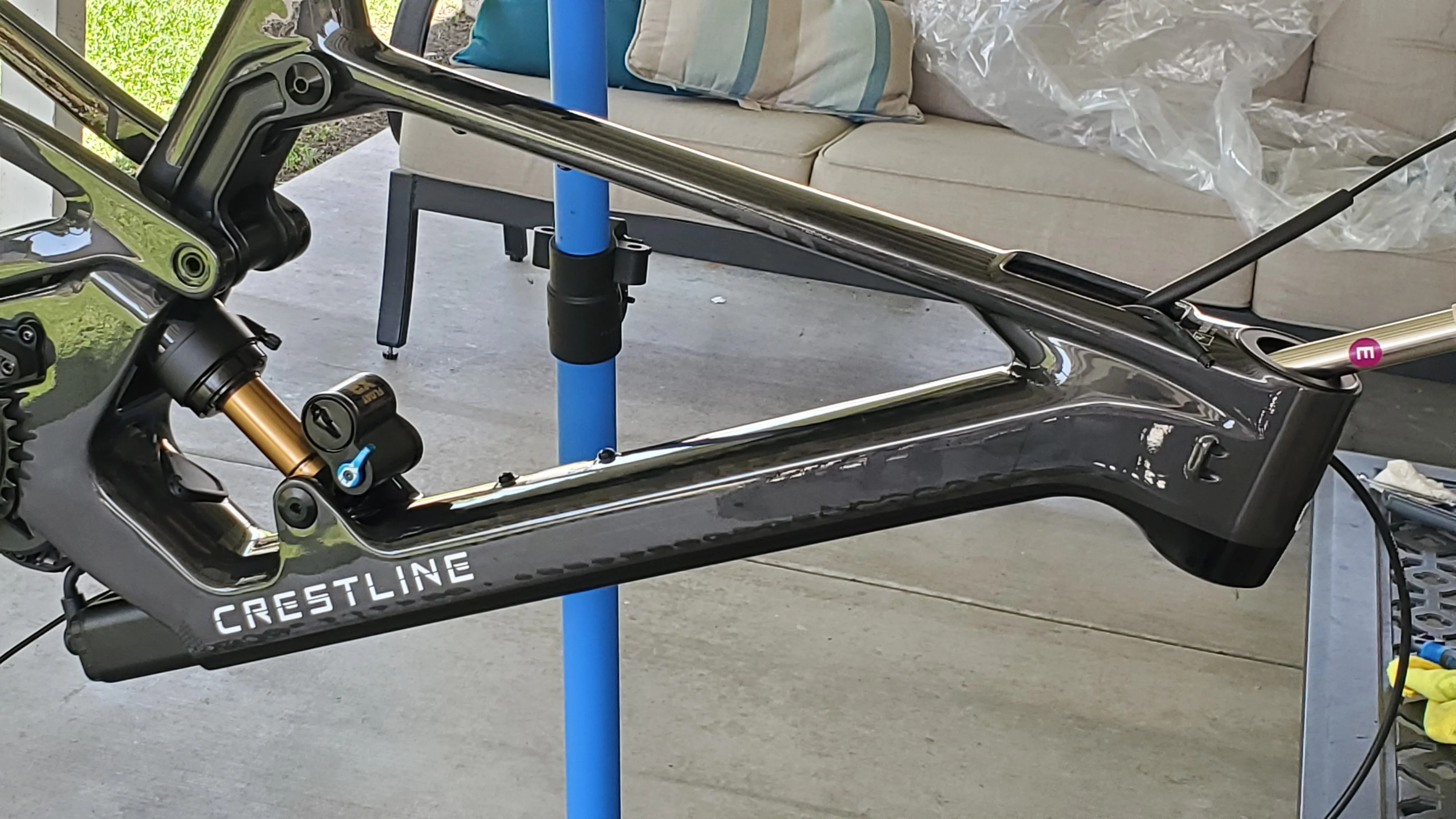

Note that rear triangle glistening in this shot @Singletrackmind , just for you pardner.
The raw stuff shows up as well, raw looking and almost pre-scratched up appearing so you don't got to worry about being rough with this girl in my mind.

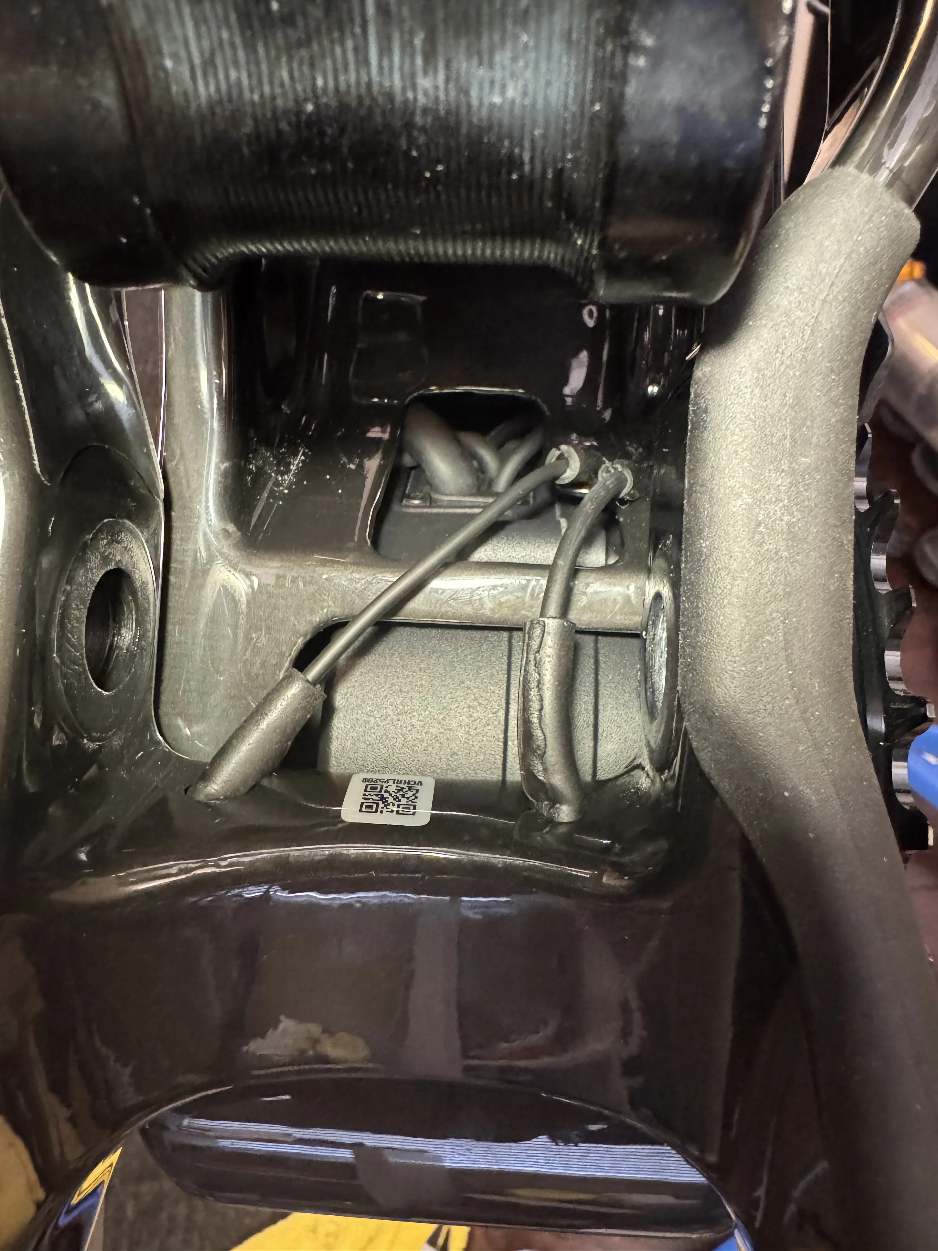

Now just wondering where the heck will I route the dropper post cable for the next step?!
There are 2 guide tubes, one comes with the display unit wire pre-installed. One for the rear brake, but what about that dropper cable?
Anyone with an RH2 and a 600 or 800 battery try routing a 3rd cable yet? Havent tried it to be honest, just looks to be super tight and my brain is already foreseeing a potential obstacle. T made it look easy , but the 700wh battery seems to make room with it's curved edges inside the squared frame.
Enjoy the day and the build "family"!

Thanks for the follow up pics! Appreciate the efforts to highlight the "raw" finish. Totally understand the methodological approach you are taking.
Looks like the model I ordered as a complete build come with the silver or "clear" anodized Cascade links. Seems like it will match well with the silver Crestline branding/lettering.
I reached out to Crestline and Fanatik (the bike shop that had the last available RH3 frame size) to see if I could swap the red Zeb for a Black Zed and unfortunately but understandably Crestline pre-orders their entire kits and bike shop couldn't exchange as well.

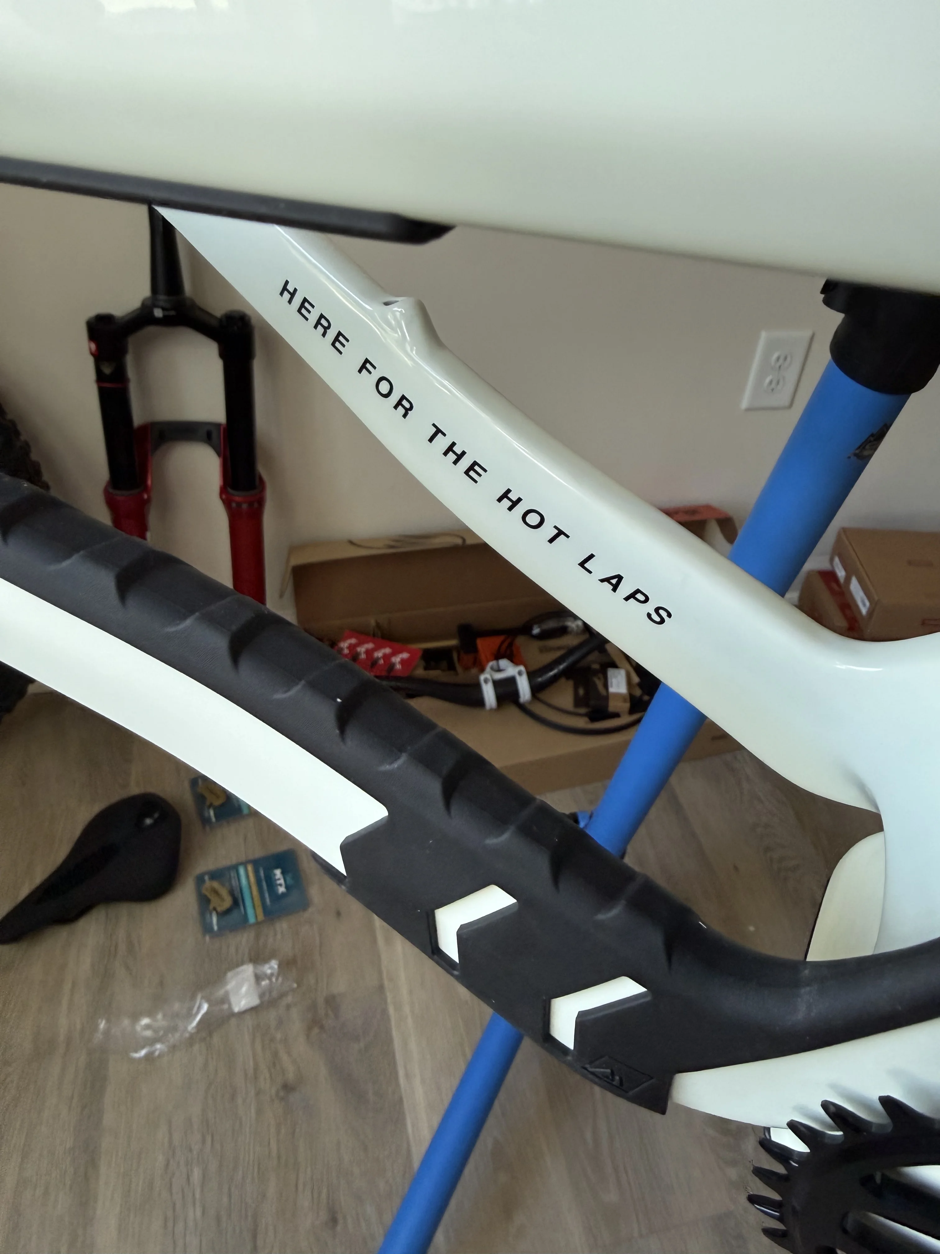

Decided to swap out majority of components on my current S180 over to the new RS181.2 and will sell S180.

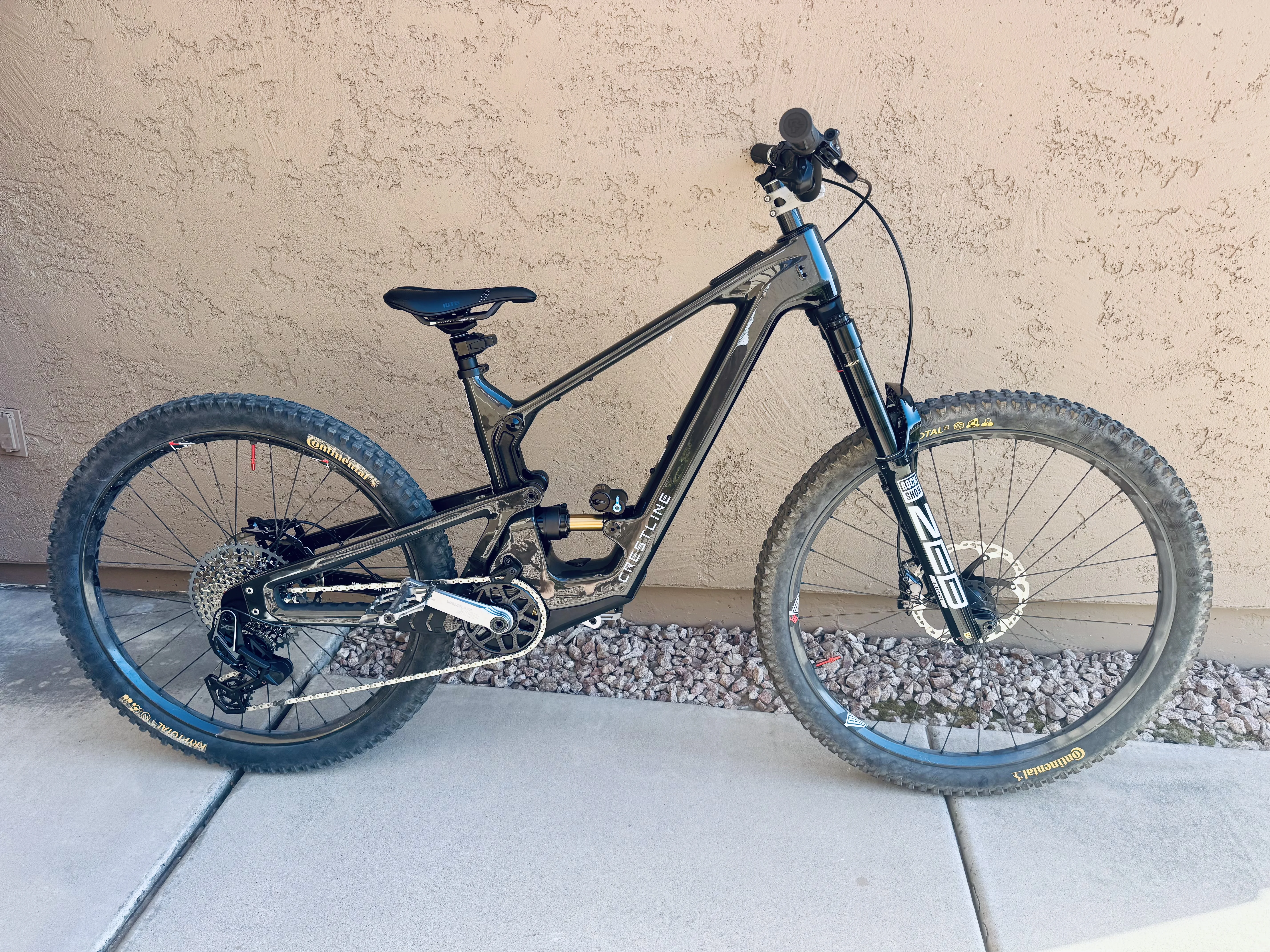

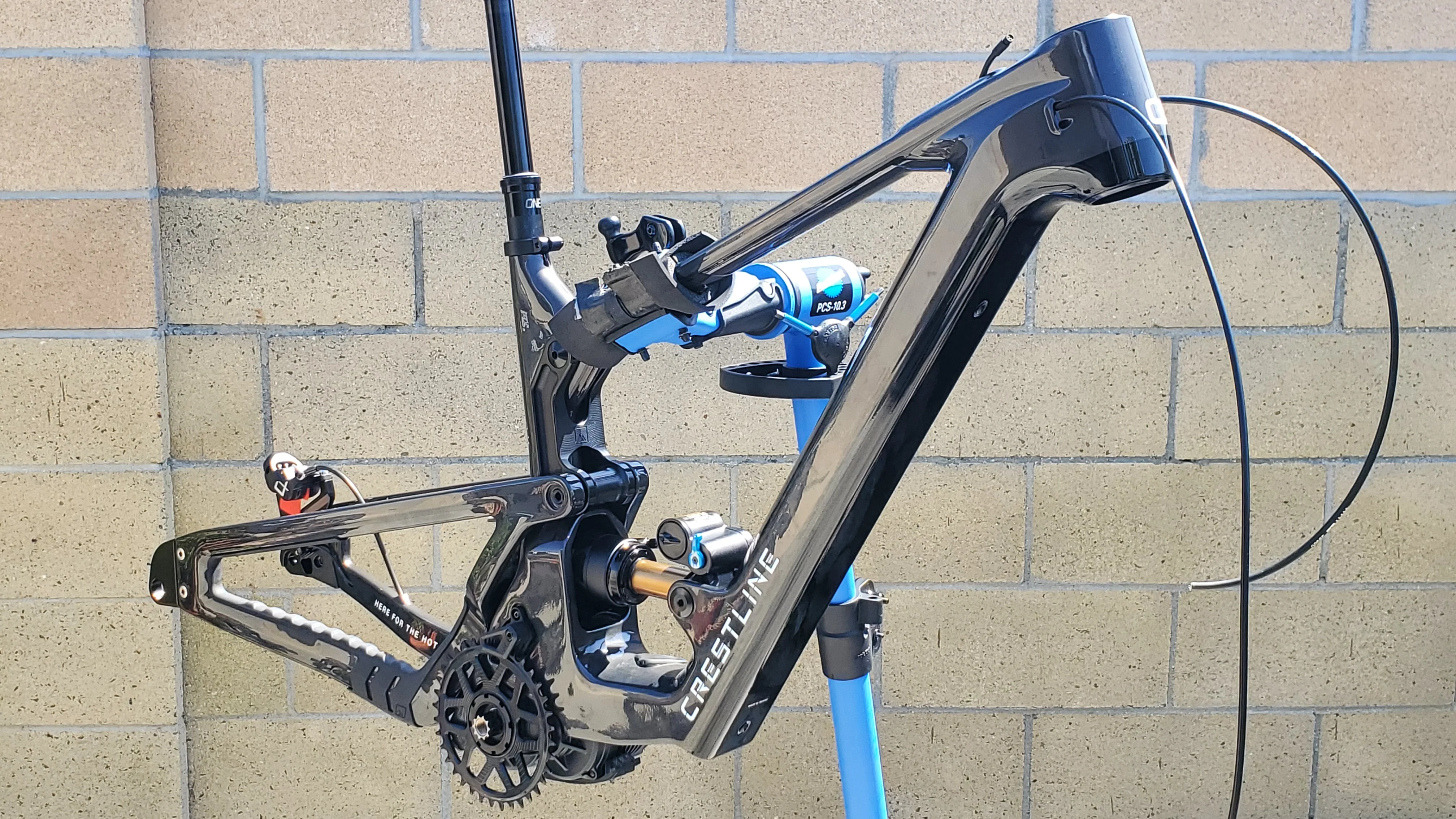

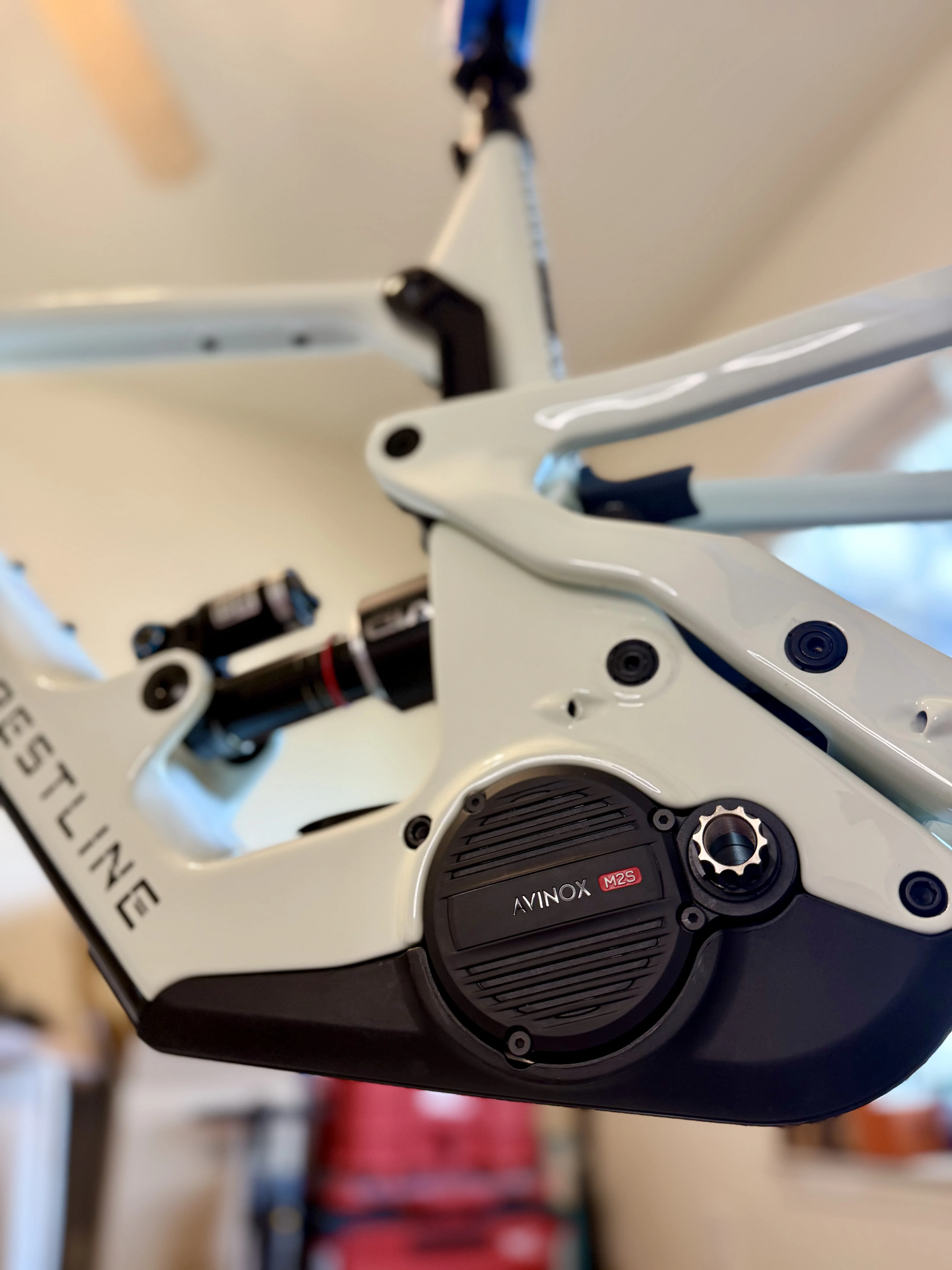

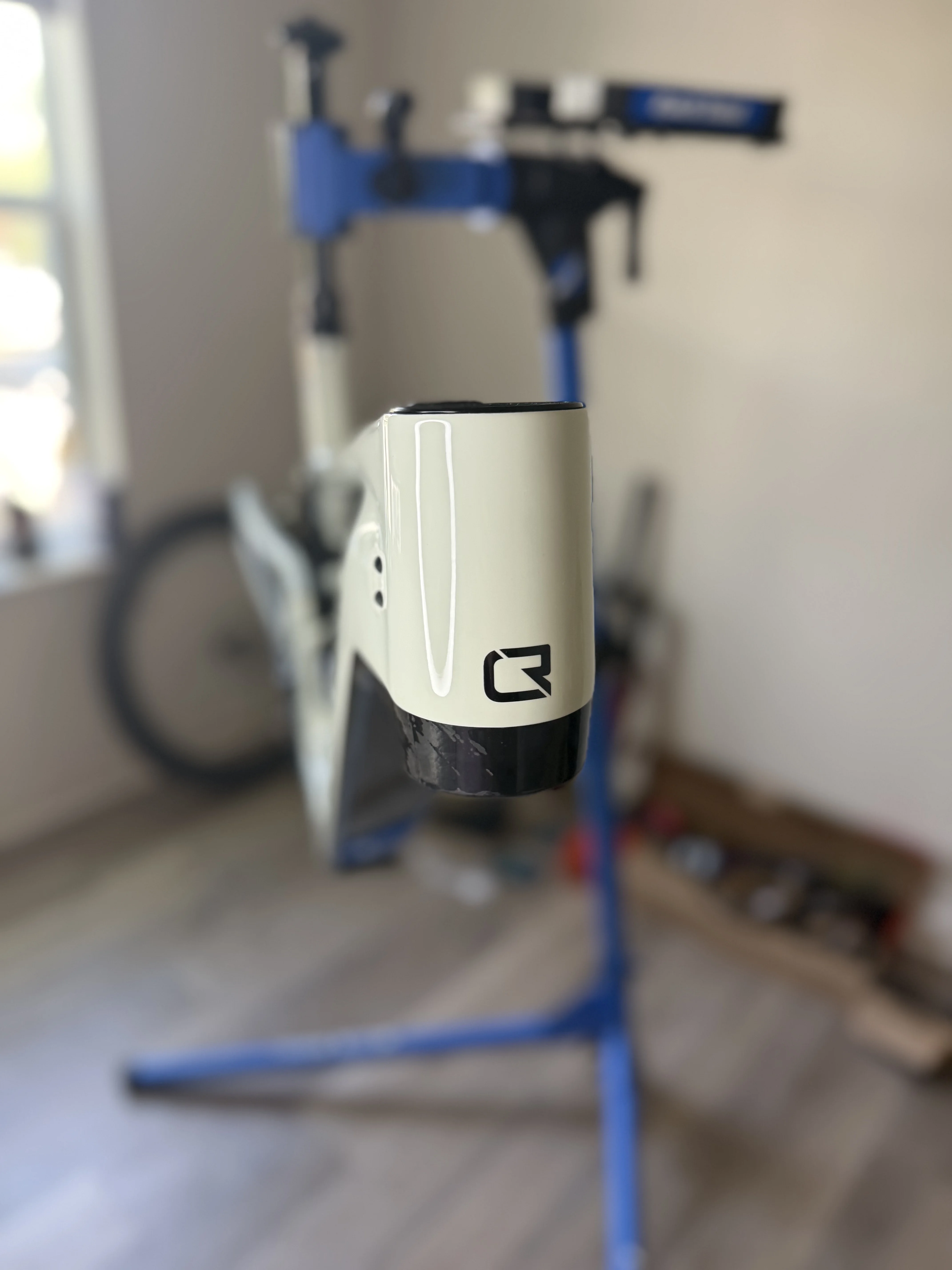

Step 2 - Lindsey got her OneUp dropper cable routed and post installed!
I had removed the battery trying to be like T on the video, so ended up sliding the cable through first without the battery in.
Then zip tied the dropper cable to the display wire to hold the cable in place with some tension as I slid the battery back into position.
Used a broom handle with a soft plastic tip to gently nudge the battery and align the mounting holes.
Learned this trick after the battery got "wedged" in the frame! I tried to run the cable housing damper (to be cool like T again) and it got stuck and tore the foam. Caressed it out without a scuff using the broom through the head tube.
The dropper cable ended up finding its own path or I may have got lucky. It lined right up with the groove in the battery along the display wire.
She is coming along mighty fine!
Hope this helps, cheers time family!

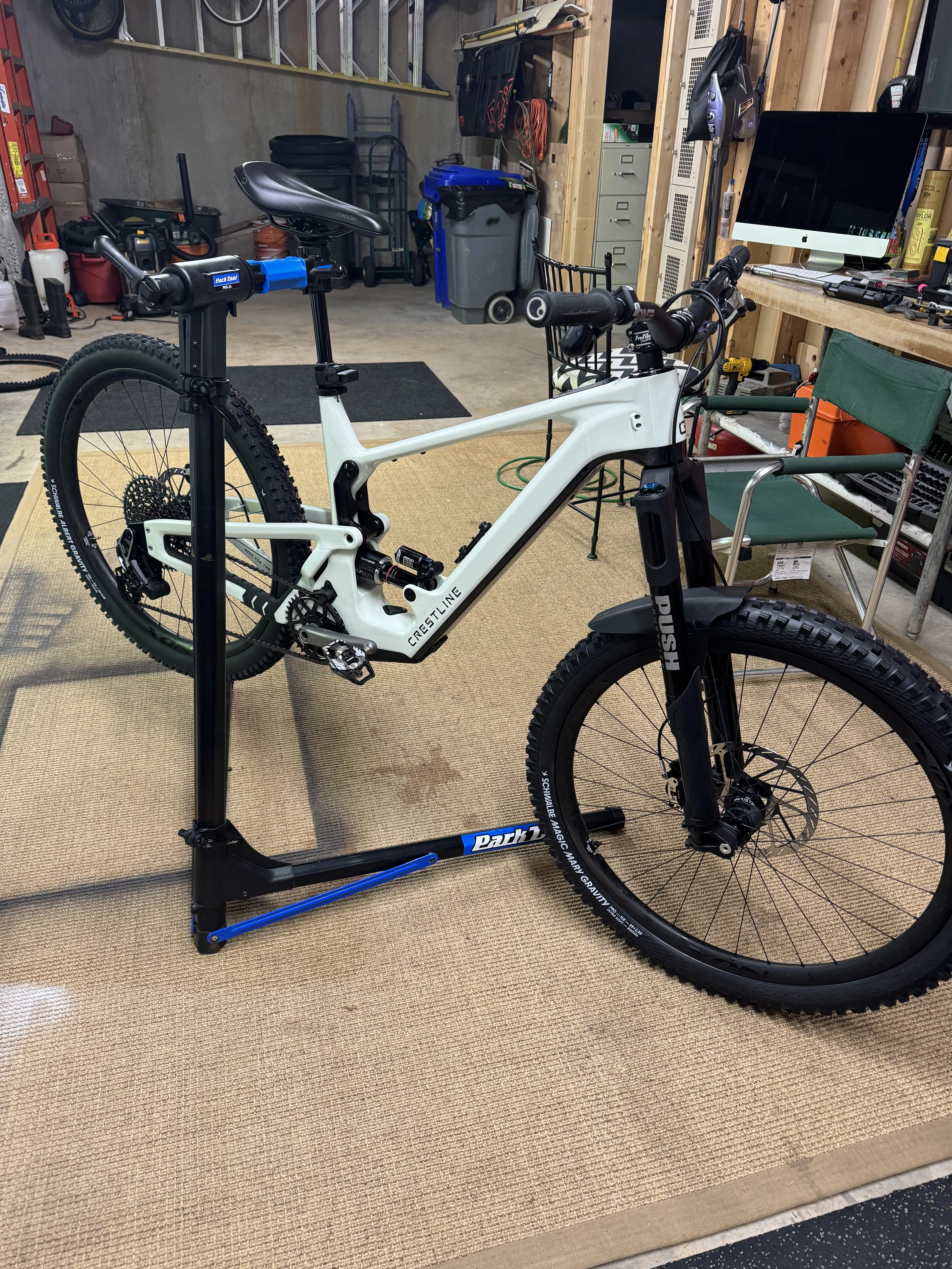

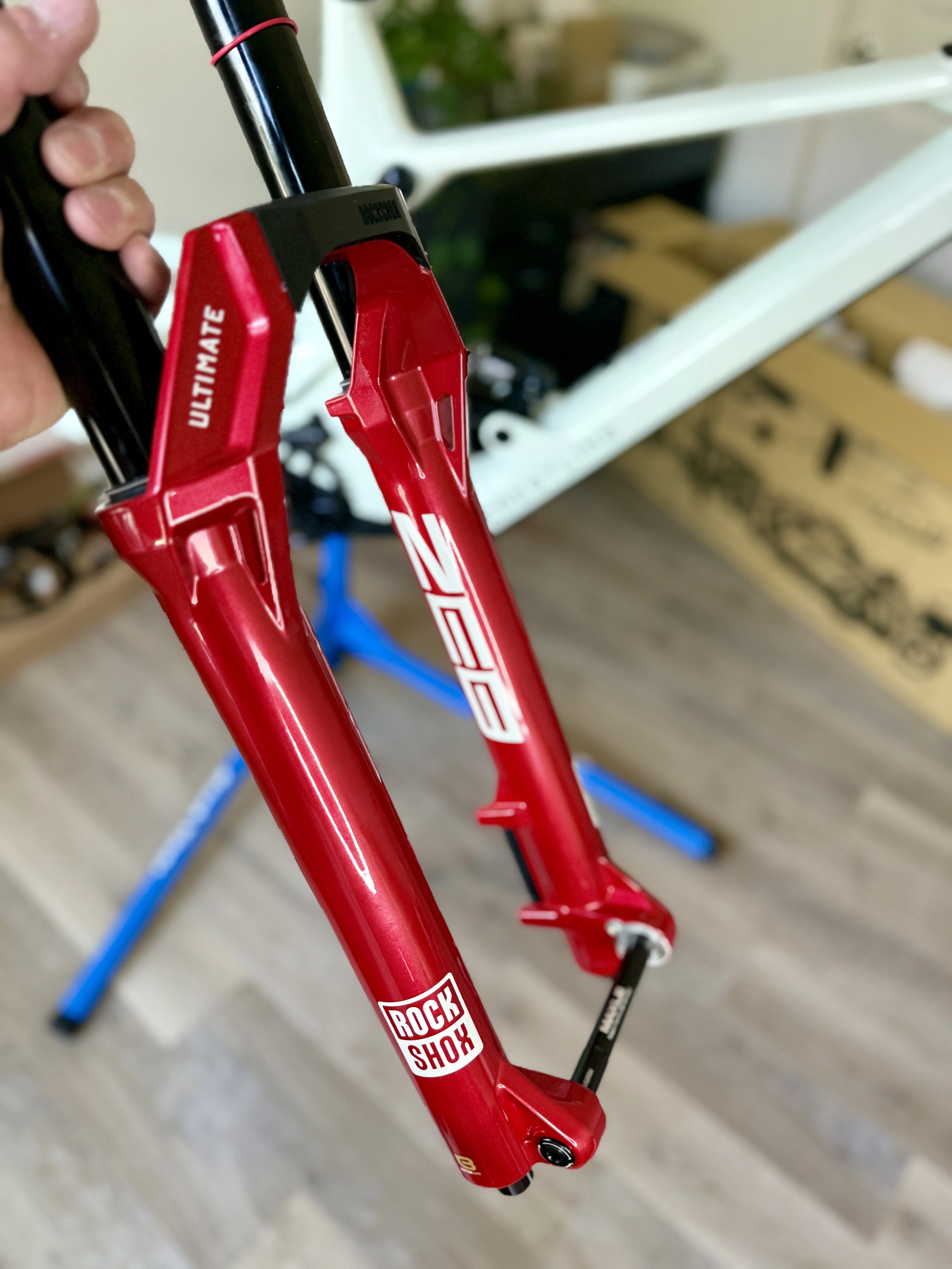

#60 arrived just in time to take flight! Leaving for Jarrods Place on weds! LFG!! 🤘🏼View attachment 182348View attachment 182349View attachment 182350View attachment 182352View attachment 182353View attachment 182355
Zeb is a beaut, but she’s a chunky girl
