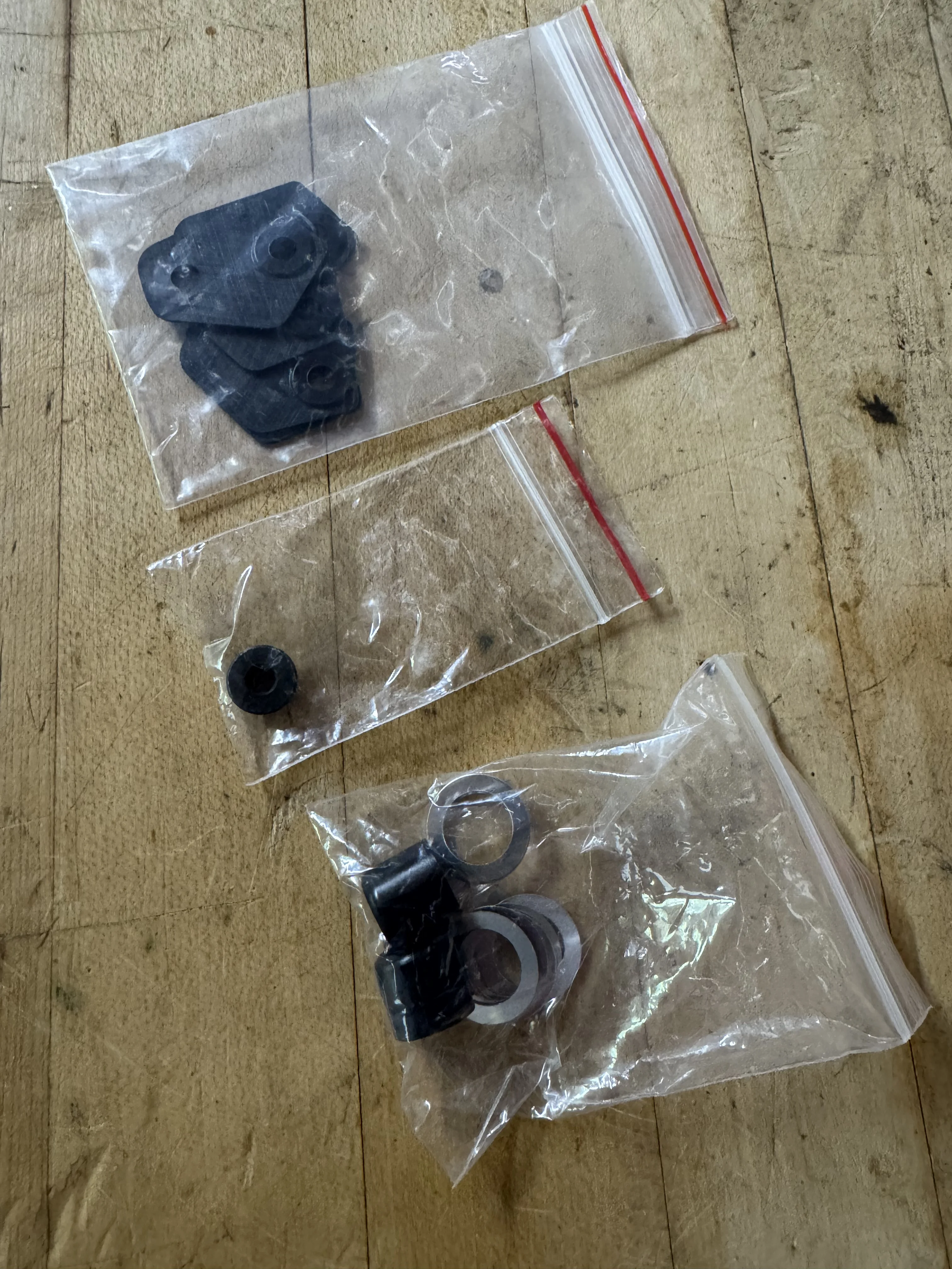

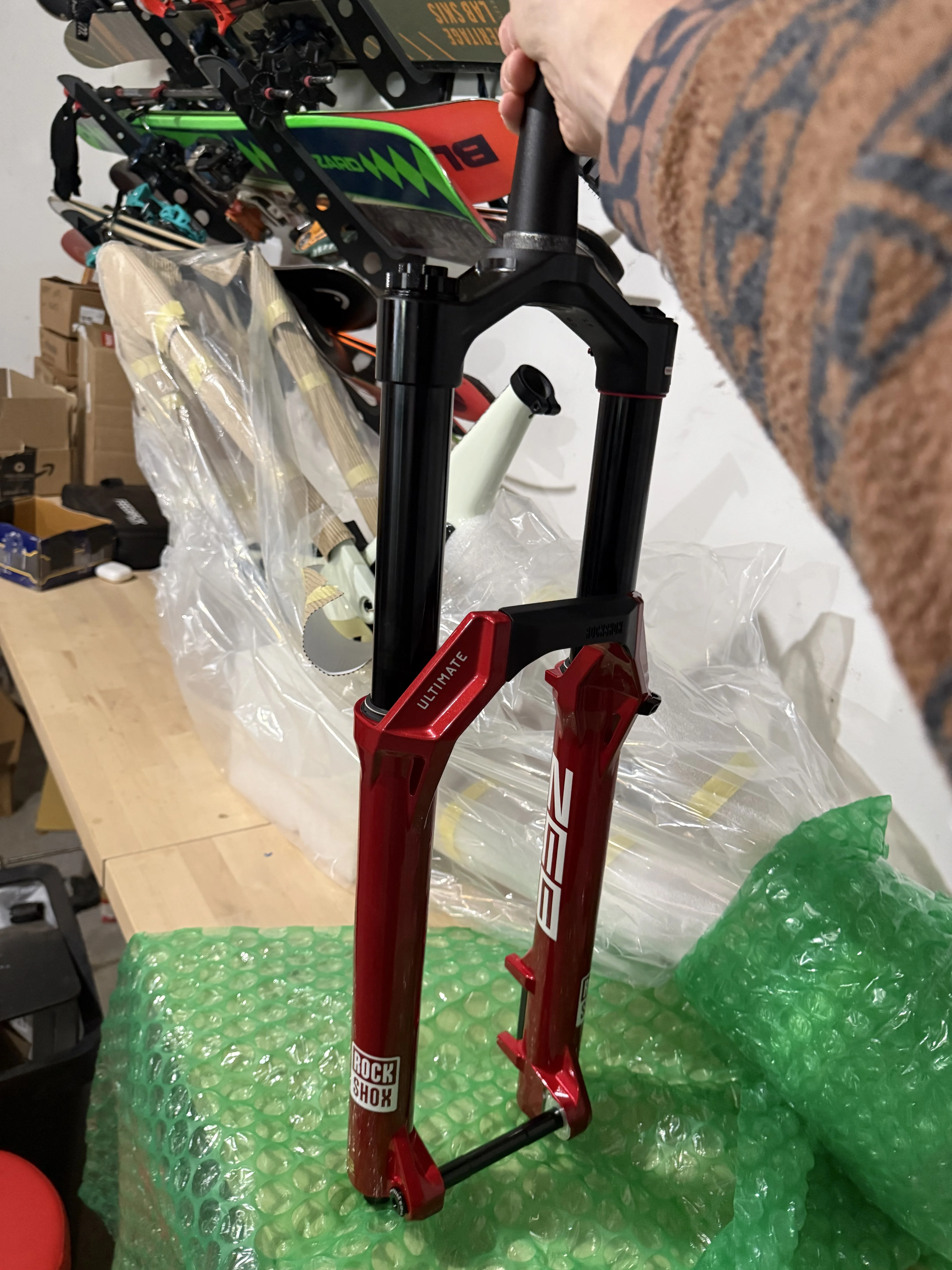

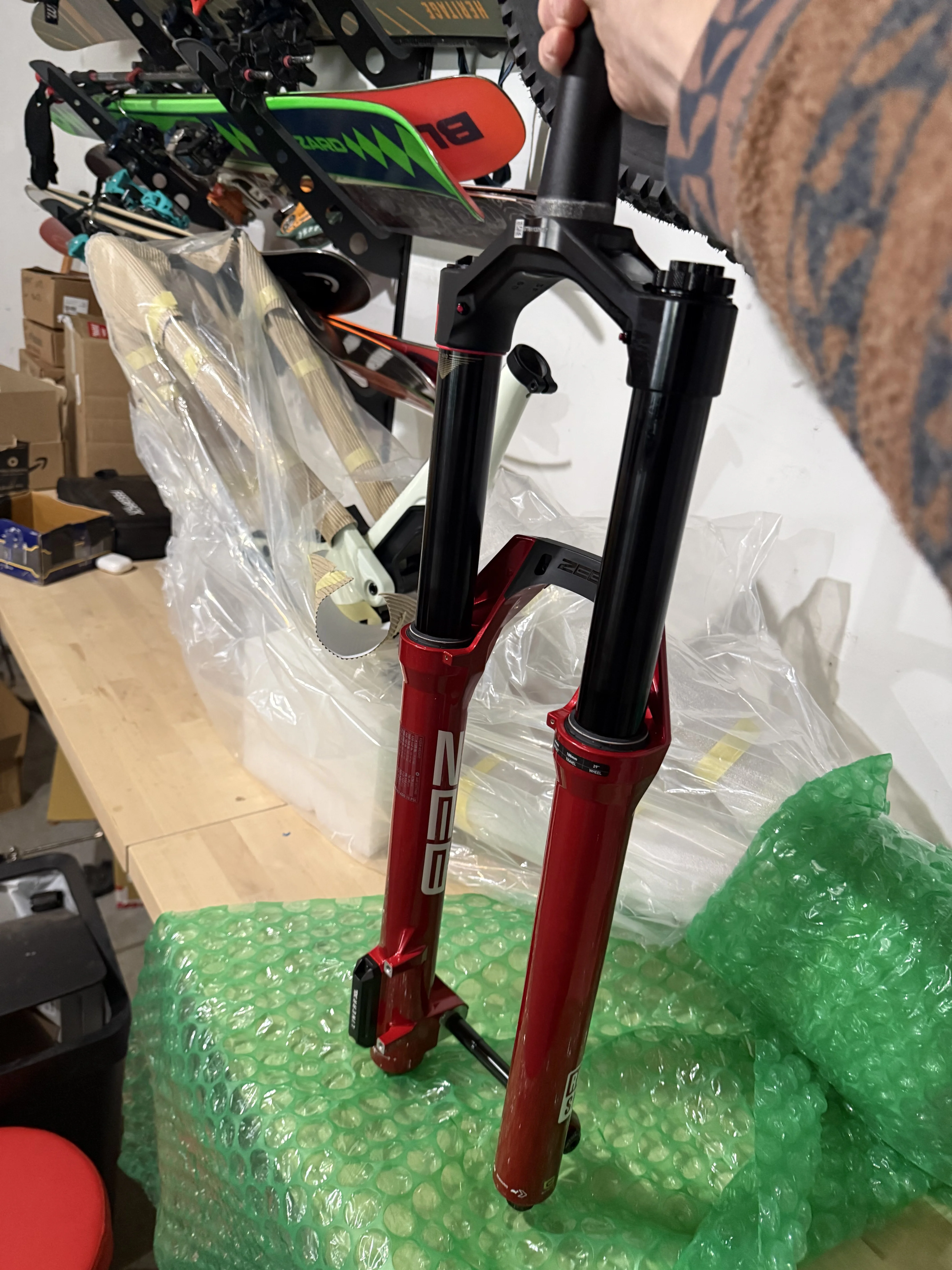

Read em' and weep! Sadly, my package was missing the odds and ends box with the charger, axle, etc, so a few more days waiting for me. Good for my patience I suppose! @Wah My frame came with the Zeb and arrived today.
The 007 nickname around here is used for a rider with 0 skills, 0 stamina, $7k bike 😝
JK I’m actually jealous, that’s an awesome number!
Let’s see that Zeb… Bond, James Bond. Also i guess he was able to pack in the same box.
same box — I thought Christmas only comes once a year.

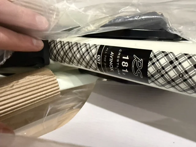

Bike shop just sent me the invoice to pay for the thing with a note stating it is ready for pickup!! 🥳

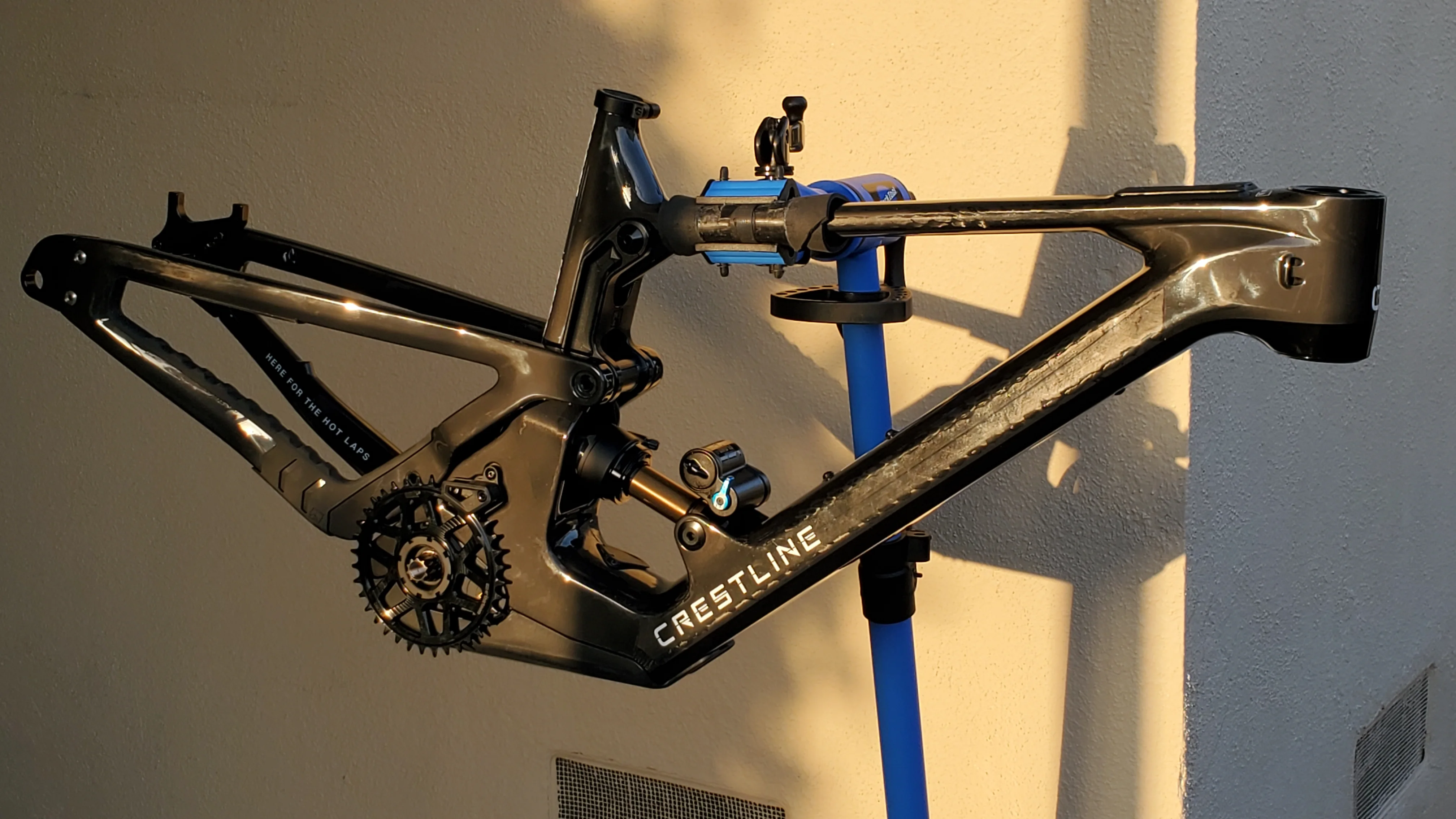

Brought good old #97 home!
Snapped some pics while she took in what was left of the sunlight. Tried to show how the raw carbon details pop when the sun hits it. Subtle, yet intriguing.. and sexy!!
Think I'll call this girl Lindsey!!

Damn, that frame looks nice! Is the raw carbon details throughout the frame including headtube, seat tube & chainstays?
Yeahp, all over the frame. Yet you see it only as the light hits it just right in spots as you gaze upon its features. Note the shadow line on the wall inline with the pop seen on the frame.
It's mostly subtle, dark stealthy grey and smooth looking, then BOOM spots of RAW glimmer in the sunlight! It's so much nicer in person pics don't do it justice of course.

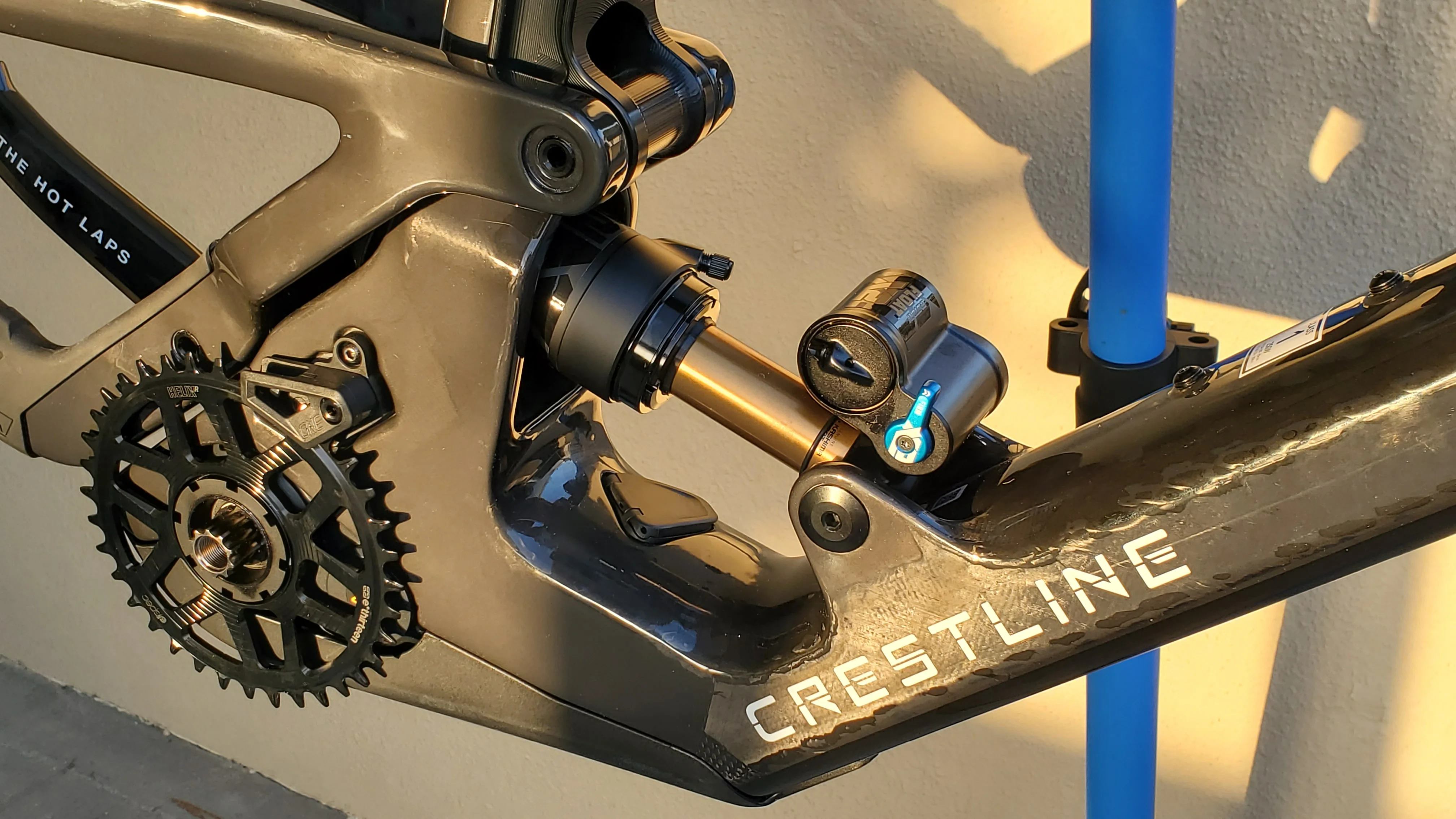

9 clicks out, looks tight, anyone have any problems? Not sure max clicks

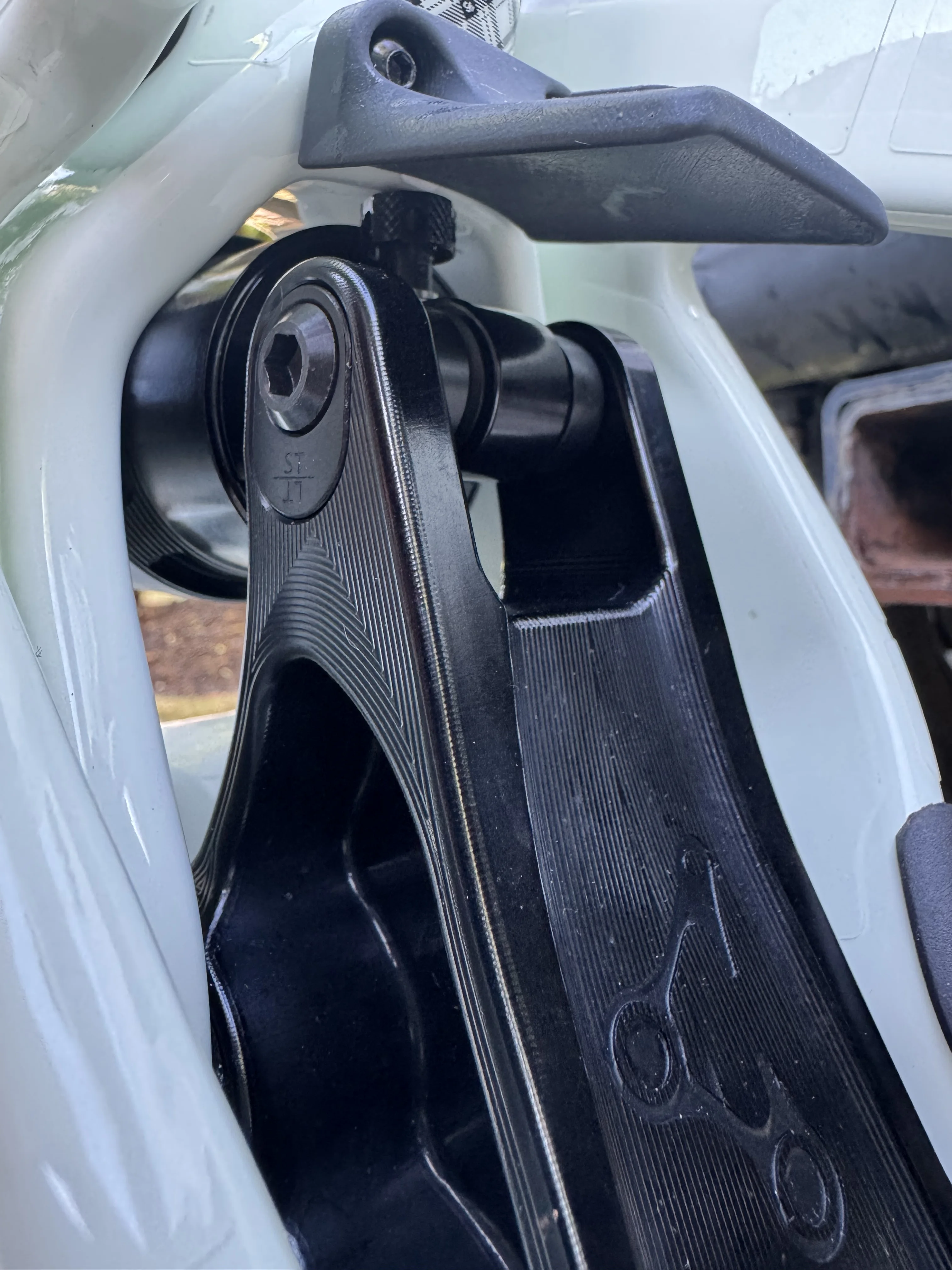

It was the same way on .1 frames, if you’re in ST mode and have the rebound dialed out it will likely hit. You’ll have to remove the shock, take the rebound knob off then reinstall the shock.
Not ideal, thank you

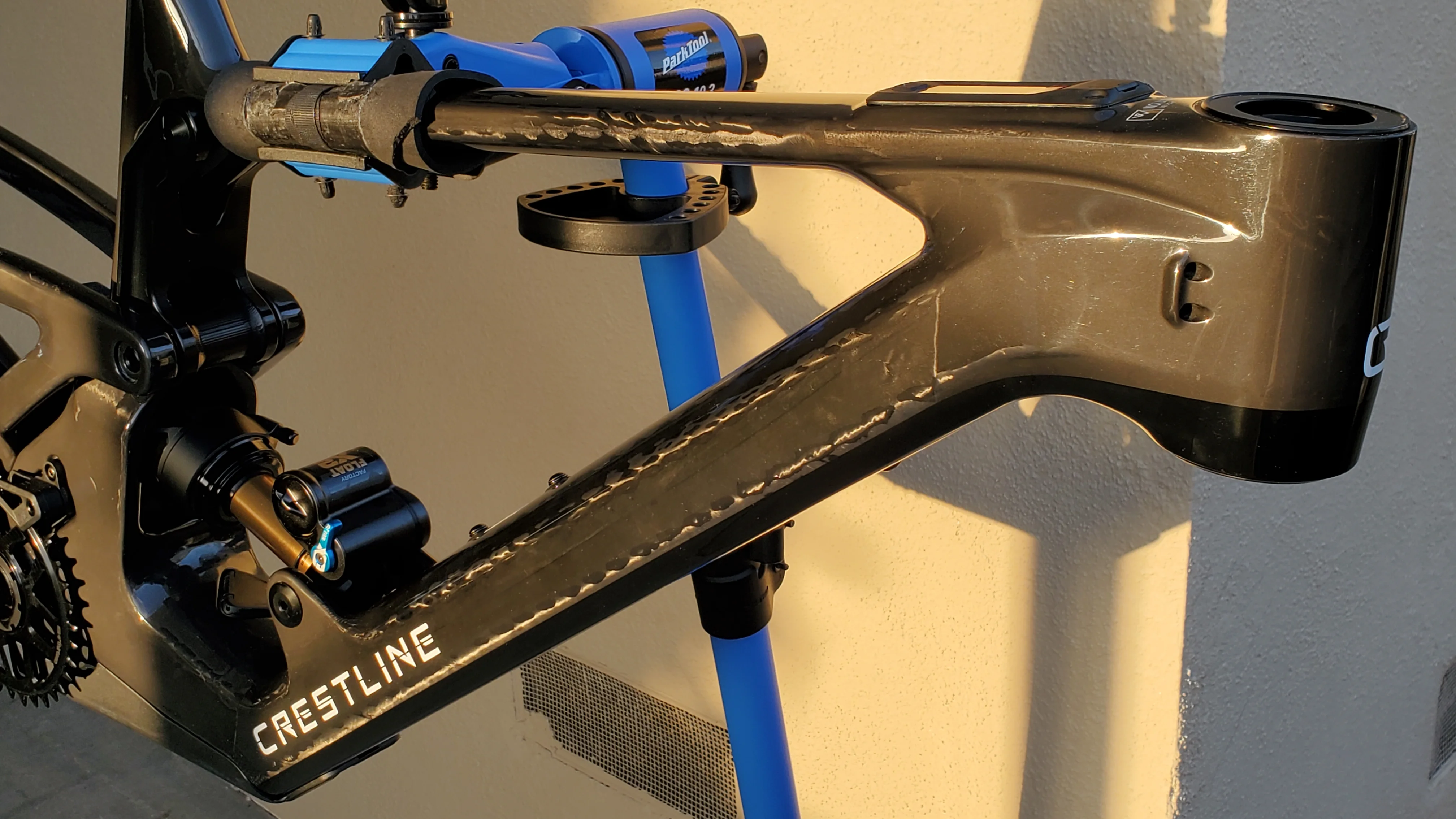

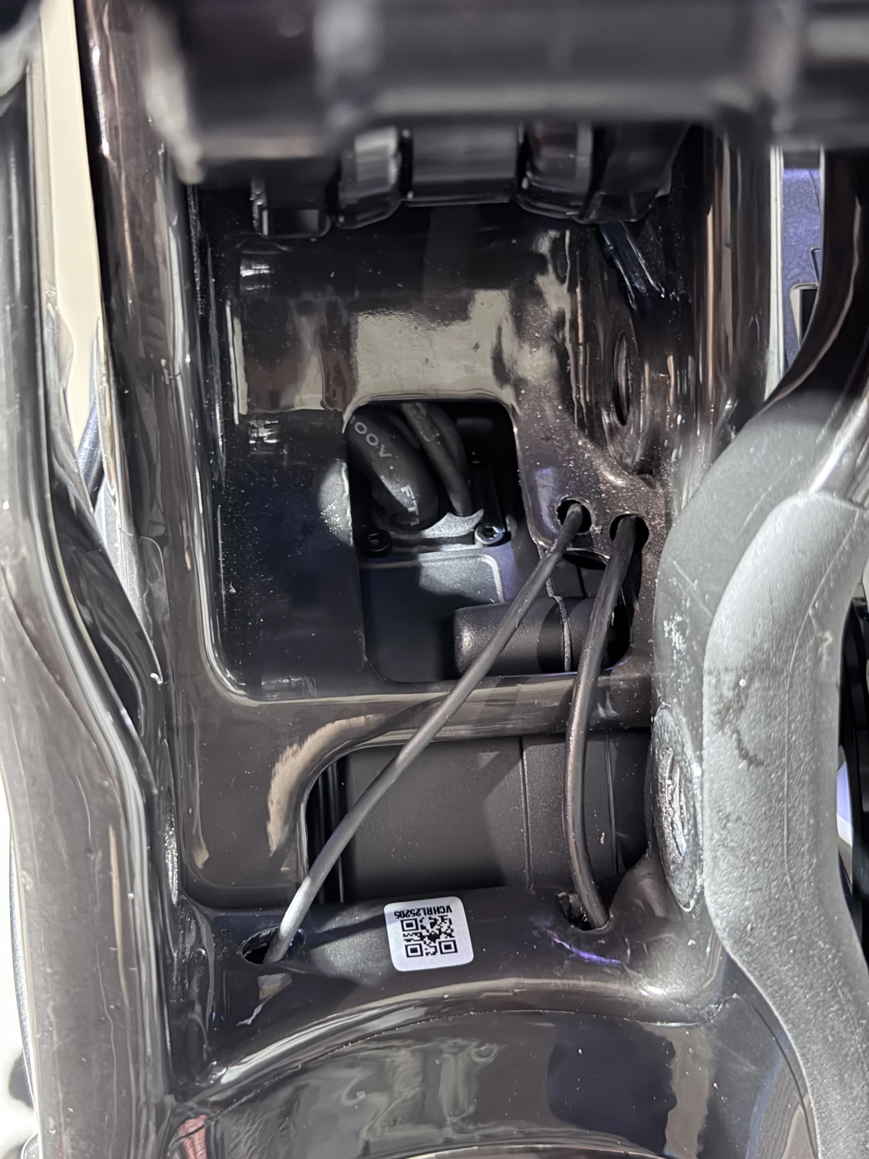

These open windows under the linkages gives me anxiety of water and mud getting in for sure. Any thoughts ? I guess these are for heat management? I want to tape them lol, not feeling I can wash my bike anymore
This kinda got brushed over. Curious if everyone is just going to leave it, tape over, or stuff with foam? Idk if I want to leave that large of a hole there. I get my bikes pretty muddy often.
View attachment 1821739 clicks out, looks tight, anyone have any problems? Not sure max clicks
Think the issue may be it looks set to ST vs LT?!! :LOL:
Do you need to undo the shock mount to remove the rebound knob?
What is the real concern here? Water ingress or mud build up?
Both… I don’t exactly want a wide open window to my motor/electronics. I get that it may be rated to get a bit wet, but I also don’t spray my cellphone with water that is also water resistant. It’ll also build up mud in there over time and be a pain to clean out. Look at the yeti thread, same issue with them and most people are using foam there. It seems like it was overlooked or is there a purpose for it? I don’t have my frame yet, but just looking at that pic I don’t think I’d want to leave that open.

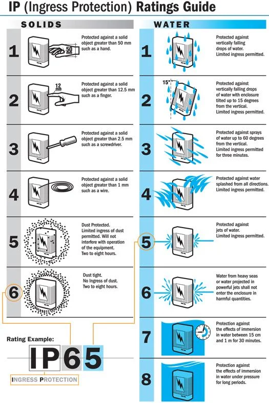

Yeah I get it. I work a lot with water proof electronics, IP66 is good for water/dust (dirt), so I wouldnt be worried about that, especially from DJI who work with a lot of outdoor electronics already.
Mud wise, interested to see feedback from 181.1 owners to see if it is a real issue?
Also it is not 'a bit wet' it is from jets, next level is IP67 and IP68 which relates to full submersion.
