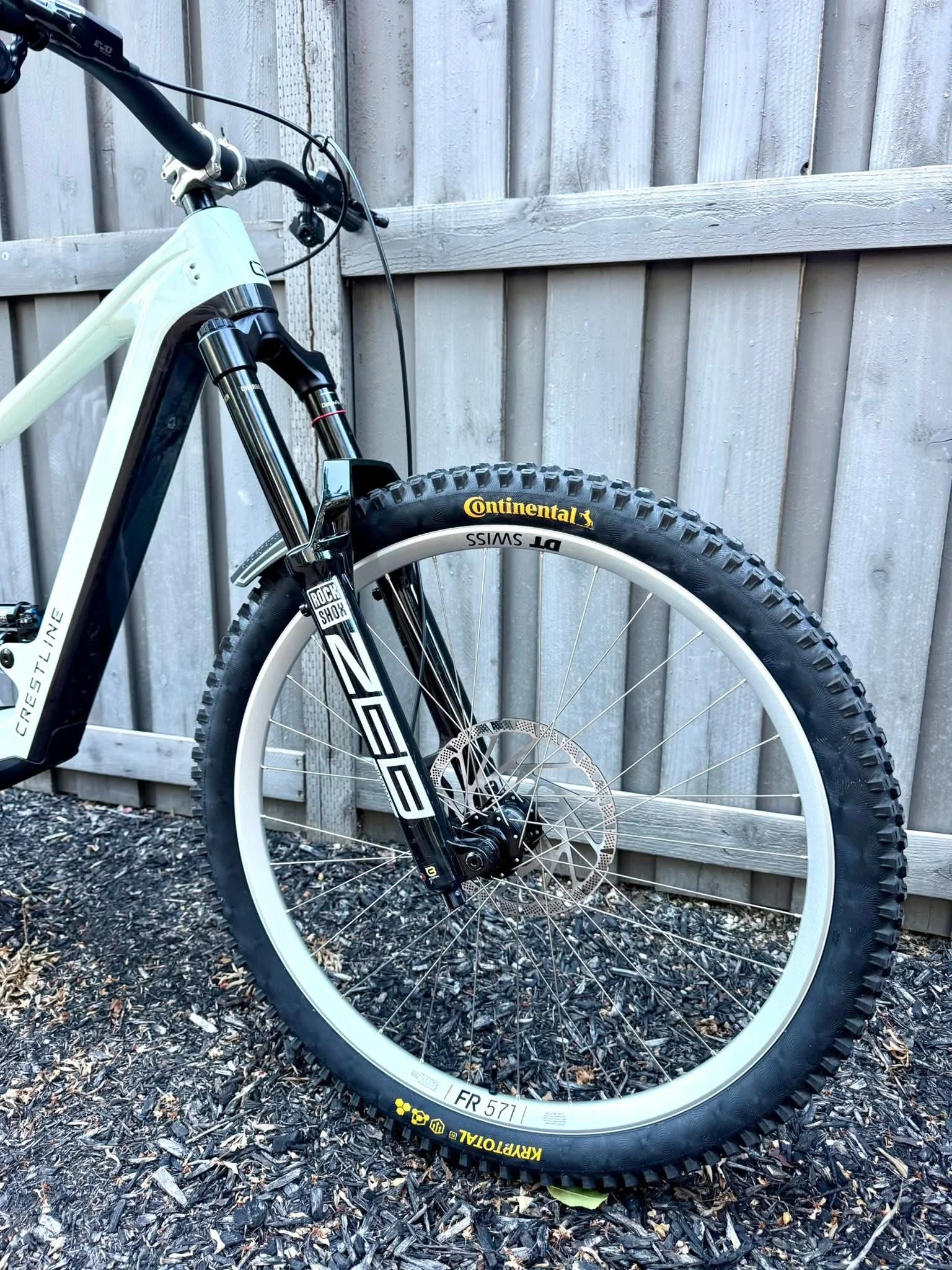

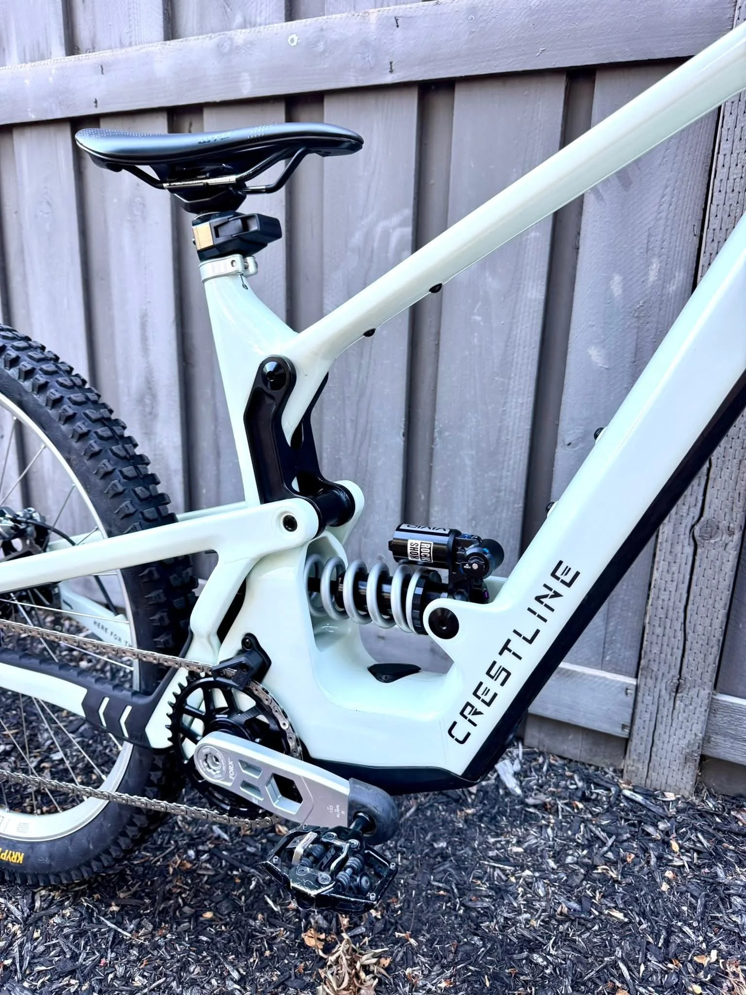

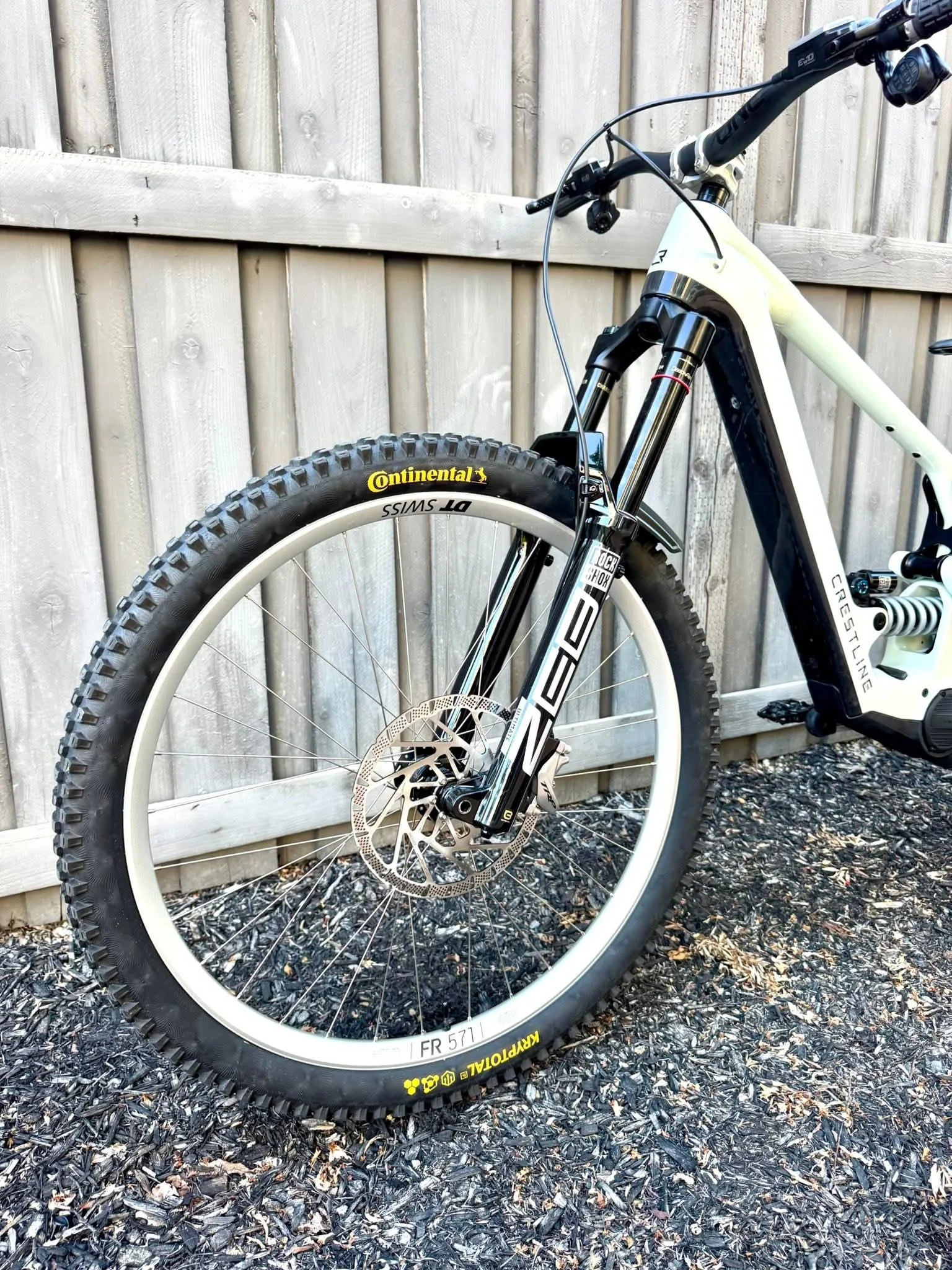

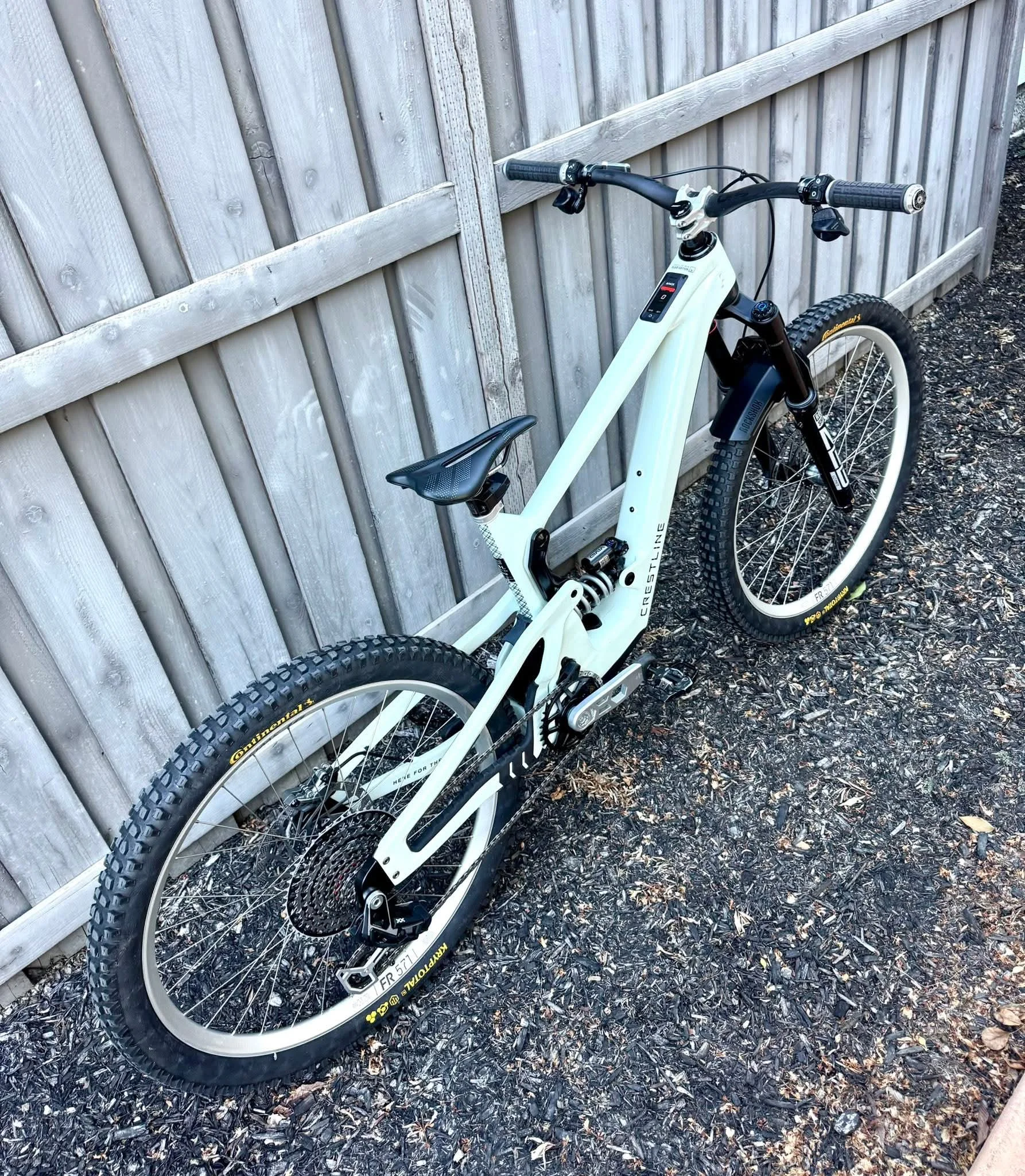

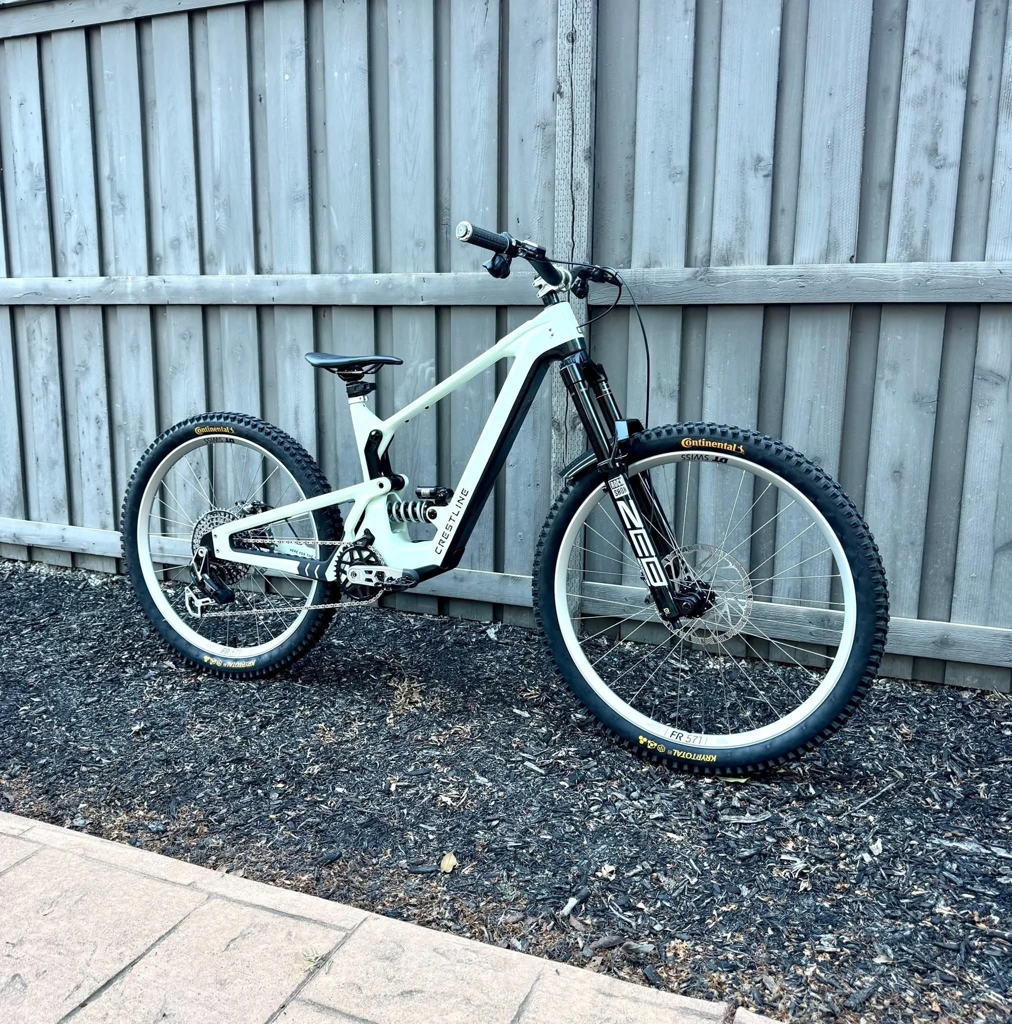

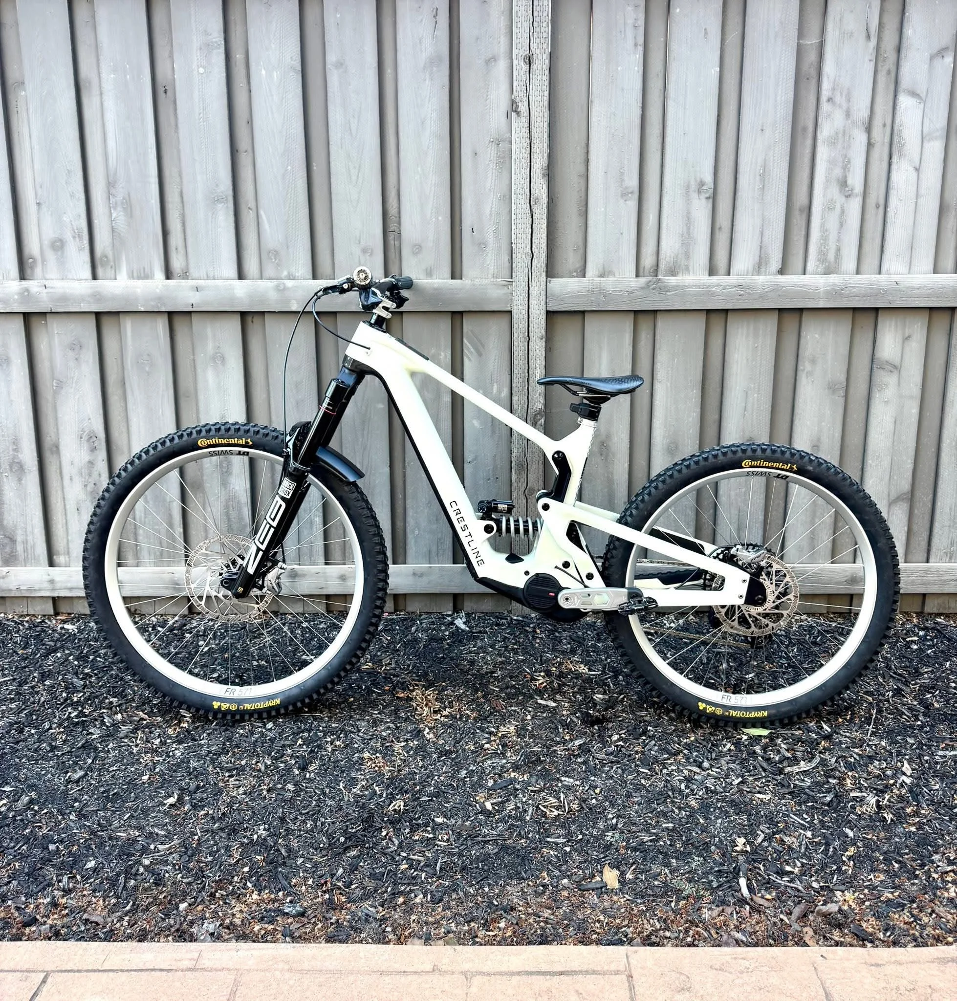

slowly building it up…
I do notice the inside of frame and inner guide tubes seems a bit rough / not high quality finish. I think I can easily break the end of the inner tube if not paying attention… this is the first carbon frame I look inside… anyone can share is that same with major brands?

My Levo is jagged af through the head tube. Its smooth where the HS cups go and where the battery slides in and out. It’s not perfect, but fairly decent.
What size frame did you order? From the assembly video, I was under the impression there aren’t any internal guide tubes for the hoses…. more of an open/internal routing setup.

I have rh-2. I do see some tubes but maybe not all the way through downtube. I didn’t remove the battery to see through. The video says rh2 can use internal tubes but not rh3/4? Not 100% sure.
I was discussing this earlier in this thread on the first page. The 600/800 batteries have guide tubes molded into the battery. The 700 does not. In the video he is building a rh3 or 4 with a 700. So the hoses would route in the corners, while in an RH2 it would route in the battery guide tubes (bc it can’t fit a 700). I *think* this is what he means in the video.

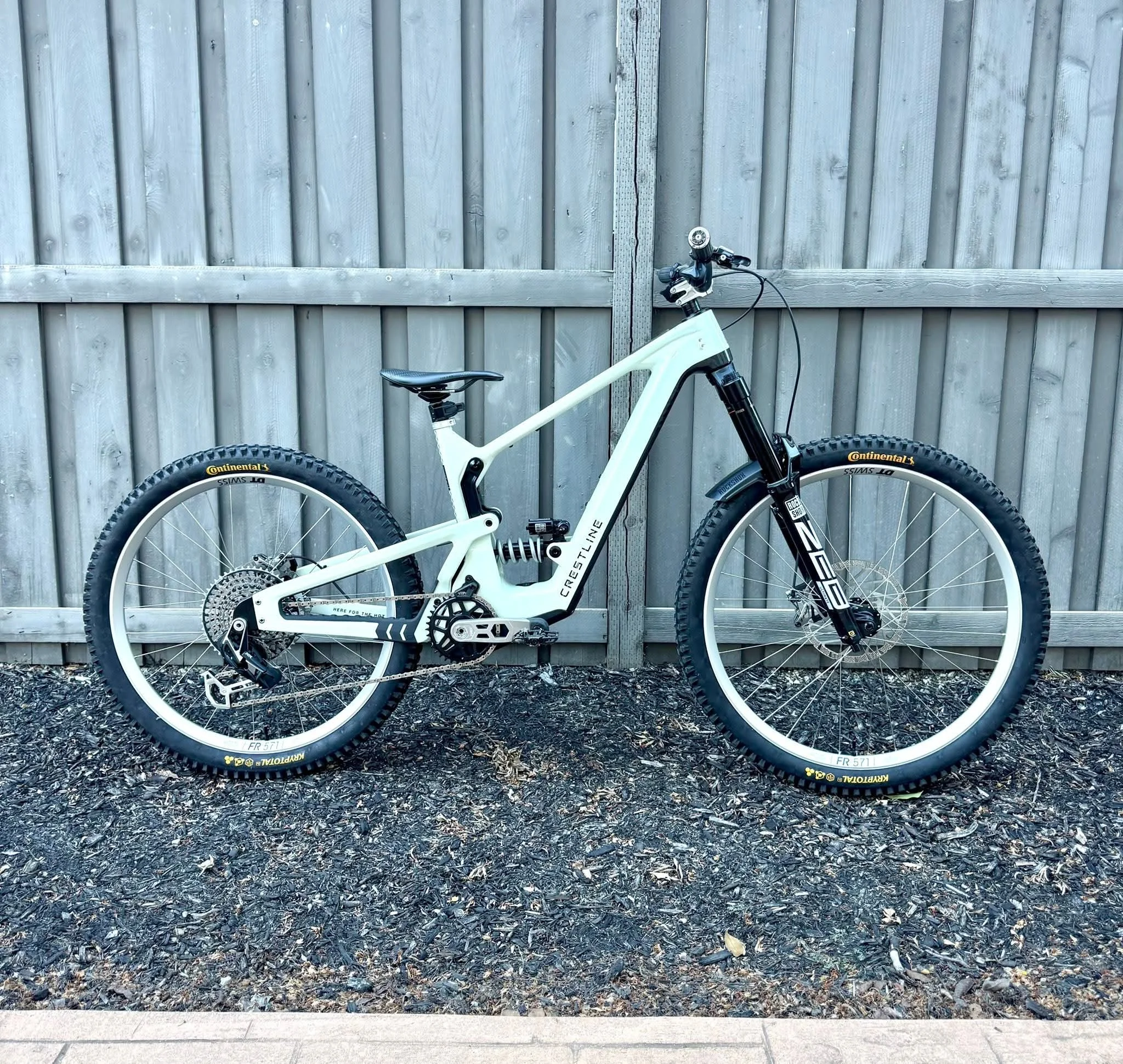

This must be one of the first builds:

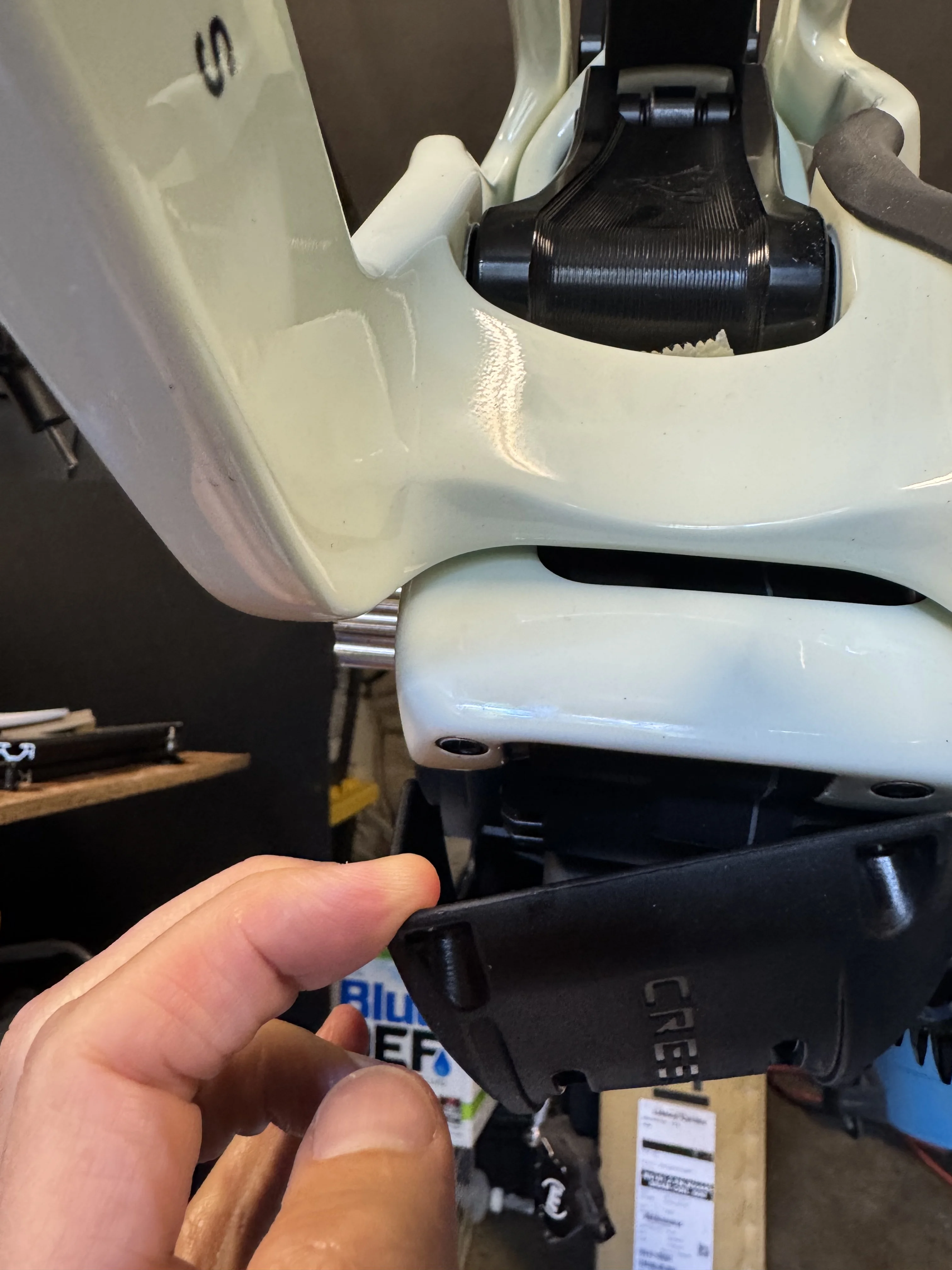

That’s brutal. Sorry to hear. Did you have any issue removing the motor cover? Doing this now and the rear non-drive breaks free no problem but the drive side rear won’t budge. I’m afraid if I force it, something will break. I of course removed the bolts.
Yes I had the same exact issue! But I eventually got it off with some more force. But I was also afraid I was going to break it. Luckily I didn’t. 👍🏼
