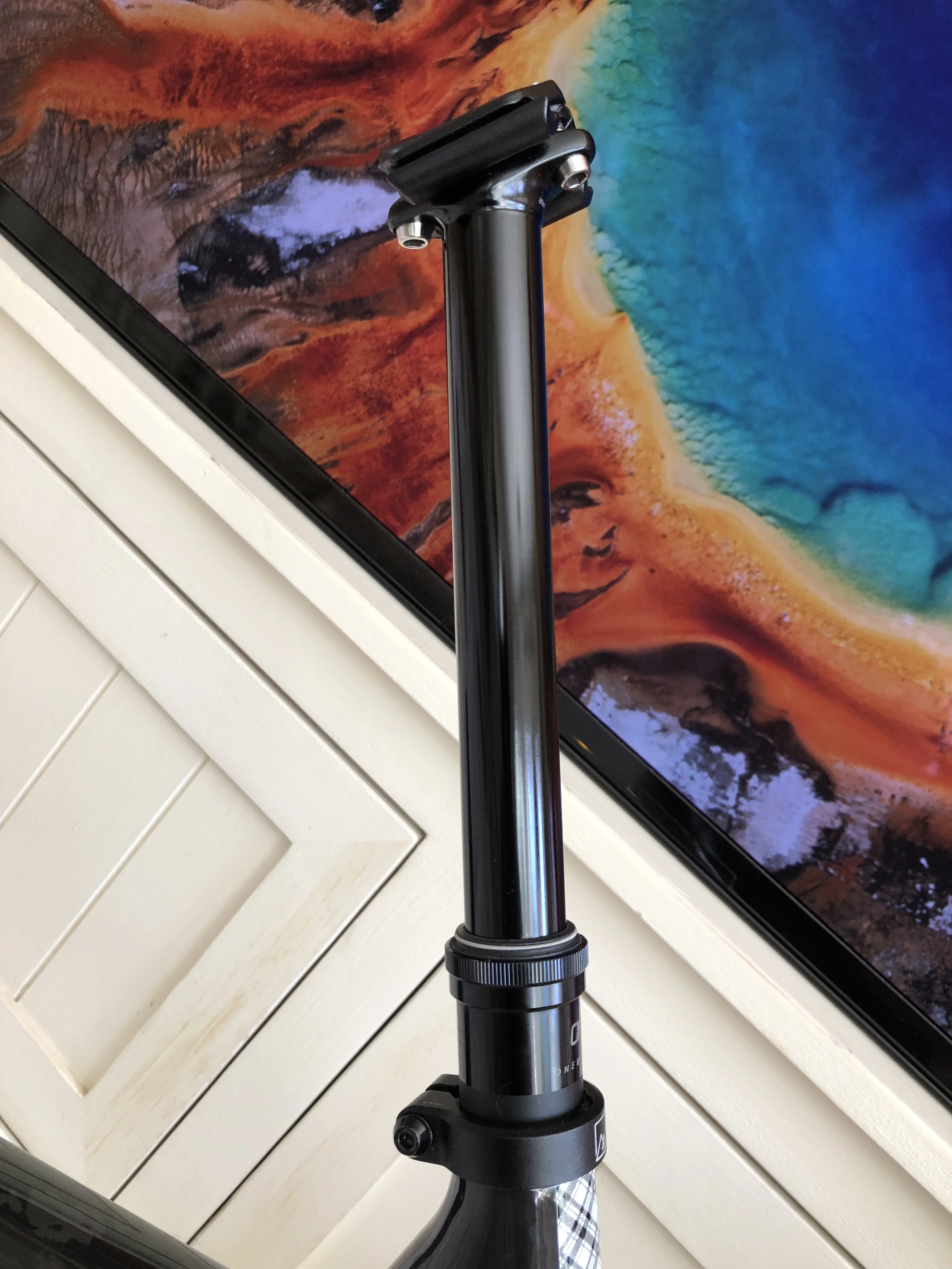

I’m 5’6 with 29 or 30 inseam. I tried to do the math the best I could and it seemed like a 180 fully slammed might be right on the edge of being too high for me. I wondered if I ran a super low profile seat like an sq lab 611 it might fit perfectly
I have an SQ Lab 612R going on mine. 👍🏼 Just put in my 180, slammed without cable. 26” from center of crank spindle to back edge of seatpost seat clamp. Which is the exact distance as I was running on my old ebike. 🤘🏻😎
On my current bike that measurement is 25.5 but I have a volt on it that’s like an inch taller than a 611. Putting the cable on doesn’t add anything?

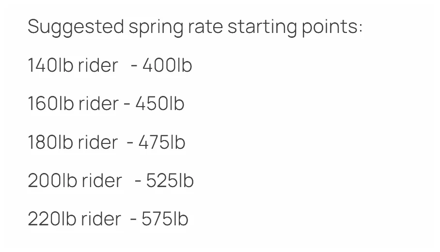

you have to specifically buy a red spring.

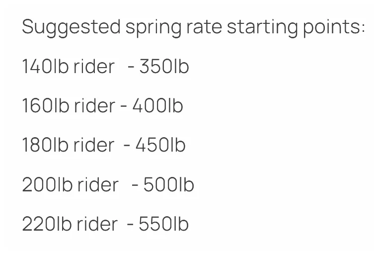

The better question is, what is the spring rate and is it gonna be good for you?
It will at least a little bit I’m sure, but hopefully not too much. I haven’t put the cable in yet. I installed my rear brake and cable yesterday from my previous bike and once I installed it, I realized the old cable is too short on this bike, so I had to order some new rear brake cable. I’m still waiting on my wheels which are currently being rebuilt at Berd, so it will be a couple weeks before until I get them back to finish it. So I’m not in a hurry at this point.
Update 180 one up slammed with cable installed is 26 5/8 from center of crank spindle to back edge of seat clamp, fully extended. So you lose about 5/8 with cable installed. It’s also a bit of a pita to install and adjust, but I’m sure it will be amazing when it’s finished!
