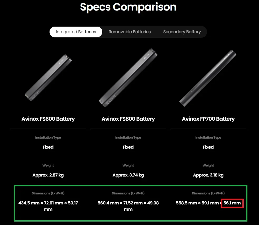

Specs from Avinox:
800 "Ranger" (long range)
700 "Roundie" (all rounder)
600 "Ripper" (for the hot laps!)

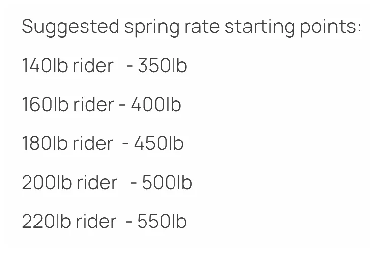

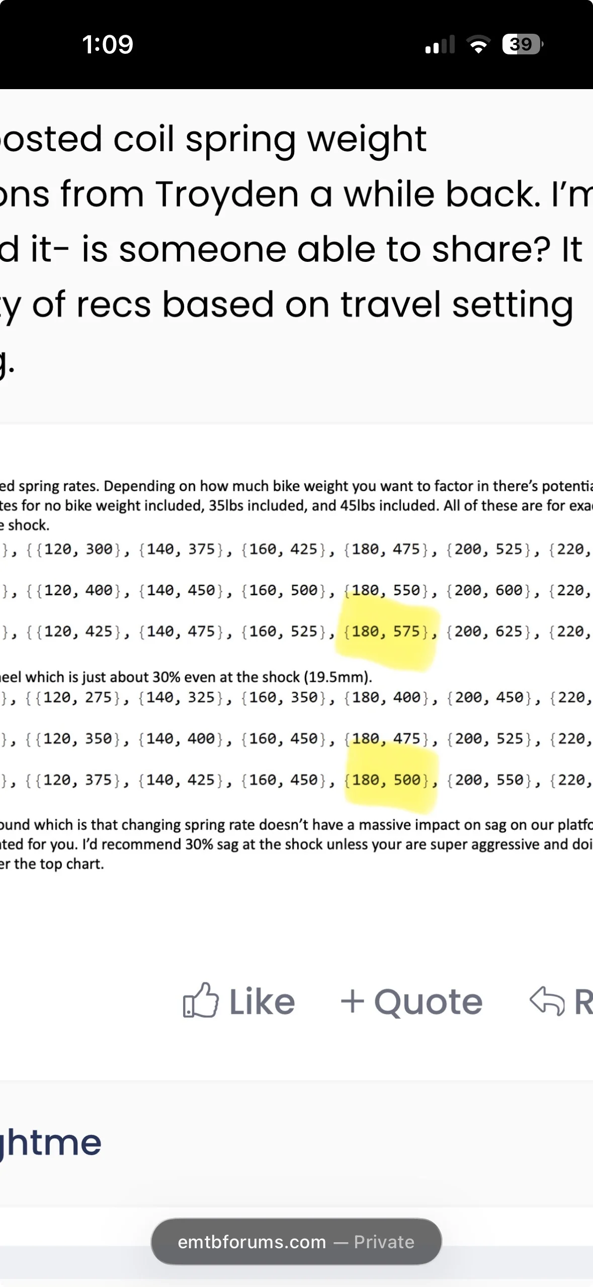

Someone had posted coil spring weight recommendations from Troyden a while back. I’m struggling to find it- is someone able to share? It showed a variety of recs based on travel setting and desired sag
From the FAQ's section. I'm about 190 kitted and 475lb is perfect
140lb rider - 350lb
160lb rider - 400lb
180lb rider - 450lb
200lb rider - 500lb
220lb rider - 550lb
140lb rider - 350lb
160lb rider - 400lb
180lb rider - 450lb
200lb rider - 500lb
220lb rider - 550lb

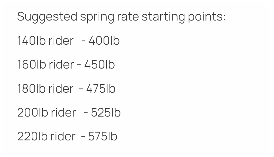

Thanks for this. Interesting that this conflicts with the other chart that Troyden shared. The other chart would put you between a 500-575 (if I’m reading correctly). You are saying you currently have a 475 on a CL frame?
Yes sir, 475 on a Spectre. Maybe 1.5-2-ish turns of preload. A half turn more preload and I'm not hitting 30%... I couldn't imagine running a 100lbs more spring.
On my previous model RS180 I ran 50lbs firmer than that table suggested. Depends on your terrain I guess. I’m 91kg or 200lbs and will be running a 600lbs spring when mine comes in. Maybe even 625.
This is helpful to know. I always end up going over recommended spring rates. I’ve got a 500 ready at 170lbs.
