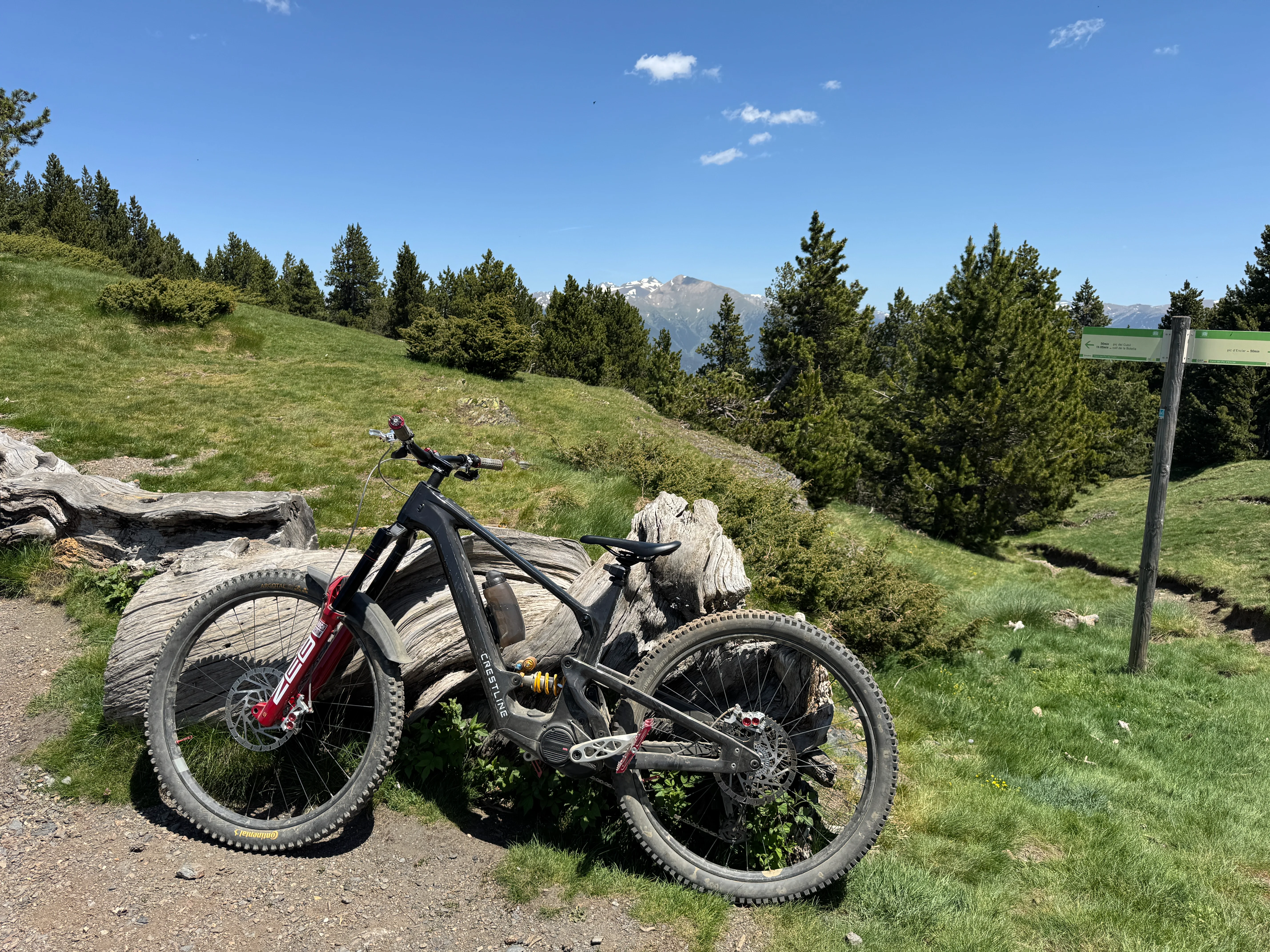

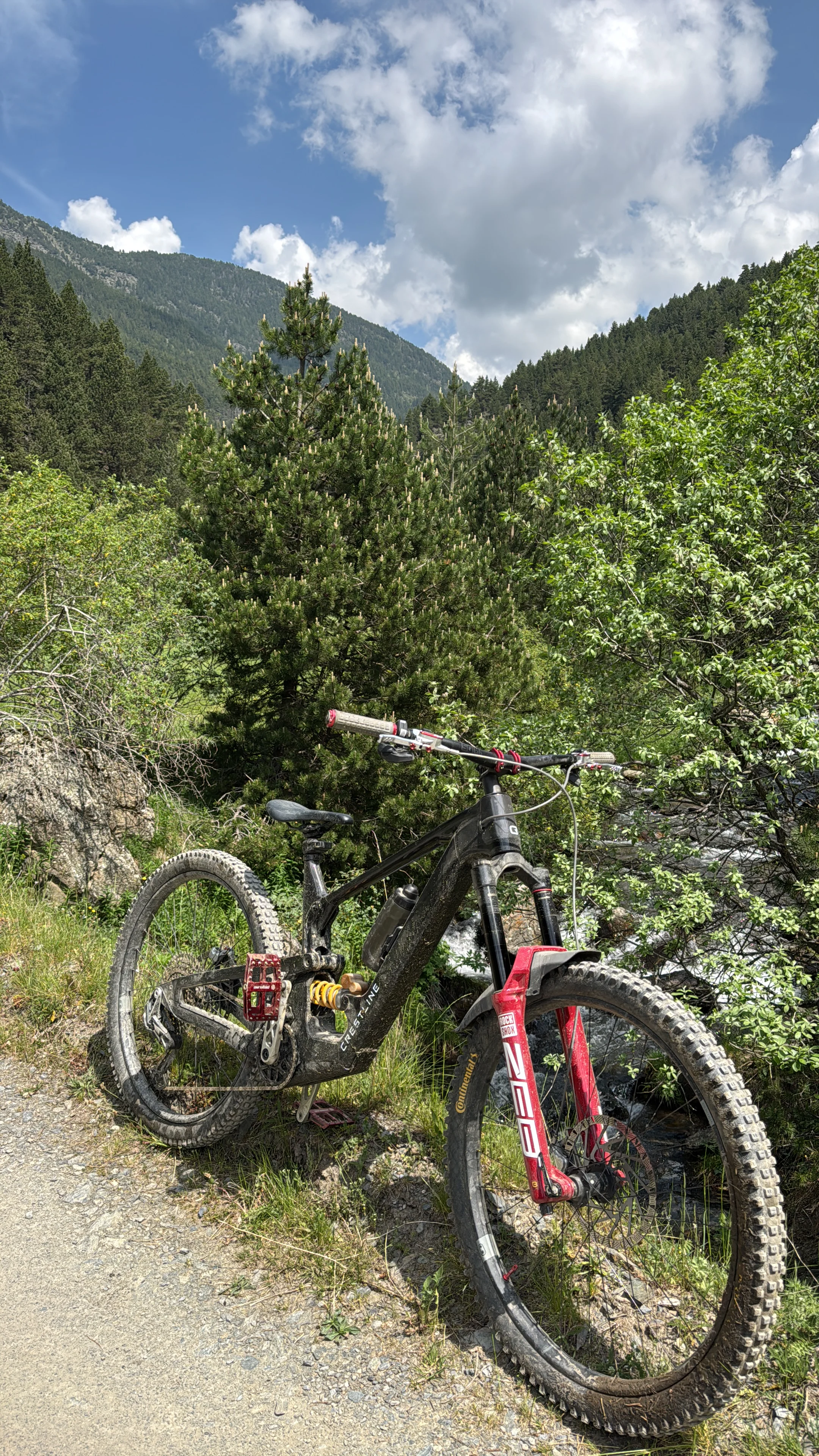

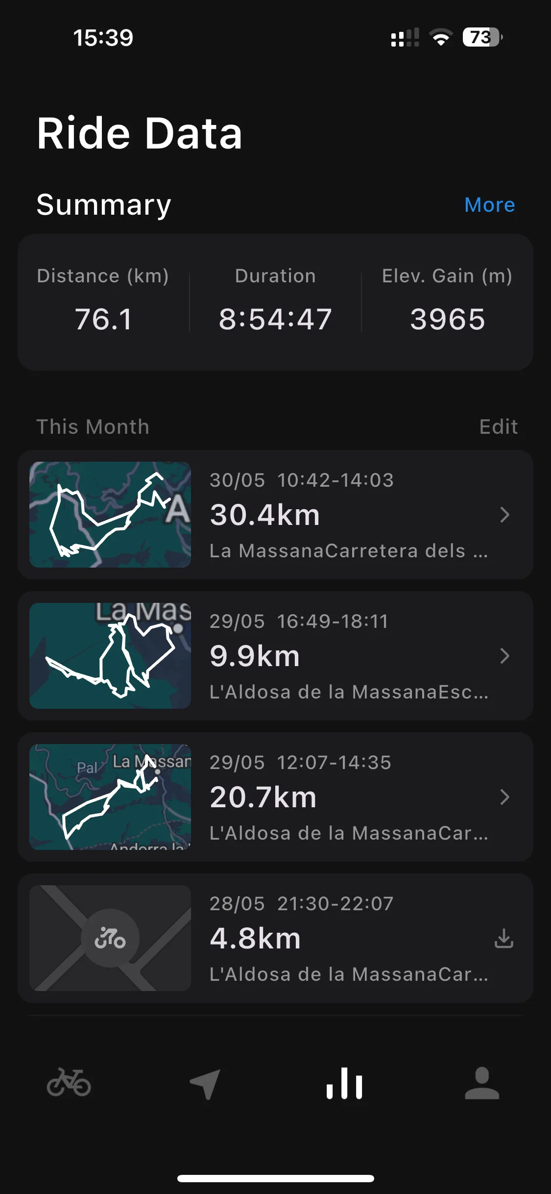

No.53 Checking in after a slow start aquiring the bike and a Battery to go in it. Just done 3 days riding with nearly 4000m up in 76km........
Have an Ohlins installed so looking to sell the unused Fox DHX2 if anyone is interested.
TRP 223 2.3 Rotor with hope V4.......its very Binary here. Steep up and steep down......
Too early to report on the coil. For now I like it.....but its for sure not as crazy plush as my Pole Sonni on the steep offpiste.
Hoping Troydon has my name down for a 200mm rear conversion (hint hint Troyden)

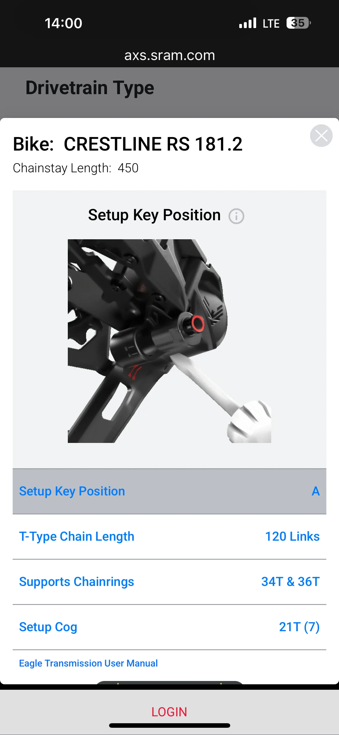

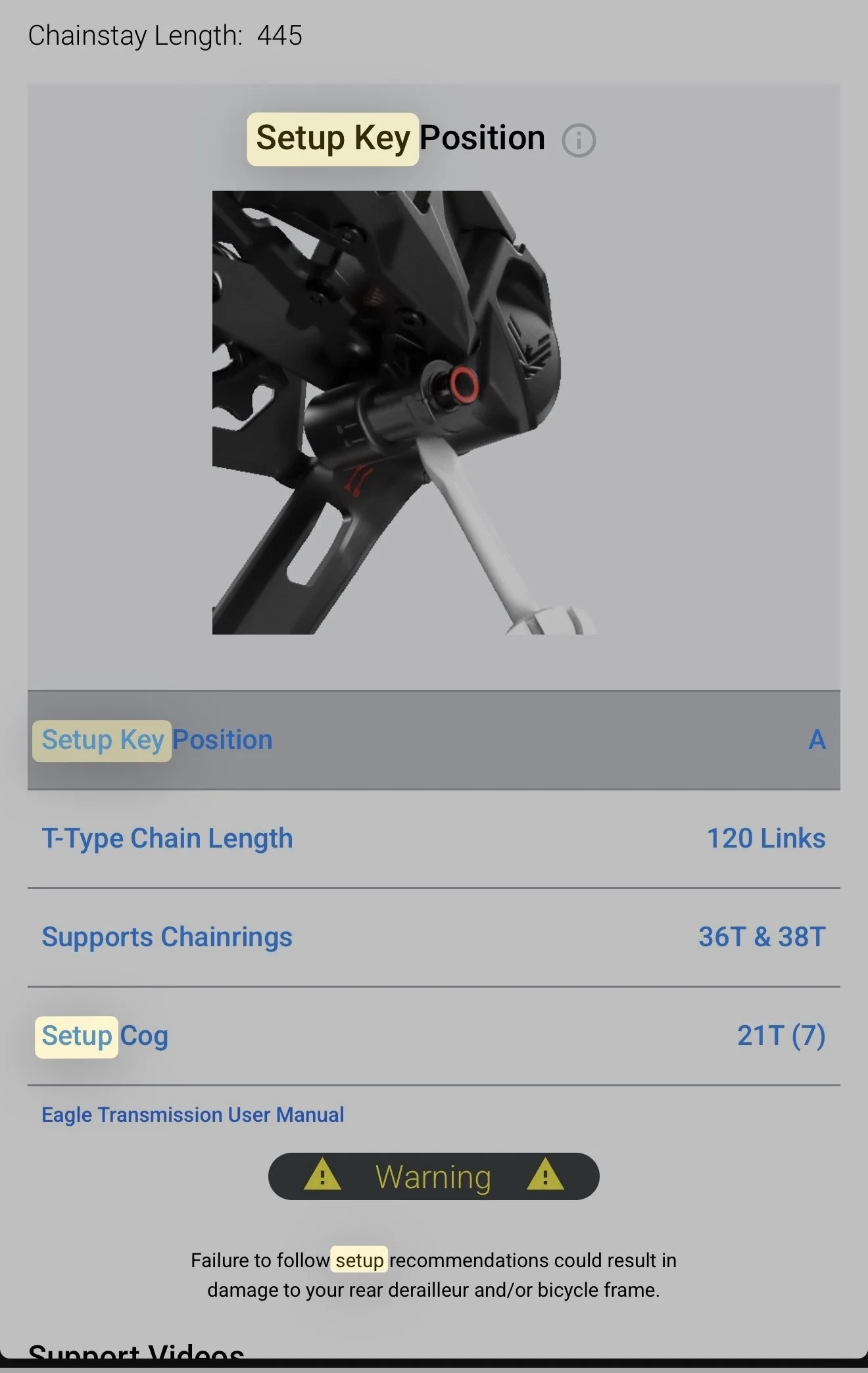

Question for those who are running a SRAM AXS XO Eagle Transmission Rear Derailleur, can you verify number of chain links you're using?
SRAM calculator is tell me 118 links for an RH3 frame with a 36t Chainring.

1st time calculator determined 118 which is why I reached out to this forum.
What size frame are you running? Using stock chainstay length?
RH3 MX 445 stays — 120 links and works like butter

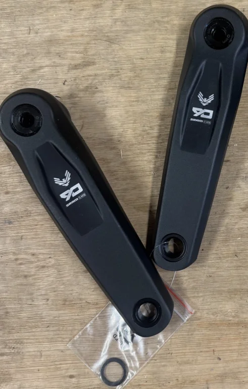

Eagle 90. Cheap, work fine, not super heavy, and only have a small logo so they blend in with all your other parts, even if you don't have a SRAM drivetrain.
Easier to swap out. I have managed to get 2 x 700 batteries, and it takes under 5 mins, and less fiddly (2 bash plate screws. 2 battery screws under downtube.
Which way did you route the cables ?
I’ve got wireless, so only the rear brake and control wire to route. Which I’m thinking of going through the top tube , with both. So I can hit swap the battery. Which is needed for big days in the Lake District
Yup, same reasons I got the eagle 90 155mm cranks.
Oh yeah, I forgot to mention they do 150mm, which few brands do. That was the main reason I got them. I might even go down to 140 or 145 if I can find some cheap-ish cranks in that length without a crazy Q factor. (I'm using a CYC X1 Pro motor, which is pretty wide already.)
