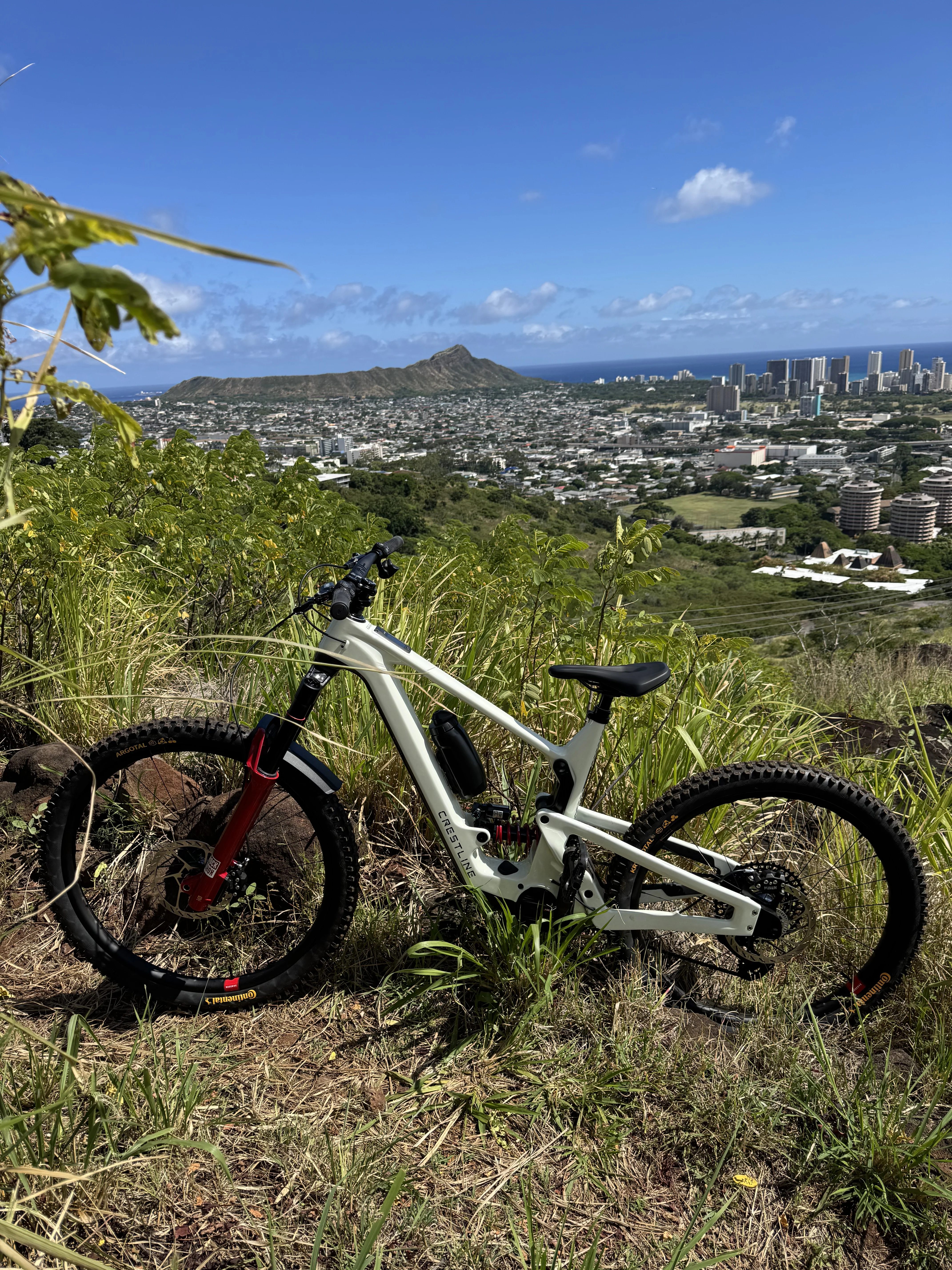

First proper ride post nut snip…finally
5’10, RH3, mullet, 450cs.
Unreal bike.
Sizing: perfect to me. I went 180 oneup dropper slammed and 155mm cranks. I wouldn’t change a thing. 35mm rise oneup bars cut to 770. Wouldn’t mind trying 50mm rise again, but it felt real good as is. Very comfortable.
Climbing: got some steep jagged chunky lava rock climbing in today. I truly thought this climbs better than my amflow (sold) which surprised me. Idk if it’s the longer cs or what. Didn’t have to consciously weight the front on steeper sections and it just ripped. Tires helped too, gripped insane. Did not notice the e13 hub at all!!! I thought the deadband would be annoying but I literally didn’t even notice it.
DH: wow. Surprisingly playful, corners great, eats chunk. I will never use another I9 hub. The e13 sidekick set to 18 degree (max). Dead silent bike. Felt so free of any drag at all, butter smooth, no readjusting feet. Ate the chunk. Mavens need a little breaking in though. Zeb and vivid coil felt good, I need to tinker a little with it though and get some rides where I’m pushing harder to give better review on that.
M2S: Again dead silent. I just ran auto all the time on m1 and did same for most of the ride today. Felt pretty similar. The hugggggeeee improvement I felt that I never did on my m1 was toggling on the quick start in advanced features. This made a big improvement when you stop on a climb. Smoothshift was super rad too for dh (didn’t have on my m1 since had cable derailleur). It’s sick being able to upshift multiple while coasting then as soon as you pedal it’s already in that gear. If you have m1, the M2s isn’t worth the upgrade to me. Well, mine wasn’t rattly though either. M2s was dead silent of any rattles (I’ll update if that changes). Only noise I got was in gear 12 on the road in turbo I was getting a click in derailleur and played with micro adjust a little but couldn’t get it to stop.
Contis: dude these things grip! Argo front krypto rear. Can’t wait to see how they do in mud. Always rode assegai F and dhrii R and hate how they pack mud here.
Will update as I get more rides in. Super stoked though!

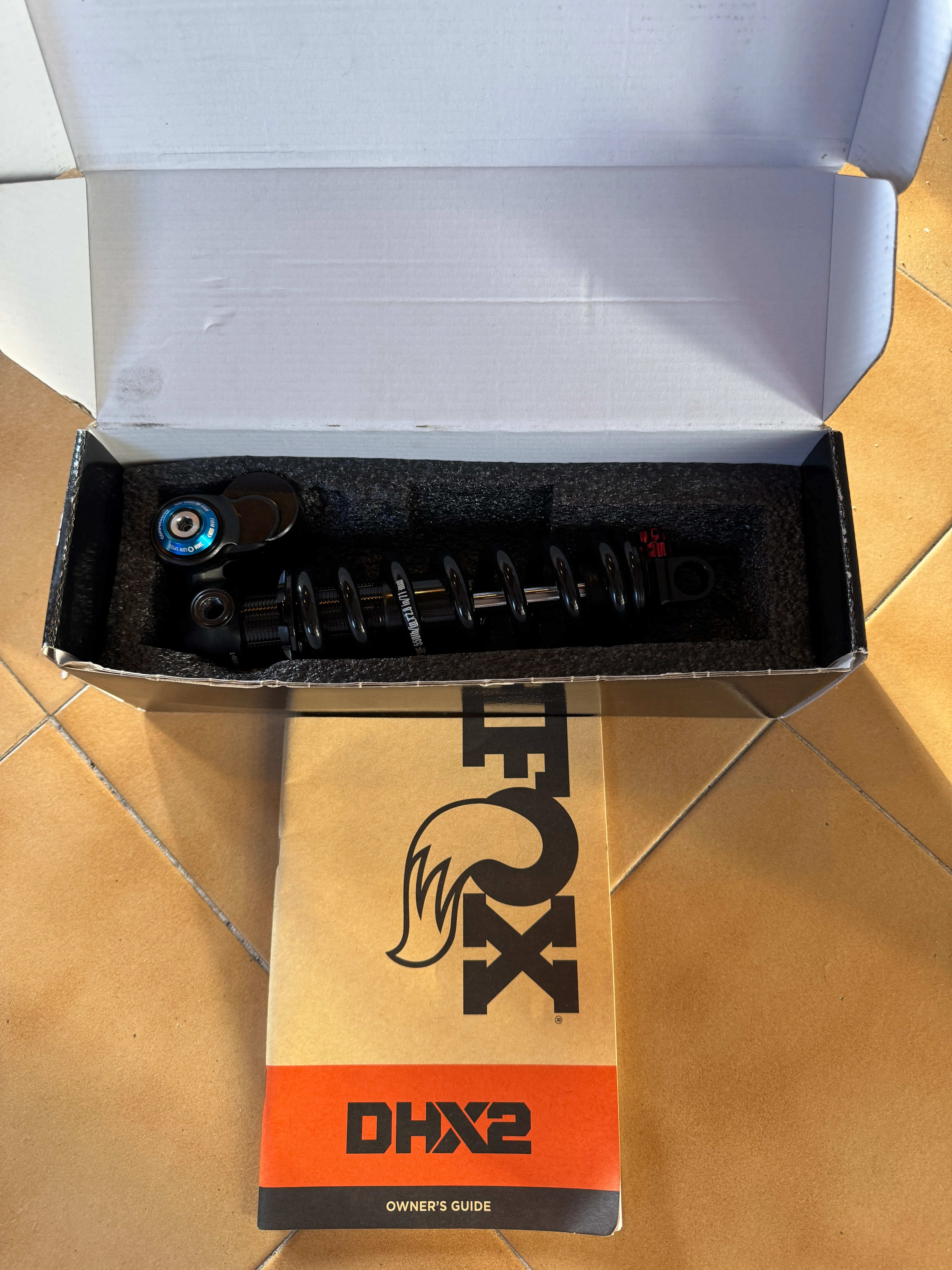

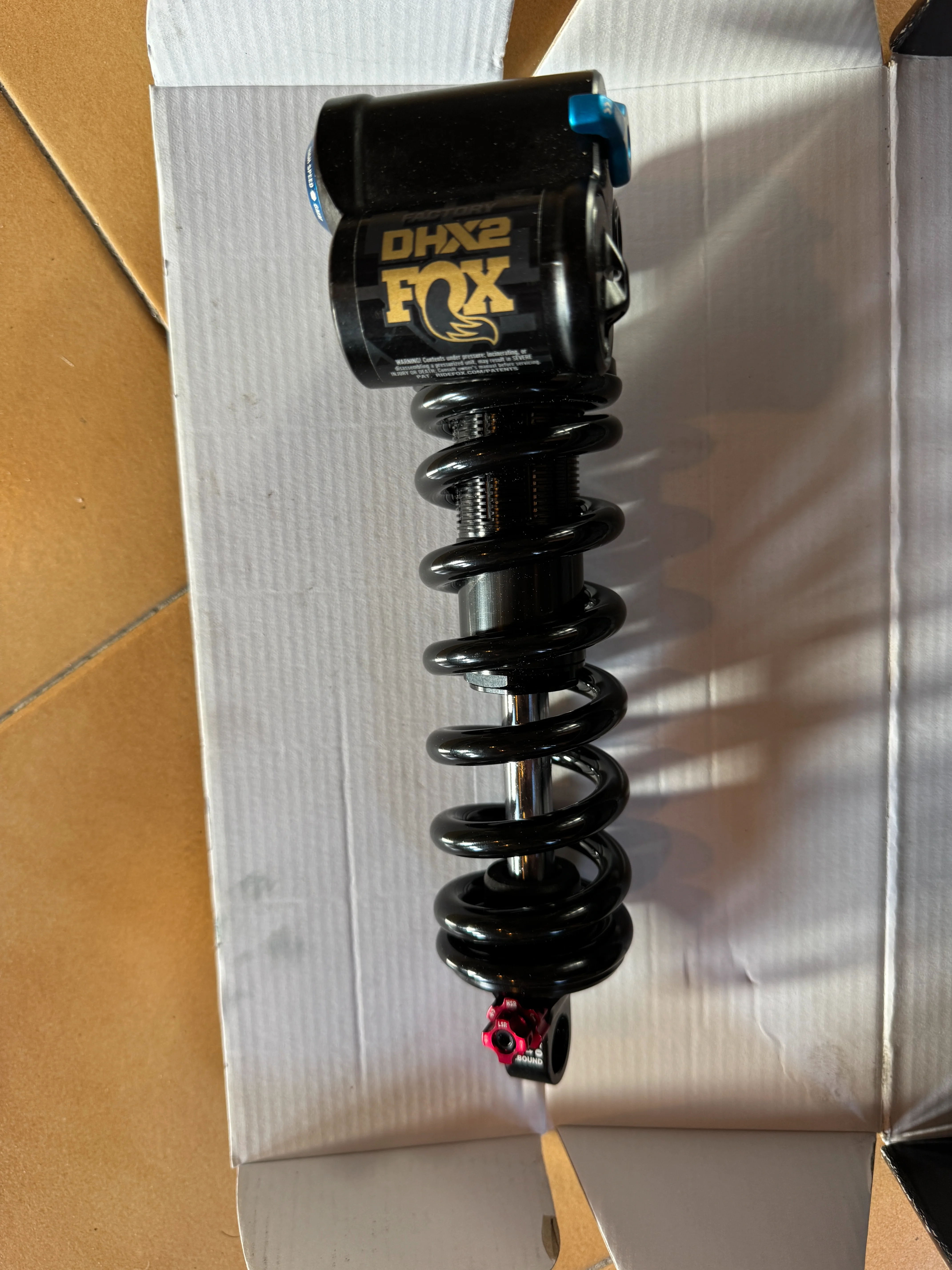

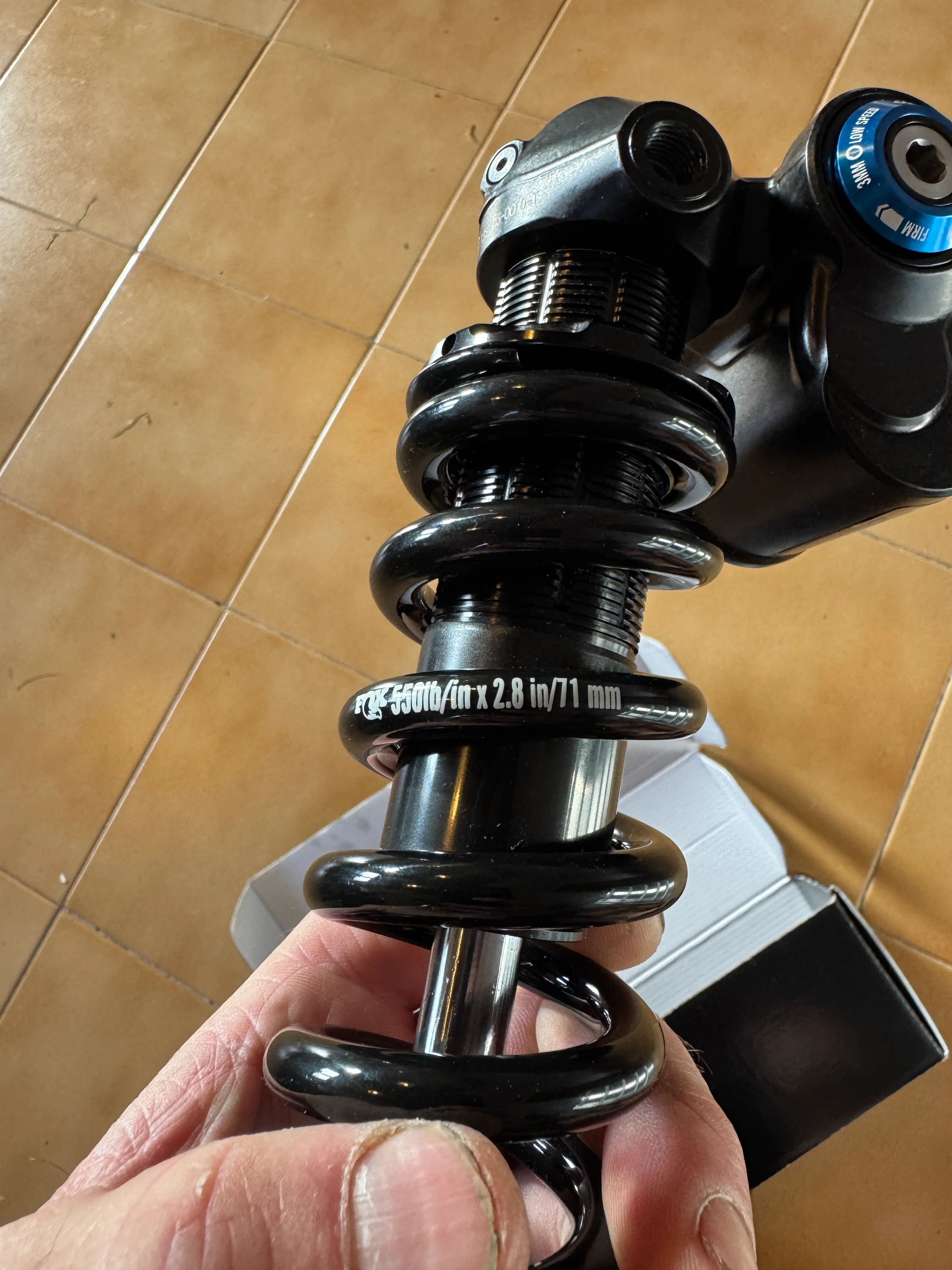

Mine was shipped with the DHX2 and a 550 Spring......never used it and swapped out for a Ohlins TTX with a 525 Spring to be truly in the sweet spot I am 100kg fully loaded. The DHX2 is for sale and I can send with my work mate to the states on the 25th June if anyone state side is interested

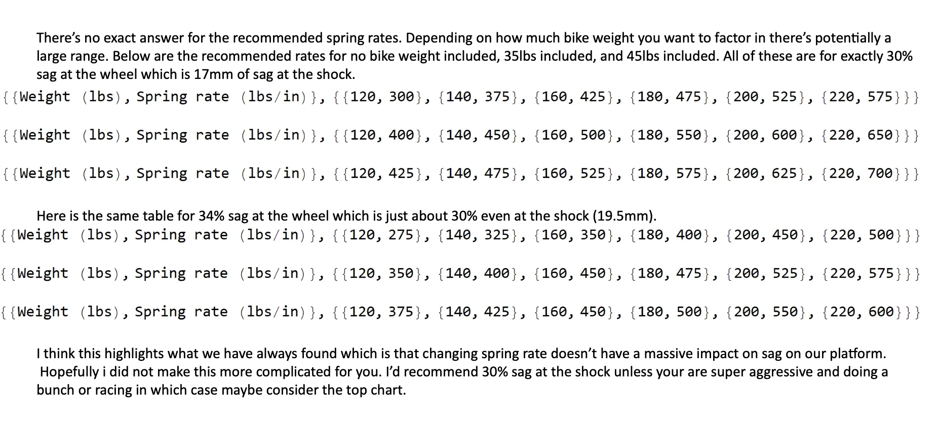

I’m curious what spring rates people are running. I’ve seen the charts etc. Just want to know people’s actual experiences. I’m 150lbs on a rh2 with a 400 pound coil dhx2. The rear feels a little tall to me so I’m considering trying a 375. I wish it was a little easier to swap coils
I use to be the same weight and 375 will get you at 30% sag. Im now 160lbs geared and running a 400lb spring.
