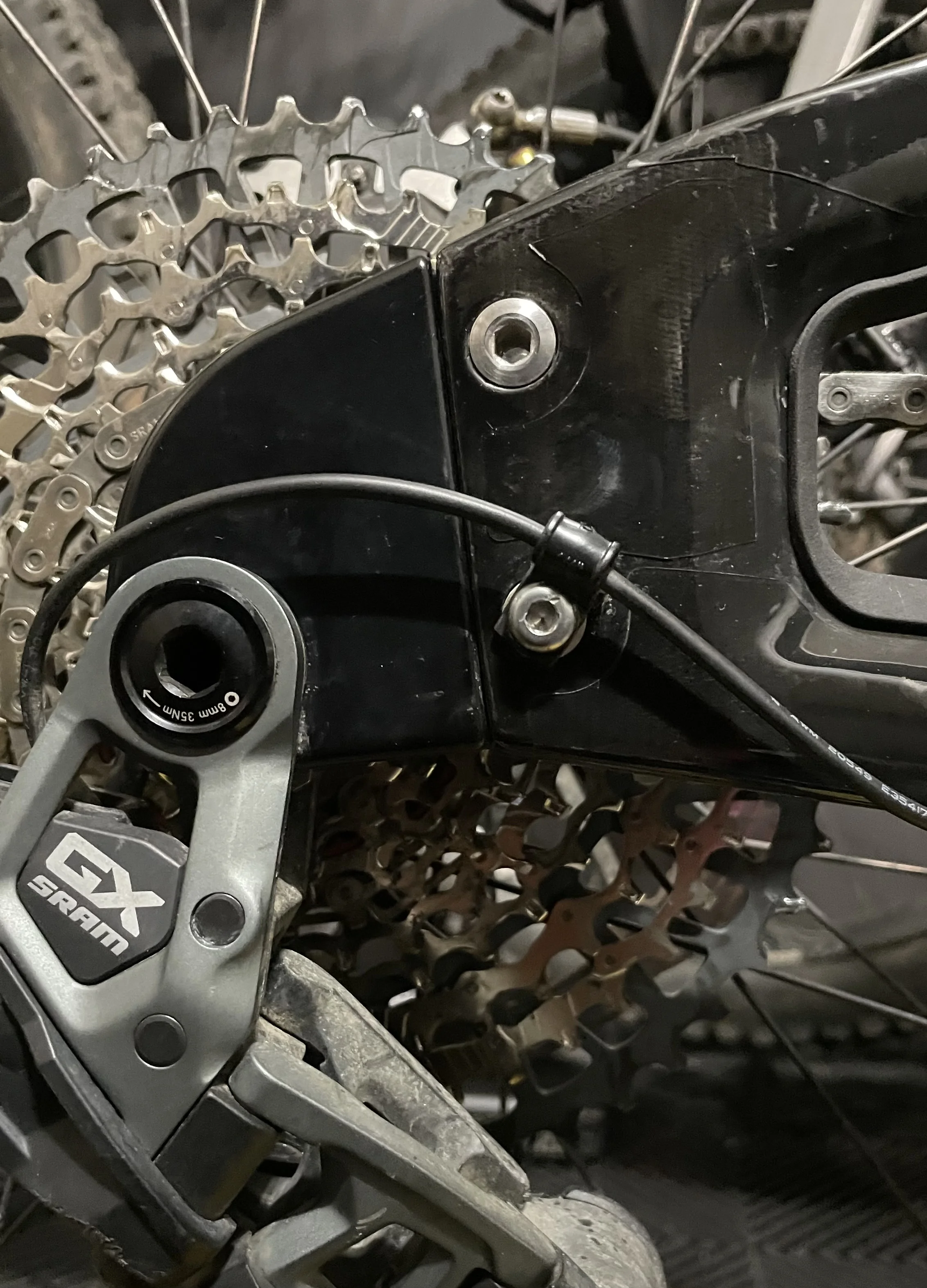

Speaking of the sram power cable, how are y’all routing it to the hanger? Currently mine is routed between the UDH mount ears on the derailleur.
Learned this from someone on 181.1 thread (AlumiPro), done on both .1 & .2.
Plastic cable hold down using a stainless M5-0.80 x 20 bolt that goes through the factory hollow dropout fastener, and the nylon lock nut fits perfectly inside the drop out allen fastener on the inside so you only have to tighten the bolt on the outside, while the inside dropout allen holds the nut from rotating.
