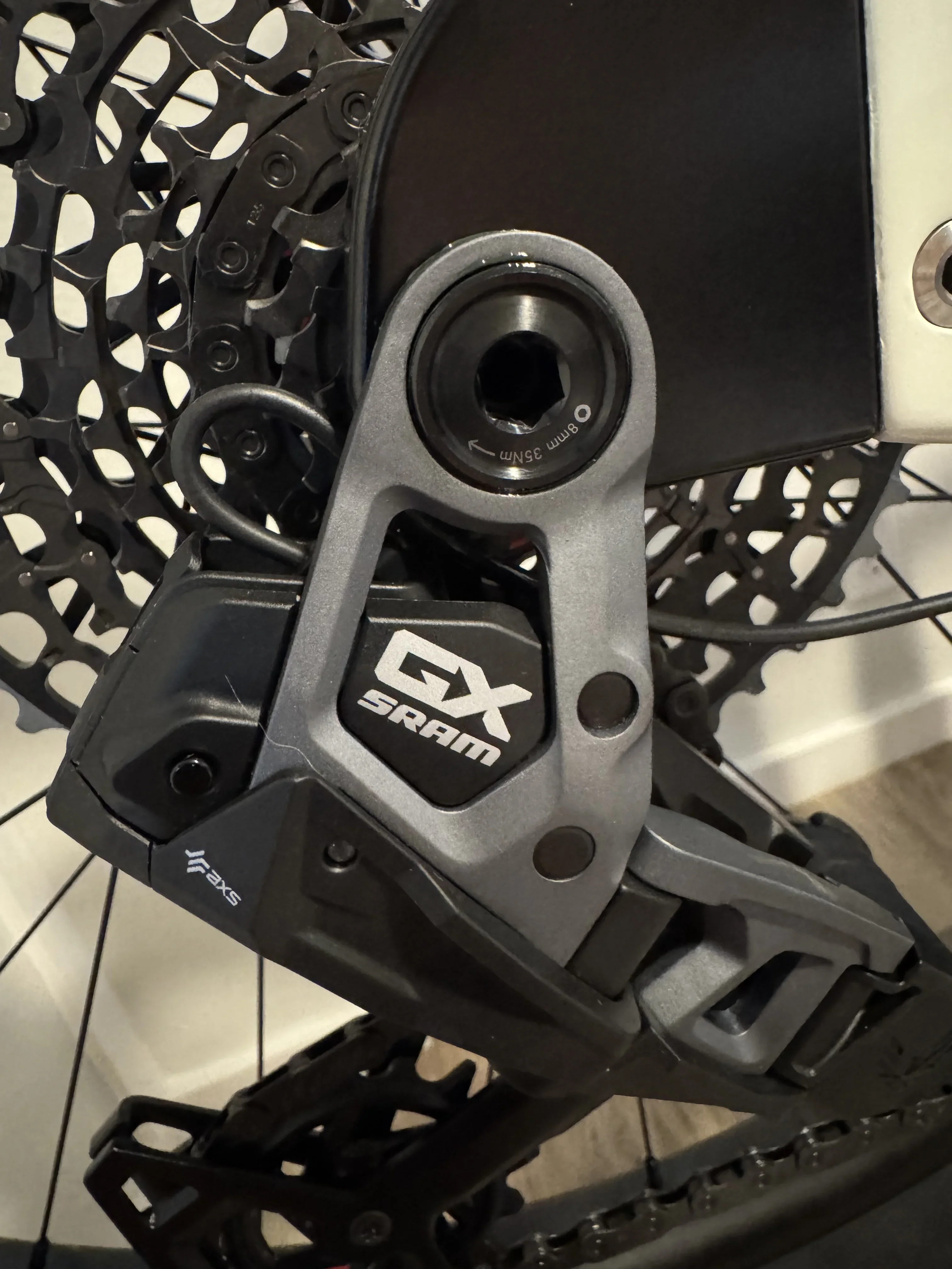

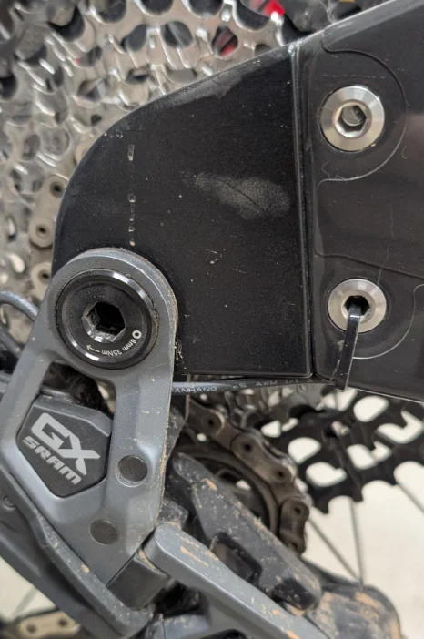

I have it outside the frame. Seems to sit flush and doesn't move. I didn't like how running through the UDH mount made a big gap under the chain stay.Speaking of the sram power cable, how are y’all routing it to the hanger? Currently mine is routed between the UDH mount ears on the derailleur.
I went with the Wolf Tooth 200mm dropper post. Shortest insertion length available. If the 210 is on the edge of being too long, 200 with better insertion will be on the money, I’m guessing.Man, I tired the line, string, shifter cable, all taped to the cord and nothing.
Finally a fished some trimmer wire in there and taped the end butt to butt and barely made it through. Something about the chain stay bend was getting the plug hung up.
All good. SRAM instructs us to route the cable between the UDH 'ears.'Speaking of the sram power cable, how are y’all routing it to the hanger? Currently mine is routed between the UDH mount ears on the derailleur.

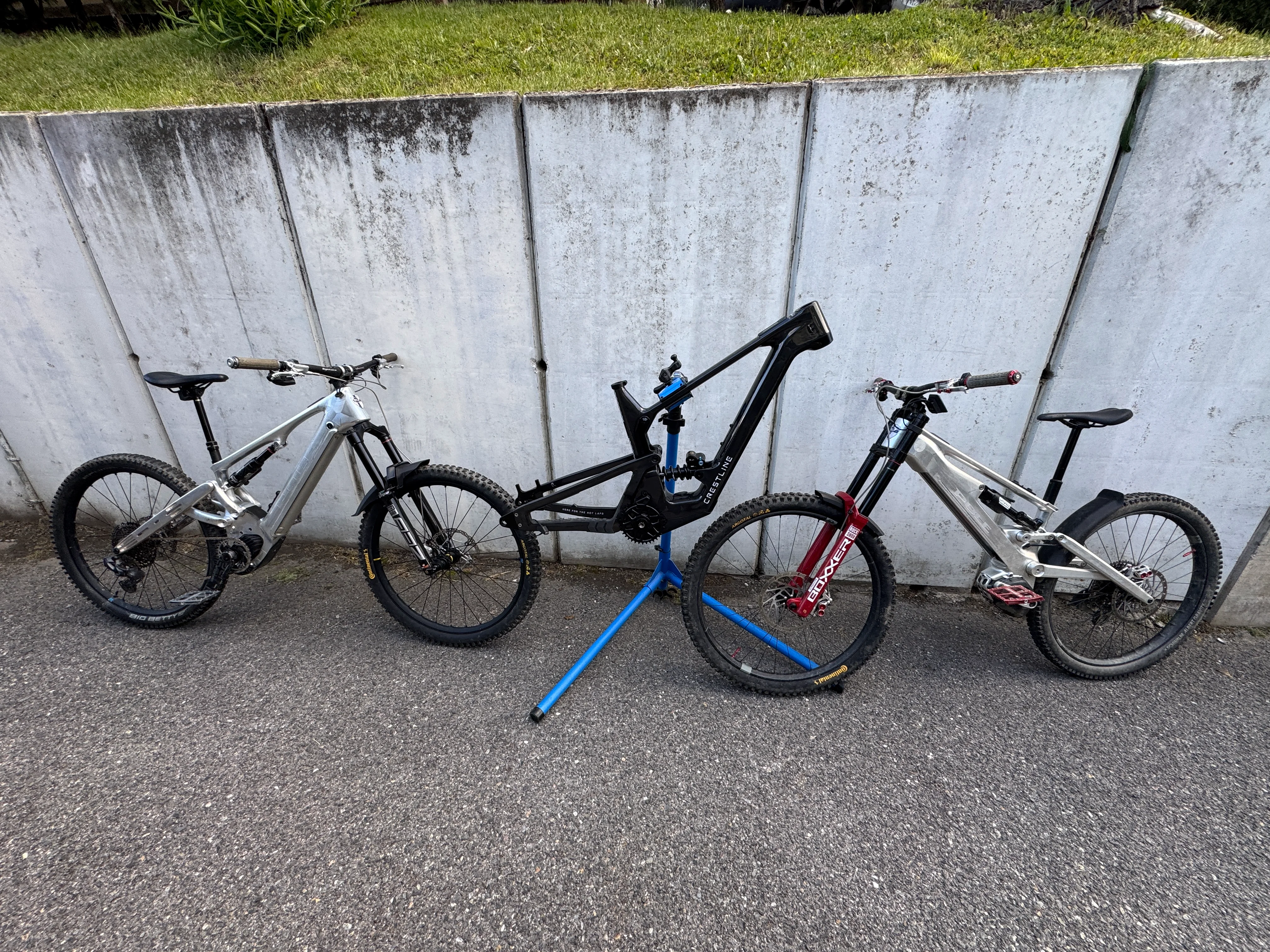

Sorry to hear about your battery. Is that the Forged or the Raw frame?Chassis No 53 checking in......had to go and rescue from the USA and the Build is starting.......if anyone in the USA needs a 800w battery I have mine stuck in Florida (no go on airlines).....PM me.
also have to sell a Pole Voima and or Sonni as 3 top tier Ebikes in the Garage is a bit silly.
its a raw Plaid. will be robbing bits of the Poles for the build.......got a loan Battery until I can get one over here....Sorry to hear about your battery. Is that the Forged or the Raw frame?
Glad you were able to get a loaner battery. I had similar issues when I bought an emtb from Canada and tried to ship to US.its a raw Plaid. will be robbing bits of the Poles for the build.......got a loan Battery until I can get one over here....
Nice! I also parted out my Voima to build my raw Plaid. You’re going to love it. I’m curious to see how it compares to both of your Poles. My Voima has the CX Race, and the Avinox blows it away. Way more power, but also more controllable. Climbs that were super steep and technical are now a lot easier on my Plaid. It’s also 3.5lbs lighter than my Voima with the 750 battery. Seems like Leo is losing a lot of customers to Crestline.Chassis No 53 checking in......had to go and rescue from the USA and the Build is starting.......if anyone in the USA needs a 800w battery I have mine stuck in Florida (no go on airlines).....PM me.

After much debate, I have run my Sram cable the same way you described. No issues so far.
