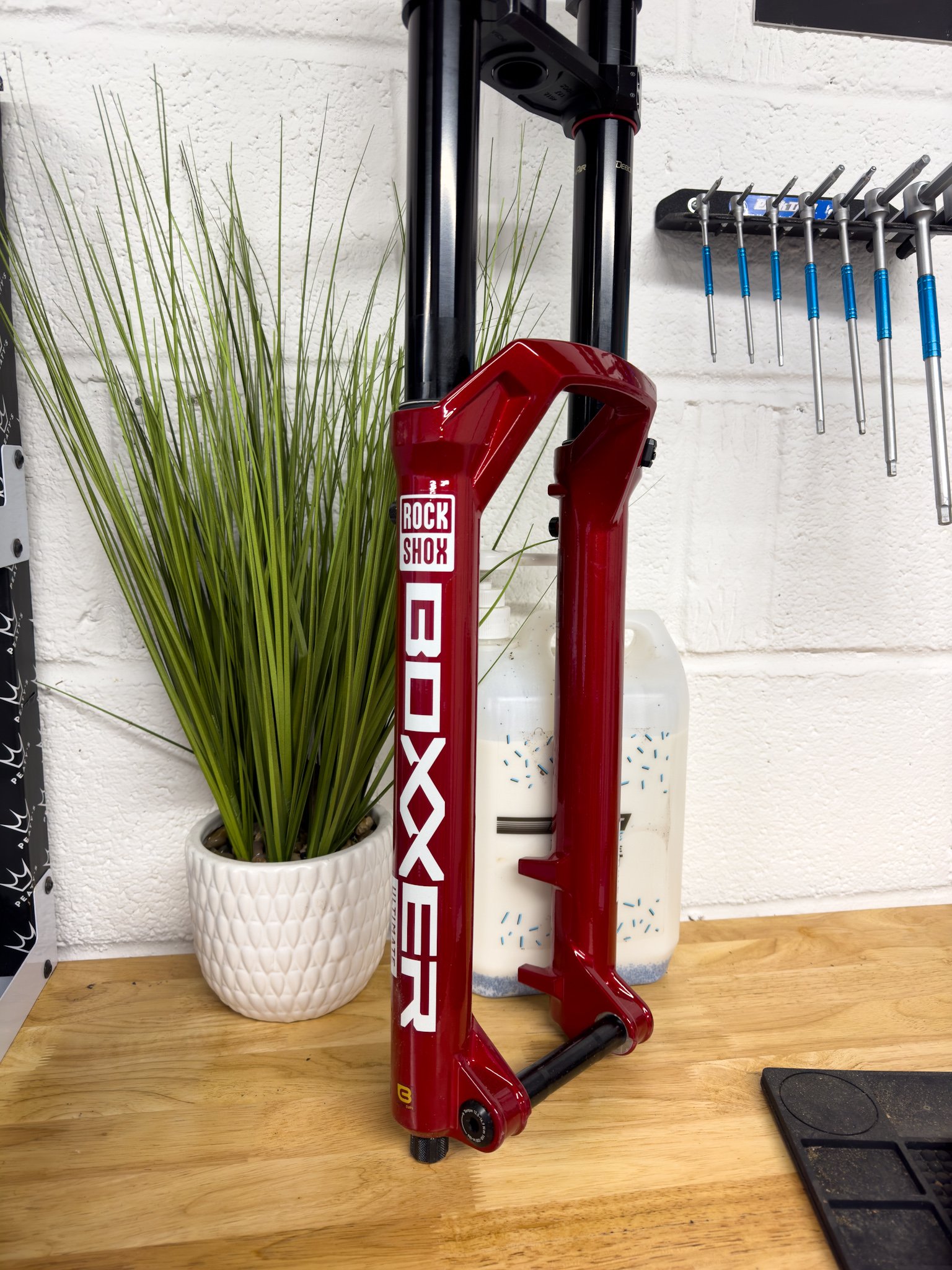

I ordered a 2024 Boxxer, will be here tomorrow so will give it a go.

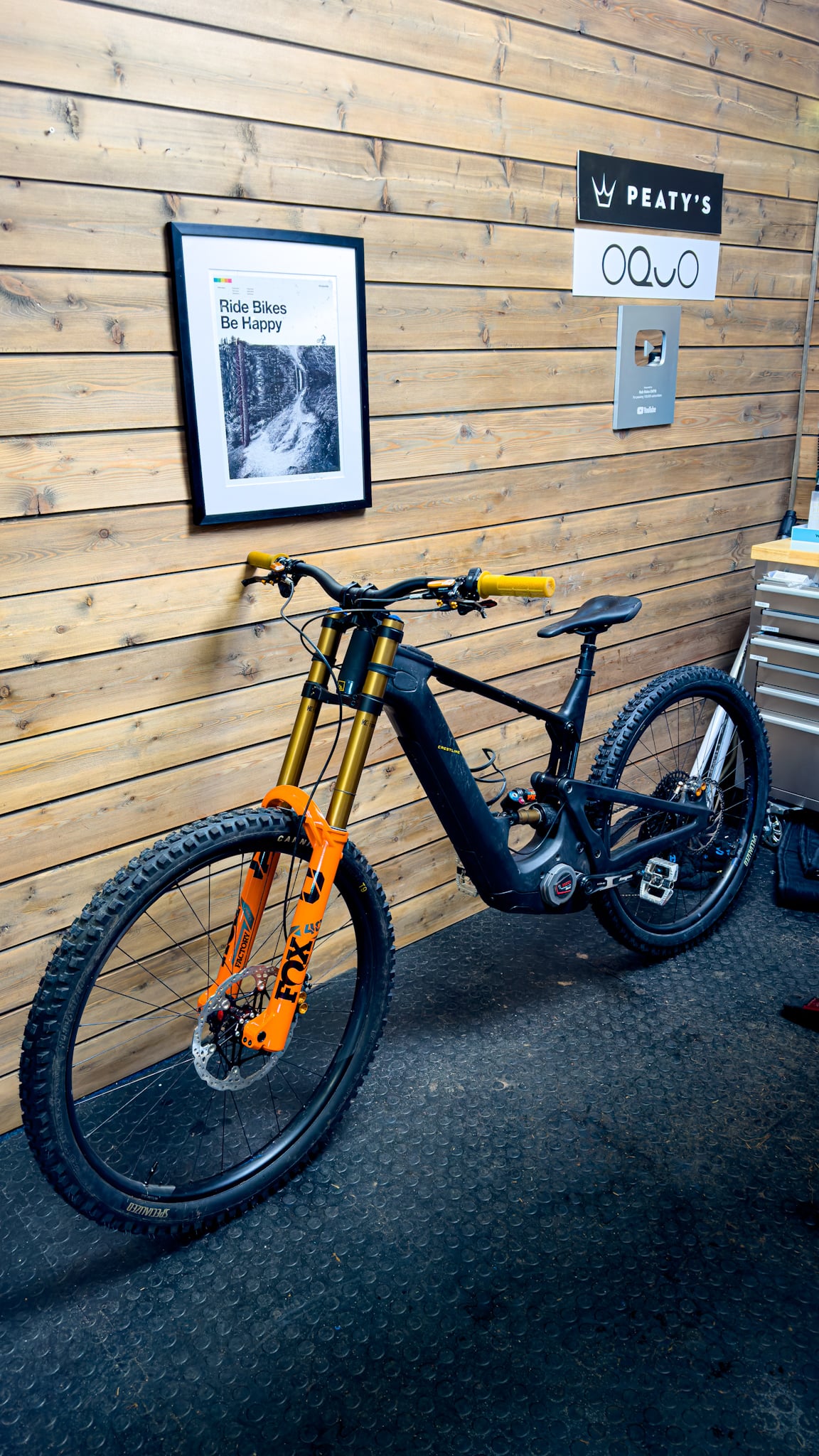

I really liked the Ohlins DH38 on the Haibike NDURO 8 that I have in for test, although thats only 180mm, so if I have time i'll get that changed to 200mm to test aswell.
Crestline really is the perfect test bench for this kit!

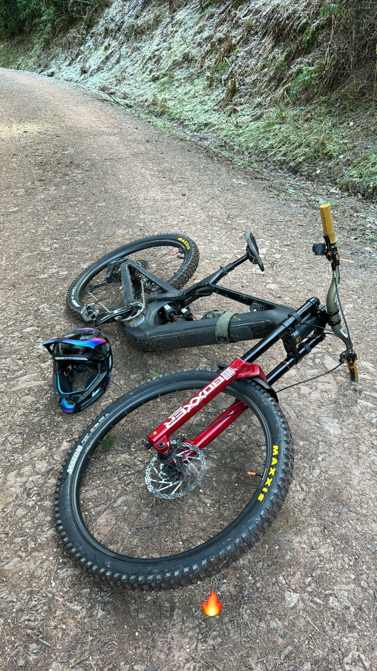

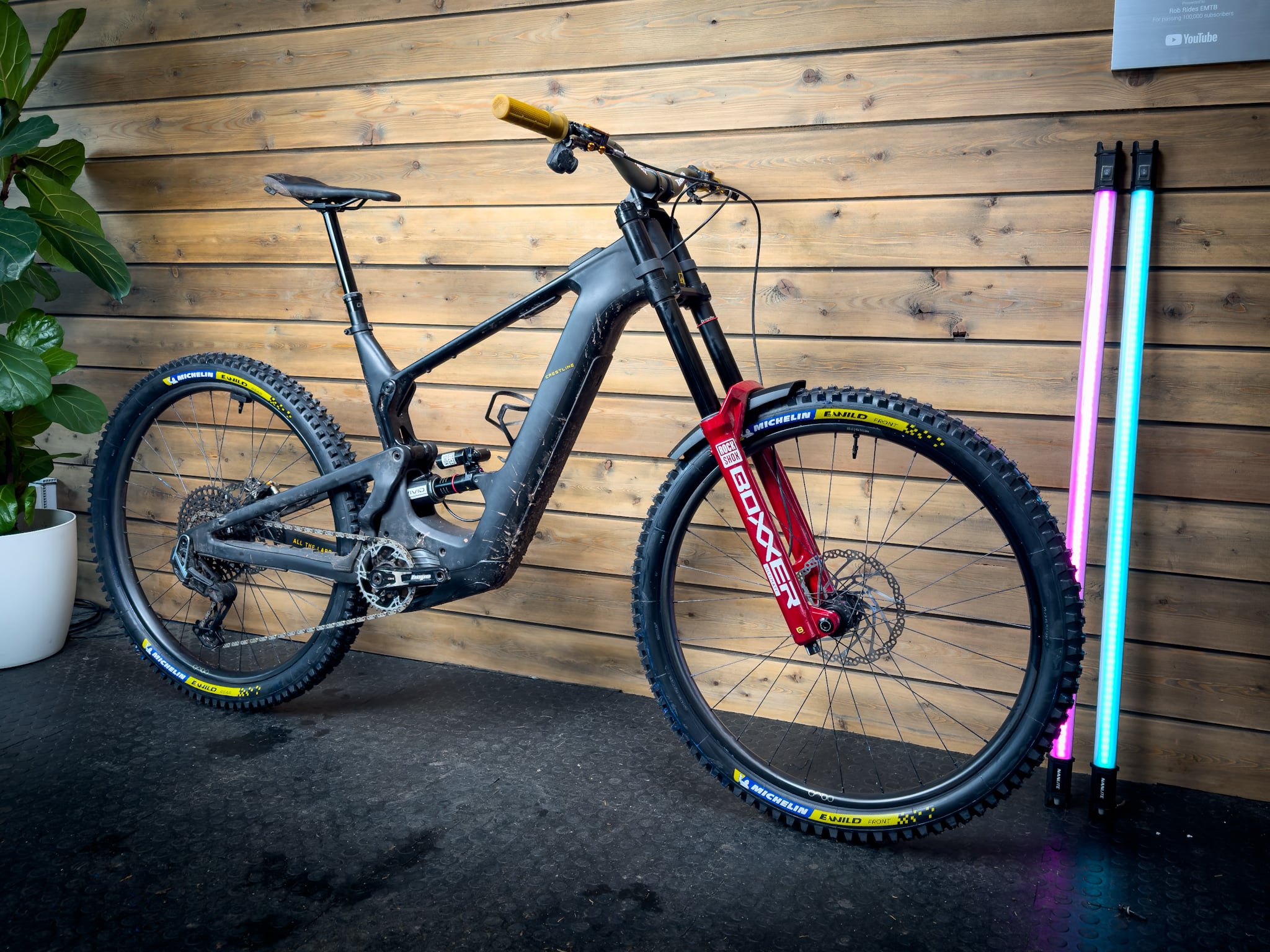

Few laps. Back to full 29, Vivid and Boxxer.
I’ll get some more time and give some feedback but felt pretty damn sweet on the first runs.
Original geo pretty much. Love the adjustability on the Boxxer / dual crowns, with scope to change axle to crown etc.
