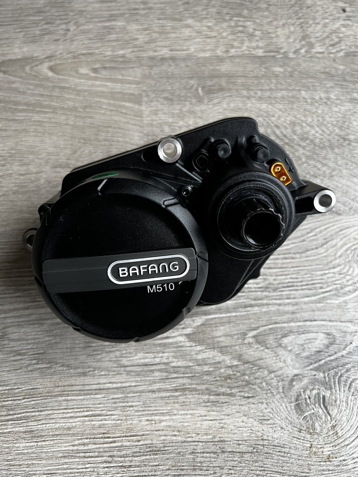

Just an FYI - Bafang contacted me today to say the M510 is still under development but will be sent as soon as its ready for the CHEEB V2.

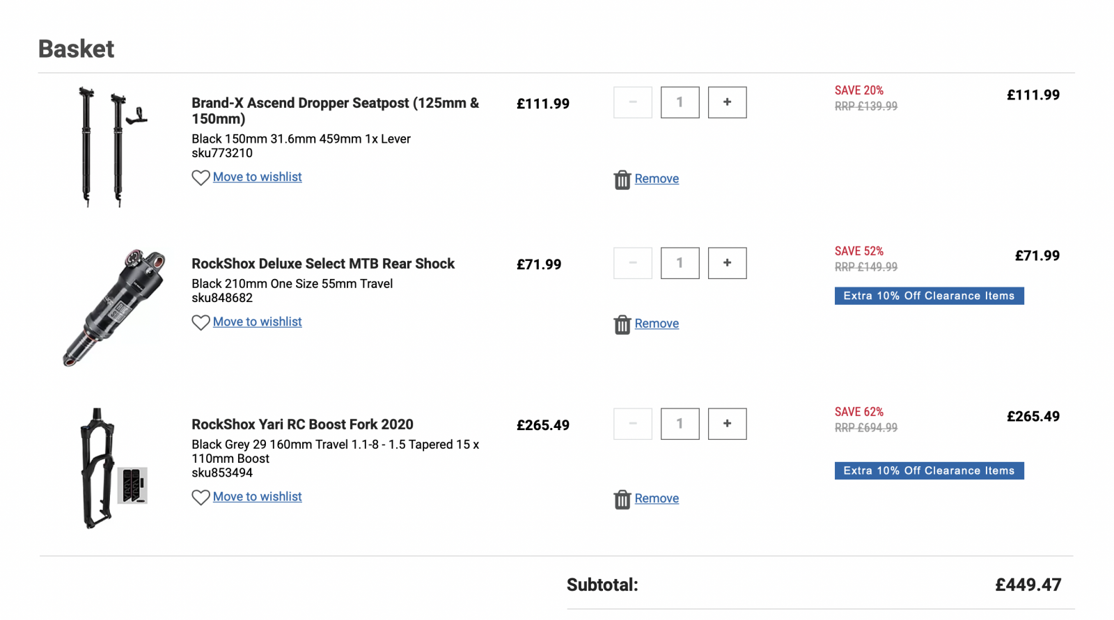

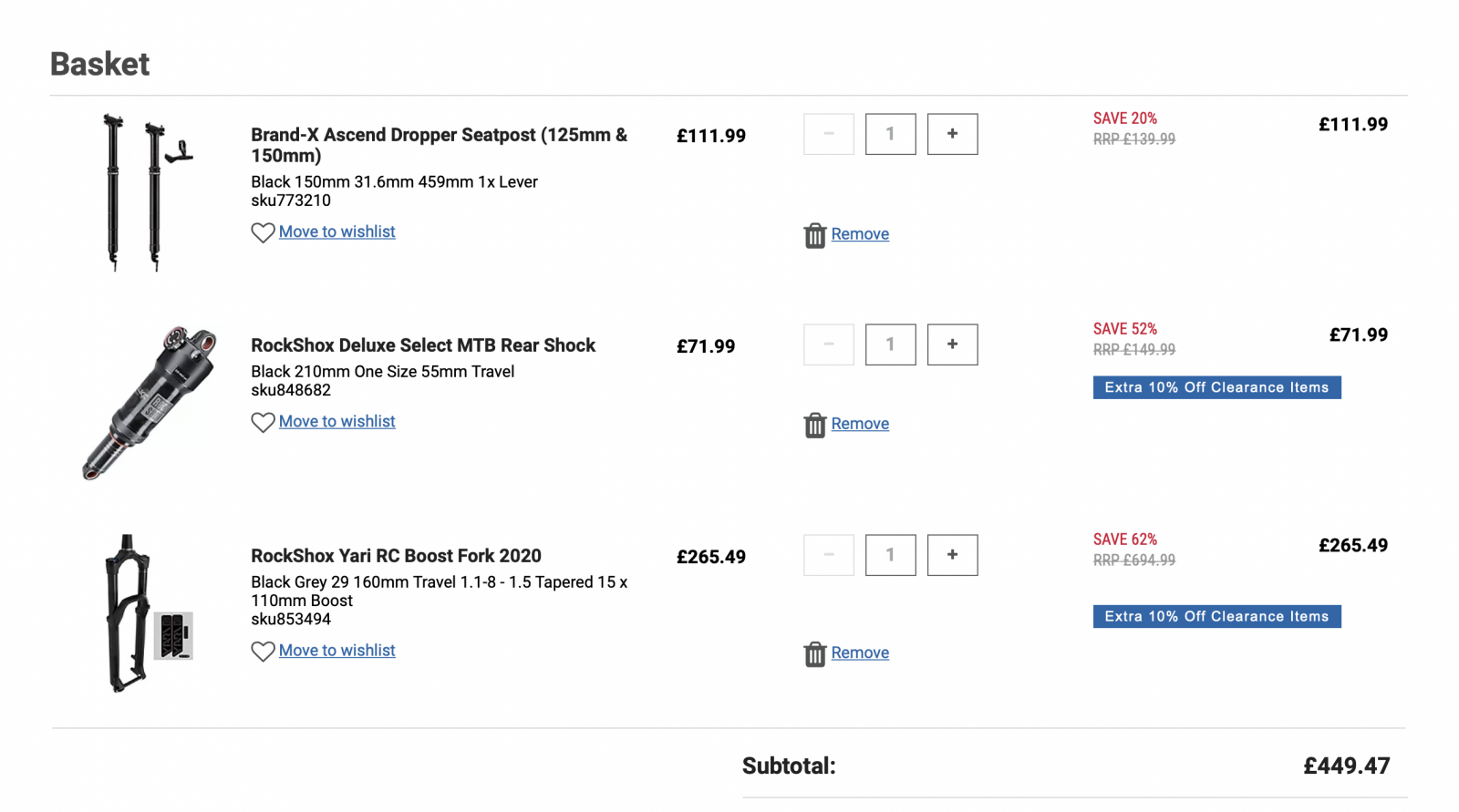

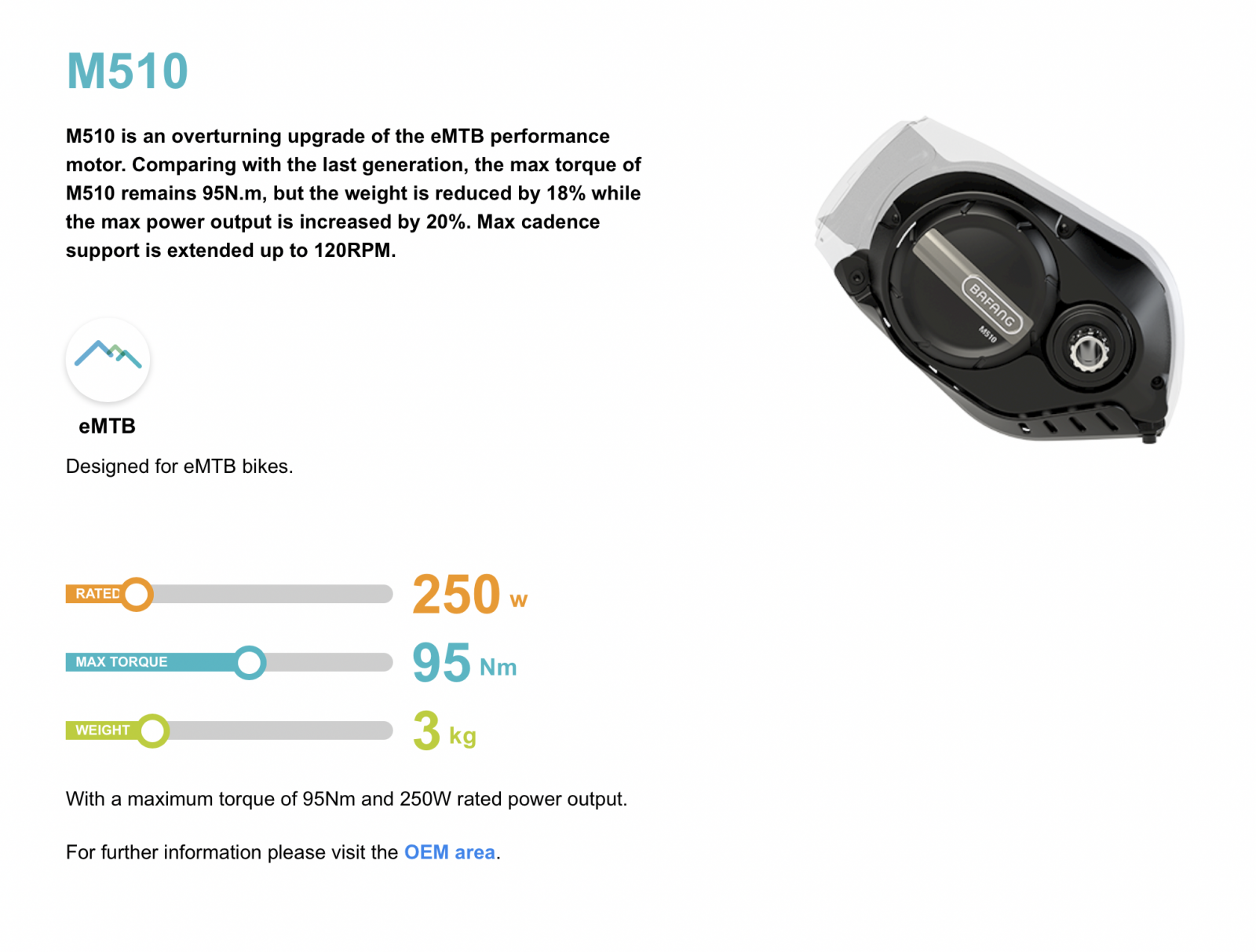

New M510 motor, 20% more power, 18% lighter. And some amazing deals on at the moment at CRC - Yari fork for £265 is a steal!!
The goal is to keep the entire build at £2999 or under.

Thanks for the heads up about the forks, just ordered a set for my wife’s Cheeb. Do you have your M510? Dengfu don’t have a date yet.
