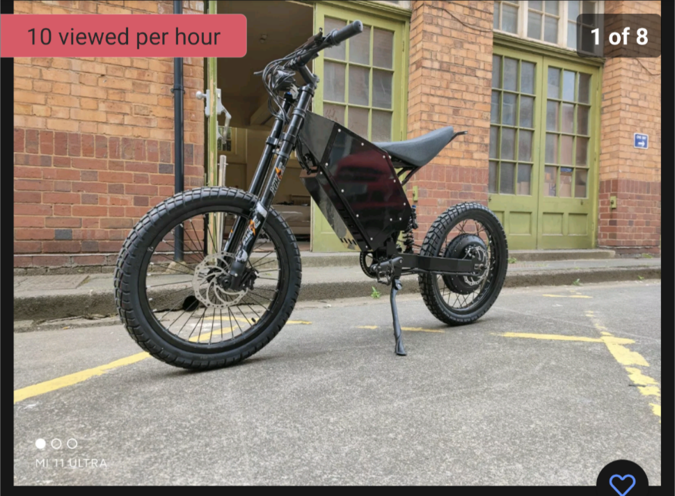

Yeah as long as your bike doesn't look like this you are unlikely to get stopped:
Not that I wouldn't mind one of those if I could ride it without that worry!
