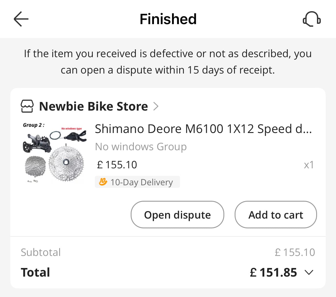

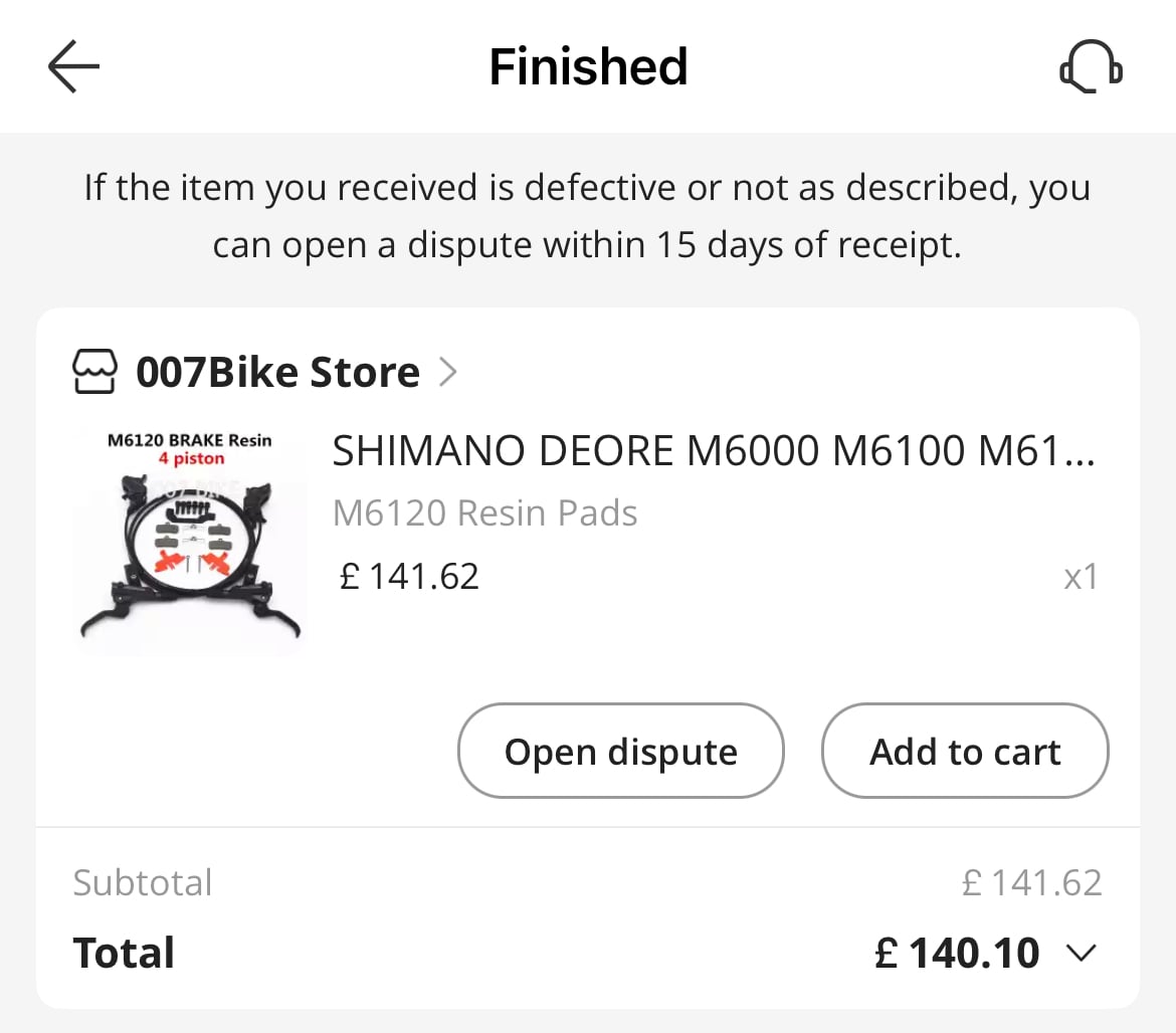

Doesn’t have to be expensive. There’s some great kit at value prices. Entire Shimano Deore 12 speed drivetrain at £151 shipped. I have a spreadsheet with all costs!

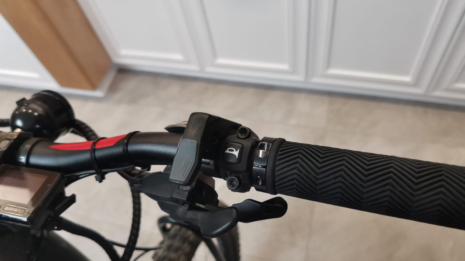

Throttle is pretty cheap ~5 eur, worth trying. I am glad you received M510, cant wait the feedback :)
I recommend such a throttle valve. She's on the right. It is very convenient for her to shift gears if she lifts the rear wheel with her left hand. And it is also needed to drive deep rivers, you can put your feet on the steering wheel :-) and go.

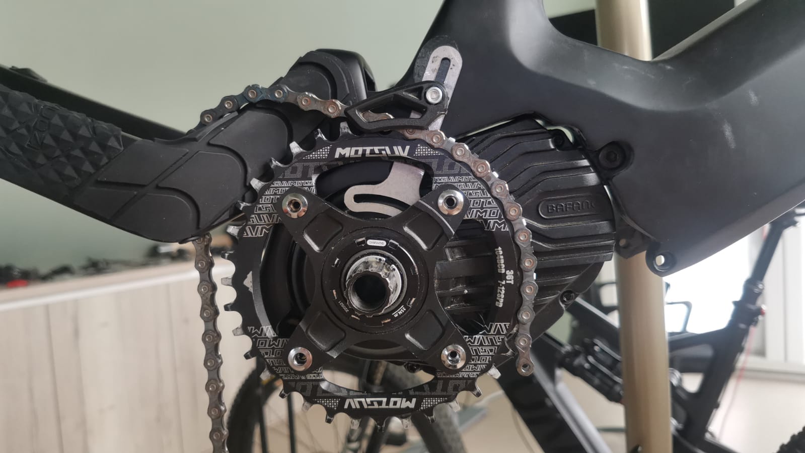

Attention! If you want a minimal chain misalignment on the new spider from the M510! The star fits only 36 teeth on the E10 frame. Or 42 teeth on the outside of the spider. I glued thick rubber so as not to spoil the frame. The distance between the chain and the frame is 2-3mm. I will check if the gaskets will last for a long time. 9 stars at the back give 47km of speed. Cadence 90 I think I have enough.

Pssst, chuck the chain aligner, you won't need it with a Narrow / Wide chain ring.
You may be surprised just how far out of the ideal alignment a chain can be on a modern cassette and deraileur before you start to get changing of the gear problems.
I don't want to ruin the frame. I used to have a case on a carbon frame. The chain fell on the rear triangle and damaged the triangle.

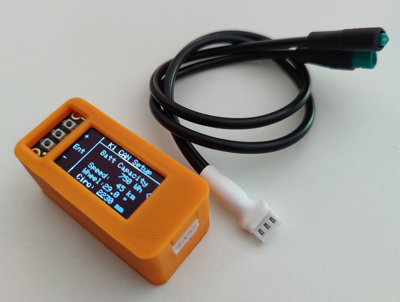

Hello ebikers.
K1 eBikes has designed small, portable and simple K1 CAN Monitor & Speed Unlocker - no need computer or mess with BESST. Works ONLY with Bafang motors with CAN bus (green connector to display with "house" shape 5 pin connector).
For more info check the following link:
https://endless-sphere.com/forums/viewtopic.php?f=31...
How to unlock speed:
https://youtu.be/6z3TzEqNWsQ
If you interested, send an email to [email protected], will answer any questions and will send user manual.
K1 CAN Monitor is determined for testing purpose only and is not waterproof.
