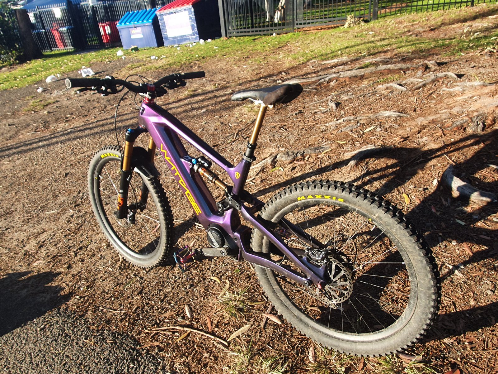

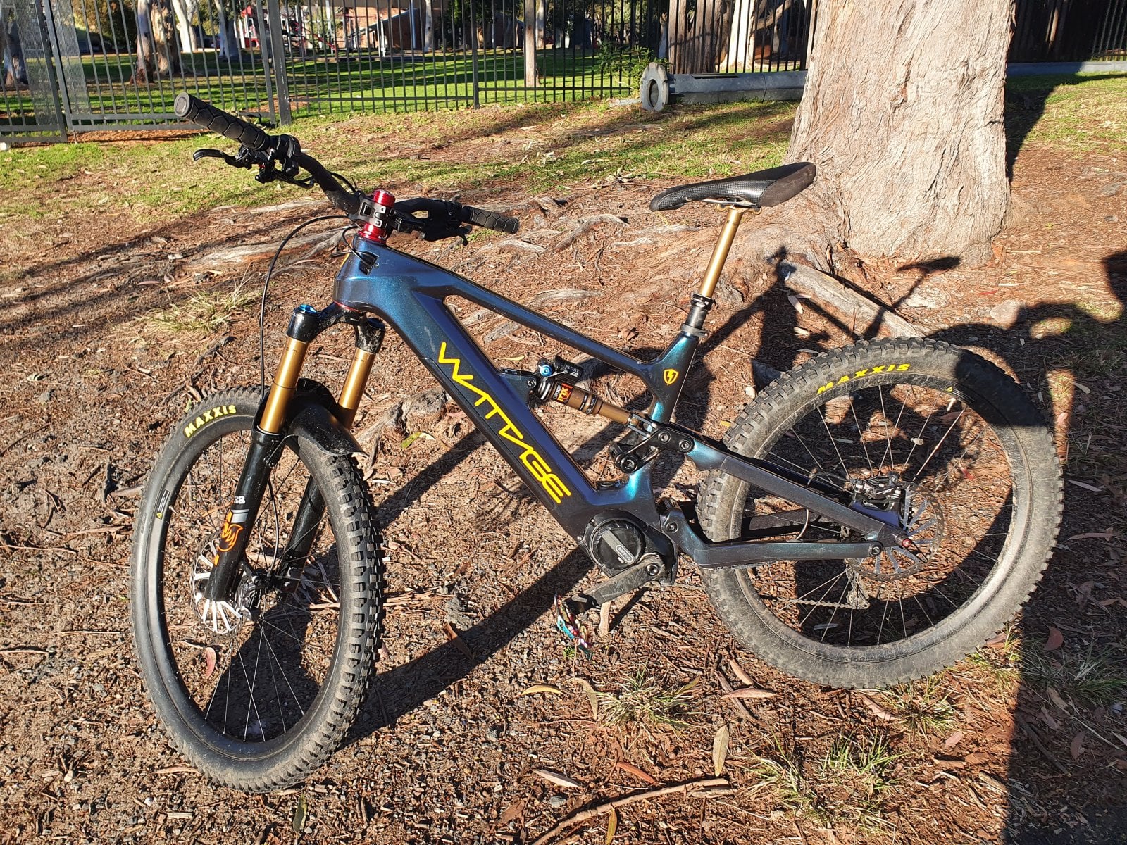

Hi All, I got the frame, carbon wheels and handlebars from the defang factory. So far is holding up. M600 motor is fantastic and certainly has a good kick. Got KOM today so certainly capable. Mine is a mullet and based on the Cheeb v1 except with Fox 38, x2 and Fox dropper. The weight is 25.9KG but does not seem heavy riding it. The battery range is incredible and I no longer have battery anxiety :). Live in Sydney so have amazing trails to play with.
Sweet looking ride man. Veey nice build. Im ok with that weight . What casings do the maxxis have? Anu tire liners?what is the battery size?
840WH battery, Have Maxxis 29'DHF & 27.5'DHR (very good). Setup as tubeless and has amazing grip. Love the slack position (like a mondraker) and is very agile through the corner and eats rock gardens and down hill for breakfast! -> super happy
Great! I was wondering the casing. Are they dh casing, double down or exo+? I guess you dont have inserts/tire liners in them , by your response.
That info will give a better idea of the weight. For instance, if the maxxis dhf/dhr are exo casing and no inserts in the tires and someone likes their dhf/dhr to have full dh casings a d tire liners that will be another 3lbs(1.4kg)on to the weight of the bike. The 25.6kg bike will now be 27kg
That info will give a better idea of the weight. For instance, if the maxxis dhf/dhr are exo casing and no inserts in the tires and someone likes their dhf/dhr to have full dh casings a d tire liners that will be another 3lbs onto the weight of the bike
EXO+ and as you suggested no tire liners - hope that helps...just realised they are maxxis 2 DHF/DHR
