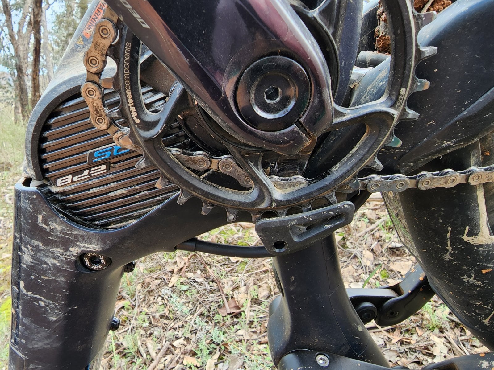

Changed E-13 Chainring to Shimano spider which hits the chain guide mount
spxxky
Dec 11, 2021
35
9
Bolton
Any fix for this? It's weird but aren't the E13 and the Shimano spiders supposed to have a 53mm chainline?
It's the rear of the spider that hits the mounting bolts for the chain guide. The fix is don't use a chain guide, you don't need one.

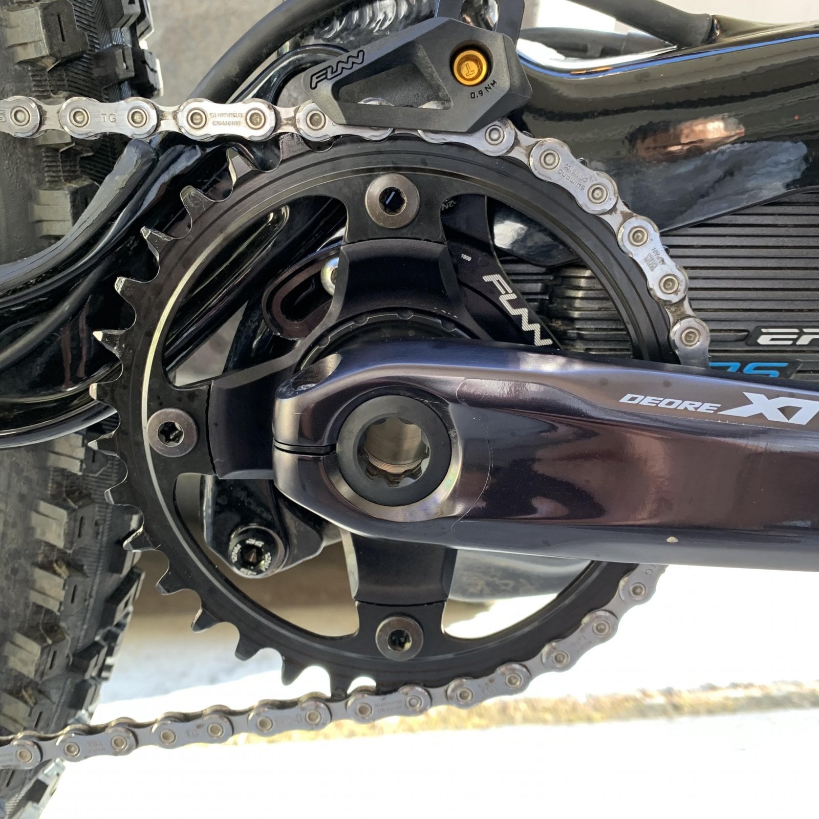

Are you talking about the nukeproof chain guide? If the nukeproof sells an eMTB with this chainguide on an EP8 motor and that bike has a 53mm chain line and a SHIMANO spider - then it will fit.
Anyways, I personally replaced the eThirteen chainring on my Rise with Shimano Spider w/ 34T for shimano 12 speed (SM-CRE80-12-B ) but it looks like the smallest chainring Shimano sells is a 34T.
FSA also sells a spider for the EP8 with a 53mm chainline (W0154 - 380-0455000050 ) and it can be coupled with the RaceFace 32T Chainring for Shimano 12 speed ( 1x Chainring 104 BCD - SHI 12) if one wants to keep the chainring at 32T.
People already reported shearing their eThirteen direct mount chainrings in this forum (and it's a pain in the ass to remove the chain mount lock ring afterwards, one even had to get the motor replaced).
Anyways, here''s a pic of FUNN Chainring guide for the Steps Motor on my bike (coupled with the Shimano Spider)

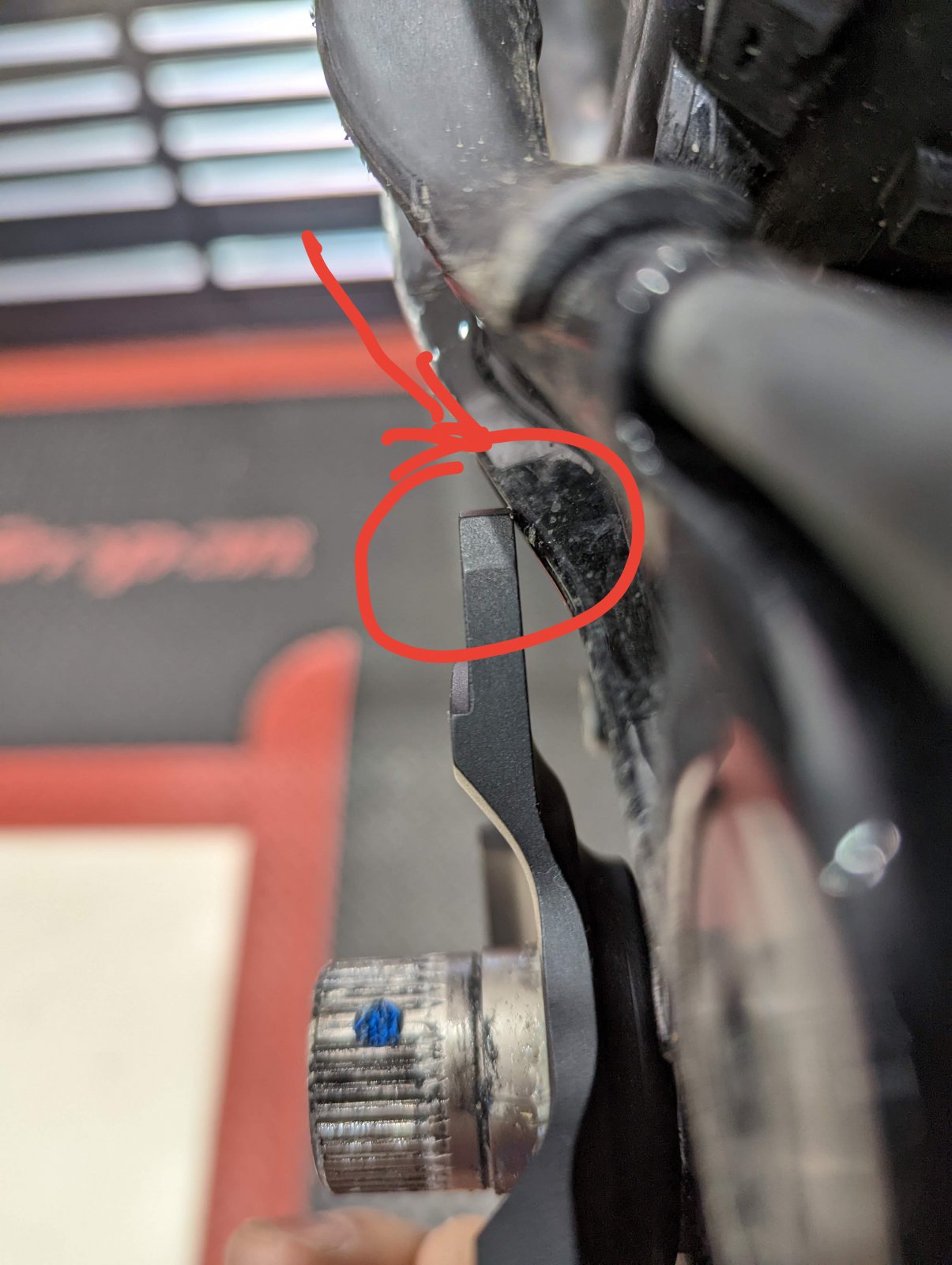

Hi, I broke 2 of the teeth on the original 32T e13 chainring this week, so am looking into options. The shop ordered the direct mount Shimano spider that has the 53mm chainline it definitely fouls the e13 chainguide mounting points, but even when the chainguide is taken off it then fouls something else. (I have an H30 frame in case it makes a difference). Do I need to order the 56mm chainline version of the spider? Thanks.

Hi, for the carbon frames the 53mm chain line is fine without the chain guide. I've not looked at the alloy frames so i don't know if there's a difference. Could help if you can find out what it's fouling on - the motor or the frame ?

Just got back from the shop and the 53mm chain line Shimano spider does not work on the alloy (H models) as the spider fouls on the frame. :( Photo below:
The 55mm chainline Shimano spider does work, but is definitely running a 55mm chainline (verified by measuring). This also doubly means you can't use the e13 chainguide - you can remove the spacer washers to get the guide inboard more and have clearance for the spider, but then this means the difference to the new 55 chainline is far too much.
I have temporarily installed the 55mm Shimano chainline spider and aftermarket chainring to use whilst seeking a solution.

Hmmm, I have an Rise Alloy (H series) and I've used both the Shimano Spider and the FSA spider made for a 53mm chainline - I even posted pictures above.
Not sure why people are trying to install a spider meant for a 55mm chainline
Here's the Shimano SM-CRE80-12-B (meant for a 53mm chain line - comes with 34T) - works on my Alloy H30 (Large)

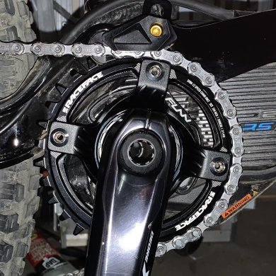

And here's the FSA spider w/ the RaceFace 12-speed Chainring, also made for 53mm chaiinline. Fits just fine on my H30, no rubbing.
FSA also sells a spider for the EP8 with a 53mm chainline (W0154 - 380-0455000050 ) and it can be coupled with theRaceFace 32T Chainring for Shimano 12 speed ( 1x Chainring 104 BCD - SHI 12) if one wants to keep the chainring at 32T.
That's a blow... looking at your photo, I can't see any way around that other than the FSA spider. let us know how the 55mm chainline is - any drops etc.
If I had a choice I wouldn't. Unfortunately the 53mm chainline spider didn't fit on mine, so all we had to experiment with and that worked was the 55mm. Model CM-CRE80 4 ARM Adapter, sub variant SM-CR Y1VY0020).
Many Thanks for that - my H30 is only a Medium, so I have just checked and all the chainstay lengths are the same across the board, so it's strange that mine obviously fouls and yours doesn't. I will see if I can get the same part as yours which includes the 34T chainring. The part I got was only the spider.
