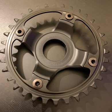

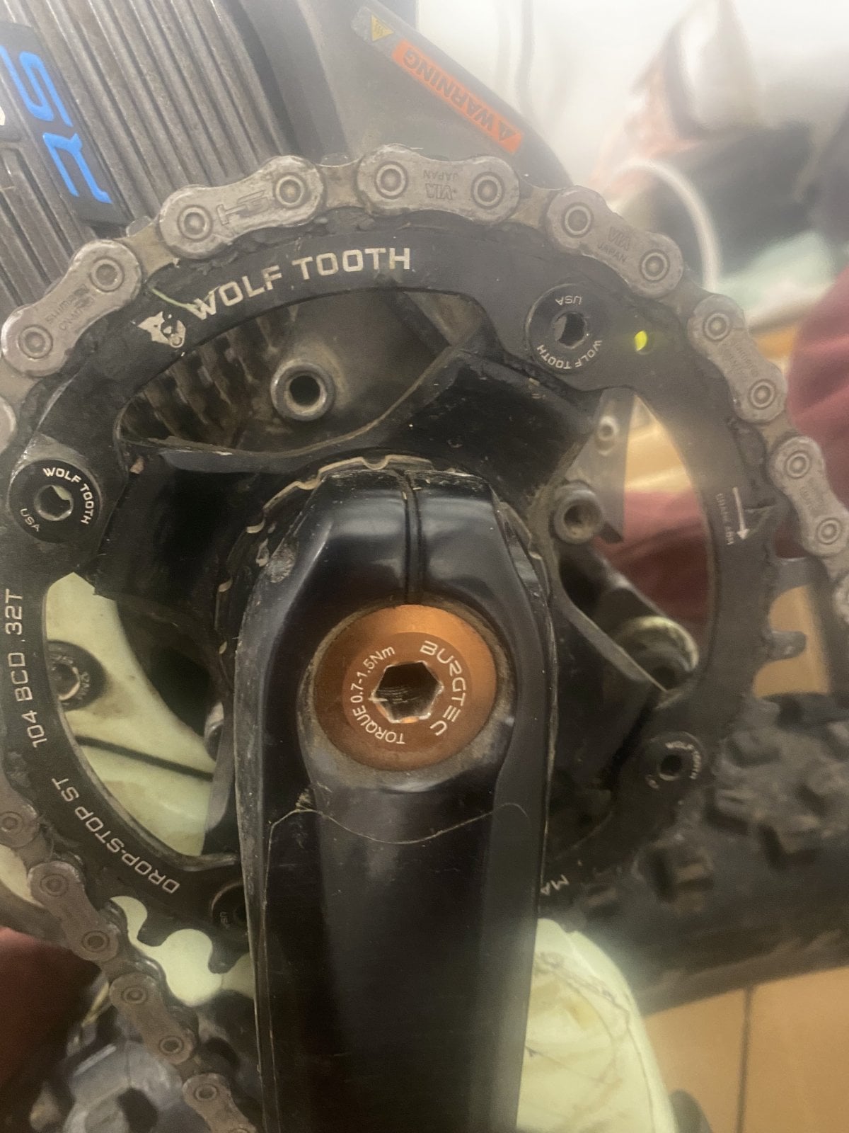

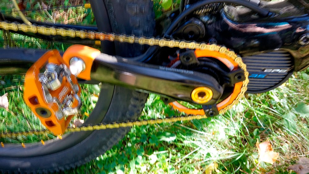

I got this one in a 53 chainline. Paired up with a Wolftooth chainring and bolts, dropstop specific (they do dropstop for SRAM and different profile for shimano) to the latest Shimano chains.
It’s totally transformed the bike into something amazing, or more like a machine that hopefully the chainring won’t snap😜.
Same lockring is used as on the E13 ringpiece.
Not loads of choice on chainrings, One up have one.
also bear in mind that the chainguide Won’t fit anymore, I’ve not needed it and that‘s with very rocky terrain.

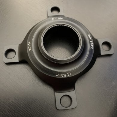

FSA also sells a spider for the EP8 with a 53mm chainline (W0154 - 380-0455000050 ) and it can be coupled with the RaceFace 32T Chainring for Shimano 12 speed ( 1x Chainring 104 BCD - SHI 12) if one wants to keep the chainring at 32T. Even though the Shimano spider is meant for a 104 BCD chainring, it's meant to be used with a Shimano chainring due to the profile of the the arms. If you were to use a RaceFace 32T Chainring (which is also 104 BCD) on a Shimano spider, you'll have a GAP and it won't look seamless (aesthetically) due to the inner tabs being a different profile than what's on the Shimano spiders. The FSA spider is more seamless looking when coupled with an aftermarket 104bcd chainring.

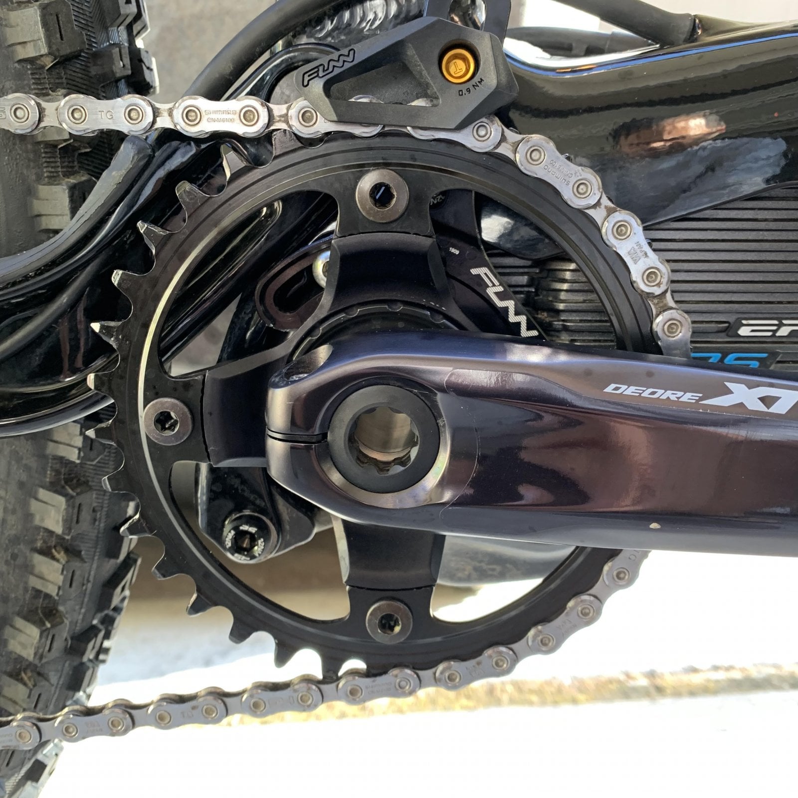

This means that you won't be able to use the eThirteen chain guide. If you want to run one, here's a pic of FUNN Chain guide for the Steps Motor on my bike (coupled with the Shimano Spider) - Rise H30. OneUp also sells a Chain Guide for the EP8 motor as well.

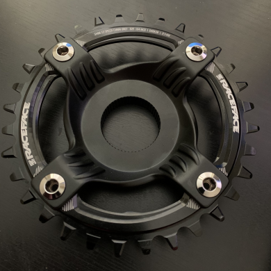

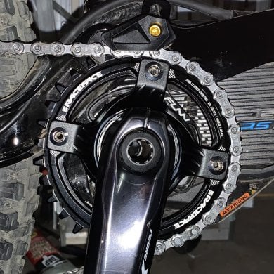

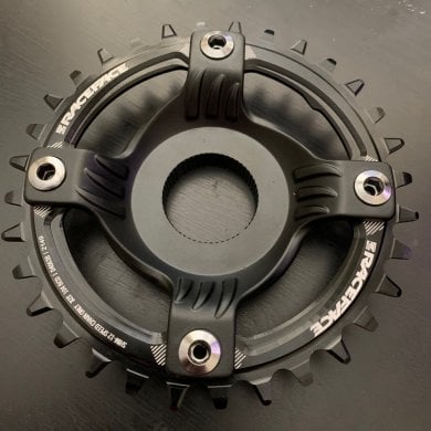

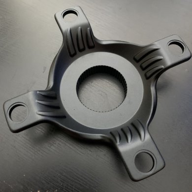

The FSA one is legit as well - pretty beefy / forged aluminum. Here it is coupled with the RaceFace 32T Chainring for Shimano 12 speed.
Weighs: 136 grams
note - the E*THIRTEEN 32T - STEPS direct mount chairing is 96 grams.
note - the Shimano SM-CRE80-12-B - STEPS chainring with spider for 12 speed is 176 grams.

Hi Funks,
could you just clarify which spiders are which in your pics?
In the first lot you put up where the ring sits perfectly against the spider tabs, is that a Shimano spider or the FSA? And then what brand ring is it? Raceface?
The last lot of pics that you put up where the spider tabs sit over the Raceface ring, is that the Beefy FSA spider you mention?
The pics online of theFSA spider you link to all appear to have been taken from the rear of the spider, so I can’t tell.
Asking for a friend really as I have Shimano/Wolftooth as in my pic, but I do like that seamless look in your first pic.

Here's a picture of the Shimano Spider w/ Shimano chainring ( SM-CRE80-12-B ). It only looks seamless because the Shimano chainrings have extended tabs. If you were to install another chainring (ie. wolf tooth, or the race face) there will be slight gap there (as the tabs don't extend all the way) albeit it will still work (104 bcd) but doesn't look ideal aesthetically. Basically, the Shimano Spider only has that seamless look when used with a Shimano chainring (which are hard to get a hold of)
Here's a picture of the FSA Spider w/ RaceFace (front view) - the chainring sits behind the spider (double checked this with FSA).

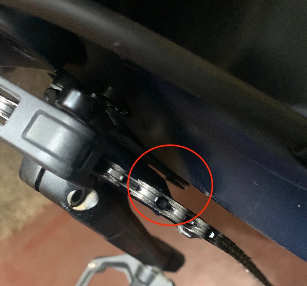

I bought the Oneup guide, but it's definitely not compatible with the Orbea Rise M10.
My Ethirteen Chainring deformed, thankfully e13 very promptly sent a free replacement. Still it's the new revision which is missing the grooves, so it hits the OEM chainguide bolts.
I got around it by filling a mm of the oem guide tabs so that I get a minimal clearance.
Really disappointed with Orbea engineering, if they fit a Shimano engine they should comply with all the clearances so that you can have more flexibility while replacing wearables. It's ridiculous that you can't fit standard shimano guides and chainrings.

I have reached out to Orbea for comment regarding the clearance issue between the revised Ethirteen chainring and the OEM chainguide.
To be clear this is the 32T Ethirteen E*SPEC Direct Mount Chainring for EP8 - CR4UPA-109
This is the same issue as reported here:
Orbea's reply was very disappointing and lacking ownership to either go to a dealer or contact E13.
So at this point in time, I'm not aware of any chainring compatible with the rise with the OEM chainguide, which is kinda crazy considering it's a wearable part!

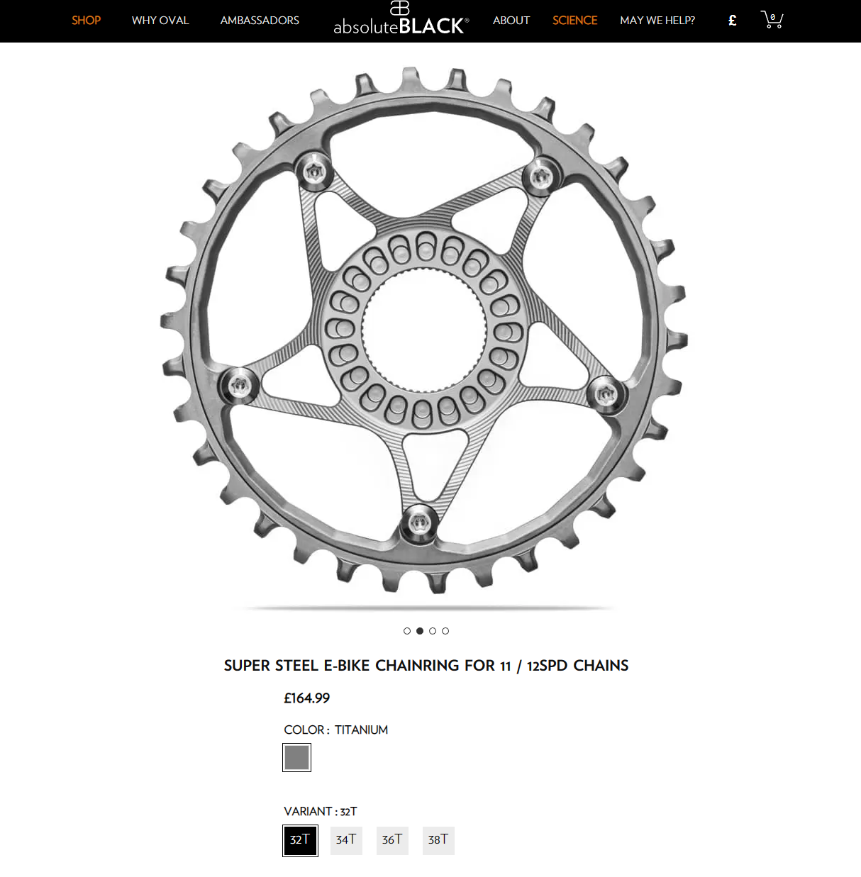

I saw someone mention this from absoluteBlack - but expensive. The price in the image is just the chainring - you also need a spider. But it is steel so could last well.
