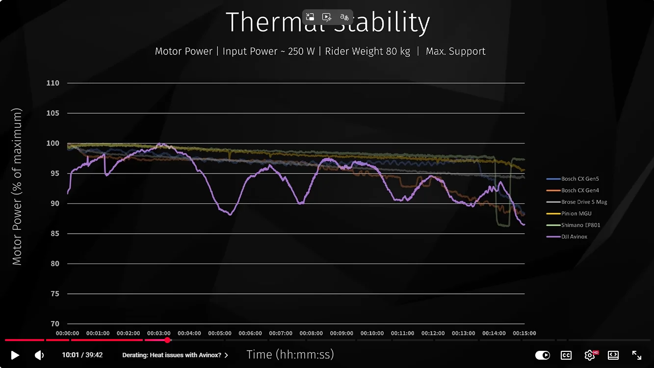

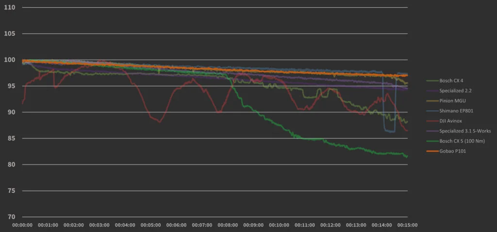

The thermal regulation that Suns PSD mentioned is the same thing I was thinking. Some of the Velomotion.net motor tests show how different motor controller systems handle heat buildup differently over a 15min period, which I found pretty interesting. In the below image, you can see how most motors steadily trend downward when run at a continuous 250w INPUT power (so remember that some of them will have been outputting much more than others), but the Bosch CX Gen 5 abruptly falls off at around the 8min mark, and doesn't recover (this test does not give it a break to cool off). The Avinox, on the other hand, seems to derate and recover in a sort of erratic wave pattern almost constantly. Shimano looks strong, then abruptly drops off at around 14min, then 30 sec later recovers. If we throw out the Pinion as it is really a whole different beast, you will notice that the motors that derate the most or fastest also tend to be the lightest ones, so I'm inclined to think that what we're seeing here is the tradeoff for having so little thermal mass to absorb and buffer the heat. The Gobao that Aventon (and Alutech and others) are now re-branding, while having similar peak power and torque to the Avinox, actually may be way more powerful if you take a 15min average, rather than just looking at the instantaneous peaks. If one is power hungry and does long steep climbs in hot temps, it's really looking like a pretty sweet package if they can refine their pedal sensitivity and work on their rattle. It seems like 300g well spent if they can dial in those elements.
It's worth considering that heat does not necessarily equate to power being derated.
You could look at this as the ones that derate the most are also going to be the most likely to have a long service life. I personally find that bosch gen 5 curve to be pretty attractive. The dji looks a bit squirelly.
I don't know much about the topic, but was wondering if DJI is purposefully creating all of those power peaks and valleys and erratic power delivery to manage heat related deregulation? Micro breaks maybe?
Maybe it's a good strategy as it's not something that a rider can even feel, and only a machine turning relentlessly at a constant rpm can even detect the ups/ downs?

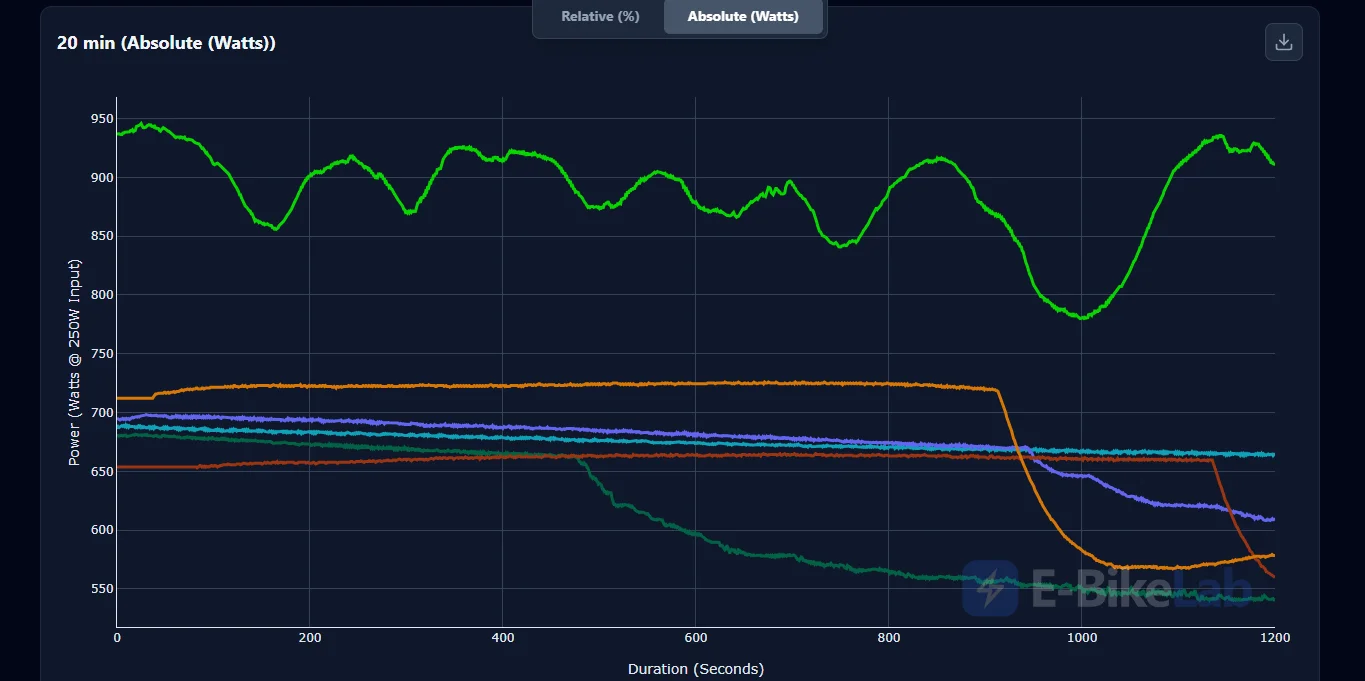

If you look at the wattage output, it's socking out significantly more power than all the others during the thermal test, even in the valleys. Thermal dissipation is related to mass, and the dji is lighter than the rest. Between this and the fast charging, I'd expect the dji setup to see significant degradation in performance over a few years of use. Time will tell.
