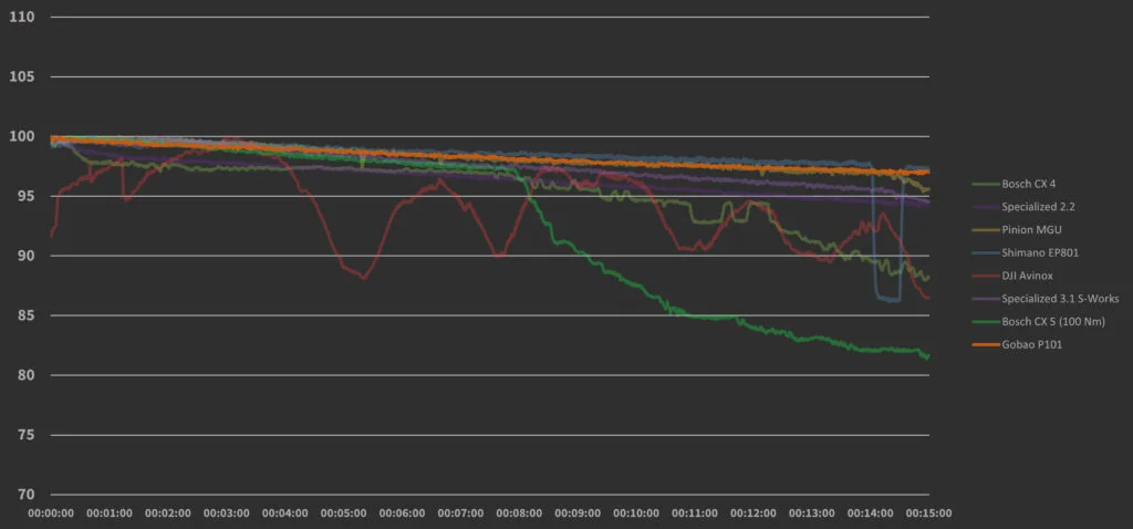

The loss of power you are noticing is likely thermal regulation. All the motors begin to do it after about 5 minutes when all out.
Unfortunately more power will just make it come sooner unless they build physically larger motors, add cooling systems, significantly improve efficiency, or the like.

The thermal regulation that Suns PSD mentioned is the same thing I was thinking. Some of the Velomotion.net motor tests show how different motor controller systems handle heat buildup differently over a 15min period, which I found pretty interesting. In the below image, you can see how most motors steadily trend downward when run at a continuous 250w INPUT power (so remember that some of them will have been outputting much more than others), but the Bosch CX Gen 5 abruptly falls off at around the 8min mark, and doesn't recover (this test does not give it a break to cool off). The Avinox, on the other hand, seems to derate and recover in a sort of erratic wave pattern almost constantly. Shimano looks strong, then abruptly drops off at around 14min, then 30 sec later recovers. If we throw out the Pinion as it is really a whole different beast, you will notice that the motors that derate the most or fastest also tend to be the lightest ones, so I'm inclined to think that what we're seeing here is the tradeoff for having so little thermal mass to absorb and buffer the heat. The Gobao that Aventon (and Alutech and others) are now re-branding, while having similar peak power and torque to the Avinox, actually may be way more powerful if you take a 15min average, rather than just looking at the instantaneous peaks. If one is power hungry and does long steep climbs in hot temps, it's really looking like a pretty sweet package if they can refine their pedal sensitivity and work on their rattle. It seems like 300g well spent if they can dial in those elements.
