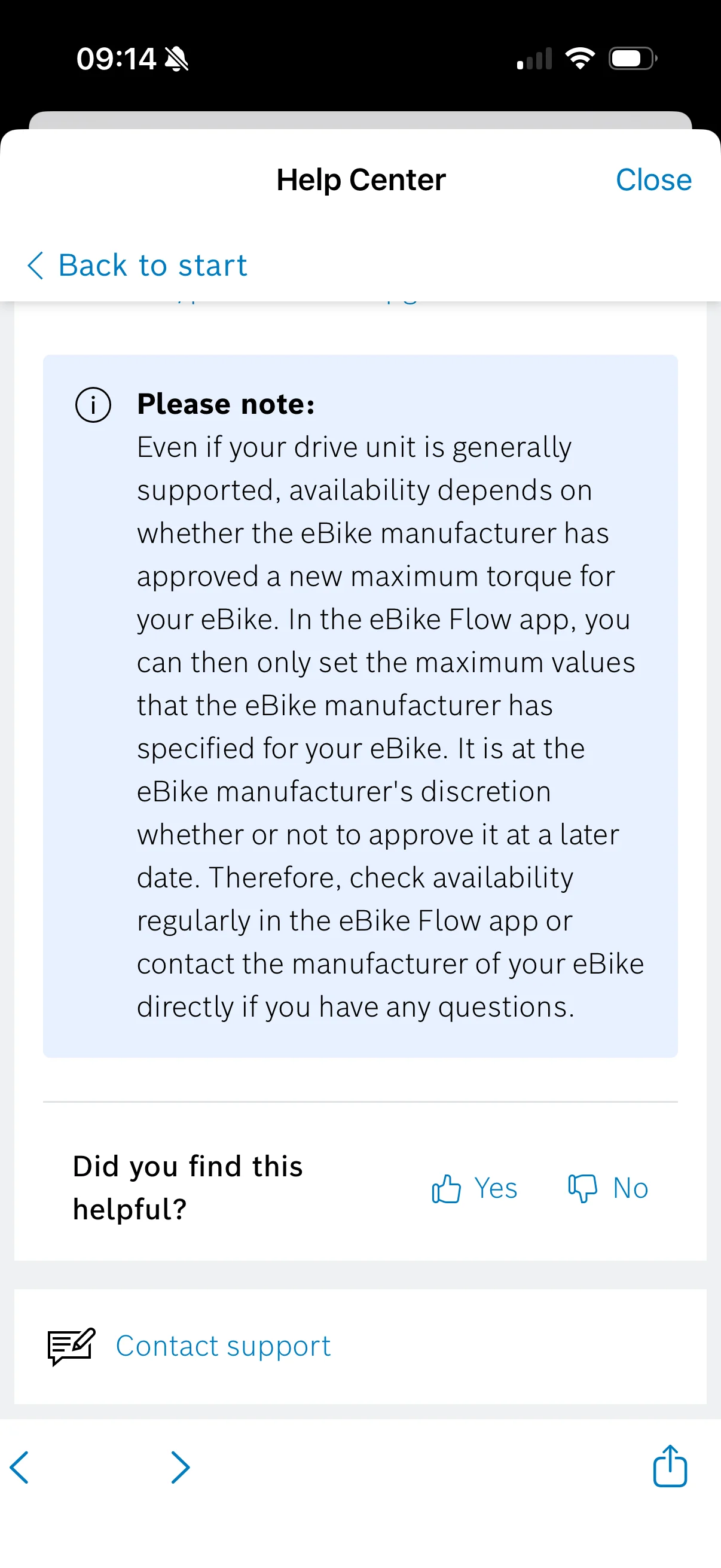

I’m wondering if Pivot has not approved this update. I’d be pretty frustrated by that if they are trying to promote the new bike. Mine is only 3 months old. Currently on a 2025 Shuttle AM

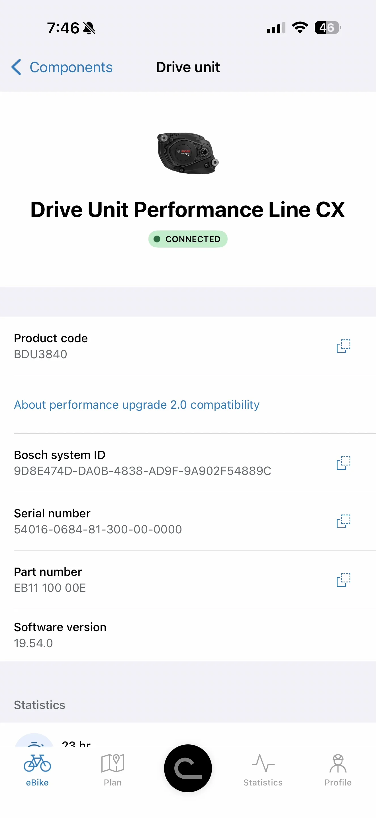

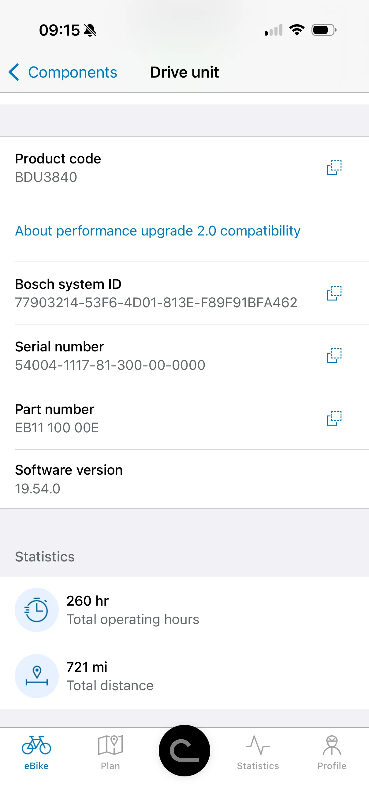

Anyone who has completed the update, can you check the software version on the motor when you go into the individual components?
I think it is much more likely the update has simply not yet rolled out in your area. I'm not seeing it yet on either my Gen 5 or Gen 4 bikes which is typical, normally don't get them for 1 or 2 days later here in Germany! I can't believe in my case that the manufacturer would block the update for the Gen 4 bike since max. power will remain at 85NM
Maybe so. I find it interesting that the main software update was released, but not the power. The update I installed very clearly stated it was the 120nm update. Oh well

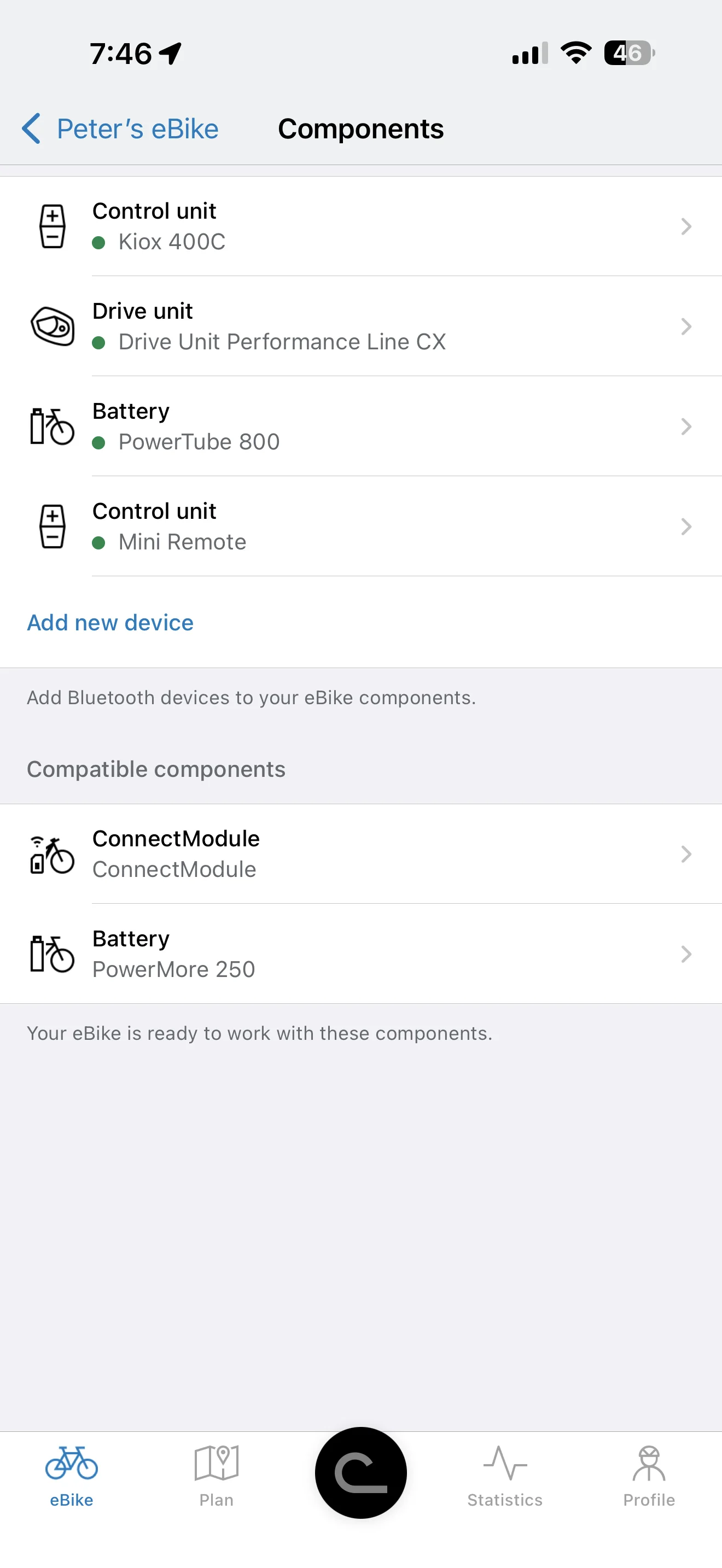

I believe the update popped up on my main page of the Flow app. If it wasn’t there, I had to click on the settings icon in the upper right hand corner of the screen.
Then from there you click on the components and then the drive unit. It showed an update there as well.
These are the software versions on my bike now.
