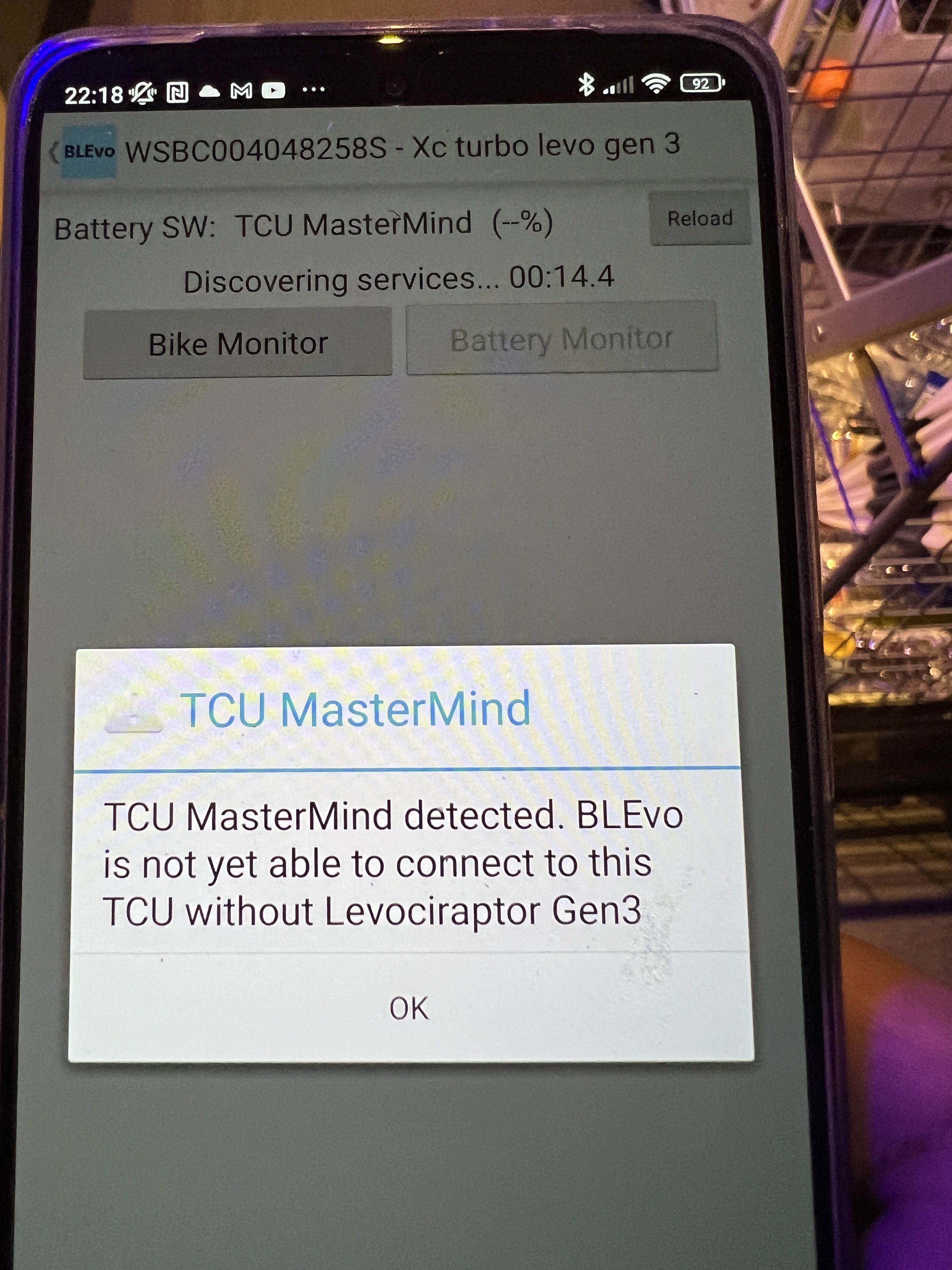

2. MasterMind TCU + Levociraptor Gen2 + Brose Motor (only in read mode, Smart Power doesn't work)
Hi @PaoloBLEvo , I just bought the Levociraptor Gen2 and Blevo to use smart HR with my Levo Gen3 with Mastermind.
I knew that smart power is not going to be supported, but I read people use it for "smart HR".
Yesterday I tried it, I can enable smart HR in Blevo, I can connect to the Levociraptor, I can connect to my Fenix 7 HR, I see my HR in Blevo...
But it doesn't change the power support, no matter what I tried.
Could you please explain step by step how to enable Smart HR with Levociraptor ?
Thank you!

Sorry but with Gen2 you can read only the data from the bike.. For use the Smart Power or Smart HR, you should buy Levociraptor Gen3..
Ok thank you, a pity.
Its confusing that it says "no smart power" but in reality it also means "no smart HR" :(
hi if without levocirator in ios .levo gen 3 with mastermind will not work right
Everything works except the Smart Power and Smart HR features. They have released the Levociraptor 3 in Europe that works with the Mastermind for Smart features. Waiting for the USA release.
Not true.. BLEvo doesn't work with the new MasterMind TCU... If you use Levociraptor Gen2, you can read the data from the bike.. If you use Levociraptor Gen3 you can also "write" data to the bike (this means Smart Power and Smart HR)..
I misunderstood the question. I thought the question was about WITH Levociraptor 2.0. Sorry for the confusion.

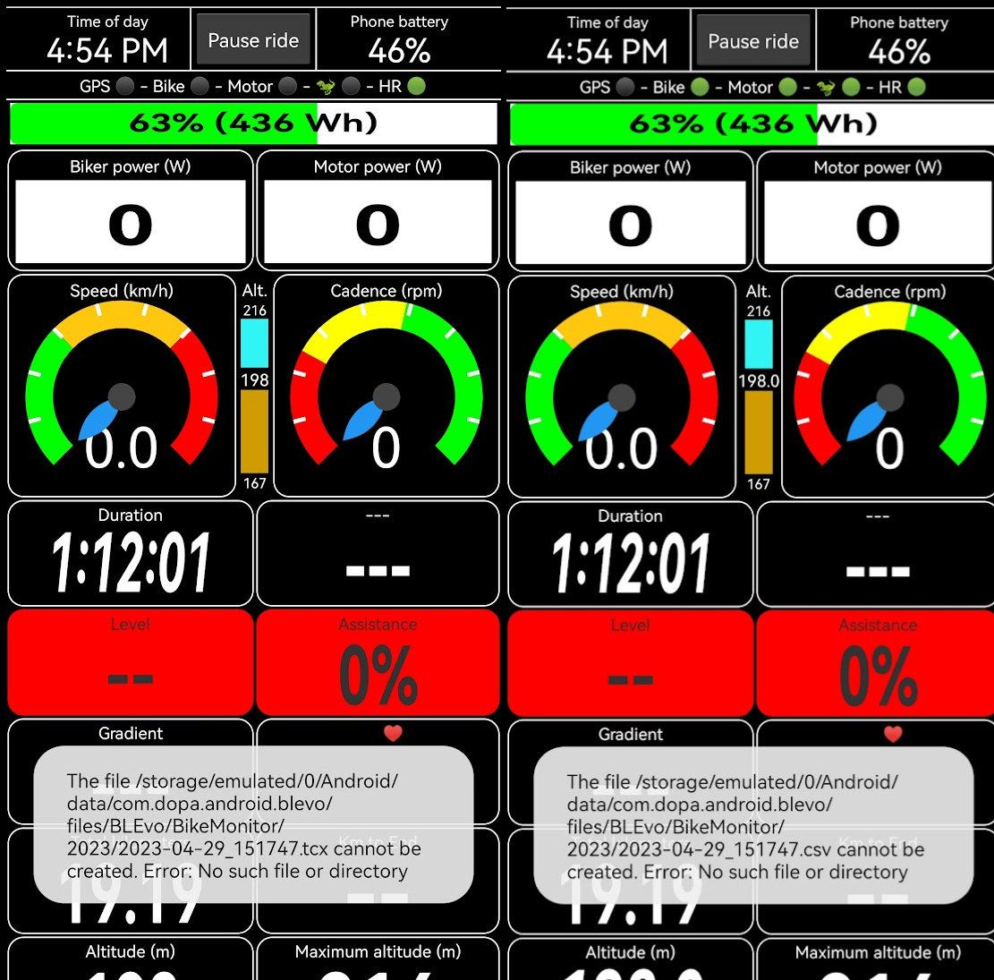

Hi!
I received Levoriraptor gen 3 and it is working fine with gen 2 Levo. Space in top tube is limited and it is really tight fit but I managed to put it in place.
I noticed one problem that might be not easy solve. If you pause ride and do something else with phone and after that try to continue ride it seems that there is some connecting issues with bluetooth devices. That also happened before levosiraptor. Also fit/tcx will be corrupt for strava upload. After levocirator installation I get also these error messages.
I had to exit program and Blevo was able to continue driving.
Program has also tried to do backups of some files but it is not completed. It keeps saying some .gpx file allready exits.

Hi!
This is a problem of the optimization of the phone, where sometimes cut the bluetooth connection for low power mode.. Please setup Android to avoid any optimization of BLEvo app.

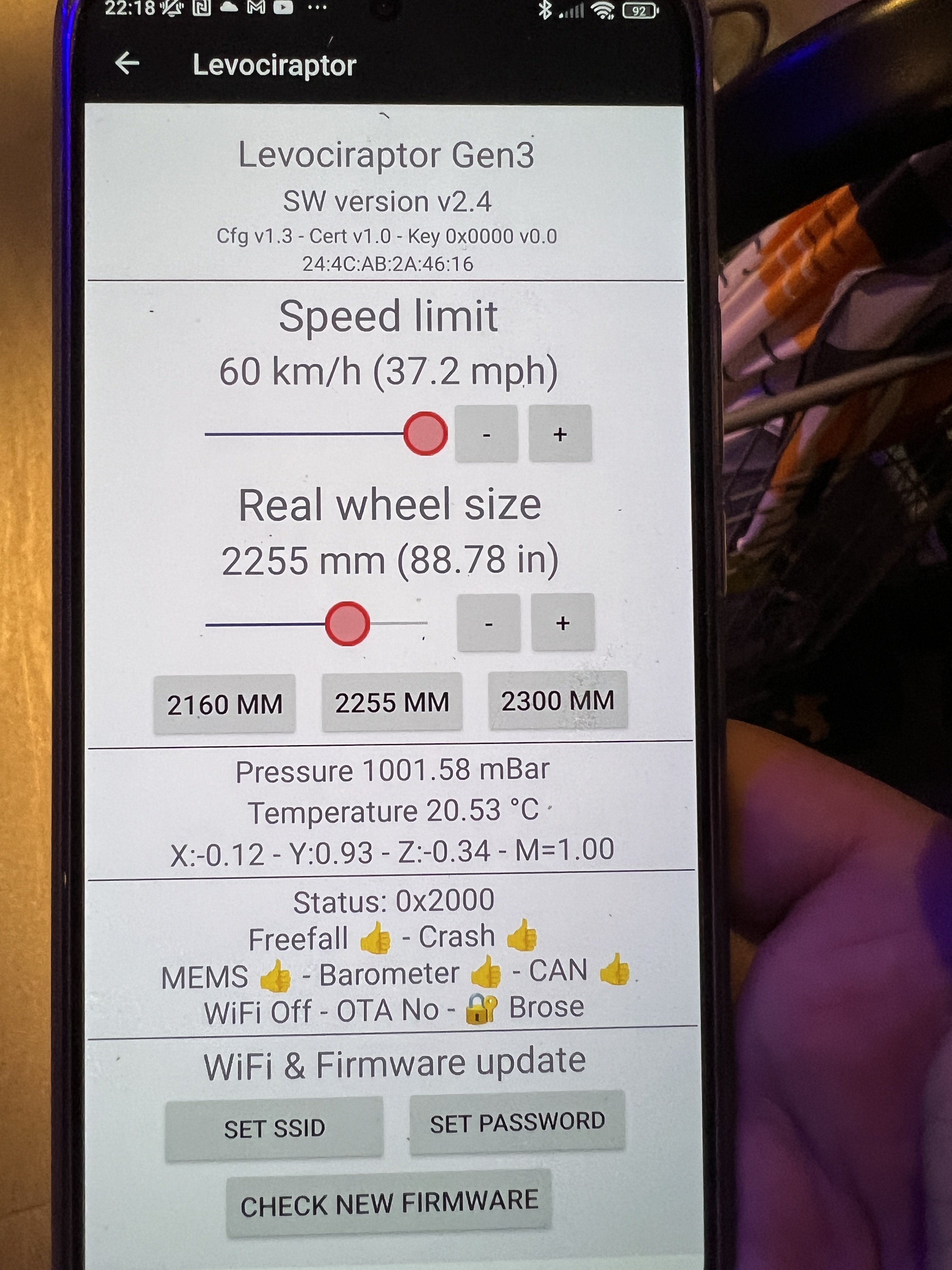

Hi. I’m sorry to ask. What it’s the value to set for Levo gen rear wheel 2255/2300
And it’s it’s normal to help this message even I have change to levocpri gen 3
Many Tks
