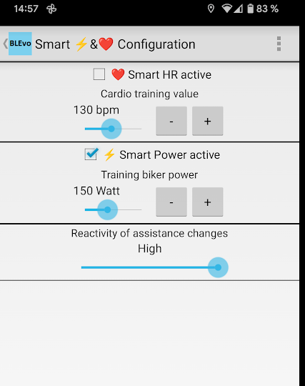

I received my levociraptor gen3 and just tried out the smart power with my Levo gen3. It works good so far.
Just one question:
I used the basic settings and set it to a 150w threshold:
With that I see that it does a great job preventing me from exceeding the 150 watts. That means, motor power kicks in and turns up fast.
But on flat terrain I noticed that the engine always delivers a bit too much power which results in that my own power just stays between 100 and 130 watts. On flat I never saw it getting even close to 150 watts, while the bike engine was still pushing.
Can I set it up somehow so it keeps me more around the threshold power, uphill and on flat as well?
Try to reduce the reactivity and enable the expert mode, where you can handle the dynamic legs power..

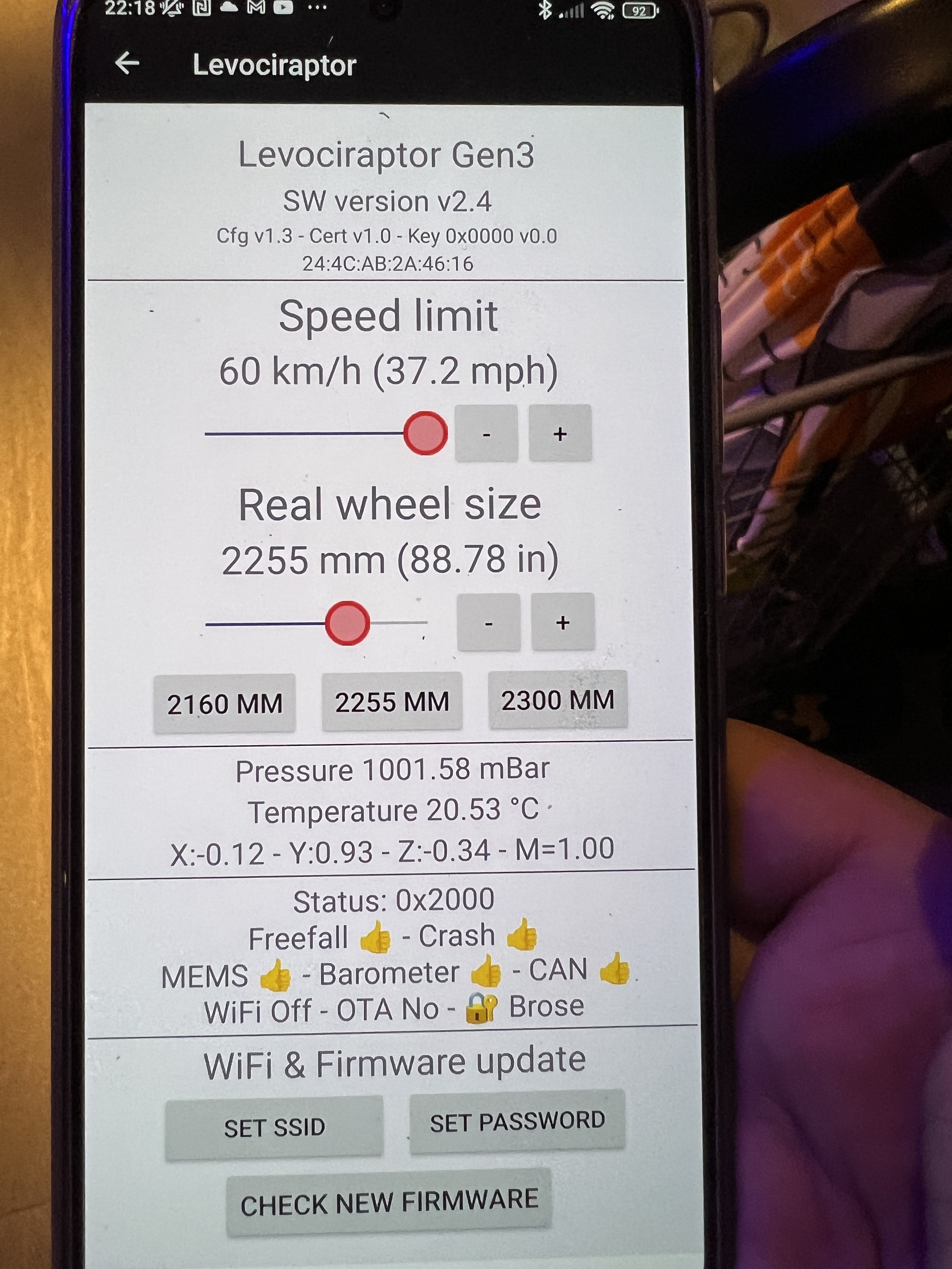

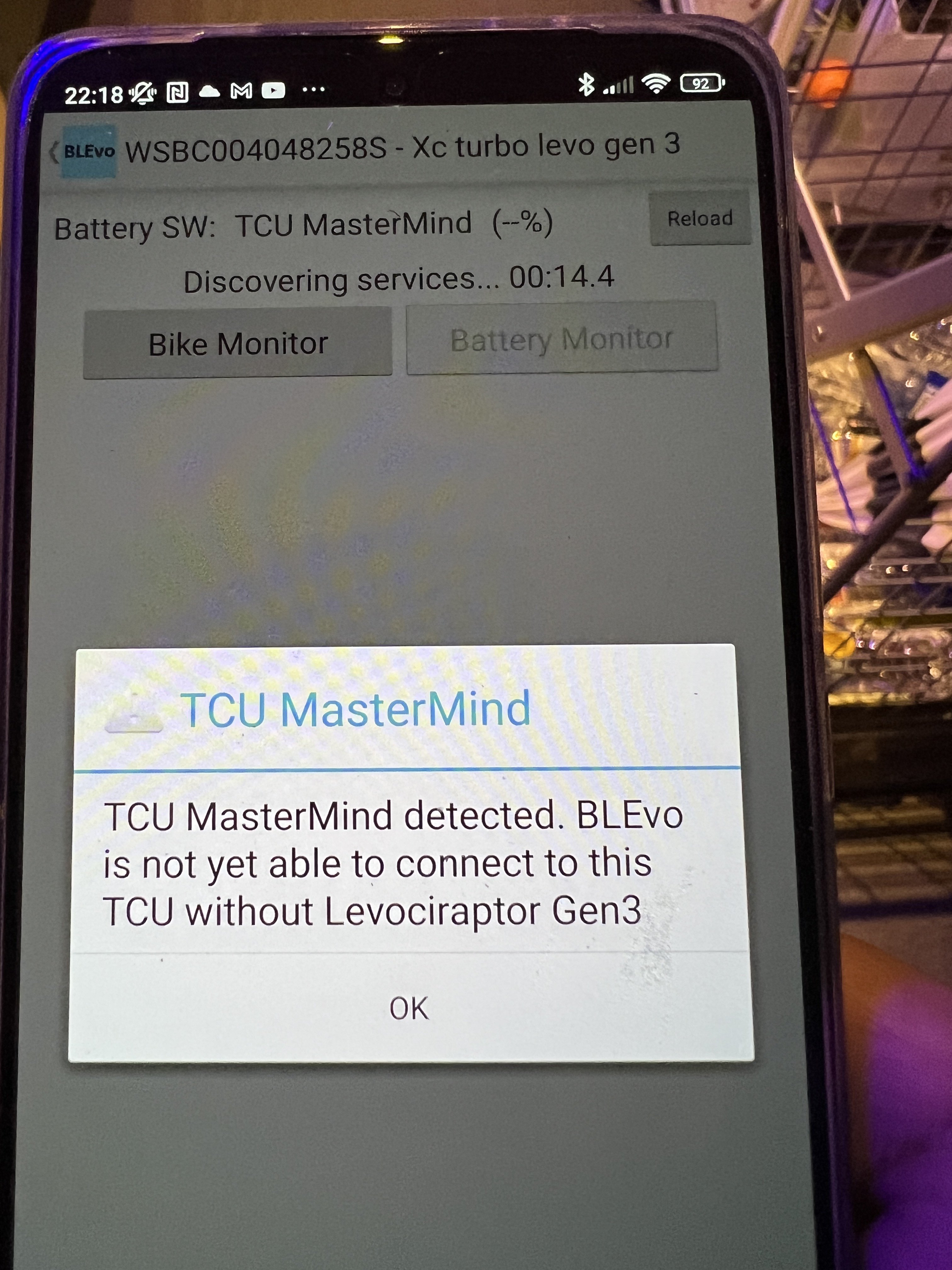

Hi. I’m sorry to ask. What it’s the value to set for Levo gen rear wheel 2255/2300
And it’s it’s normal to help this message even I have change to levocpri gen 3
Many Tks
View attachment 115647 View attachment 115648
The value depends of the wheel size... if you have the 27.5" you should set 2255mm, if 29" set 2300mm
For the second screenshot, you need to scan and add the Levociraptor device also in BLEvo...

check the other Blevo thread for more details. But yes, it does work as long as you get the recent gen Levociraptor device.

I note in SMART Configuration I cannot adjust the slider manually for “Reactivity of Assistance Changes”
It seems to set its own default depending on
which selection you apply…
Low, Mid, High, Pro
Is this correct now?
