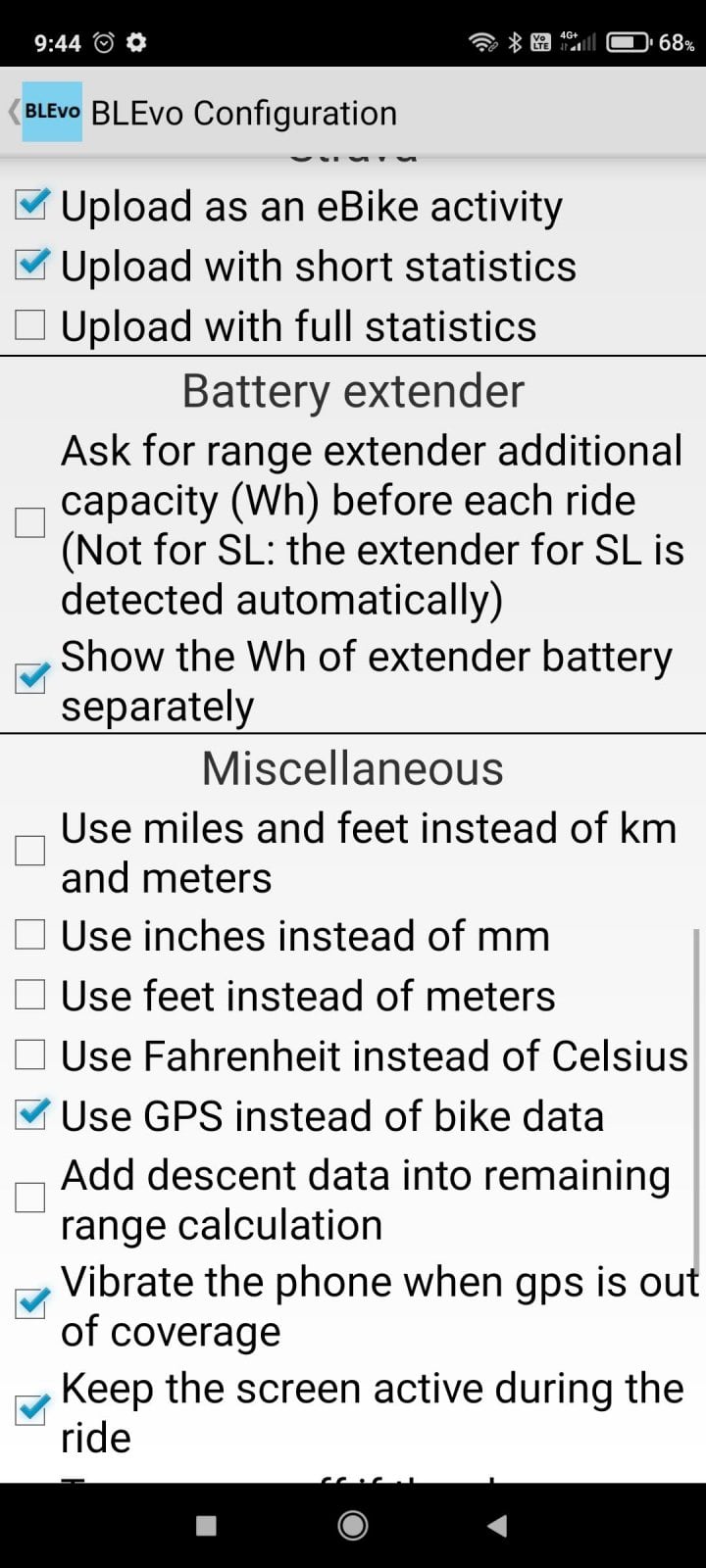

Sorry but you can use BLEvo without the bike connected (like with the MasterMind TCU). Just select the speed and KM from GPS and not from the bike.. Obviusly you will not get the battery and assistance value from the bike..

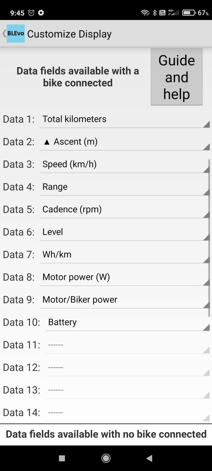

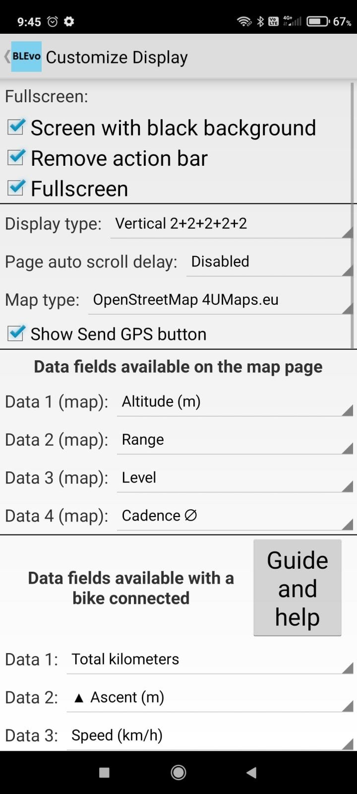

As far as I was concerned I had it set like that :
With the display configured like this :
And all the fields .. Except - They all just come up blank when you ride.

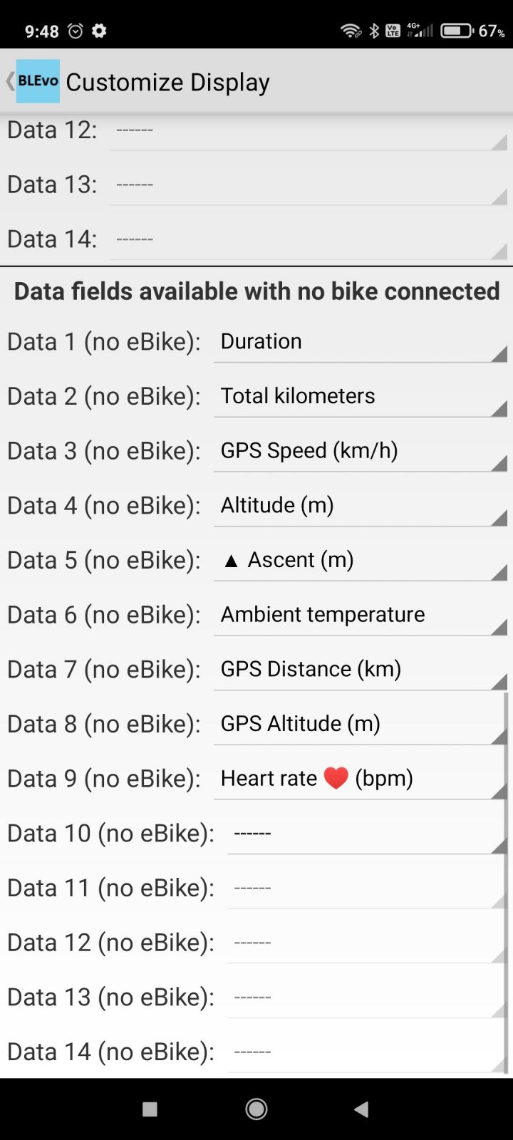

Then I noticed at the bottom, there's another section I've never seen before .. "Date fields available with no bike connected" - So I've populated them and will give it a try later. I'm guessing a lot of people haven't noticed that section and are unaware you need to populate those fields separately - for instance if you wanted to use Blevo for mapping etc with a Mastermind equipped bike.
Thanks Paolo .. You made me investigate further :)
