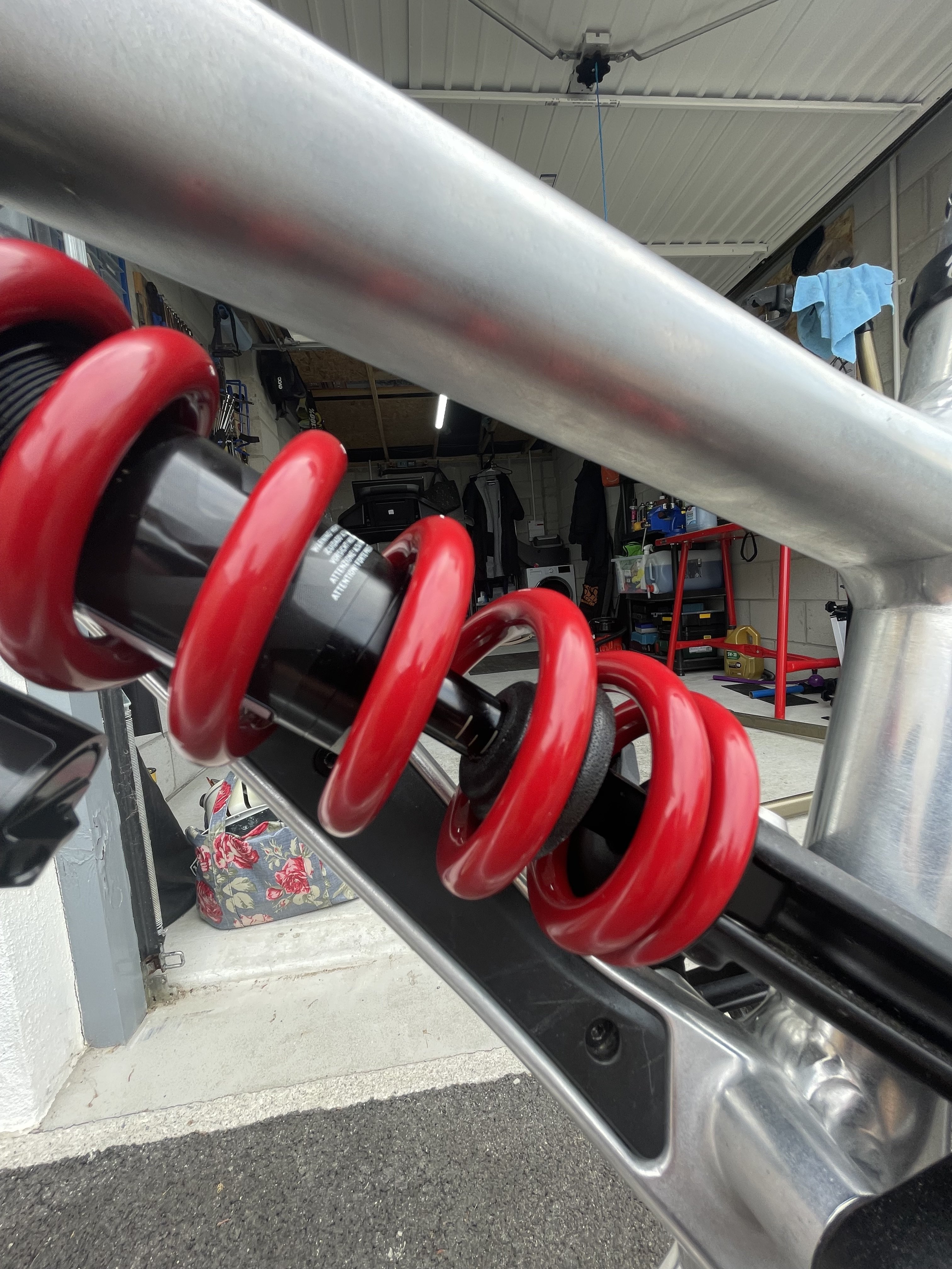

Shock arrived today. Tftuned fitted a 600 spring 😳🤯 which only gives me about 22% sag. Have ordered a 500 and 550 which will hopefully arrive on Saturday in time for a ride on Sunday.

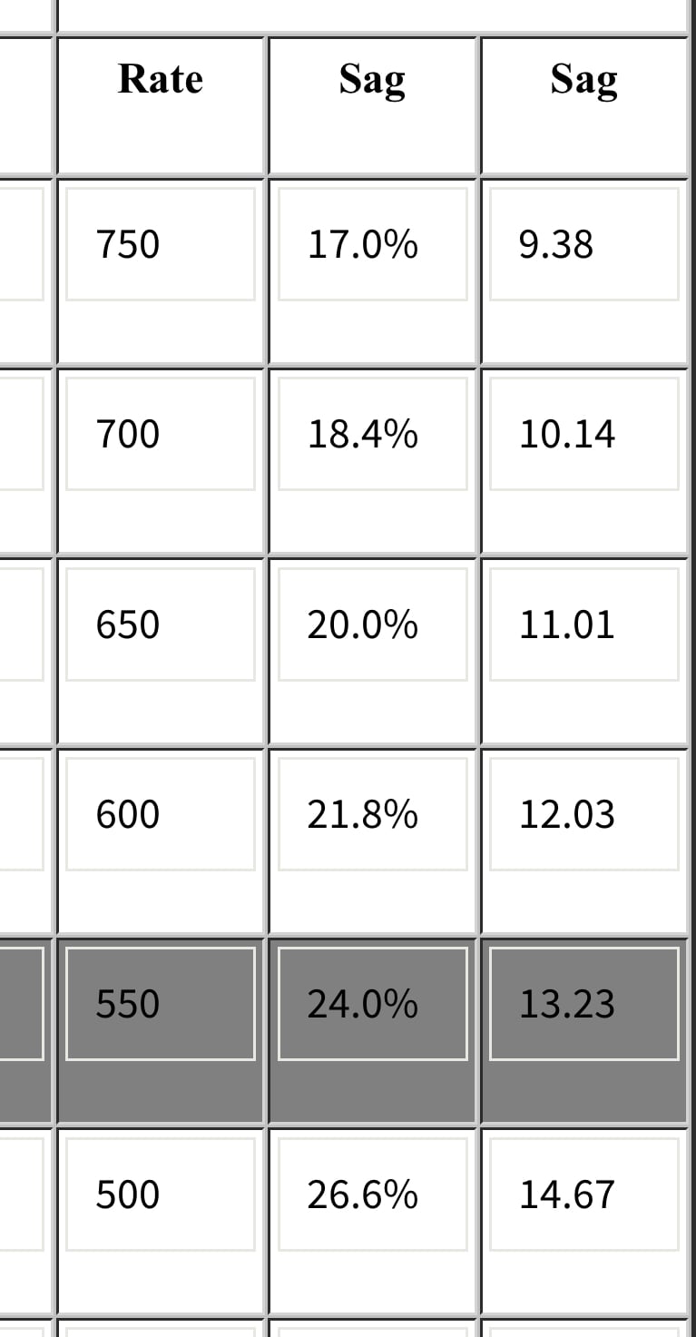

22% sag with the 600lb spring
The shaft has sag markings
That one gives 550 for 24% sag and 500 for 36% sag.
It looks like I will end up with 500lb spring…..will find out tomorrow.
Nice to see that MRP calculated a 21.8% sag with a 600lbs spring rate which is very close to your actual 22% sag measurement.
So MRP should tell you what you need to achieve a 30% sag if that is your goal.
I personally only use this calculator. It saved me money with coil fitting in the past. A good thing that RS coils are fairly inexpensive though!
Ok. All sorted.
550lb spring, 2 turns of spring collar.
= 28% sag
Riding weight 93kg
I tested the 500lb spring, 4 turns gave me 30% sag.
I will be keeping the 550lb spring.

Ok. First ride feedback.
25 miles around Dartmoor, so some good rocky descents and some long climbs.
First impression is that it feels better than the air shock. Soaks up small bumps (cattle grids feel like they are not there), deep compressions feel very controlled, no chatter on high bump frequency rough descents. There were a few smallish drops, soaked them up really well. Climbs great, hardly any pedal bob (this is probably more the bike design than the shock). Traction both up and down is very good.
HSC is one click from open.
LSC is in the middle.
HBO is one click from softest.
So overall I’m really happy. Will hopefully do some more challenging trails this coming weekend.
It’s about 400g heavier than the air shock but you can’t feel this when riding.

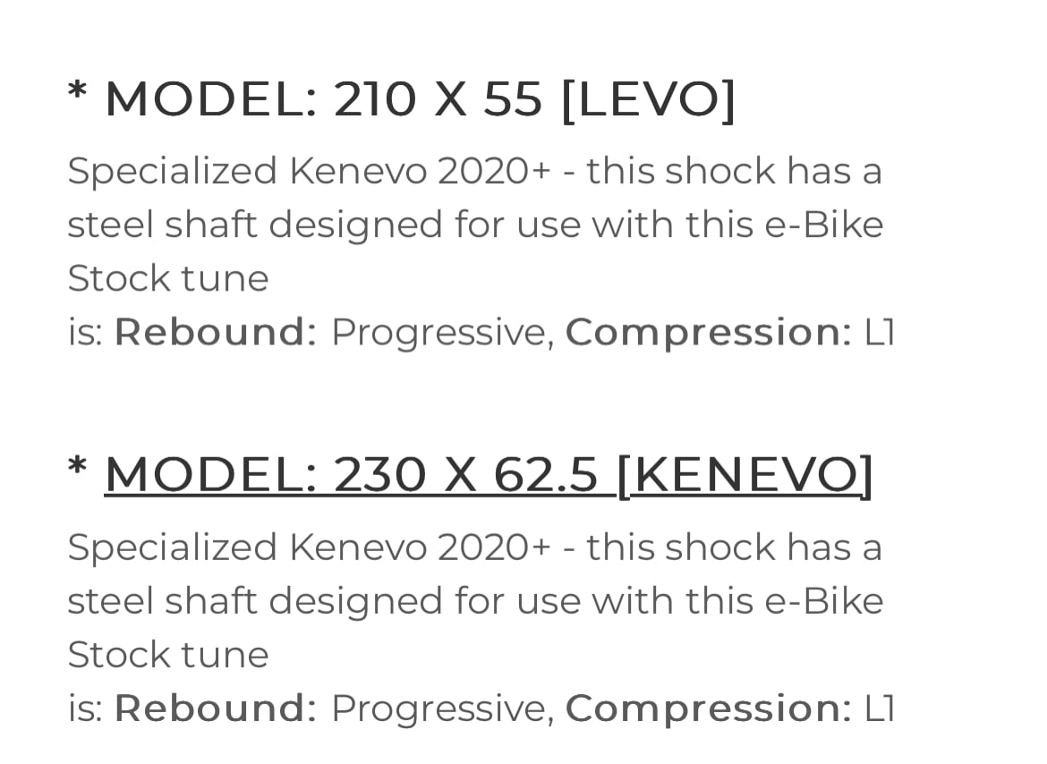

In Germany it is not possible to order the Coil with the steel shaft anywhere.

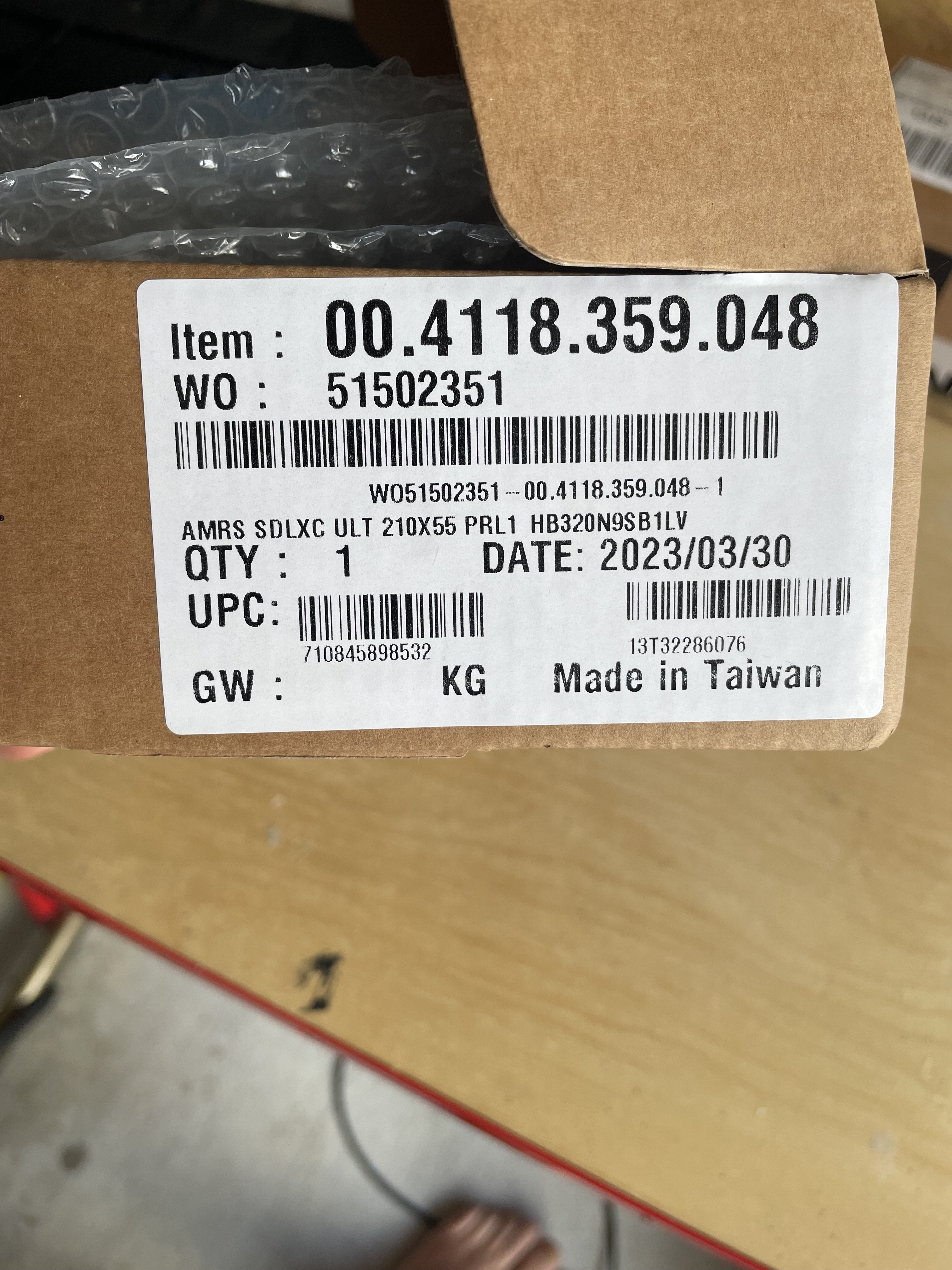

Did you get the shock in the original box and what's the print on it.
The serial number here does not work...
I was told that the RS determined that the version with the steel shaft wasn’t required, the regular version of the shock was burly enough for the Levo so they discontinued the steel shaft version. The part number doesn’t exist anymore, that’s probably why you can’t find it.
Contacted Sram again:
Hey Henrik,
Thanks for reaching out, and I hope you're having a great week!
I would be happy to assist!
The part number (00.4118.359.048) that you are looking at uses a standard shaft (not steel) and is tuned for the Levo SL. Regardless, this shock will work with your frame, as the Levo does not require a steel shaft.

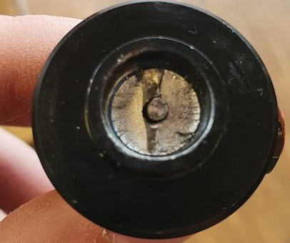

I have read an article from the Intend Owner and he said, that not the shaft or its material is the problem in most cases. The biggest problem is the point, where the shaft "meets" the eyelet.
So I will have a look at the lower eyelet and see if I can make one out of steel...
further research shows the weak point is not the eyelet but the shaft itself
the 2021 shaft is not magnetic, so it should be an alloy shaft.
