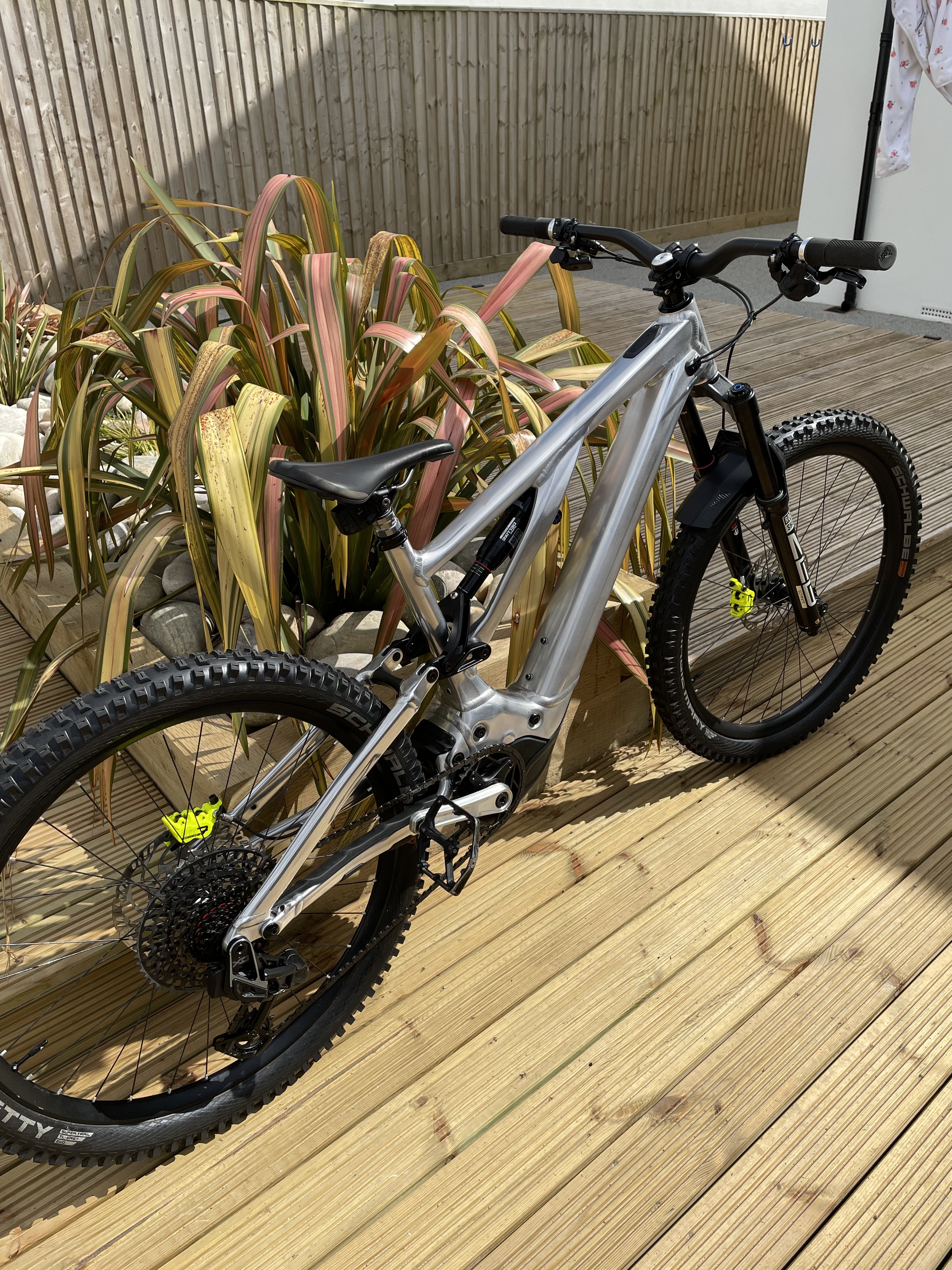

The Ohlins would look best, it’s yellow and would match the Magura’s.
I considered the Ohlins but the Rockshox is cheaper in the US and also has better parts and service availability I believe. Plus the rockshox has HBO, which I believe the Ohlins does not
Think I’m opting for the RS SD.
