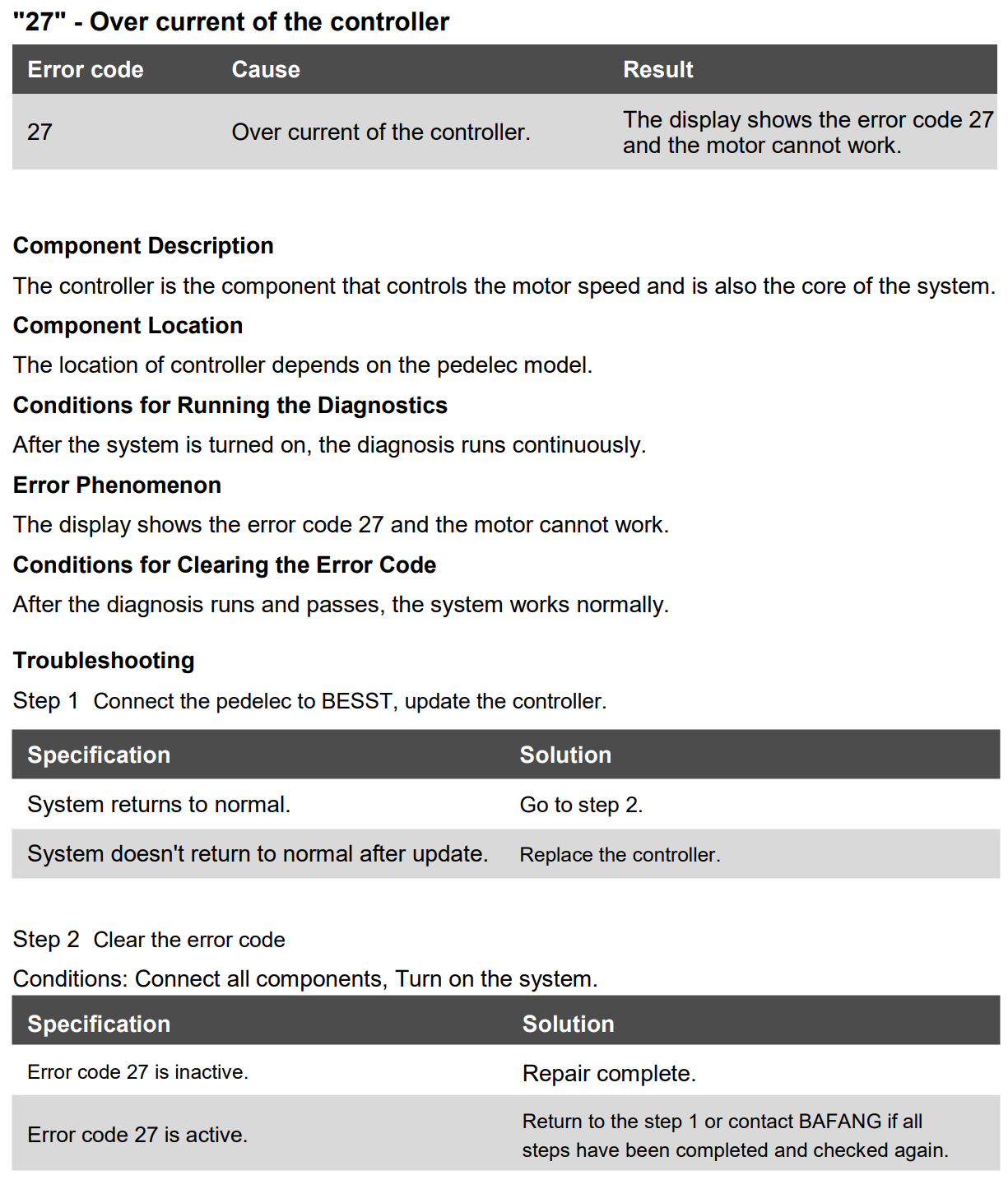

I run into 27 error (new M600), error remains also after power on/off. This is not OK if you can put back motor into function only by connecting to BESST. Also similar on M510 FC2.0, overvoltage error and did remain.
@Dado Have you tried removing the battery rather than just switching the system off?

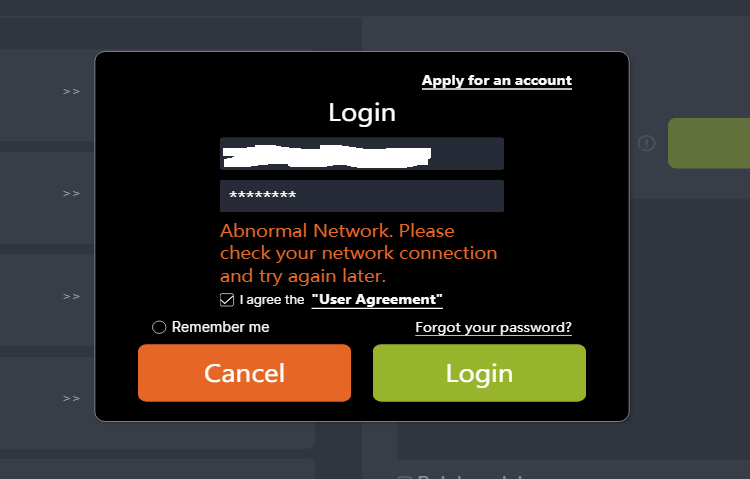

Guys i can't log into Besst Pro with my vanilla best account, python script doesn't work here as well. Is there some different py script just for Pro?
Have you done everything like here:
Take care. An new revision (2.0.8) download automatically if you accept. this revision don't work with my M820 :cry:

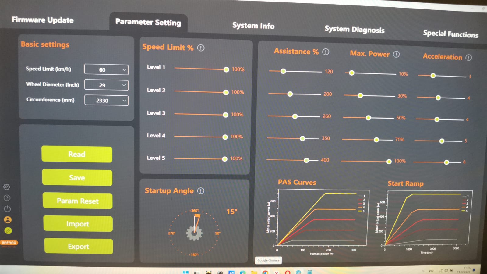

Finally today after riding this software function and i can adjust the parameters 👍
