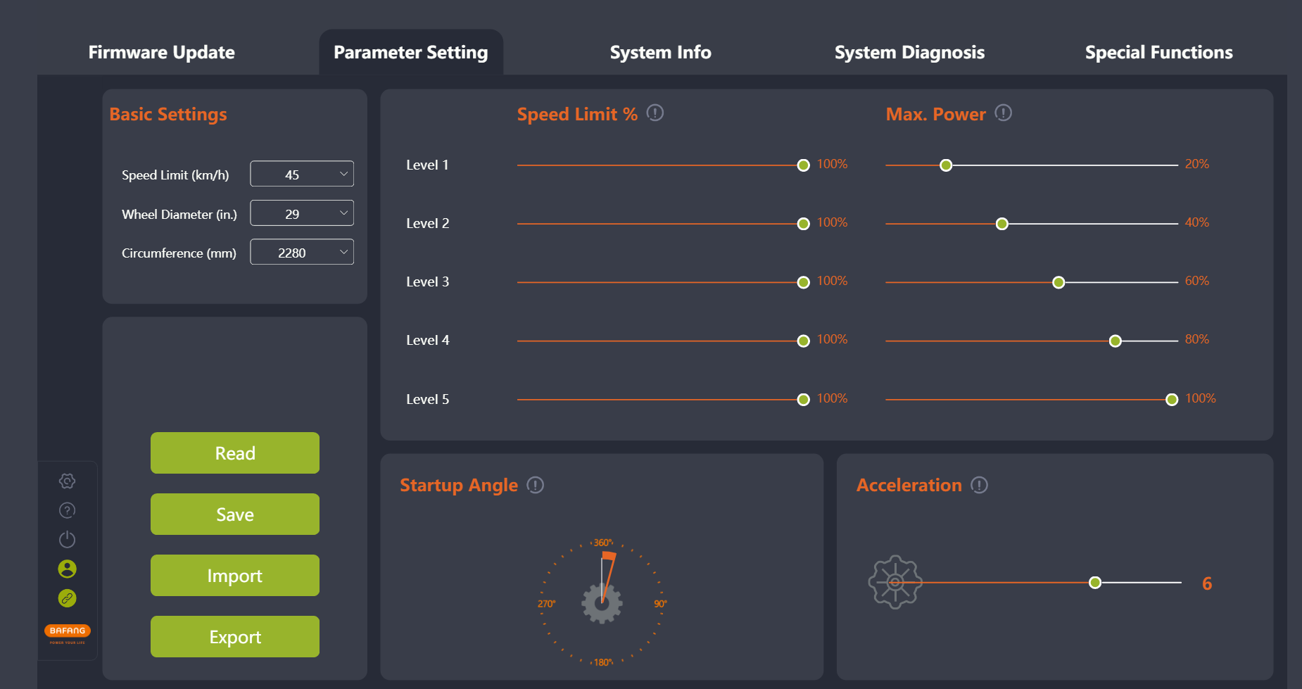

Hi guys, can anyone tell me why can I see only these basic parameter settings on my M560 ? I'm using latest BESST Pro with bypass. Am I missing something ? Thanks.
HMI
Controller
I never got the bypass software to work properly. I did however get a userid/pw from the distributor who sold me the motor and that worked perfectly for me.
Not what you asked but perhaps a plan B.

Thanks. Yes, maybe the account is somehow limited with this bypass. I will try to write to Dengfu if they can provide me login or invite line.
Follow on: what I learned was that not all login credentials provided the full feature set in the Besst software.
Perhaps the bypass suffers from allowing access but not full access to all Besst features????!
Yes, seems so. It’s pretty hard to get information about these tools. I know there exist distributor accounts and oem accounts. Seems bypass allows only distributor access which seems
to be very limited.
Try if password would change something.
But usually here Besst Pro is deciding between FC1.0 and FC2.x type settings screen.
Your looks like old controller, which has only these settings.

Hmm, this is interesting. I wonder if they've sent me the old motor - you know the noisy one from first iterration (could explain why I've complained that much about noise) or only if controller is old and the motor is last generation ? This is what I hate on bafangs dealers. They will send you something and you don't have idea what is it.

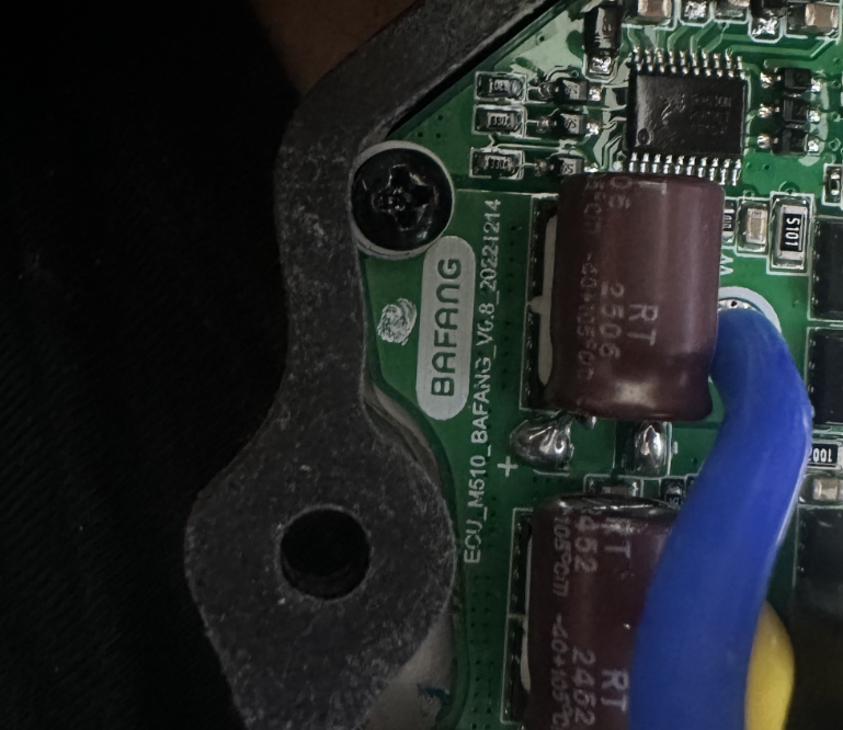

So are you saing FC1.0 has no possibility to set those extended paramaters ? I've put a picture somewhere where mine M560 controller says it's for M510. Can I replace controller from M510 to M560 ? Those one for sure have those parameters because the seller showed me.
What is interesting that or controller firmware seems to be same.
Not sure why is not showing you fc2.0 parameters. If I remember right also first controller v0.5 had all settings.
But didn't you say this ? It's pretty confusing. So do I have old controller which does not have extended settings or what controller do I have :) On board there is it is for M510 and year 2022 so I don't know what shit is this.
You need to know how it is done with bafang can protocol. If your controller does not respond to advanced power settings packets request (Acceleration and Assistance level %) then Besst Pro wont show this screen.
Yes, but you've said the old controller was 0.5. I have this V0.8 so it's a newer I guess right ? So don't understand why it shouldn't display those advanced setting. Looks more like is blocked because I'm using bypass.
Therefore I said, try that password if any change.
