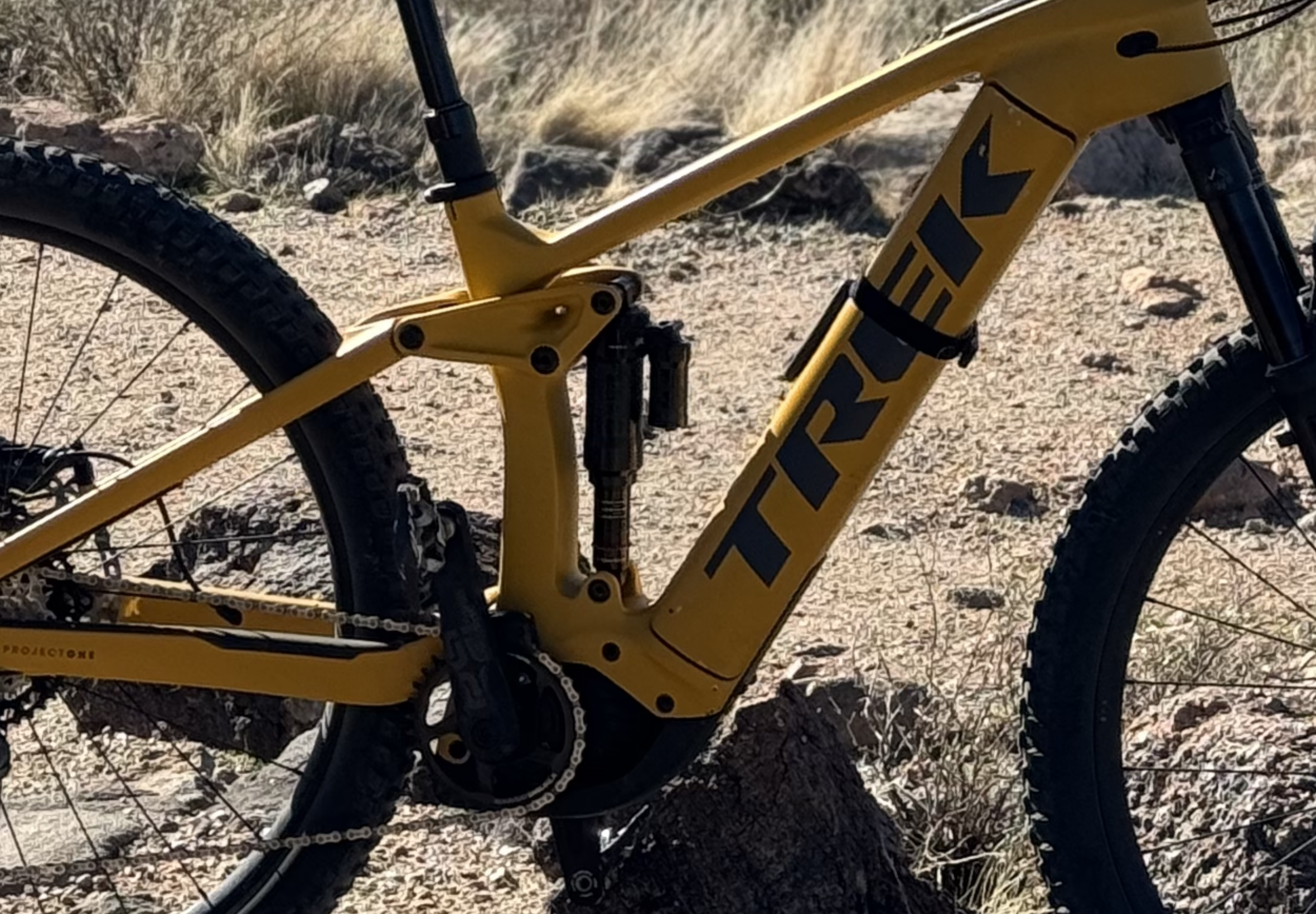

This is with the old cover and testing the new latch which is the reason for the velcro strap. The new cover seems to have a bit less gap at the top and more at the bottom. The bike is at the shop for a failure on the Zeb so I don't have a pic with the replacement cover.

My 9.8 is black so the gaps don't show up in photos but the gap is most noticeable along the long upper edge.
I have pushed the two locating/lock plates in as far as I can but they didn't have much adjustment. That has slightly improved matters though.
There are also three thick, dense rubber blocks along the back of the battery compartment to stop any vibration but they will also prevent the battery being pushed back.
The locating/lock plates on my alloy Rail are way further recessed into the frame although I remember adjusting them when I first got the bike .

My long upper gap is a bit more than the long lower gap just like yours. I have the 3 rubber blocks and I used to feel the resistance when pushing the battery in. The last adjustments they did removed that resistance. I didn't get to really test vibration/noise difference yet as the Zeb failed on the first chunky downhill 6 miles in.

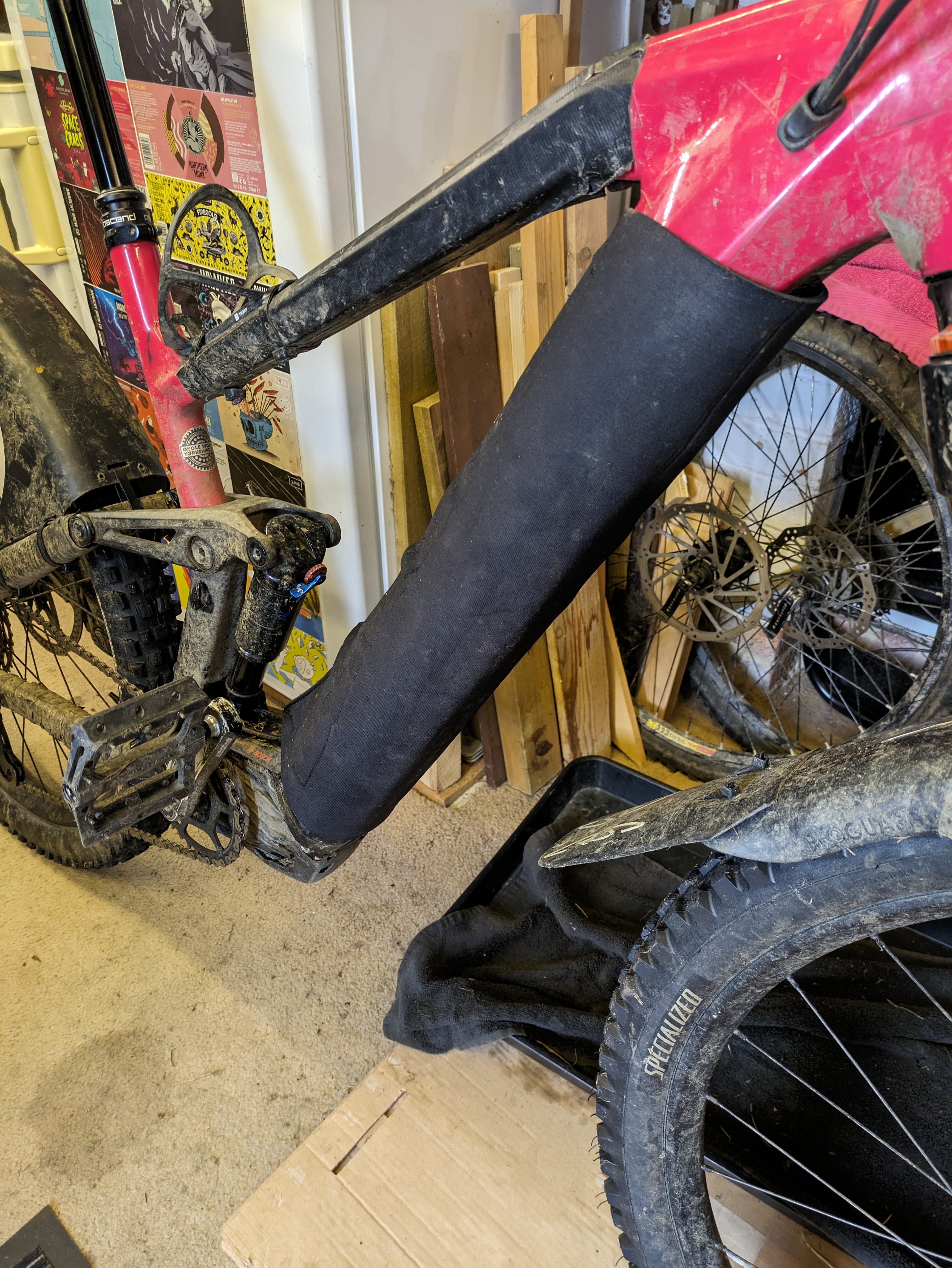

Not Trek, but these neoprene covers from eBay ect cover any gaps and make good protection for the downtube.
No links as I had it given a couple of years ago.

Have made my own neoprene cover (well, my wife did). Works great but looks almost as shit as the shit it keeps out and I don't want to have to use it in the summer.
