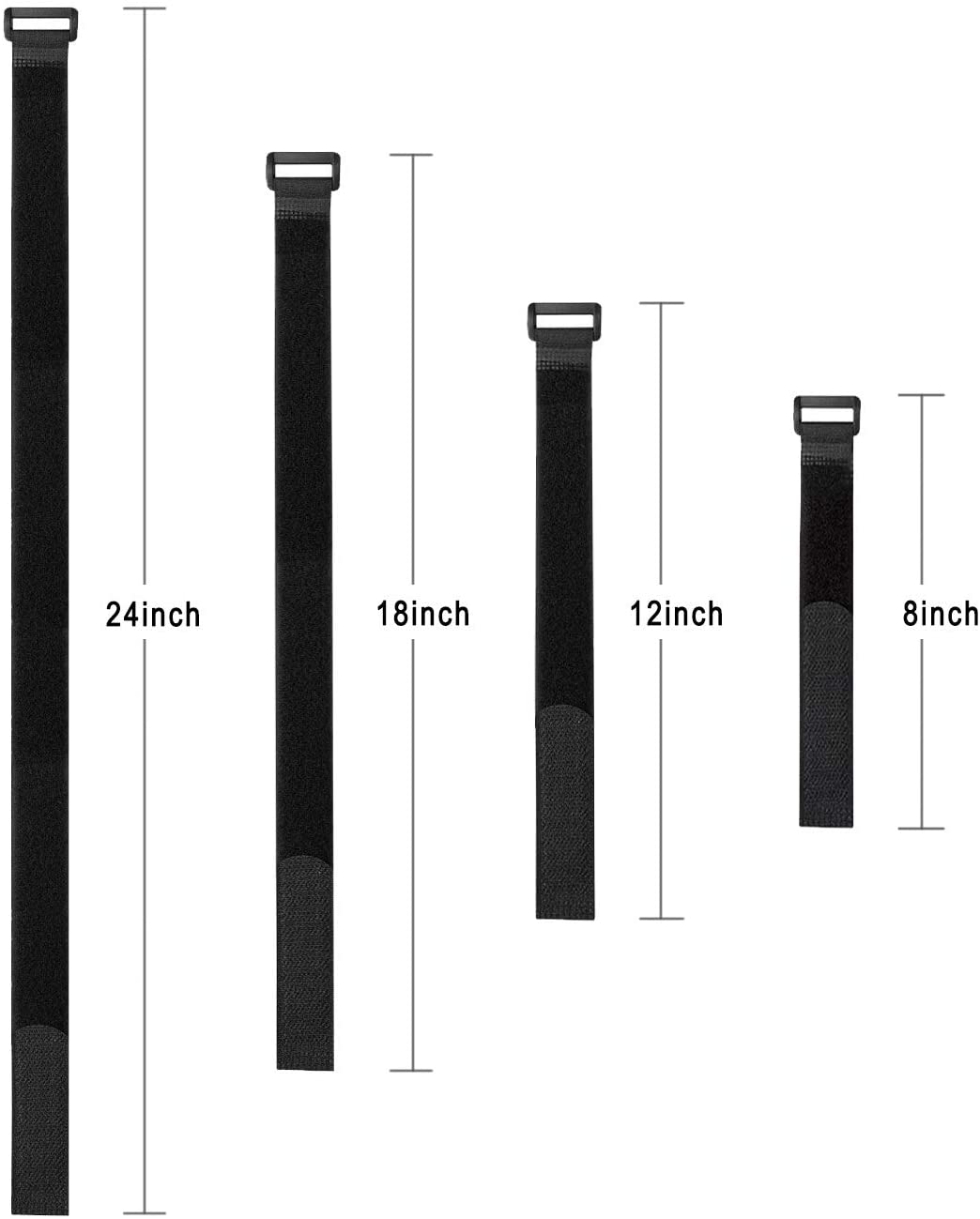

Yes, that's right.
The strap I use is about 1"x18" with a simple plastic buckle and is very secure.
They are very cheap for a multi-pack of various lengths on Amazon, useful for lots of other jobs too.
