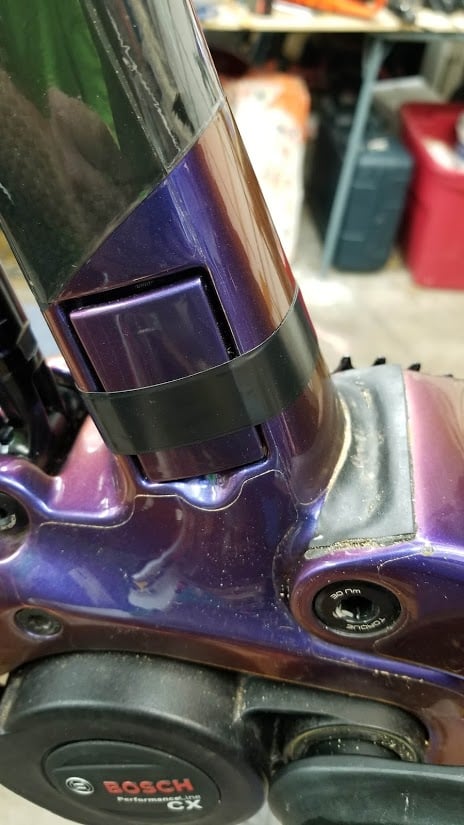

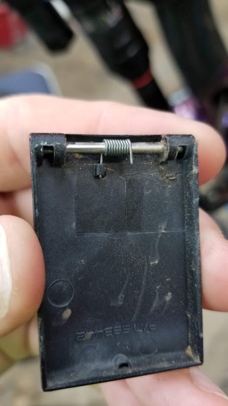

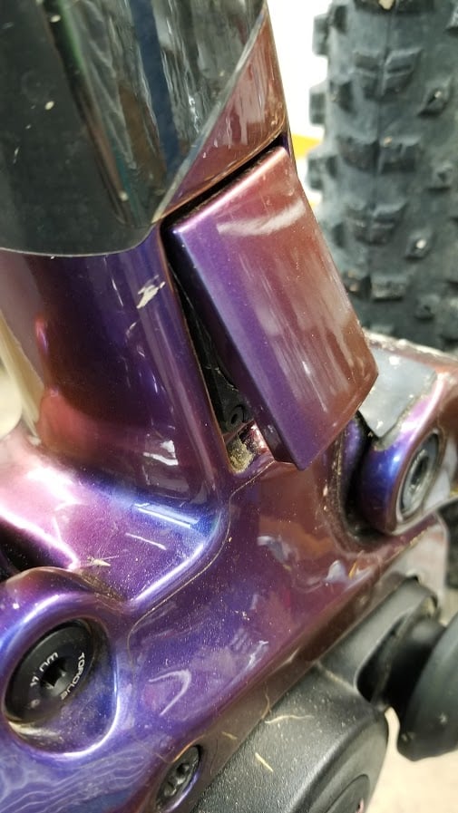

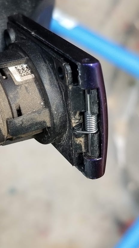

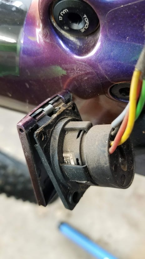

Has anyone else had a problem with the charge port door? I unplugged the charger yesterday and the flapper is now stuck open. Looks like the spring has slipped and is now pushing against the door closing.
What a shit design. There's enough slop in the plastic hinge to let the tiny spring slip past the stopper. I've fixed it three times today and everytime I open the charge door fully the spring slips.
I'm taping this mofo shut unless there's a design fix or revised replacement part.

I looked into this on a Rail I have access to. I popped the cover off and the way the spring gets stuck open is from opening the flap all the way. If you are just opening it up 3/4 of the way to fit the plug, the spring shouldn't pop through between the face and the door.

It was just a suggestion. However, even fully opened I couldn't make the spring pop out - this is on a 2021 Rail 9.8. Don't open it further than needed and it should be set in place and the tail of the spring will hold the frame of the charging port.

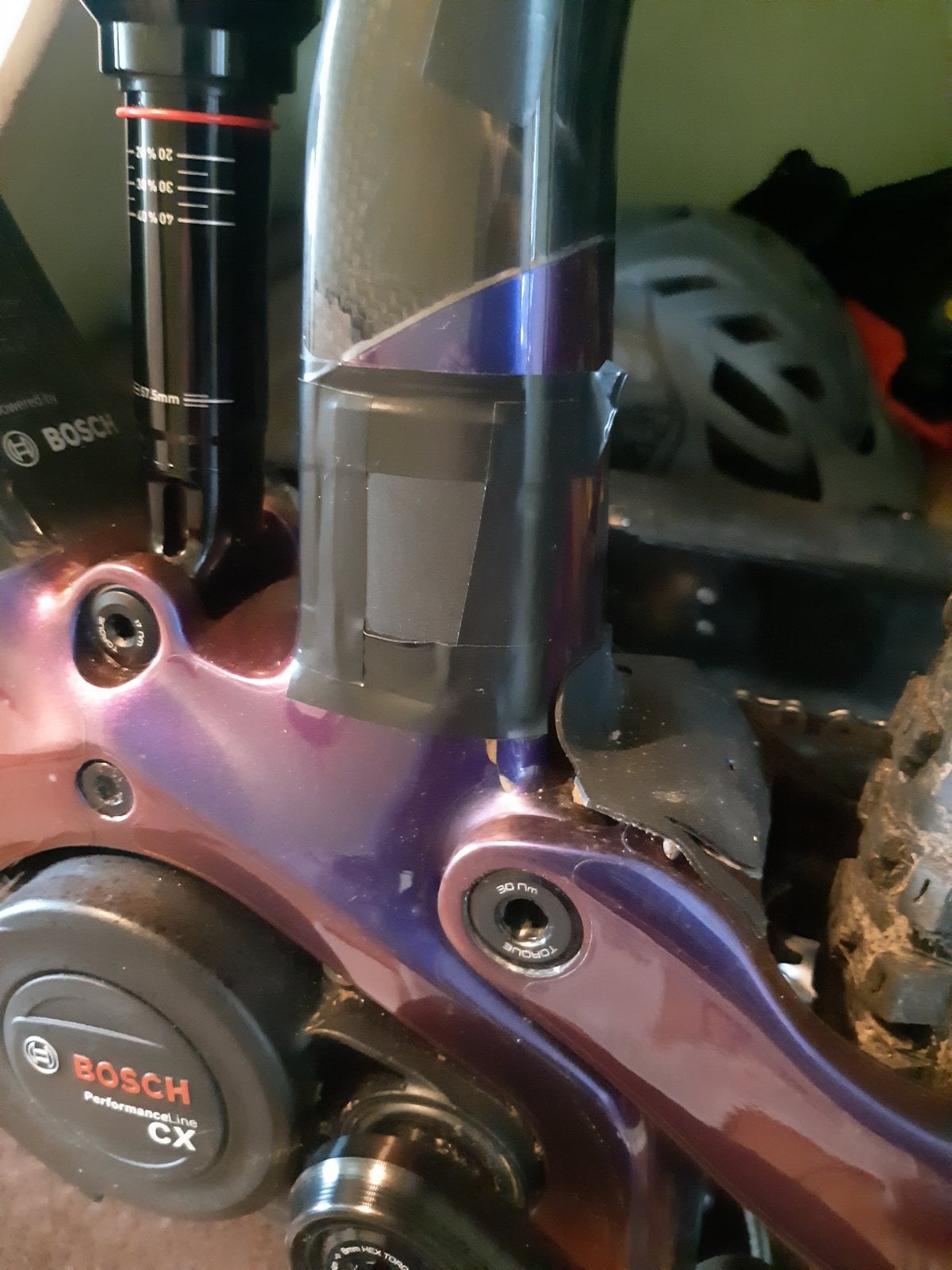

I have a 2021 rail 9.8XT and the flapper lasted about two weeks. Now it's permanently taped shut. Please find whoever it was in the company that made such a poor design and give them a nice hard kick to the nuts.

Maybe velcro would work as your kludge, easier than tape to open close. My charger came with a velcro cord tidy that is about the right size, don't know if yours did

looking at the earlier photo of the charge port I would be equally concerned about the gap and lack of any sealing between the charge port and the frame. Water ingress there would go down the tube probably following the cable connected to the charge port to...........?

So... what I figured out is that the door is meant to go up and slide into a slot at the top so as it stays open when charging. After charing you pull the door straight BACK then release and it closes perfectly. If you don't do that, you wind up with the door sitting partially open like in the first pic of the thread.
