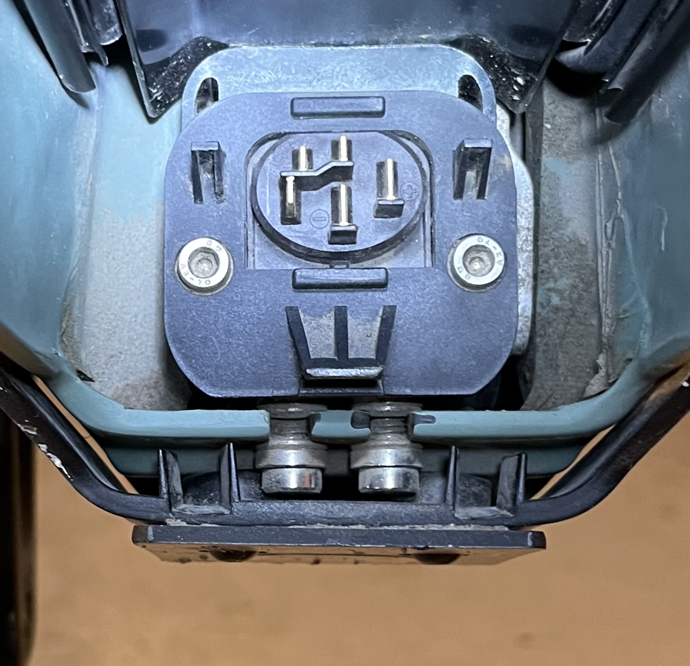

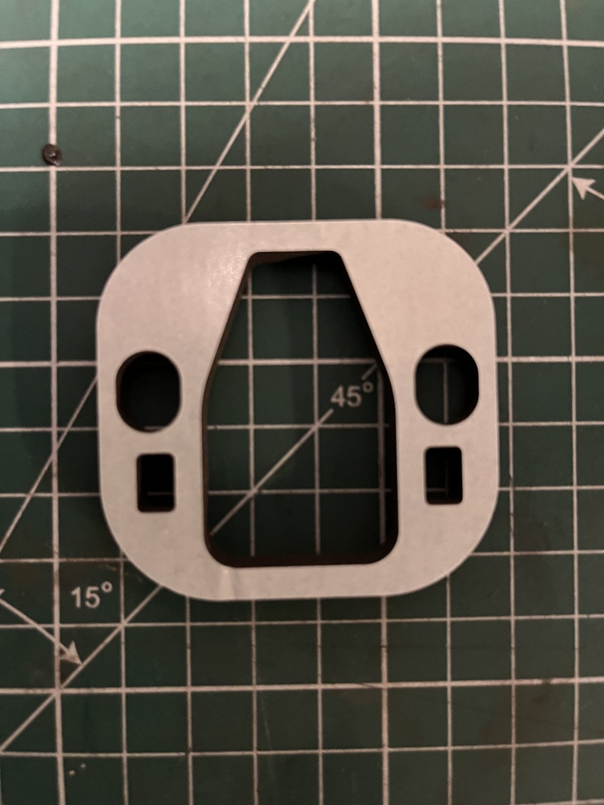

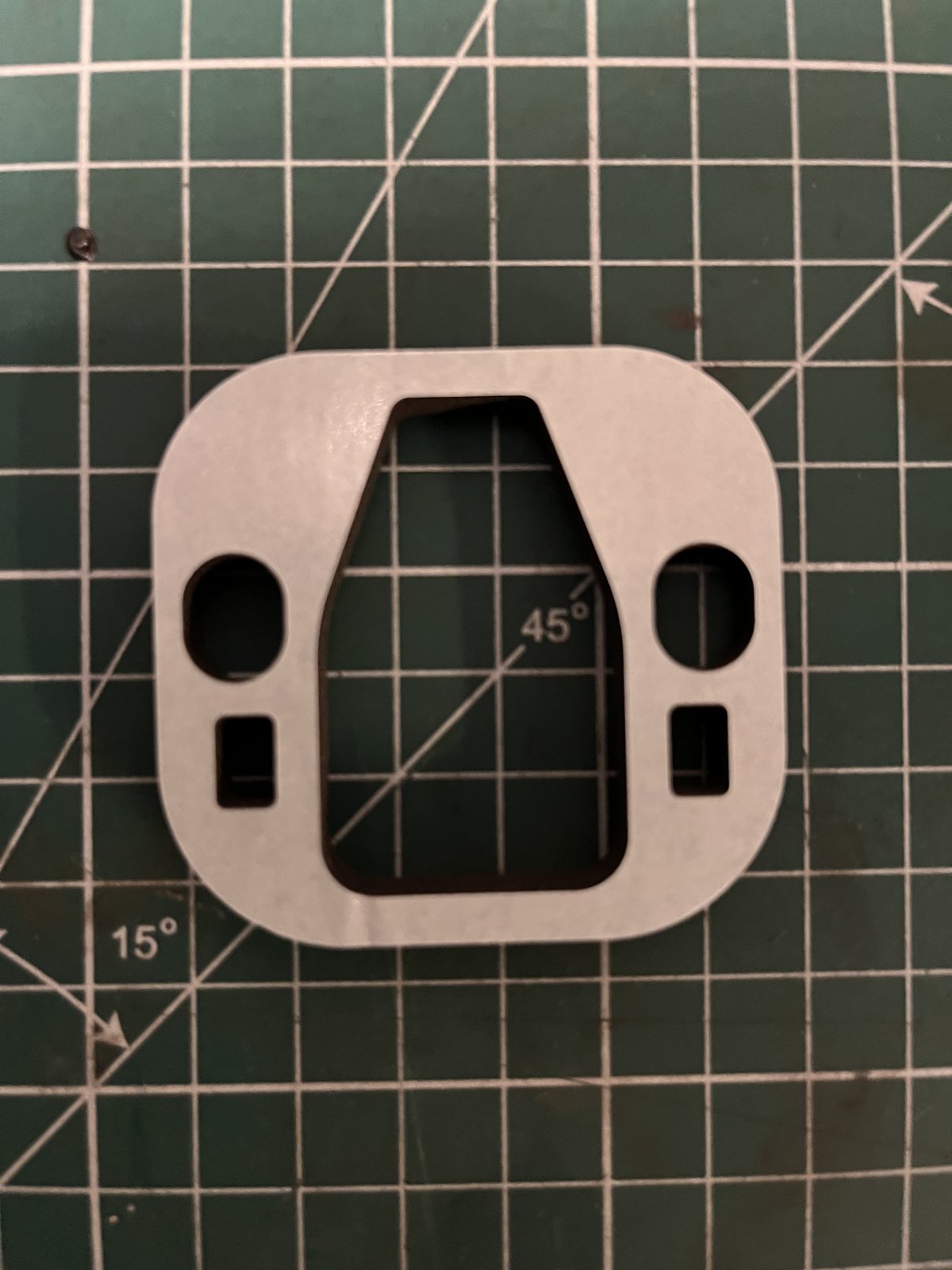

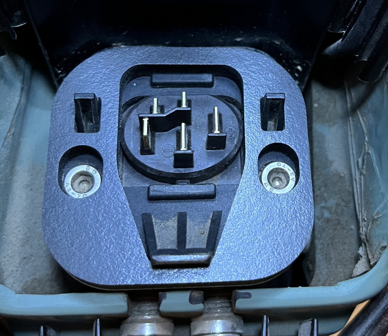

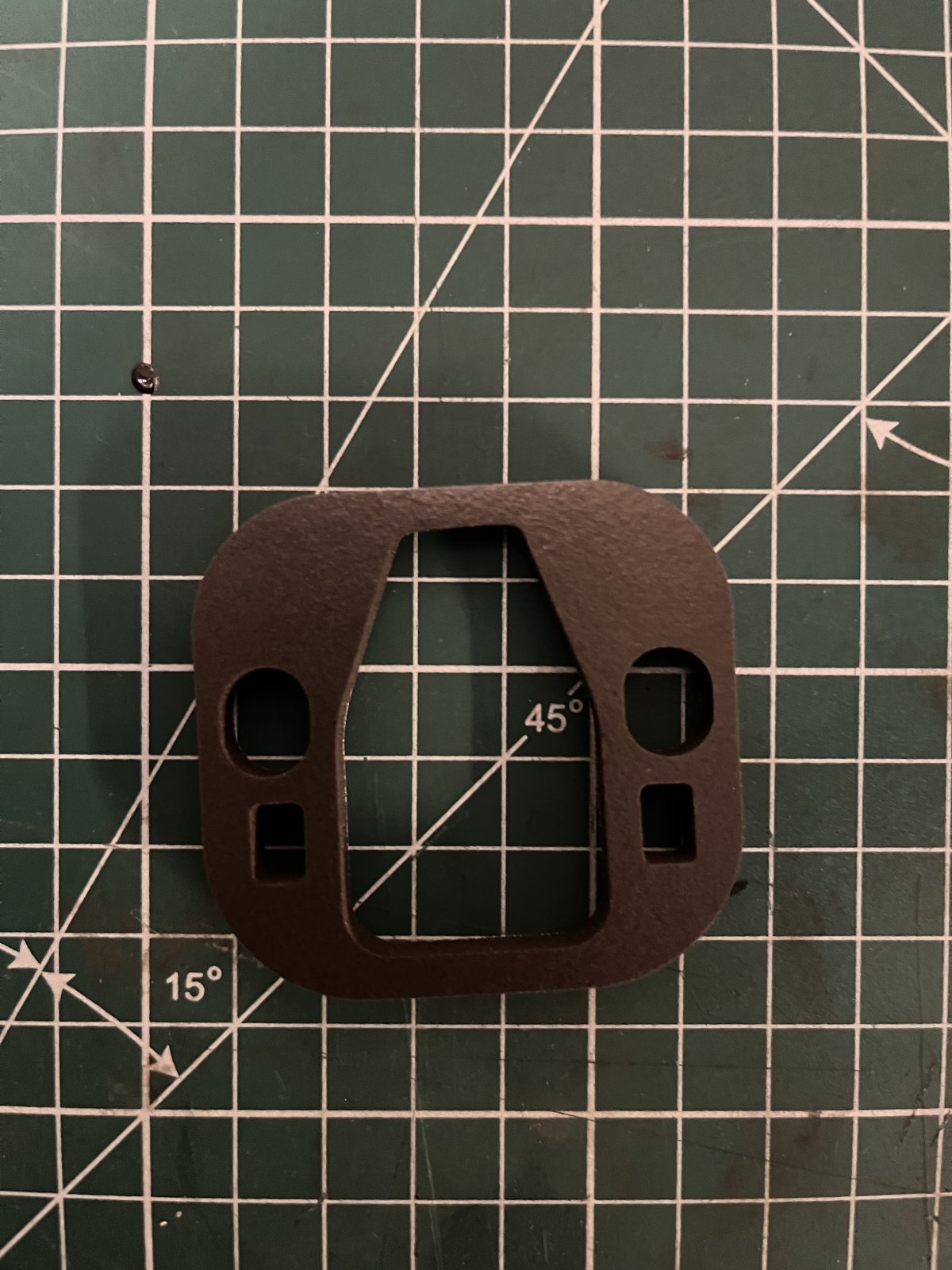

Just an update and installation guide for those interested.
Took delivery of the damper today.
Removed battery and degreased/cleaned the area where the battery connects, being carful not to touch the contact points.
Dry fitted the damper to check the fit.
removed the adhesive backing.
Placed the damper over the battery locating lugs. This guide the damper in position.
Pressed firmly to seat the damper on to the mating surface.
Installed the battery and jobs a good’en.
Installed the battery and jobs a good’en. View attachment 95701 View attachment 95702 View attachment 95703 View attachment 95704 View attachment 95705

Thinking about this I cant see this as a good thing for the simple reason its lessening the contact points on the battery connection
Just a thought .
Possible - on the other hand its adding just enough cushioning to hold the battery tight and might stop the battery grinding down the contacts through friction and unnecessary movement
Just a thought .
From the install and a good look with the battery fitted. There is very minimal loss of the battery to the contacts. The foam is dense enough to distort when clipped and locked in, with the other areas of the damper cushioning the battery to stop the rattling.
Off for a ride in a bit so will give a full review a little later.
