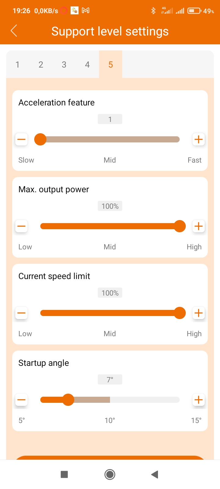

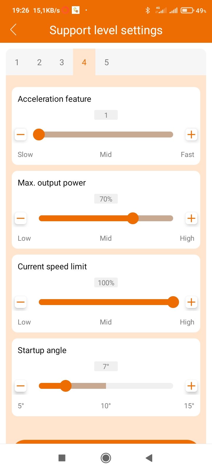

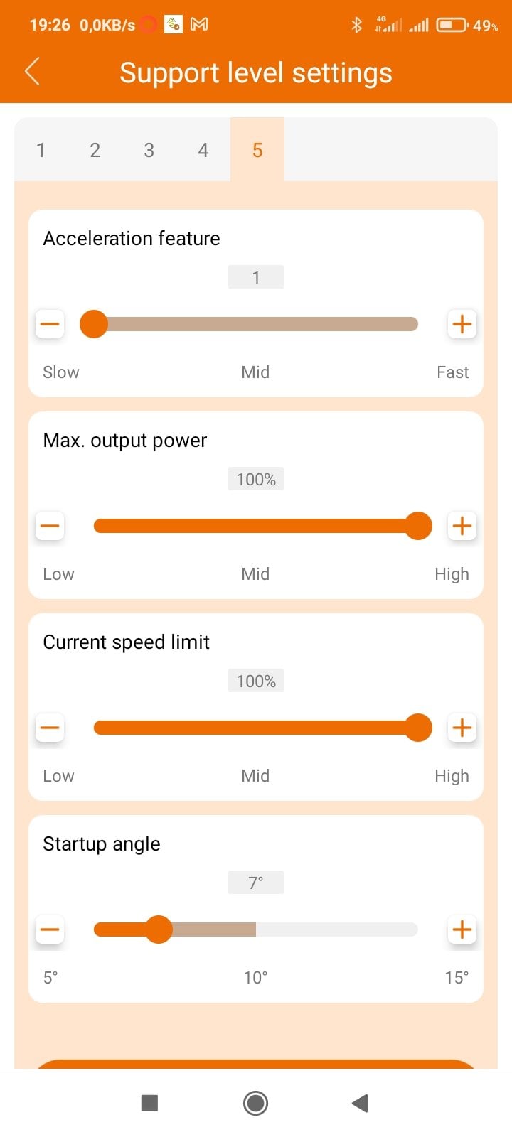

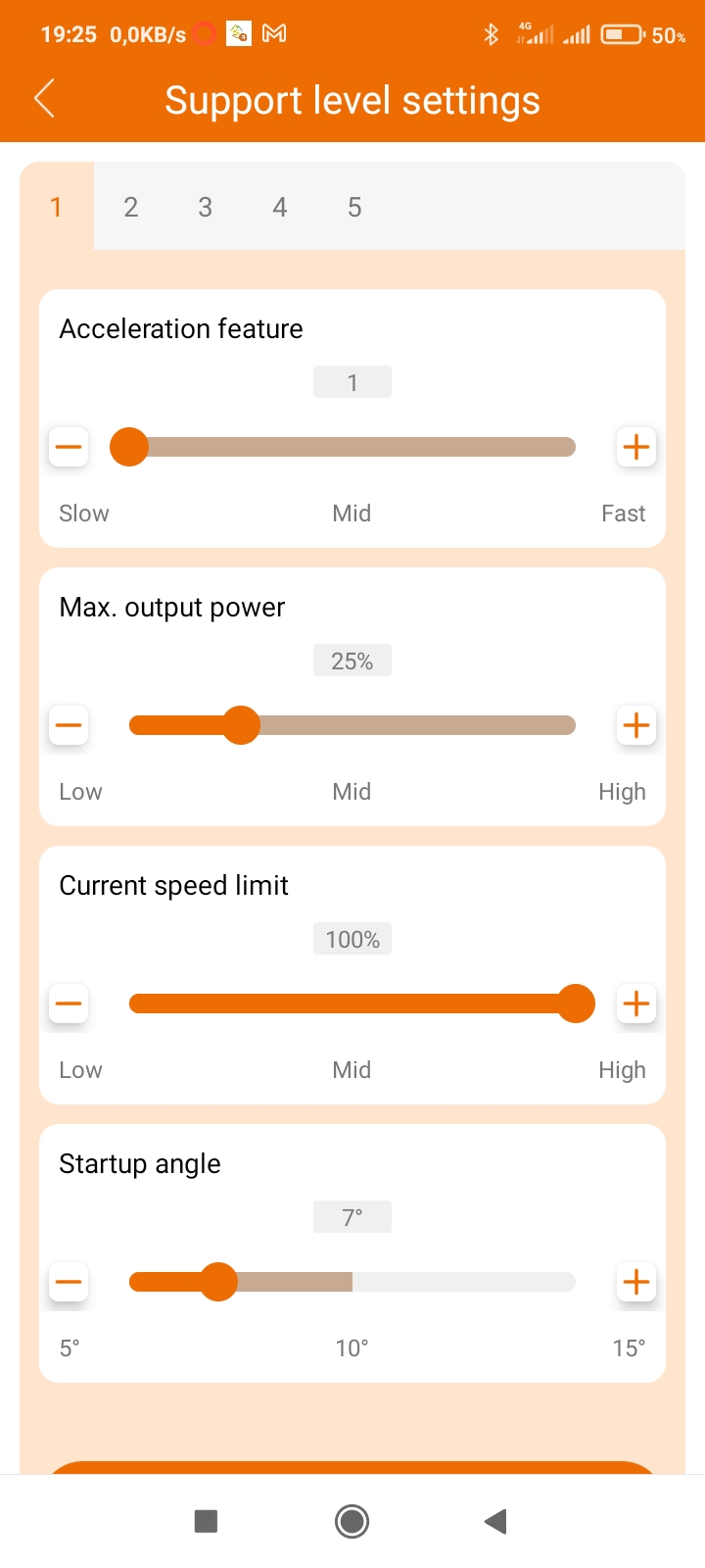

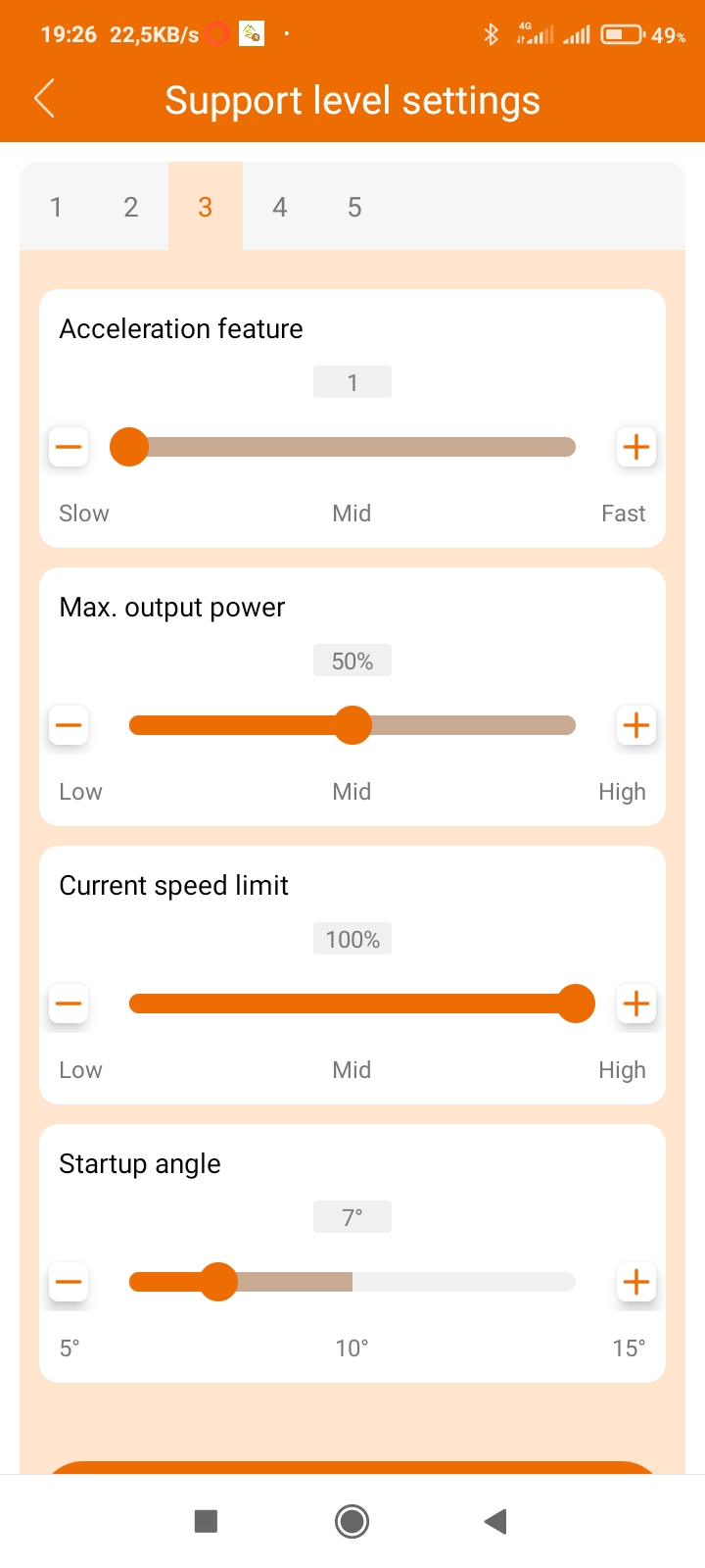

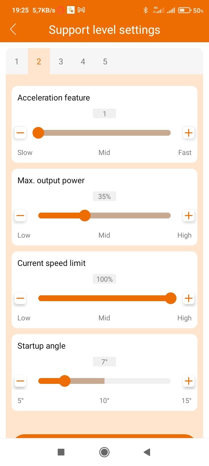

Hi, I have the LCE930 ebike with the Bafang M820 motor.
How can I configure the motor parameters with the Bafang Go+ App, to get the best performance from the motor? Currently I have it like this:
Screenshot_2024-08-21-19-26-19-500_com.bafangen.ride.jpg Screenshot_2024-08-21-19-26-09-529_com.bafangen.ride.jpg Screenshot_2024-08-21-19-26-04-446_com.bafangen.ride.jpg Screenshot_2024-08-21-19-25-58-532_com.bafangen.ride.jpg Screenshot_2024-08-21-19-25-48-240_com.bafangen.ride.jpg
Actually you can set just Global Acceleration and Max power at each PAS level.
Current speed limit does have nothing with speed - it is max RPMs of rotor, leave at 100%.
Startup angle - how quick engaging motor after starting pedalling. 10 Degree is fine.
This motor does not support Assistance level (torque sensor sensitivity, only M510 FC2.0 and M560 is supporting so far).
But check for the motor firmware version. Bafang is sending 43v version with 10A max. You can flash there 13A firmware, which will give you 130W more.
130 w more ? please explain?
If you have 43V firmware with 10A max (check SW controller version ...4310E... ) you getting peak 450W. If you have 13A you getting 585W

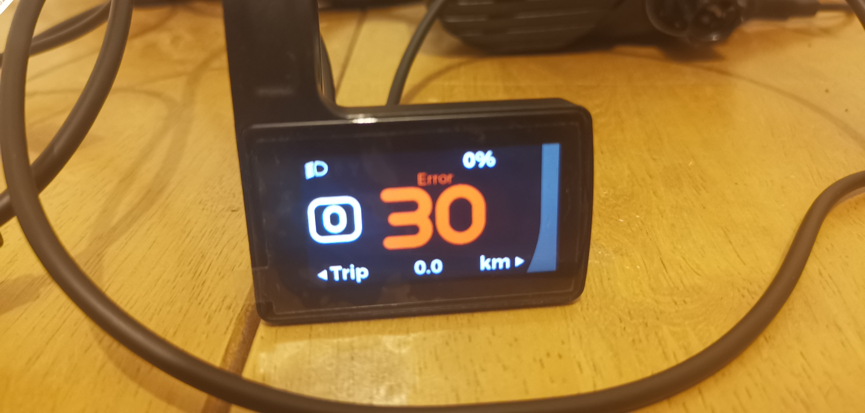

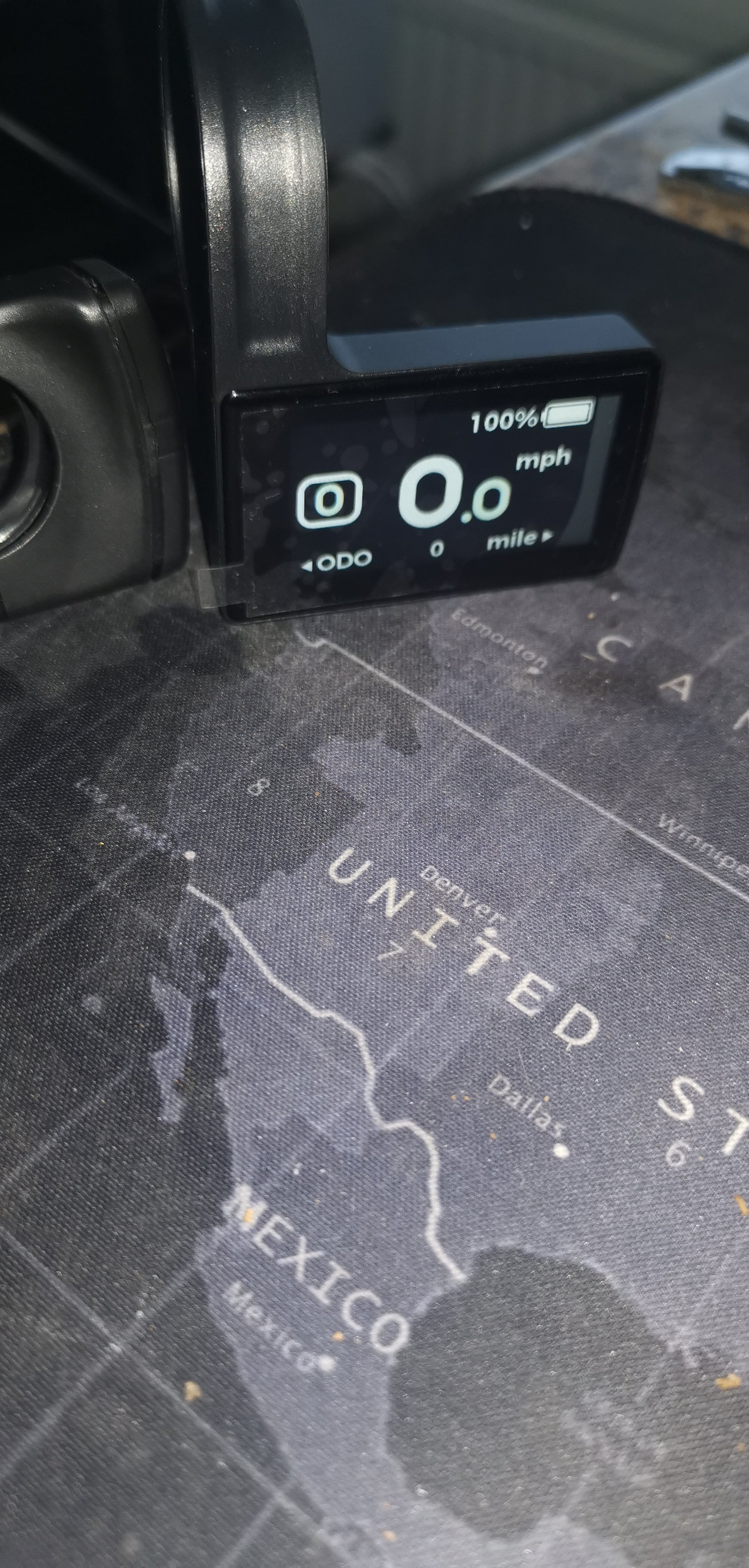

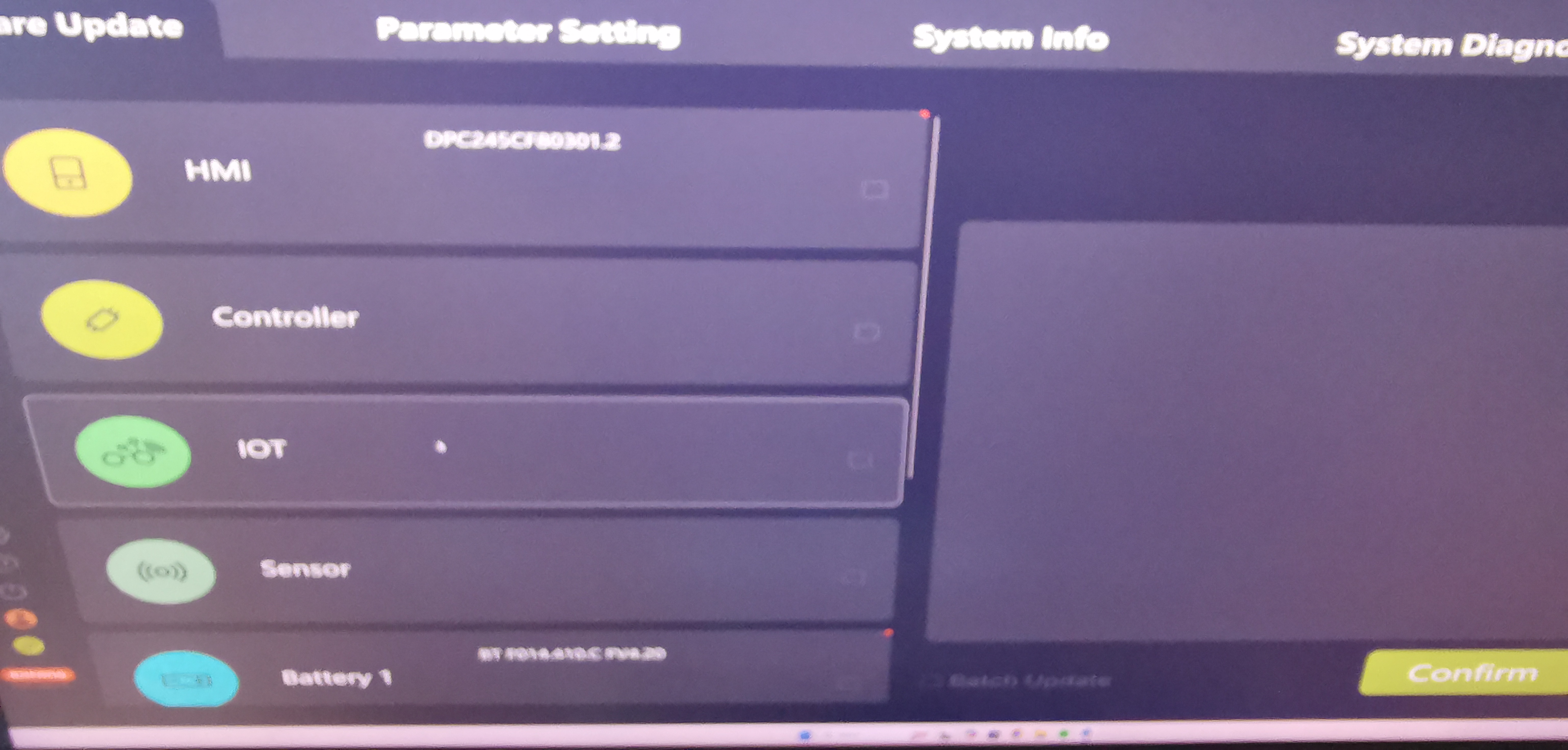

hi everyone looking for some advice regarding what to do next first time building a e bike.
so i connected all the electrics up the other week motor battery headunit and the display turned on for about 20 seconds shows error code 30.
so i read most of the information regarding this setup on this forum and decided to purchase the bafang besst tool.
i have connected it all up today and this is the information it has displayed.
any tips would be greatly appreciate.
View attachment 156896 View attachment 156897 View attachment 156898
Error 30 - no communication or faulty communication on CAN bus between controller and display. Check cable and connectors if plugged properly till the end.
Besst wont solve this issue.
Unplug all your connections cable and plug in again , try several time if possible , both my bafang motor when news has all kind of funny connections problem but after few unplug, problem solved. Pls unplug the extension cable too. Me and most of my Bafang friend been getting error 21 when new and to solve it with disconnect n connect cable.

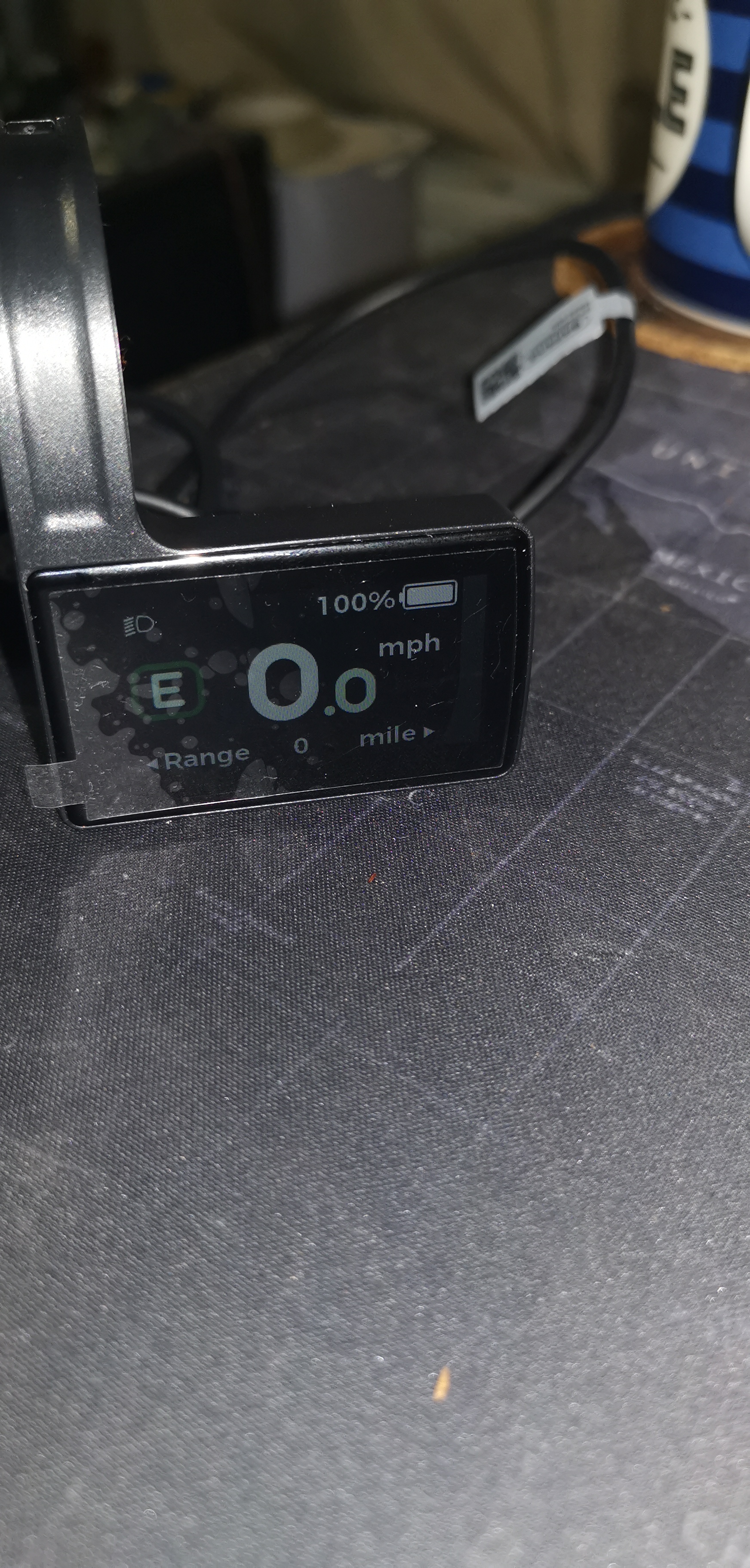

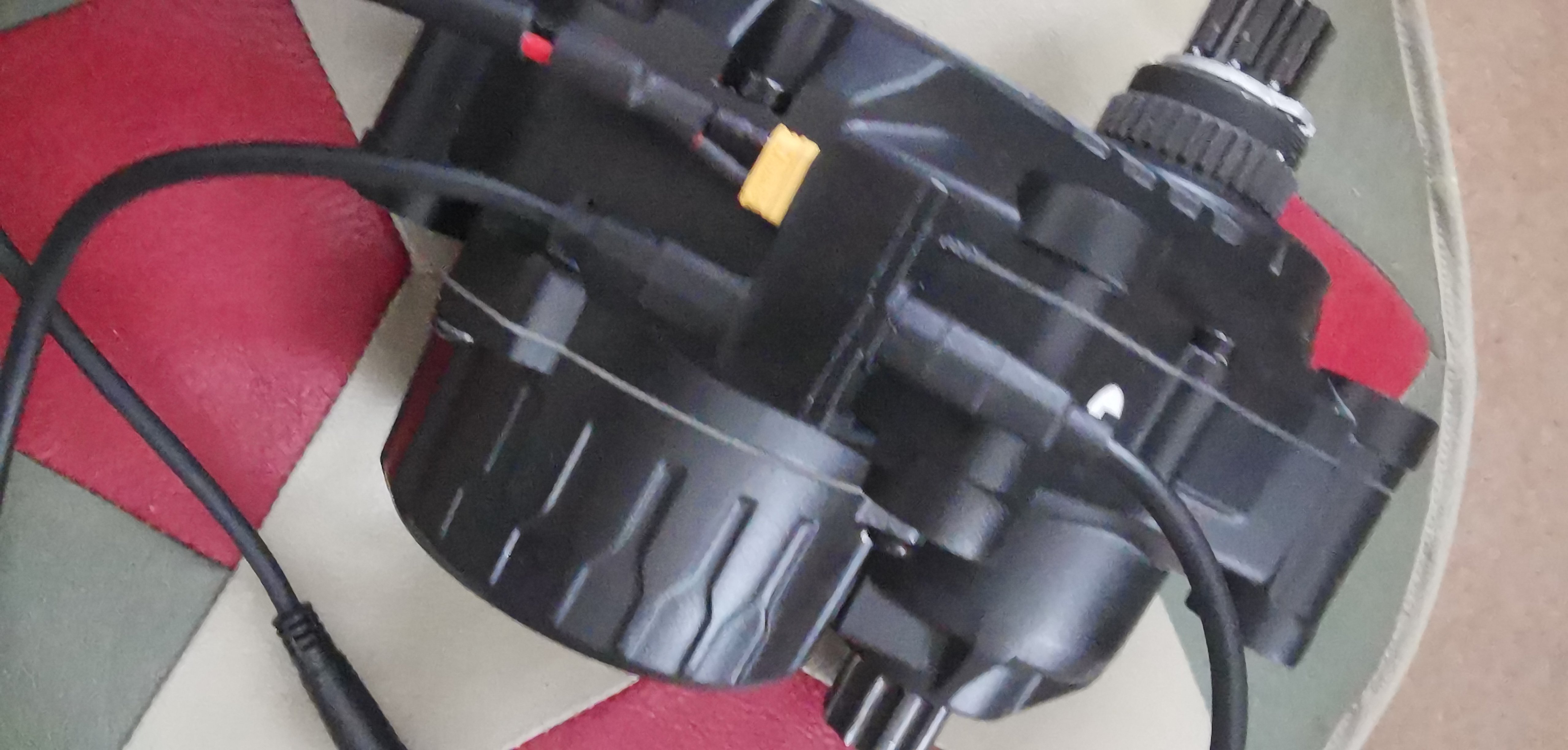

thanks for the reply i purchased the besst tool just to connect everything up and see what works and what dont and for future maintaince. when i plug the display into the tool i get this. the plug that goes into the motor i have made sure its fully inserted. ordered a new cable 1t3H just to see if its that.
am i right in thinking that if the controller is not showing on the besst tool is because eitheir the cable or controller is damaged ?
thanks the 1t3 H cable that goes into motor seems like its not fully inserted but i have pushed it in fully. ordered a replacement cable

I have seen ERR30 a few times now, always because of the cable to the display pulling out slightly. I get quite a bit of overgrowth dangling down onto the single tracks and it seems to pull that cable enough to slightly dislodge it.
Yes, Besst is powering up display, so will turn on.
If Besst wont read controller, then faulty cable or controller is gone. (Do you have main battery cabled and turned on? Motor is not powered from Besst.) But I must say, newer seen a brand new controller which was not able to read by Besst yet. They are testing it in a factory and flashing controllers at the end of production line.
thanks for the information. i have the battery connected via the yellow socket and the green plug that goes into the 1T3H lead. that lead then goes to the motor and the display. you mentioned about turning battery on there is no manual switch is it just a case of using the button on the left controller ?
i left it all powered down for a few hours then took another look when i connected it all the display had the battery icon empty and flashing i plugged in the charger the green light flashed for a few minutes then the display showed 100% battery still no controller appearing though so im hoping the replacement cable i have ordered will sort it.
