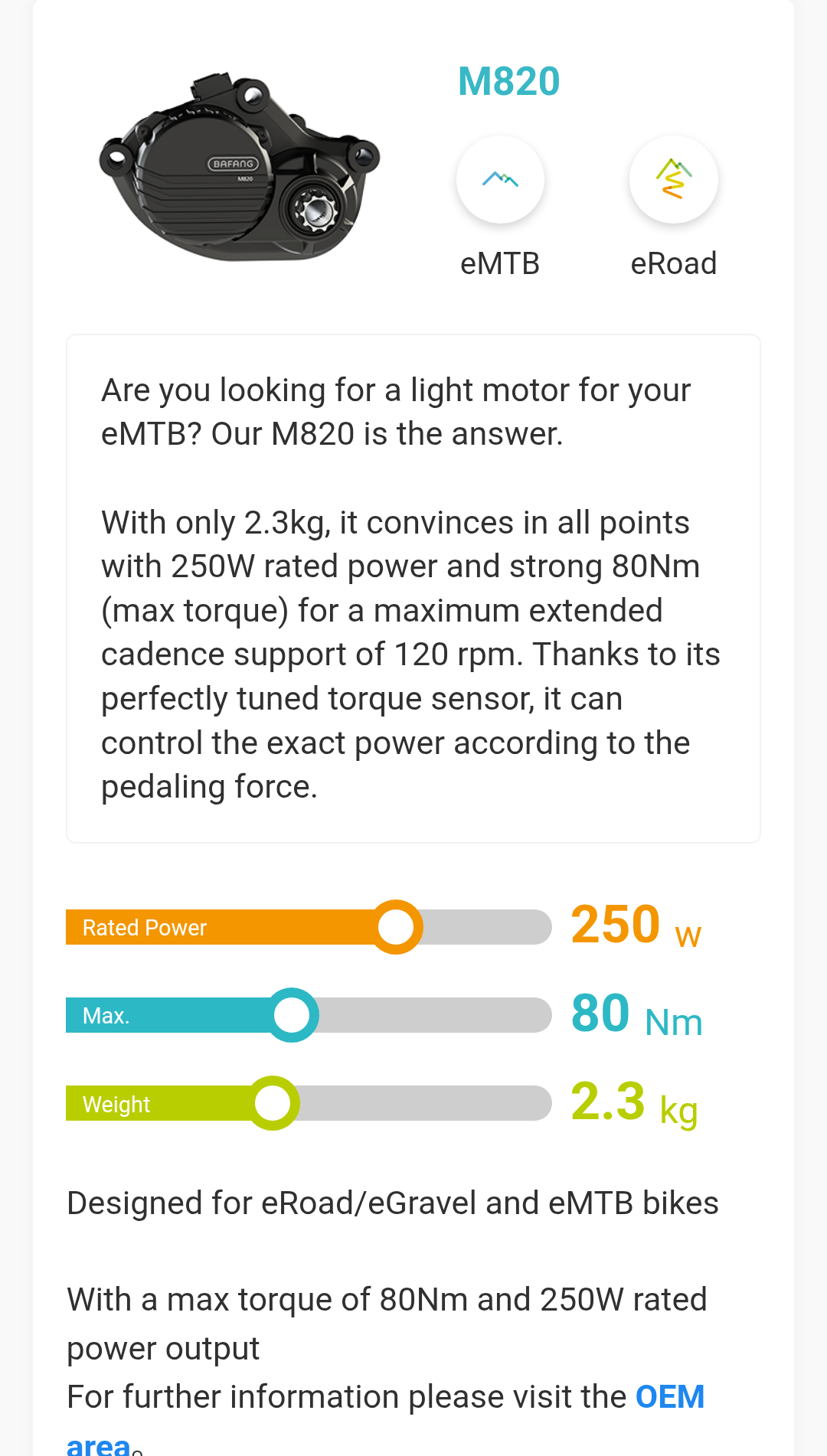

Have you noticed that the Bafang website states that the M820 motor is rated at 80Nm? Does anyone know anything more? Has there been any new firmware or changes made inside the motor?
I am expecting some revision and with higher current. Can be like 15A with 43V.
Just they asking for more motor failures. ;)
And you right, also saw motors coming recently with 10A and 43V.
I don't think, there will be any higher current firmwares. IMO it was just marketing fluf, now that Bosch is increasing their values with the FW. And if you would ask them, they could just claim "different way of measurement" or some other bullshit.
That is just my personal take. 🙂

I've owned my m820 for a year and a half now, theres no way its 80nm.

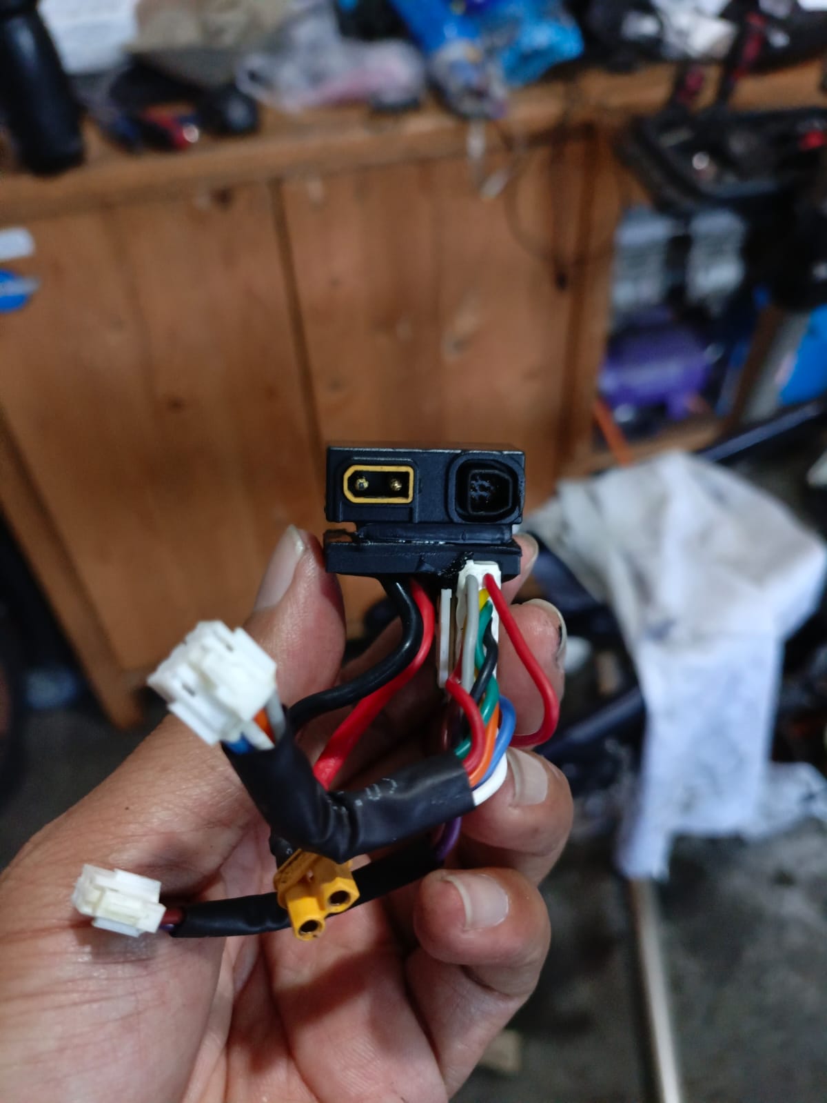

Can anyone tell me where I can get a replacement bike charge port? Bike tipped over while charging and cracked the orange flange. Still working but I want to replace it.
Mine has been cracked since almost day 1
I bough second one, from ligthcarbon, while I was ordering some other stuff. Aaaaand cracked it almost immediately. It is shit quality....
I glued it somewhat, and add some additional support around the plastic with cyanoacrylate and baking soda.

remove the socket, run the cable through it (seal it well) and terminate the cable with a new socket.
