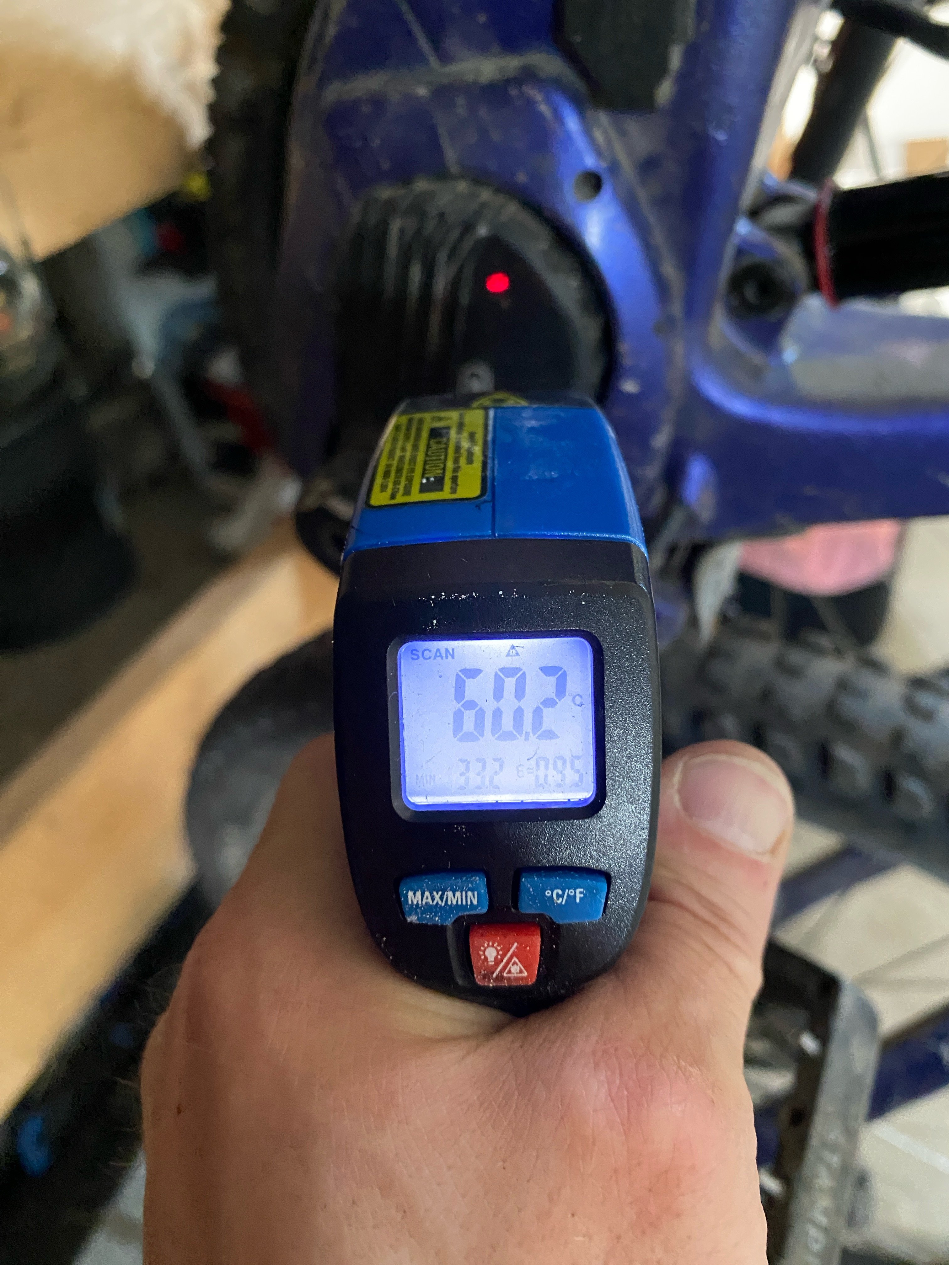

How hot is too hot? After 3 hour ride, last half hour boost and pushing all the time. 60 degrees Celsius seems like a lot.
I have had this before and haven’t noticed any issues, I am just wondering..
