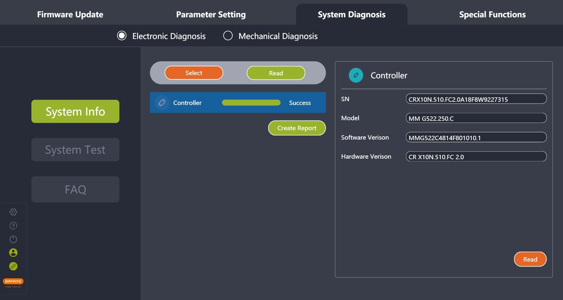

This is Hardware and Software version of new Bafang M510 version 2.
