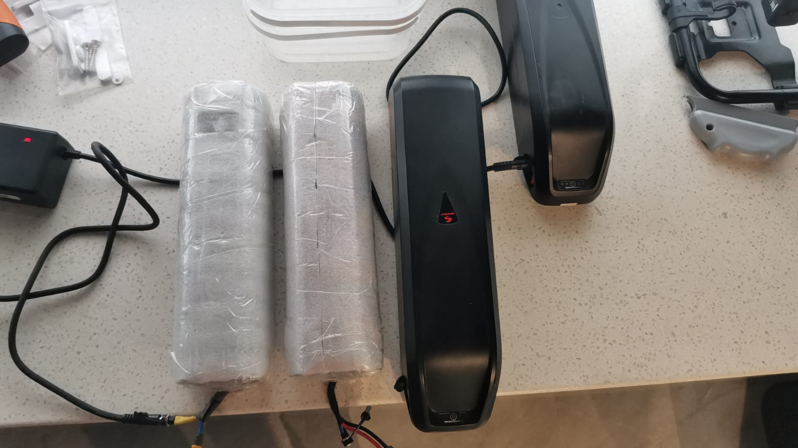

Viva la Velcros i am going to try them soon.Basically you can save around 1 Kg because the battery case is around 800gr and the lock and mounting plates of the battery are also 440gr or so .And if we make a battey around 600wh than we can have a bike around 20Kg or so with the m510 and dengfu frame
You're right. I have already done so 2 batteries. The 14An battery weighs 2.7 kg. My bike now weighs 20.3 kg. with a battery.
But I still want the M820. I'm looking for a lighter frame for the M820. A good bike should weigh 17 kg.

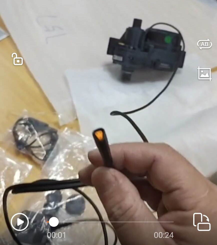

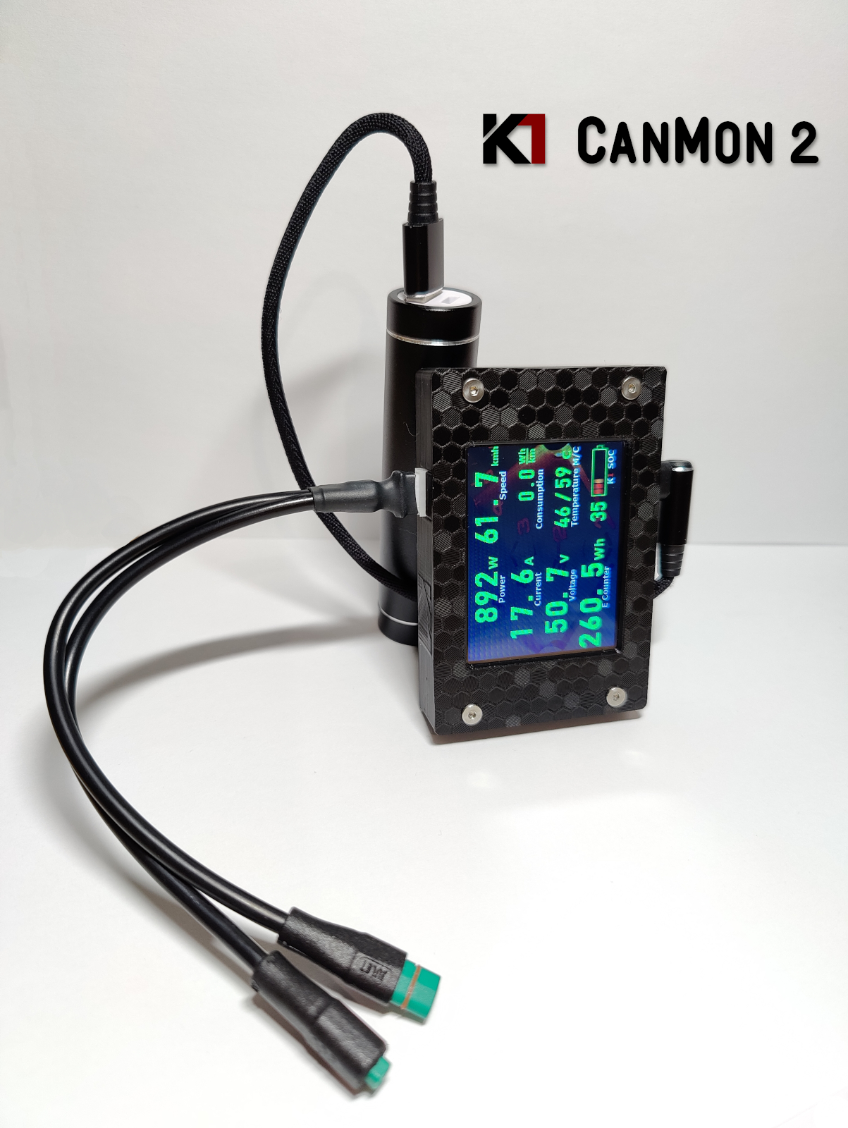

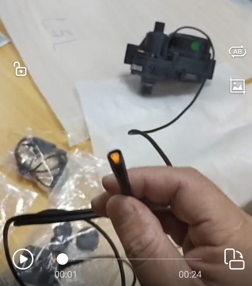

Hello mate. I doubt displays/buttons with BT would support speed limit settings, or firmware flash. Not sure though. Anybody was able to set speed limit over BT?
So you would need a BT to CAN box (which needs to be coded and again reverse engineering of Bafang BT protocol) and then apps for android and iphone, which is pain.
So for now a device, which can be used also as a display - when not raining. ;)
Later will try some silicon orings, ifthat would do the job.
Can you please clarify why? To be honest I don't really understand this obsession with making the bike light.
Having an extra few kilos on the bike don't really hinder you that much. Having some extra juice in your battery on the other hand might mean a lot during some long rides...

I like light bikes. I always take a spare 2.6kg battery with me. When driving in the mountains, two batteries are enough for 100 km. When driving on a straight road, I think it will be enough for 200 km. 24Ah is better than one 17.5Ah
My e 10 with my 700wh battery weights 20,1 Kg . With 150mm RS Pike and RS Ultmate deluxe damper. Potential for reducing weight is only small battery or carbon rims … but carbon rims .. I don’t dare. It depends for what you wanna use your EBike. I like to have a small weight because I want to jump high. For tours it doesn’t matter if your bike has 20 or 25kg, I agree.

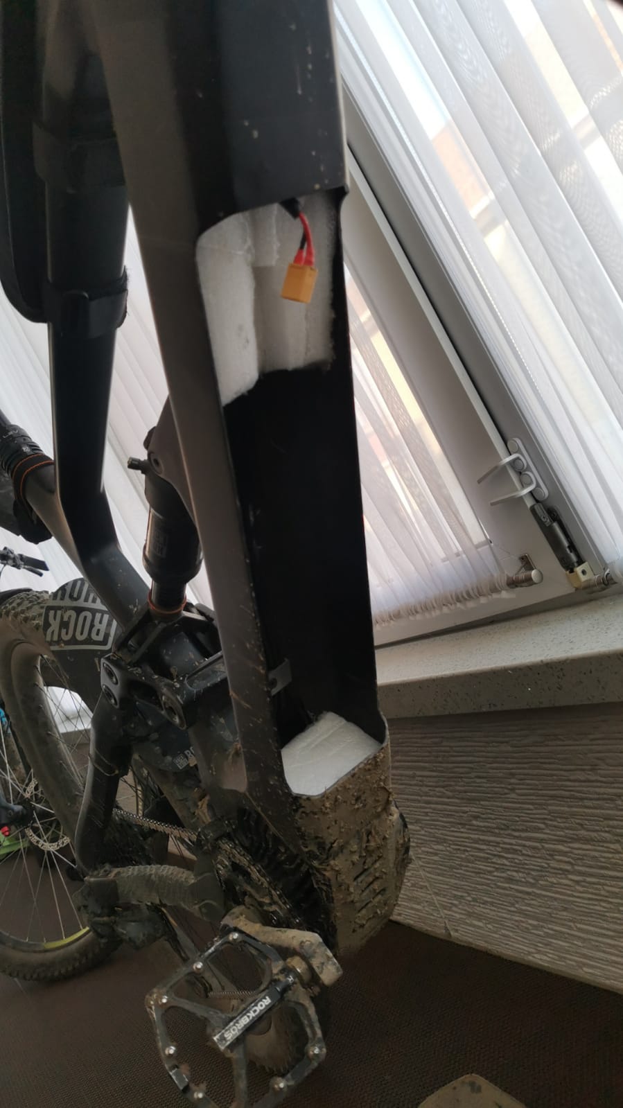

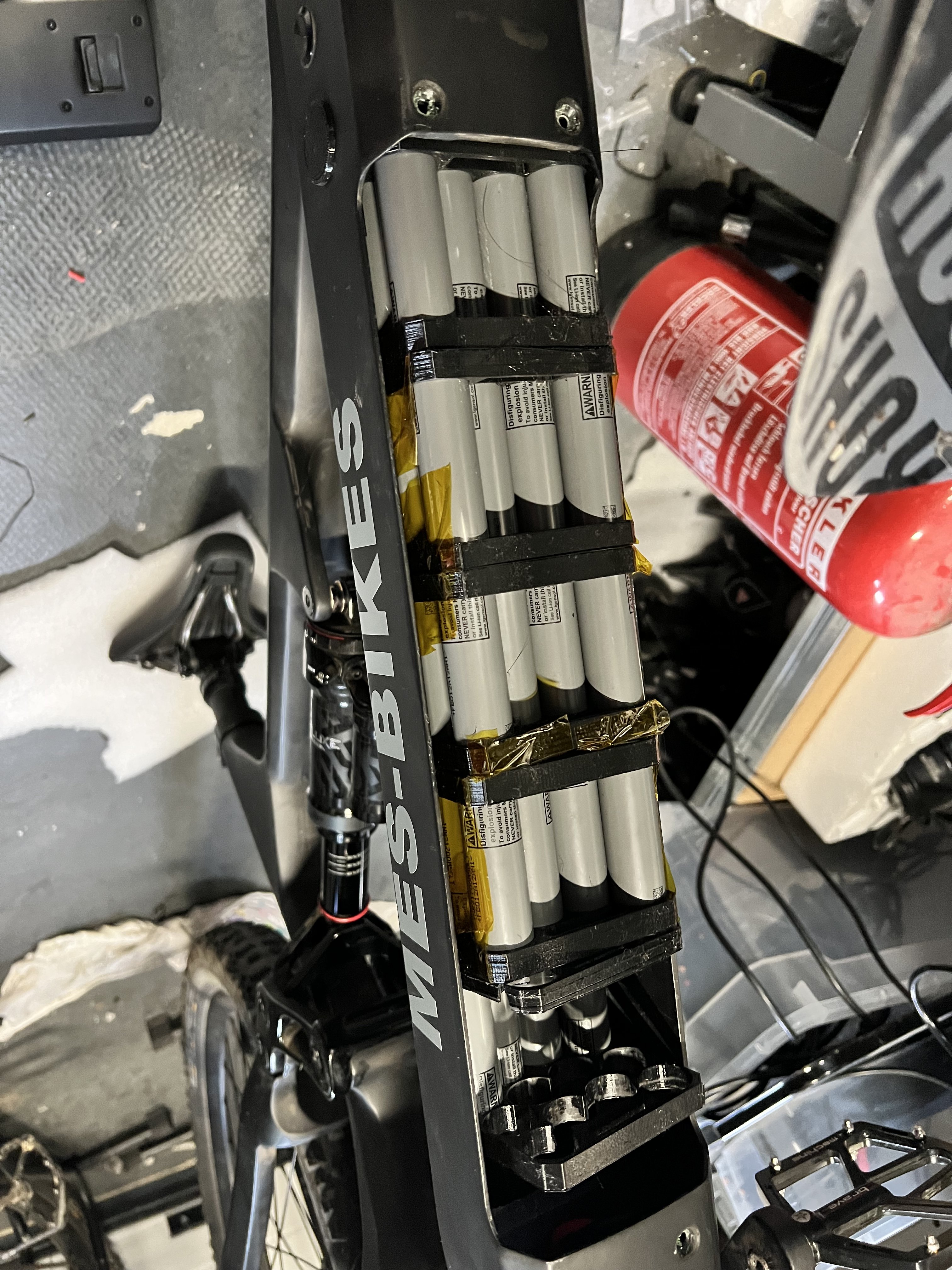

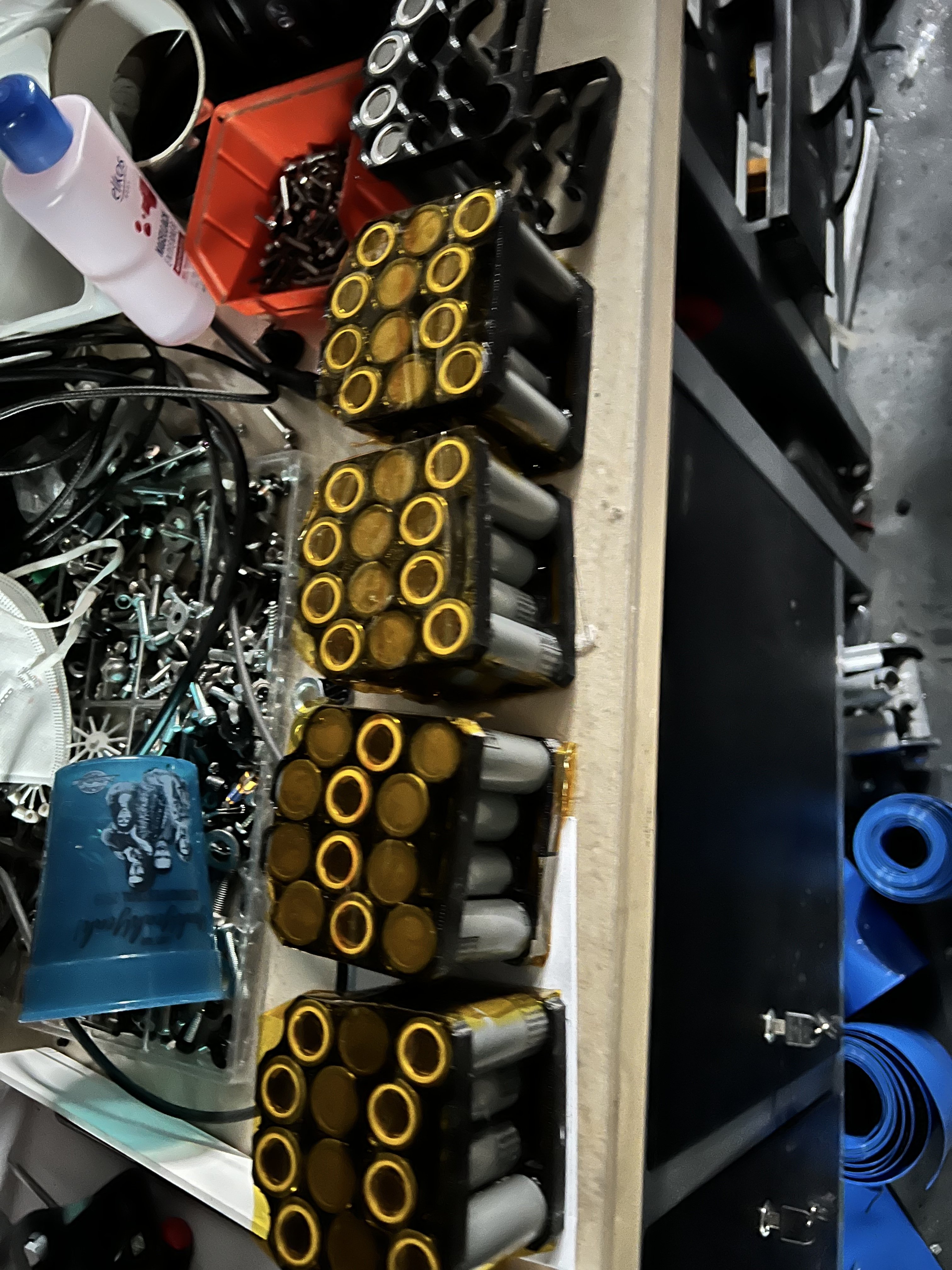

Still working on a light housing for a 13/14s battery with 20Ah . Holders are ready for 4x14 21700 cells
Still working on a light housing for a 13/14s battery with 20Ah . Holders are ready for 4x14 21700 cellsView attachment 100903 View attachment 100904
How did you manage to get 20.1 kg with such a heavy battery. Pike is lighter than Liryc by 200 gr. What tires and wheels do you have installed?
No the 20,1kg I realized not with that battery on the picture. 700wh is 3x13 21700 cells . Softpack battery!
Newman Evolution a30 , tubeless Conti tires . Shimano xt 12s

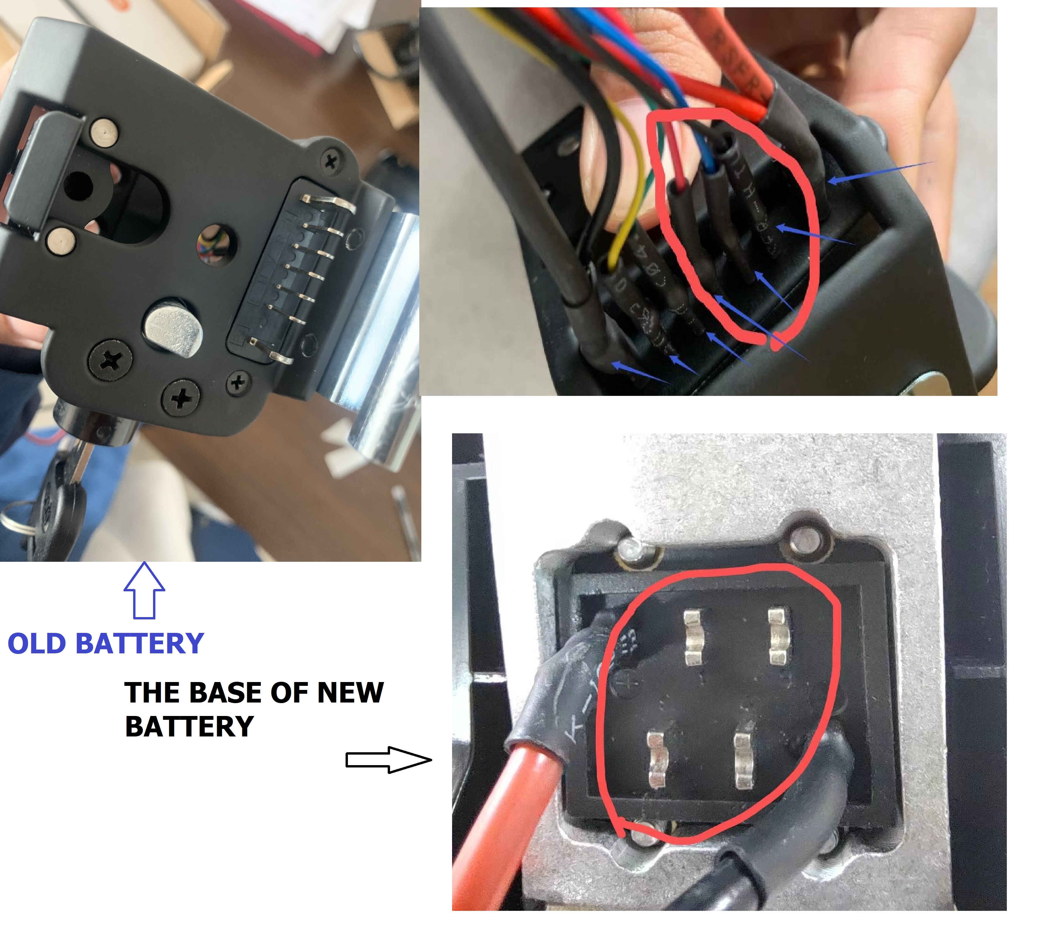

The original battery base with M510 motor has 7 terminals, and we are now looking for a high-capacity battery, the base has only 6 terminals, I don't know how to link it with the 3PINS communication protocol line, Bafang technicians Don't tell me, thesupplier of battery said they also don't know it.
Certainly dedicated wire to the bafang battery specific BMS to transmit data on battery using (Nb of charge, efficiency, etc..). For that i know, nothing other supplier battery provide these datas, only batteries provided by bafang can provide these datas.
Lot of people will be interested if you can find BMS who can communicate with bafang system.
What is the function of the 4 others connexions on the "new" base (2 for on/off switch, 2 for the battery charger ?)
about the rest 4 connect pins. 2 for data cable, that's what I want know, the last 2 for bafang's disc brake control, but now buyers normally no like use the bafang's brake, so they are useless to most people.
brake linked to battery ?
the "new" battery is provided by bafang ?
are you sure that you have not 2 contacts reserved for external on/off switch of the battery ? (may be only one and one common with main + or -)

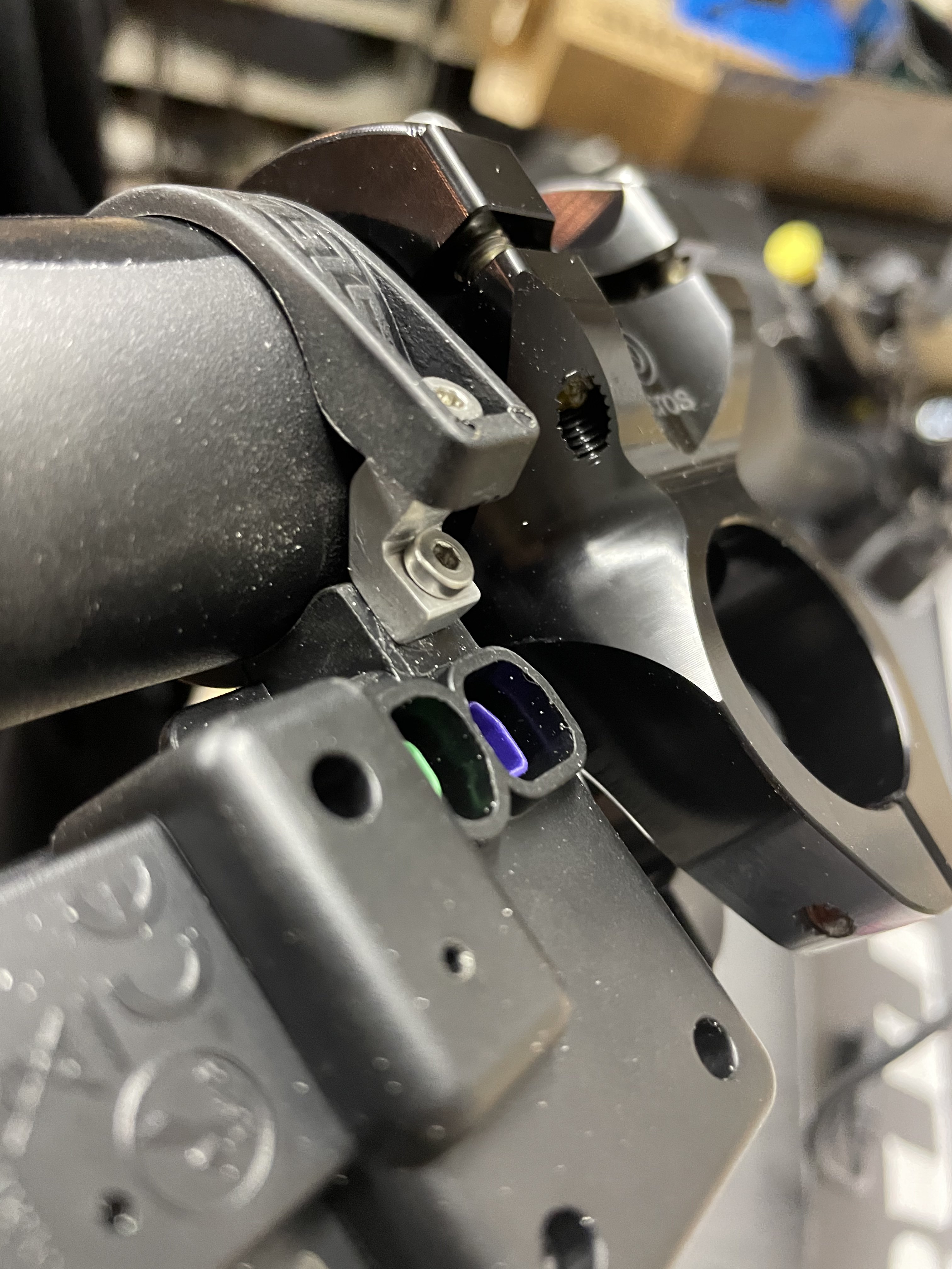

I like the fact that it caters for 35mm diameter bars. I just ordered one of these for my current Bafang display:
... which looks like a plastic version of the metal solution I saw you post elsewhere.
But that display you linked above, if it works with M510's, would certainly be awesome.
I have switched to DZ41 on my bike. And although it lacks in features it really makes up in ergonomics! Much easier to see the speed and Pas level. The whole thing is solid and the barmount is much stronger than the flimsy dpc241 mount. And all of this for a very moderate price if 35eur. Highly recommended!
