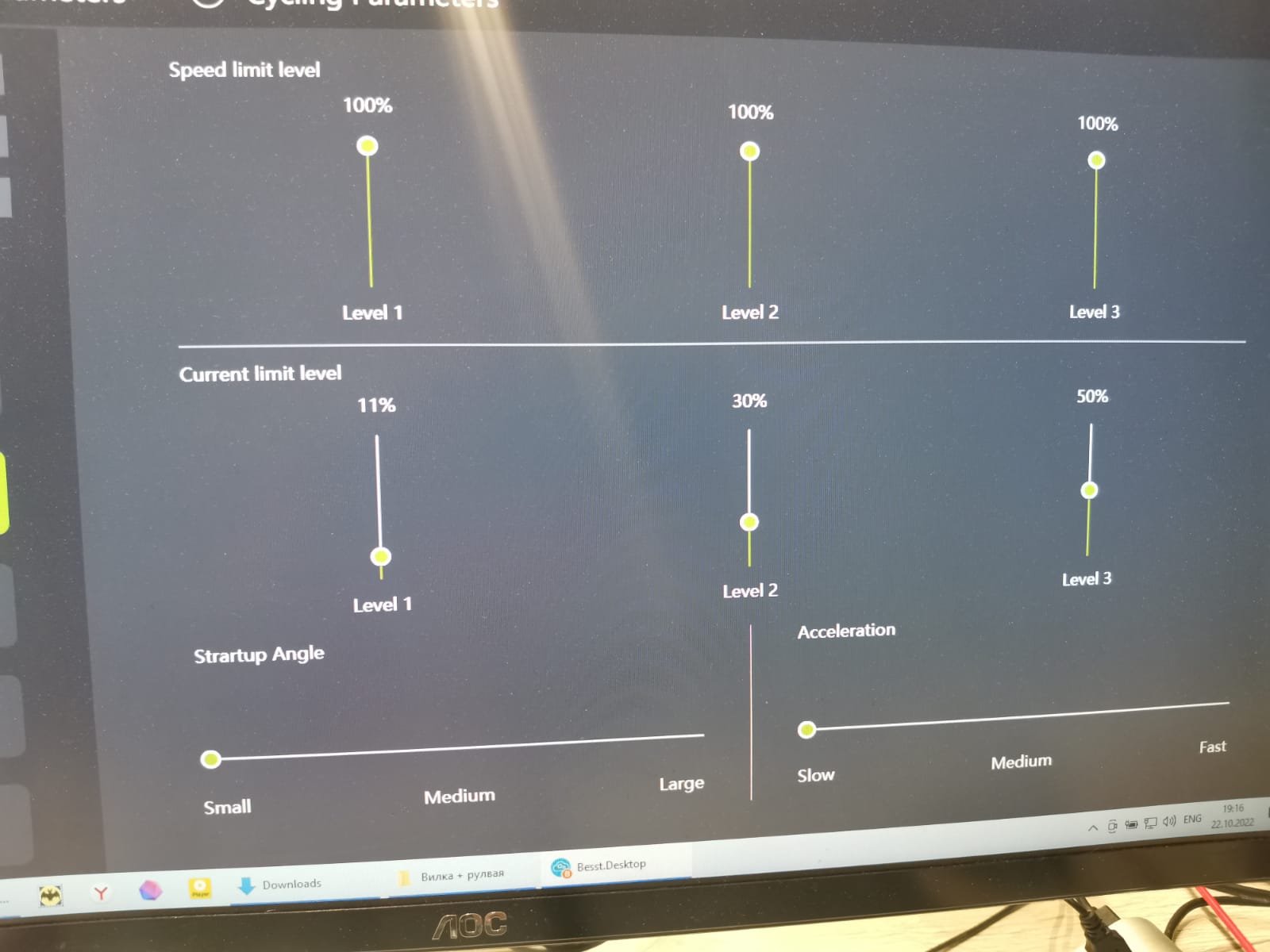

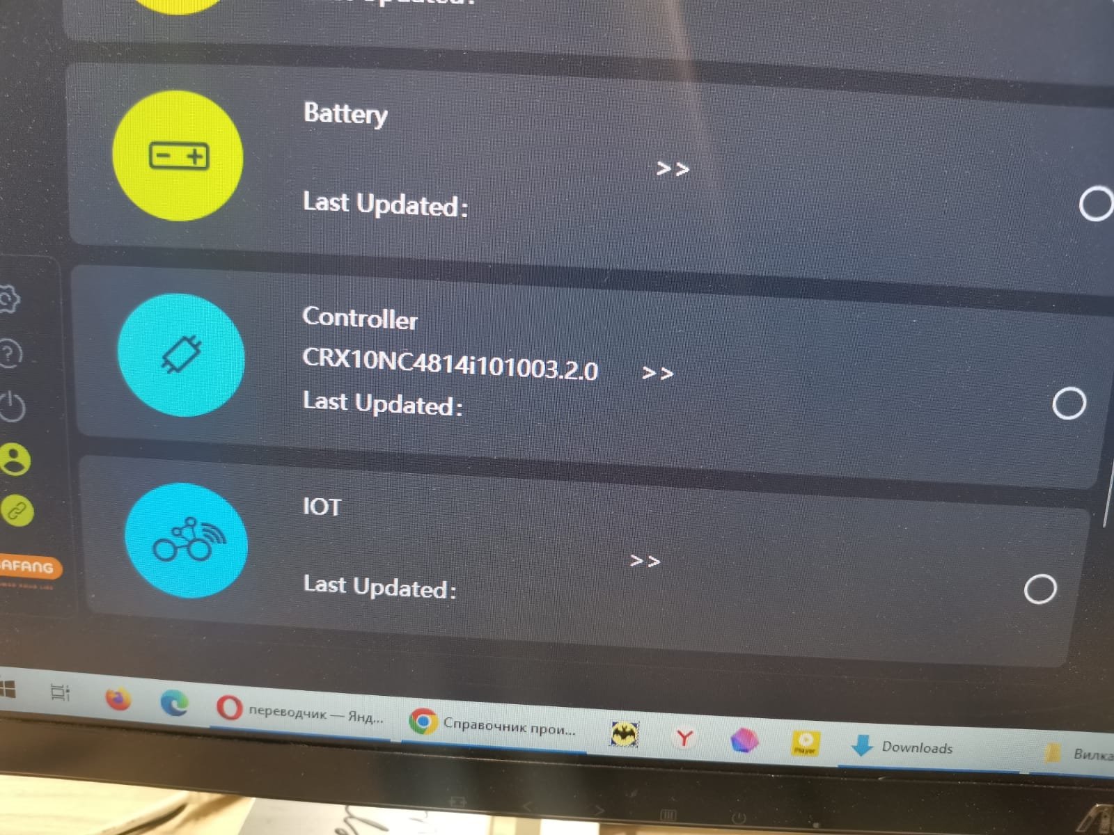

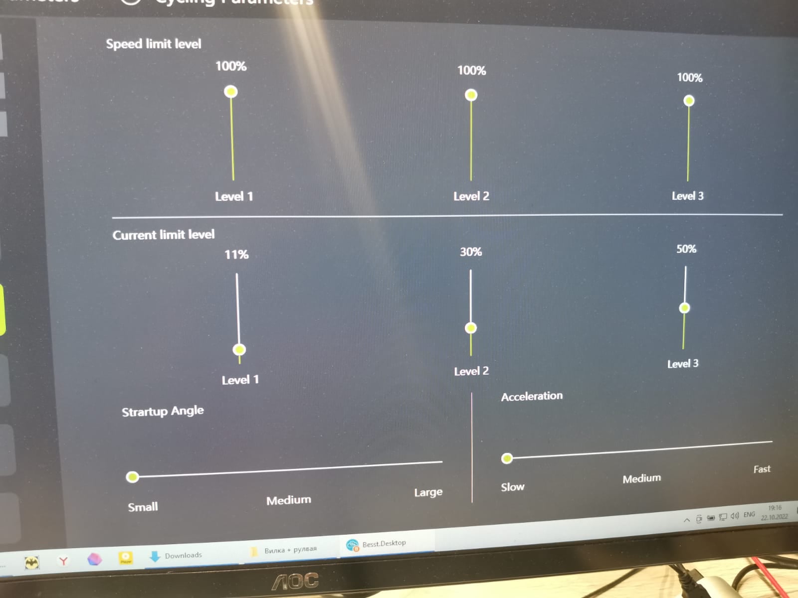

I finally found the time to upgrade the M510. I changed the acceleration settings to a minimum. The power has been reduced by 50%. I want to try if I like to ride the M820.
WhatsApp Image 2022-10-22 at 19.23.05.jpeg WhatsApp Image 2022-10-22 at 19.23.26.jpeg
View attachment 99784 View attachment 99785
Do you feel that the acceleration setting does anything at all? Somehow I didn't really feel it. Even at 0 the motor remains a bit jerky at the start
I think it does not work yet, firmeare is ignoring this setting yet.
You're right, this function doesn't work. The motor also accelerates rapidly at the beginning.

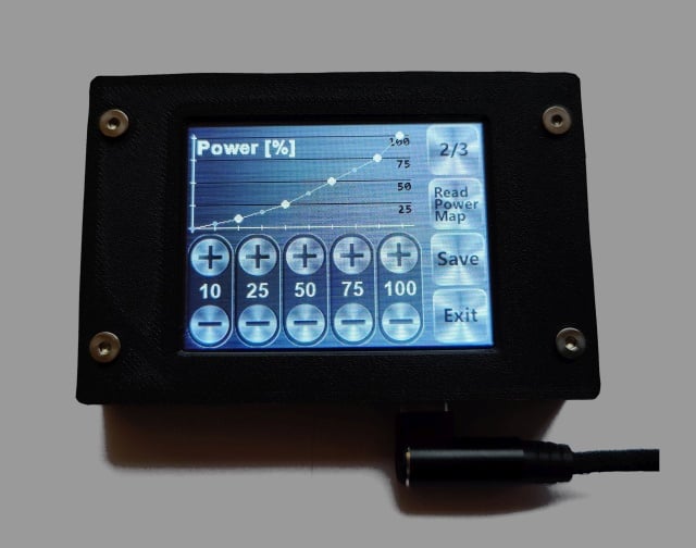

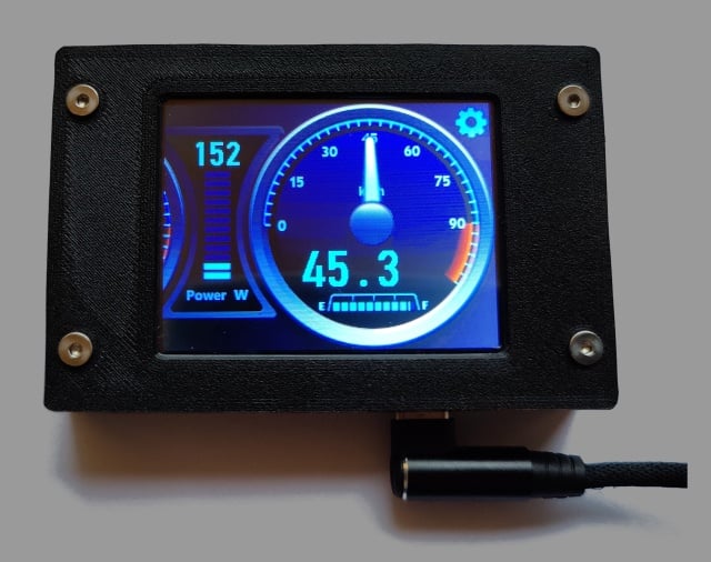

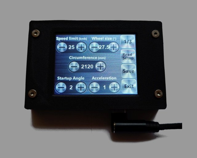

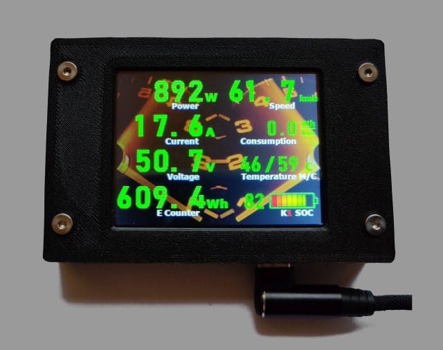

Hello guys.
A quick preview of K1 CanMon 2 - now touch display and support also M510 power map, like Besst Pro - simple, hassle free and works on 3 touches. Check for more info and first video HERE. 5pcs. available now, first 5 orders with 10% off.
Lot of new ideas for future updates...
Does it work? Is it possible to configure all modes? How much is it?
Hello Lanton. Of course it does work. ;)
What u mean configure all modes? Do you mean all passes? Now same as besst pro, you setup 5 passes and device will calculate the middle passes for 9 pass ( average value - you see the middle passes as a small dots on a graph).
And cost 170e (with m510 support) plus 10e shipping in EU. Check the page K1 eBikes & Smart IoT Gadgets is creating Ebike electronics, high-end and powerful ebikes | Patreon
Will start on a waterproof version soon, which is tricky and looks like I will sink few displays and microcomputers during submerge testing. ;) . But now need some rest, it was lot of sleeples nights to reverse engineering can protocol, make graphics and learn to code nextion display (u can imagine that chinese script language, but is good that HMI can be coded exclusivelly in this display and works seamlesly)
Anyway somebody knows how bafang designed 10 PASS levels? If added just extra tenth pass and some mapping again? Also devided to eco and sport, not sure if theres something special apart of defining power and acceleration (which does not work yet on M510) on each pass.
