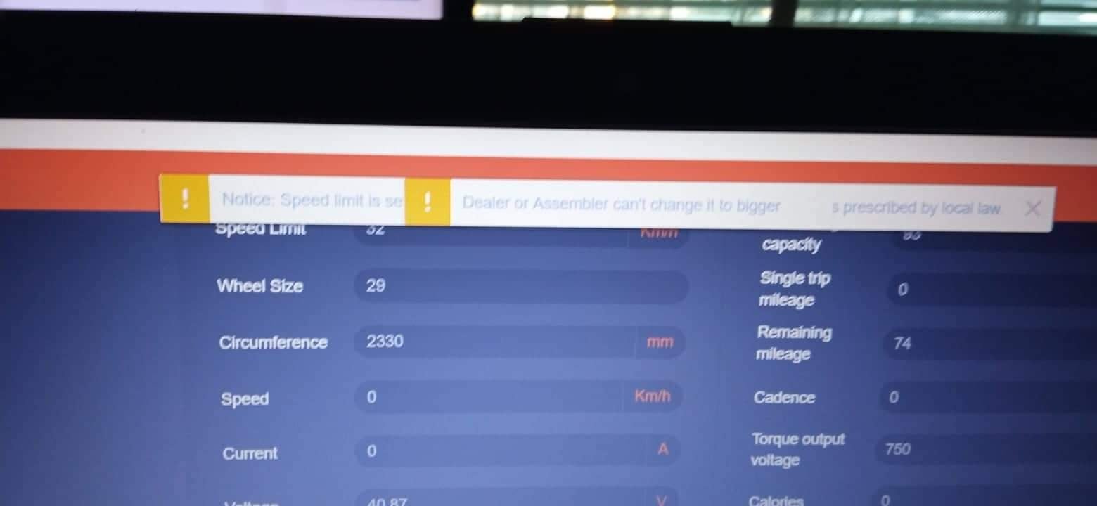

What do you mean by open version of m510? Also keep in mind this is an English-speaking forum for everybody's convenience sake....
In reality there's no such thing as open/closed versions. You can configure the speed limit provided you get/find somebody with Besst tool. Also same way other parameters can be configured depending on the firmware used. I would recommend you reading the m500/m600 tunning thread. Everything is explained there in detail: Bafang M500/M600 Tuning & The BESST Tool

I was normally using version 1.2.18 to change the speed limit on my m500. What exactly happens when you try to set it above 25?

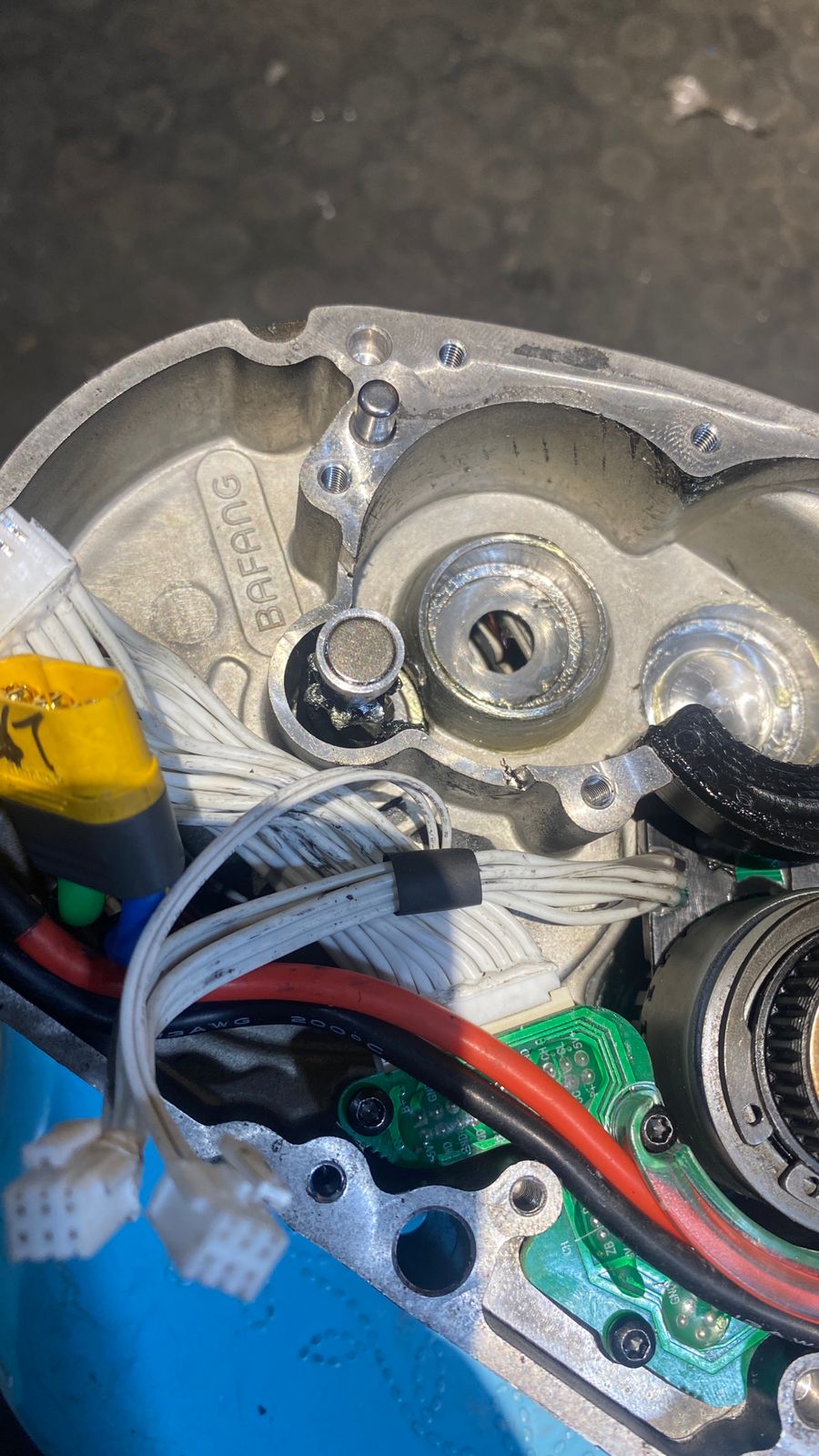

My M510 last about 400km and torque sensor failed. Motor can turn on but when I pedal no assist given. I don't know what caused this.
Then I wanna get after sales from my seller and she want me to send the motor to China. Will cost some money and time if i send from Indonesia to china.
Anyone here experience with after sales that no need to send motor to China and Bafang send the replacement part?
Its difficult to diagnose your motor symptoms @temon10 by your analogy. If the motor spins freely when back pedaling and engages the chainring when pedaling forward, the motor (mechanically) should be fine.
It is possible that the internet poll magnet may have come loose. But you'd know whether it had, as you would hear it rattling around inside the motor.
You may need to recalibrate the motor torque settings using the Besst tool. But if you haven't messed around with any firmware swaps/updates, chances are they may not be the issue.

"internet poll magnet may have come loose" where is it?
Motor spins freely when back pedalling. motor mechanical is ok after checked. I have besst tool, only can recalibrate motor position not torque sensor.

U mean this magnet right? it is firmly on place, not loose a bit. so i think the problem is torque sensor.
I thought as much. You'd know if it was the magnet, as you would hear it rattling around.
Here's where you can get another one. Be sure to use the besst tool to recalibrate the motor upon installation.
Do you know how to remove the crank shaft?
If not, let me know and I'll post a detailed step by step method to follow along with what grease should be used 👍🏿
