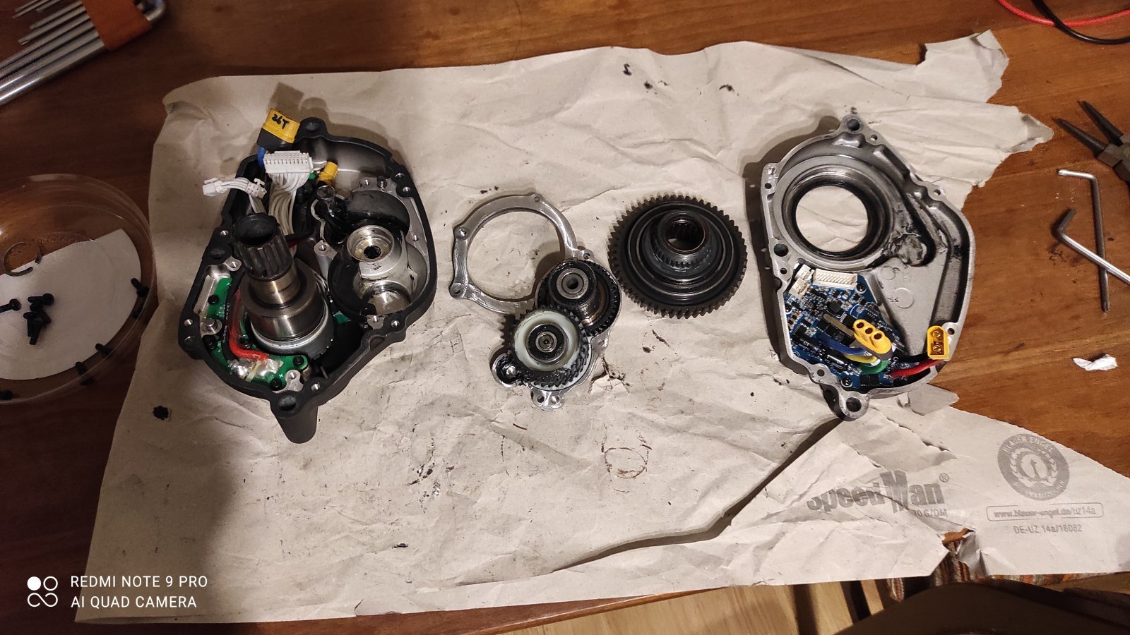

An update on my bearings isuue to whom it may concern. Yesterday after regreasing and reassembling the motor I went for a 10 minute test drive and the problem persisted. At first motor started normally, but already after a minute drive I could feel the issue there. This made me upset.
Today I have went for another ride without much expectation. I had 1 time in the beginning when the motor did that for a second, but then the issue went away. I've decided to continue my test and started going up and down the hill in PAS 5 to see if the temperature had any effect on this. To my great joy the motor worked great and haven't stalled a single time even when it got pretty hot.
My current conclusion is that the fresh grease got into wherever it needed to go and everything started working fine. I assume it didn't happen immediately and needed some time.
I have also cracked open my m500 to see if the sprag/main gear assembly was compatible with m510. But unfortunately it was a completely different bearing. The middle gears though seemed compatible, although I won't guarantee that as I have already sealed up the other motor by that time.
Here is a photo of my 510 fully disassembled
Update: upon assembling back my m500 today I have realized that I've wrongly assessed the construction of the crankshaft bearing assembly. In fact they seem to be identical(couldn't measure) and thus interreplacable. This is great news for me coz this means I will be able to use spare parts from my m500 when those bearings will die. Makes me feel satisfied ☺️

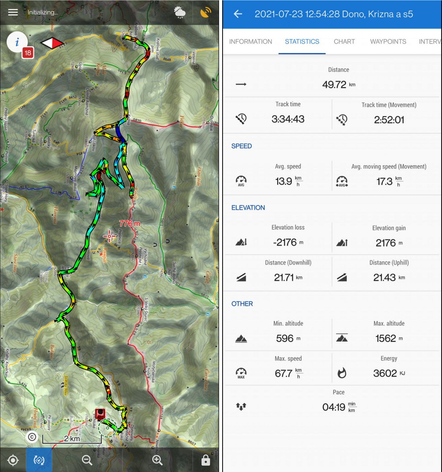

As Waynemarlow pointed out, this is very specific to the way You ride and how much energy You put in by Yourself. My experience is with the 14A firmware, that battery consumption is comparable to my bike buddy’s with Shimano and Brose. The most I ever squeezed out of 1 battery was in Finale Ligure, 54 km and 1740 hm at 10.2 km/h average speed, using Pas 2/3 mostly, at very steep and technical climbs Pas 4 for a minute here and there. I‘m in good physical condition and ride a lot. So It‘s Your guess if 2.000 meter vertical climbing are possible 😊

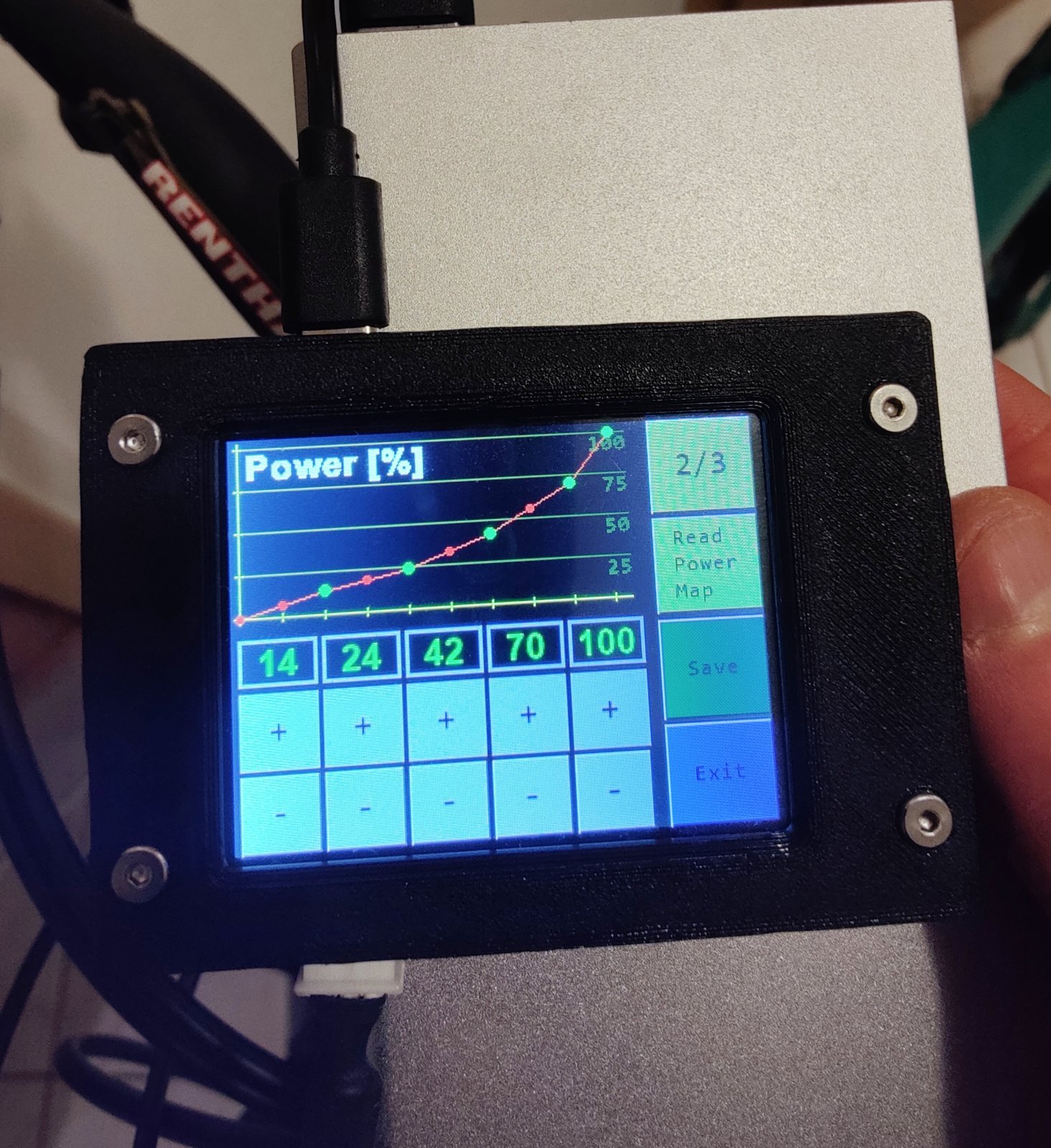

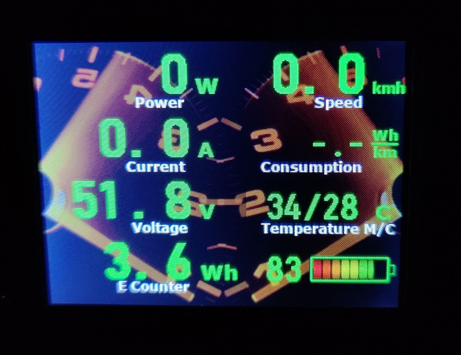

Guys and now measurement from yesterday on M510. Pass 1 (14% power) - I did 1.4km and measured consumption was 3.6Wh. (I went constant speed 24kmh). Now do the math with usable energy of battery 750Wh for a range. Of course straight asphalt.
For people who dont like physics and math :)) (750/3.6) * 1.4 km
Attaching power map setting.
