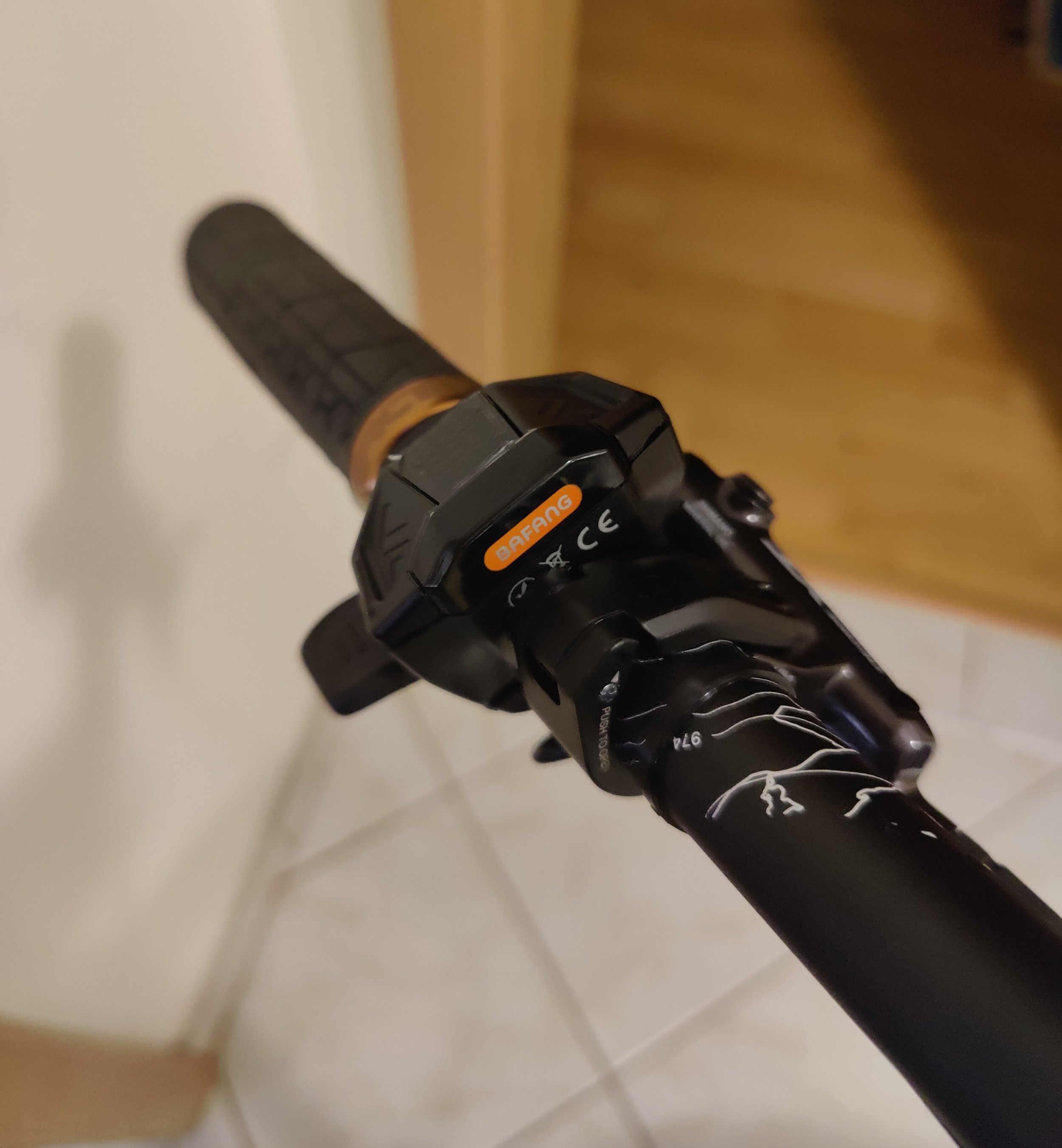

The new DPE181 remote control without a screen, but with bluetooth. If you need parameters, you connect an old smartphone or your remote control. There is a navigator on your smartphone, can you install a navigator on your remote control?
I want to buy such a remote for the M510. The remote will appear in the store in a month
The BT Buttons, do you need a display to interface to the motor or can you go direct ? And cost ?
Finally looks pro. Also looking forward for this display. Also buttons looks good.
Lanton, I have that BT buttons over a month, it somehow showed up on Ali. Chili is also selling them.
Do you like this button? Is the button convenient to use? This button does not have USB, how to charge a smartphone?
Assuming there is a smartphone app. Then you still need a module to communicate with CAN. Maybe you can make friends with the phone via Bluetooth with CAN? If it is possible, then Dado will be a very rich person if he writes an application for a smartphone. The app is easy to sell. It will not cost as much as the device. And they will be able to buy it all over the world. I'll be the first customer.
It is connected to motor over cable. BT is for connecting with mobile. Just in case missunderstanding. ;)
Buttons are good, ergonomic (I do like higher edge on end of buttons, so easy to operate). Need to check how to lower led power - shines too much.
As there is microcontroller with BT and CAN driver, it is little higher - see picture, but perfectly match into hole in new XT lever. (Can not go over the throttle case though)
Plastic case looks better, also quality of plastic. LEDs are as is - old school (could have been 2 small 1 line OLED displays) There is rubber on bottom half ring, also a hole for cable exit.
Dont wanna voluntary try waterproofing with wap wash. ;) But hope, it will be better now.
These buttons was exactly what I was looking for. To handle all CAN traffic. To mimic whole Bafang CAN protocol would take a lot of time without documentation.
Thaeber, thanks.
Digging into it, lot of overnights. ;)
Thaeber, thanks.
Dado, any plans to develop an App for the phone? I would buy it anytime ;).
