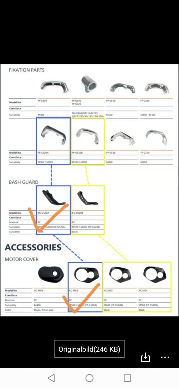

which of these guard and cover will fit the M510?
For the Dengfu e10 it should be these.
The FP G520A is an aluminium weld in engine mounting, if you have an E10 then you won't need this.

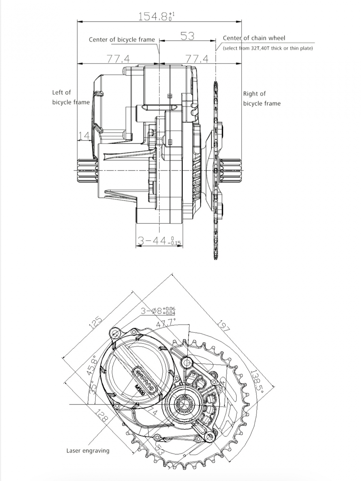

Would you be willing to drop a link to your seller? Also, does anyone have a higher resolution of the technical specs CAD files for the m510/500 than the ones posted earlier? I'm having a Ti frame built and I need the specs to pass onto the builder.

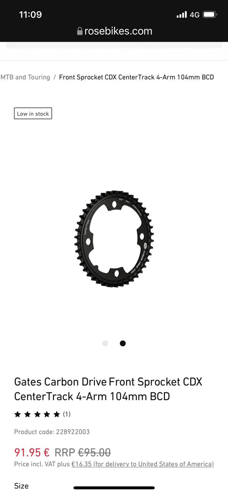

You just need to find a belt drive chainwheel for 104 BCD. And You need a chainstay that can be splitted, because the belt can not.
Thanks everyone! Yeah, I am aware that I need a splitable chainstay, I'm having a custom frame built up for this. I found this intergration guide from Gates later in my search which shows compatibility across several bafang motor and hub pairs: https://www.gatescarbondrive.com/~/media/files/gcd/ebike-manuals/gates-cd-ebike-manual-en.pdf?la=en
@thaeber would you mind posting a link to which alibaba store you purchased your M510 from?

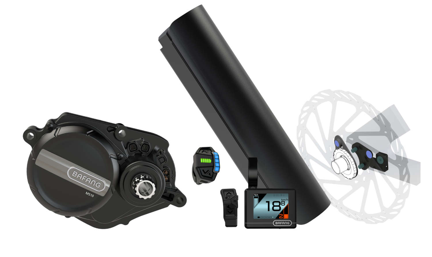

The M510 engine is compatible with most of the products in the Bafang portfolio, such as the Intube battery, the DP E180/181 displays with a clean LED HMI, the optional enhanced color version DP C242 HMI,
((((((the hidden speed sensor with two magnetic fixing solutions))))))
and the next new Bafang application”.
